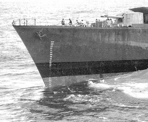

The draft marks are measured from the bottom of the bow and upwards. So the lowest mark -III- is three feet from the bottom, the upper mark -XVIII- is 18 feet from the bottom.
The range is normally III - XVIII for all Tribals. I include here the bow of Warramunga, one of the Australian Tribals. There shouldn't be any difference between the Tribals in this respect. The marks are welded onto the hull in relief plate. After painting of the ship, usually the letters are painted over in white on the black boot topping and below on the red antifouling. Above the waterline it depends on the colours: on a dark hull white is used, on a light hull black. With dark and light camo this may even switch at the colour demarcation. So not from a specific number, but depending on the background paint colour.
When the paint of a ship has been touched up, then the white/black to the markings are not always re-applied. This must be the case with the picture you included.

1. The intervals between draught marks were one foot.
2. I am fairly sure that all British Tribals started off with marks from III to XIV. Various photos and the two Tribal �As Fitteds� I have show this � see attached example and �As Fitted� for Ashanti. As the war progressed draught marks began to be painted ever higher on the hull reaching forecastle deck level on some as early as 1942. You need to check ship by ship for the time you are interested in as there were considerable variations over time. Even within a few months of your photo of Eskimo two higher draught marks had been added to hers. 3. The white painting for the lower hull would begin wherever the boot topping began. The top edge of the boot topping was just above XIII pre-war war but varied a bit ship to ship during the war with some boot toppings becoming wider and so higher and others going lower when overpainted by camouflage schemes - compare for example the difference between the position of the of the boot-topping on Zulu and its overpainting on Tartar. Again check ship by ship at the time you are interested in. (You could also have light/white marks above the boot topping depending on the paint scheme and individual shipyard practice.) Whatever her As Fitteds may show, this is Warramunga in 1943:

As Dick pointed out it is totally dependent on the subject and the time period.
Whilst the lower number of the bow draft gauge began at III the upper mark varied.
Australian tribal bow gauge finished at XX, but it changed dependent on period, late 45 into 46 it was XXI and on occasions XXII.
Bataan`s gauge was III to XVIII on launch but by commission it was XX.
The tribal stern gauge over the prop shaft struts began at X.
Like all marine paint it was subject to weathering and water friction and wore off as per the initial image.

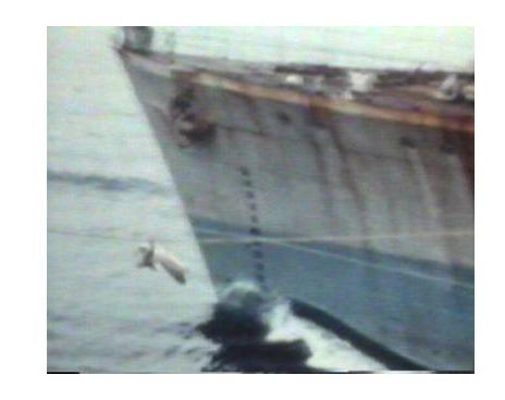

Underlining how things varied and the need to check things ship by ship, I have this photo of the draught marks on Somali in May 1940 showing that:
1. Her draught marks were simply painted directly onto the hull, not metal numerals welded onto the hull and then painted.
2. The lowest number (then at least) was V not III. However those on Haida appear to have been the welded on type (parts of which have fallen off over the years).

Thanks for your replies, that's really a kind of info which is useful to me.
The pictures are also great. Was this a common practice for Royal Navy or just Tribals feature to use painted metal numerals on the hull?

Yes, many Navies weld the numbers on. However, common doesn't mean absolutely every time.Guest wrote:Thanks for your replies, that's really a kind of info which is useful to me.
Modern Navies still weld numbers on. An interesting example is the USN Arleigh Burke class. The Stern Numbers are welded, but the Bow numbers are not.
I've never been able to figure out why someone would paint the depth numbers all the way to deck level. The only thing I can think of is a Sailor who either didn't understand instructions or didn't care. One other possibility might be easy reference during an inclination test, where they put weights on board to make the ship tilt sideways to determine if the stability is correct.
I suspect variations between ships might be due to refits where the overall tonnage of the ship changes due to added equipment. This would change the waterline.
