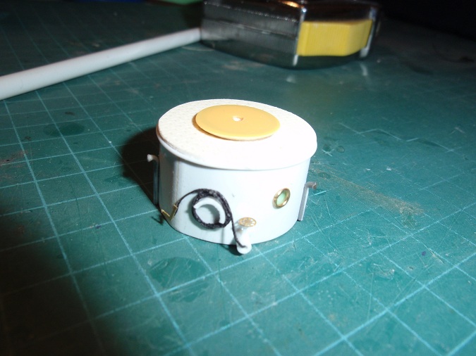

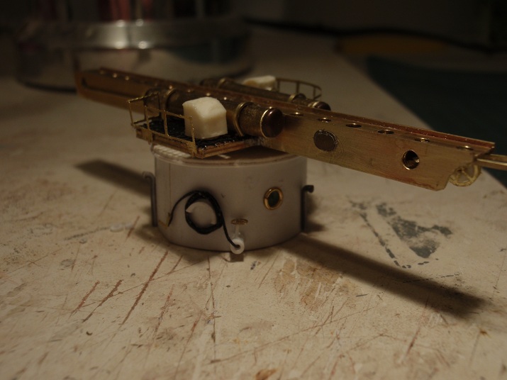

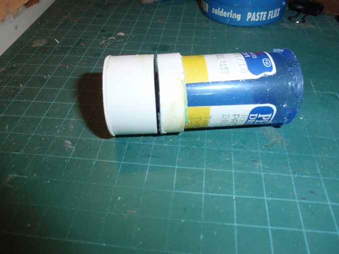

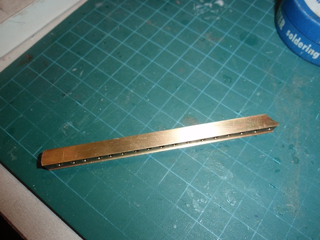

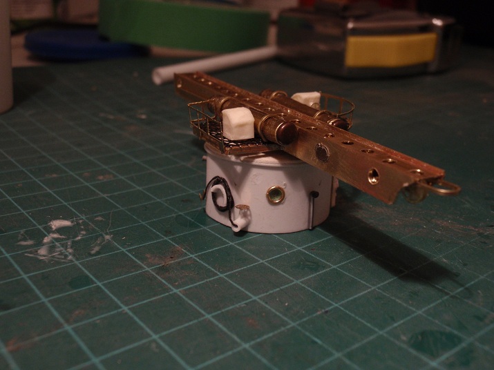

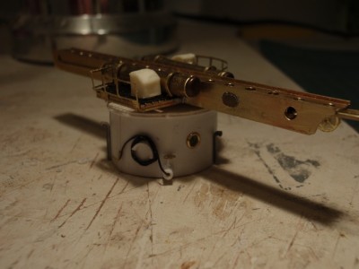

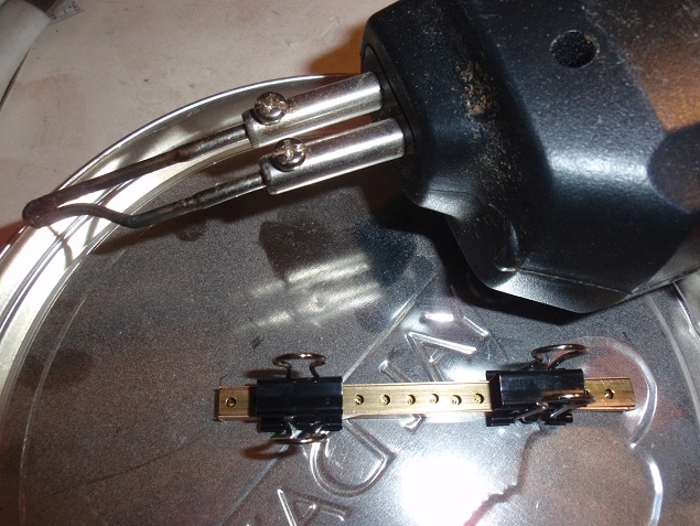

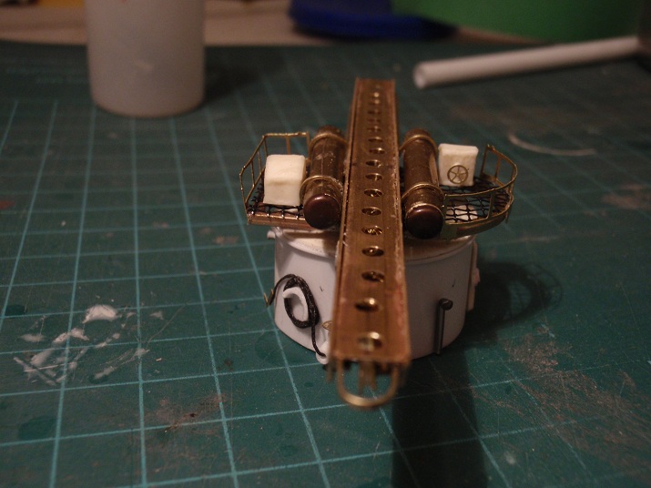

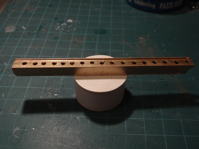

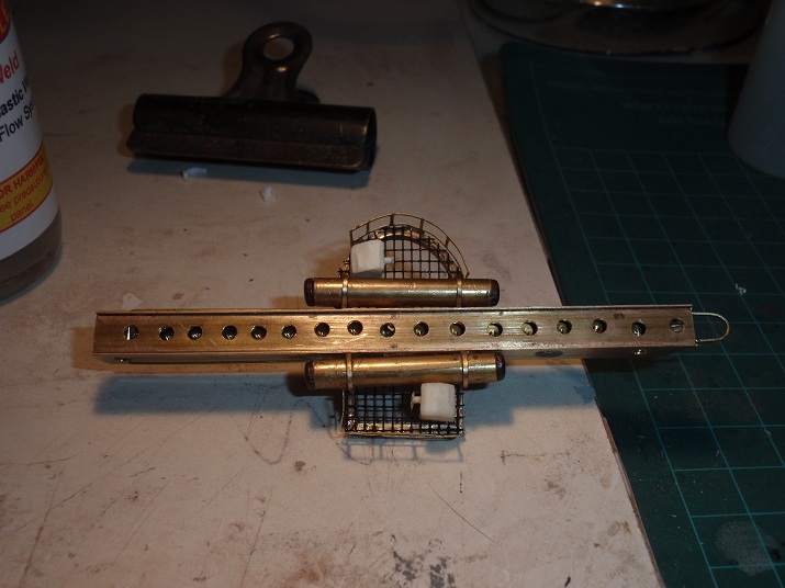

well it's time to build the catapult for sc .as catapults go it is a fairly easy looking build .the base is a pill bottle that i wraped with .30 mm styrene and then cut to length,the main body of the cat is brass strips and a piece of box beam soldered together.heres the start of it.lots more to add on still.

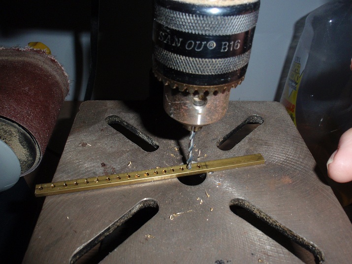

i used my drill press to make the holes in the box beam
fairly heavy brass so i used a big gun,lots of heat
main body soldered together

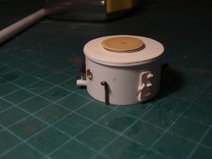

pill bottle wraped with styrene,the perfect dia.

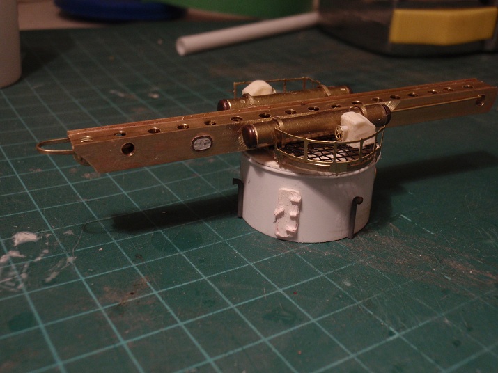

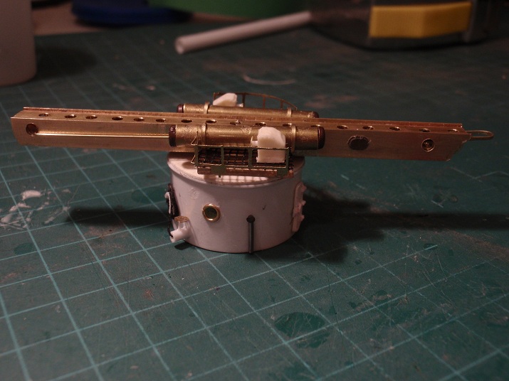

base and main body together

good job on metal Russ

Hi Russ Good start on the catapult. Will you be building the platform in brass ?

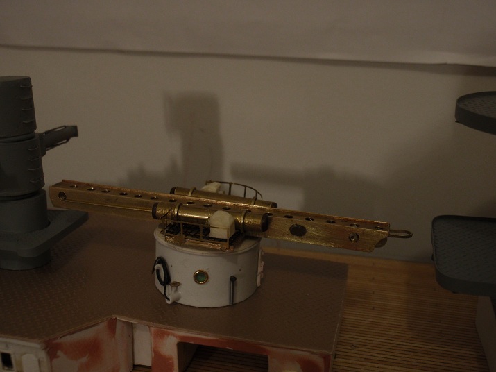

thanks for the intrest dave and norberto,yes the whole catapult is brass and a little resin casting.i got some 1/144 photo-etch railings and ladders from toms model works and it will be the only photo-etch on the whole ship.nothing else around.here's the finished cat less paint ,plane and plane cradle.the cats on these ships must have been very powerfull as they are a lot shorter then on other counterys ships.
base showing plane fuel hose
door is a casting i made from resin i made about 30 for sheer,some with pot holes in them
on some pics and plans the platform show one side sqaure and one side round,others show both sides sqaure
sitting on the deck ,not attached

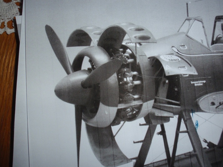

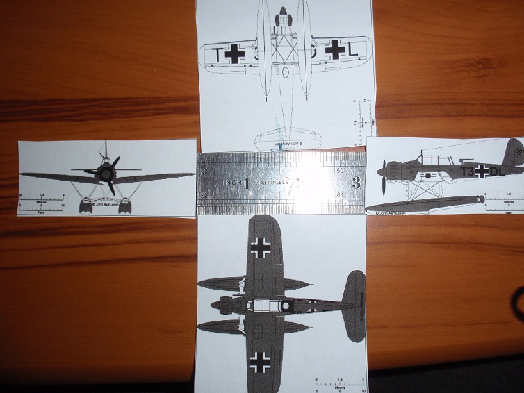

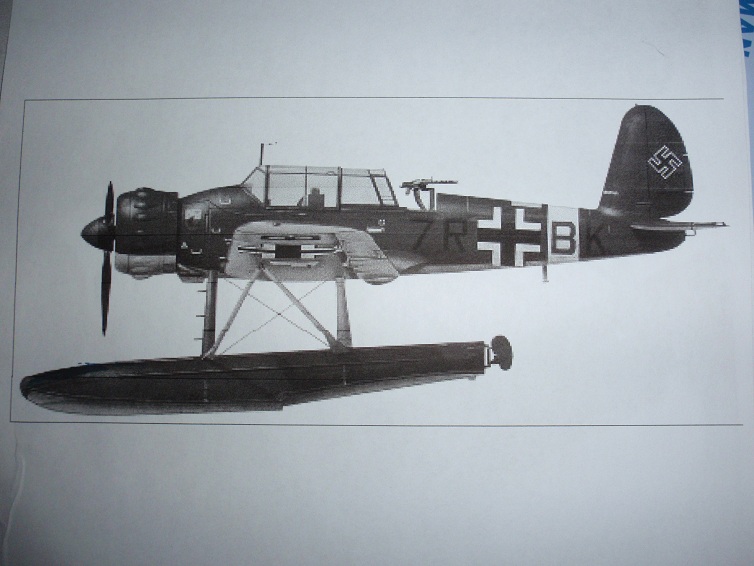

thanks richard and noberto.i am going to start on the cradle and arado 196.I scaned some pics and scaled them down to 1/144.this makes the plane about 3"wingspane and 2.8 from the front of the floats to the tip of the tail.not very big but about 30%bigger than 1/200.hopefully i can make a fairly detailed model.Going to be a challenge old eyes and clumsy fingers :big_grin:
this is the 196 in 1/144 scale
i think i wil try to show the radial engine with the cowls up
i think the 196 has folding wings,i am not going to show folding wings as i am only building one

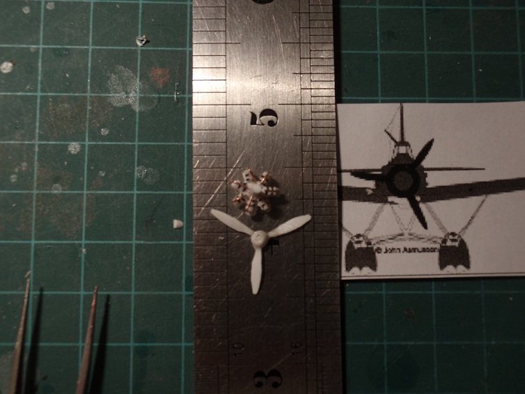

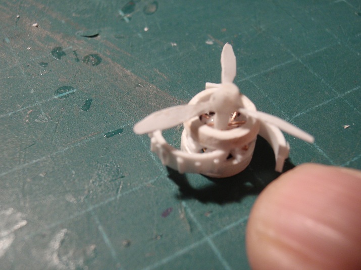

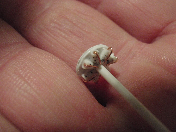

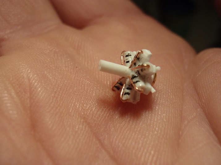

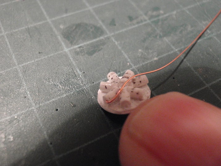

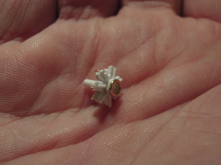

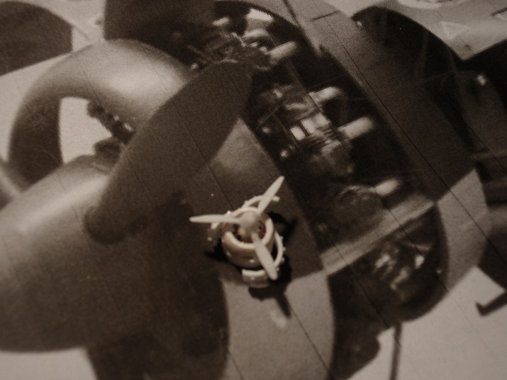

here's the start of the arado 196,this is the rotery engine.i know it is a 9 cyl. engine but i had enough trouble trying to fit in 7.once it is mounted on the airframe it will be impossible to tell there are 2 missing :heh:
Richard J OMalley
Posts: 1012
Re: 1/144 admiral sheer s.c. scratch build
Post by Richard J OMalley »
Looking good Russ
I can almost smell the avation fuel . :thumbs_up_1: :thumbs_up_1: :thumbs_up_1:
russclark
Posts: 1173
Post by russclark »

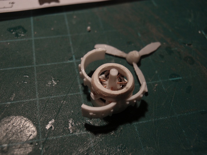

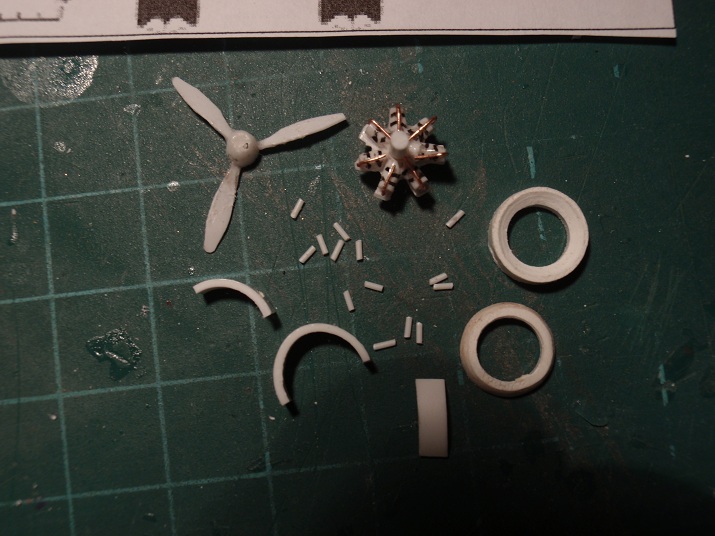

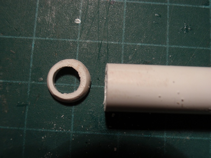

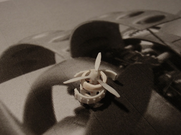

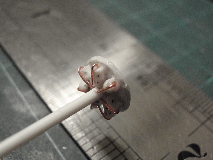

well the engine is done.came out not to bad,the prop is made from styrene ,if i find one the right size somwhere i will use it.i am not sure on the size of the engine i think i'm close.i will have to be careful when i start the airframe it may have to be a little smaller or a little bigger to look correct ,but i mean very little.before i paint it i have to somhow lightly sand some spots that the glue got on.here's some pics.
i used thick walled tube for the cowls,i tapered the front and counter sunk the back
this shows the thick  walled tube one tapered and one counter sunk
the open cowlings are the thinnest tube i had ,they still are  over sized.but at the size the engine is it is hardly noticable

Russ Your idea for the open engine cowl is a departure from the usual arrangement and a really interesting one. . I scratch build my own 196 for both Tirpitz and Blucher but I didn't dare try to go beyond building the airframe, floats etc. The only internal part I tried to replicate was cockpit interior. It had only a passing resemblance but at 1:128 is reasonable. I build up the fuselage, , flying surfaces and floats from styrene sheet .The canopy was made up from Litho strip and acetate sheet. But you are building at 1:144, a more difficult prospect. Your work on the Admiral Scheer is simply superb and presenting the 196 differently is a challenge. As a foot note to my original Arado built for Blucher .This was lost in a sailing accident whilst trying to come about and misjudging the amount of turning circle, ending up having a minor jolt with the side of the canal. All my hard work was "catapulted" off the model only to disappear into the murky depths. Now I make absolutely sure that any aircraft fitted are well anchored to the catapult /flight deck. I rebuilt a second Arado but I never had a chance to sail the model again. One of the really risky parts of the build was not so much the Arado but the launch trolley, getting that right was a bit of a balancing act. Great to see your build developing inspirational workmanship for sure and thanks for posting .

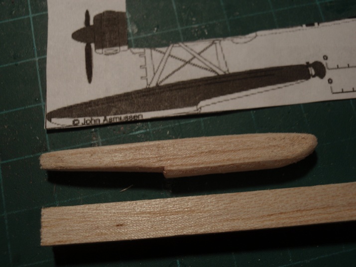

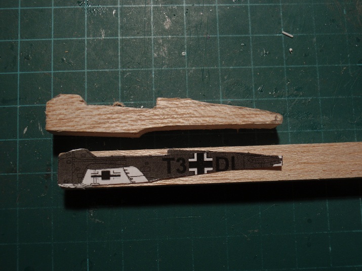

thanks dave for the insite.i am not quite sure how to tackle the fuselage and floats yet ,on my 1/200 planes i carved them out of wood,but this did not realy come out as i had hoped.i am going to try again with wood ,but skin it with styrene.this may not work as the thing is pretty small.i also my try all styrene,or cast them, if they are cast one can be fairly rough on the sanding and fidlling with the part as it would be tough.i think there is going to be a fair amount of scrape going into the trash bin :big_grin:
russclark
Posts: 1173
Post by russclark »

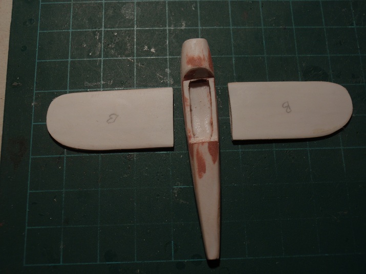

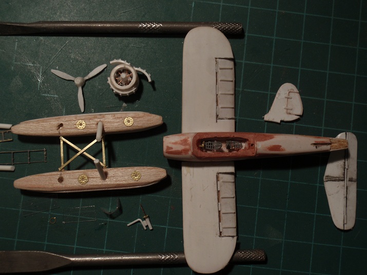

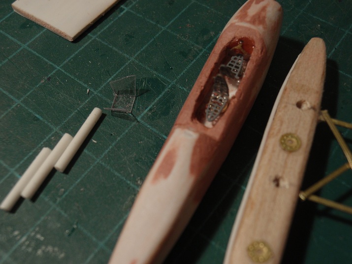

moving along on the 196,i desided to use balsa skinned with styrene for the floats and fusalage on the arado.here's some progress pics.

Russ this is great work . Scratch building at its best. I like the way you have provided for the seating , nice touch . Question how do you intend to build up the canopy?

Post by russclark »
hello norberto,the arado is very challenging,but it is coming along.how is bismark doing,have not seen any updates for a while.Dave i have been following the hanger build with great intrest ,very nice lots of detail.As for the canopy i will make it from clear plastic bent to the correct shape,then i will add the bracing over the outside .i think i will show the canopy open at the front.this solves the problem of trying to match it to the front windscreen .

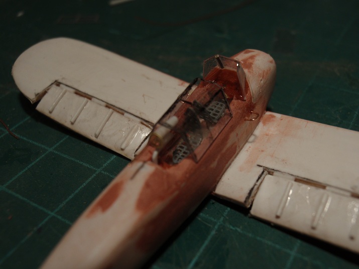

russclark
Posts: 1173
Post by russclark »

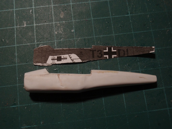

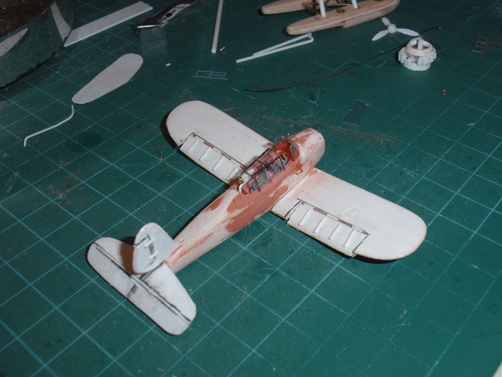

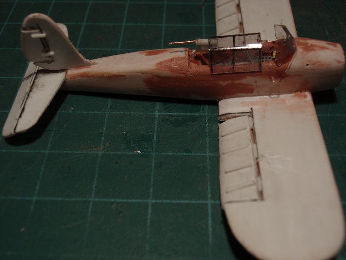

a few more shots of the arado 196,she getting there :big_grin:
canopy is not glued on yet ,i have to piait her first
