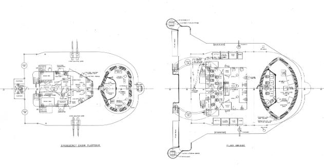

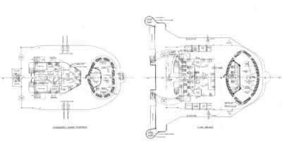

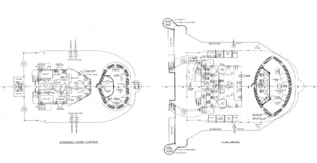

Does anyone know where the armored door to Pennsylvania's conning tower is? Is there any photo of the door?
In trumpeter's 1/200 Arizona, no door or hatch is depicted.
In booklet of general plans, also there is no indication of any door.
Is the conning tower accessed from below through a floor hatch?
BB62vet
Posts: 3162
Location: Mocksville, NC
Re: Calling all USS Pennsylvania BB-38 Fans
Post by BB62vet »
Chuck,
The entrances (2) to the armored barbette on BB-38 are in the rear of the barbette on the Signal Bridge Level and also on the Emergency Cabin Platform. Here is a clip from her Dec. 1931 joiner plan:
I seriously doubt that there were any changes made to these entrances in her rebuild following Pearl Harbor's damage.
Hope this helps!
SeanF
Posts: 799
Location: Downey, California
Post by SeanF »
BB62vet wrote:Chuck,
Hope this helps!
Well, not until they removed the entire armored conn, that is...
- Sean F.
