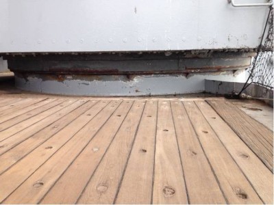

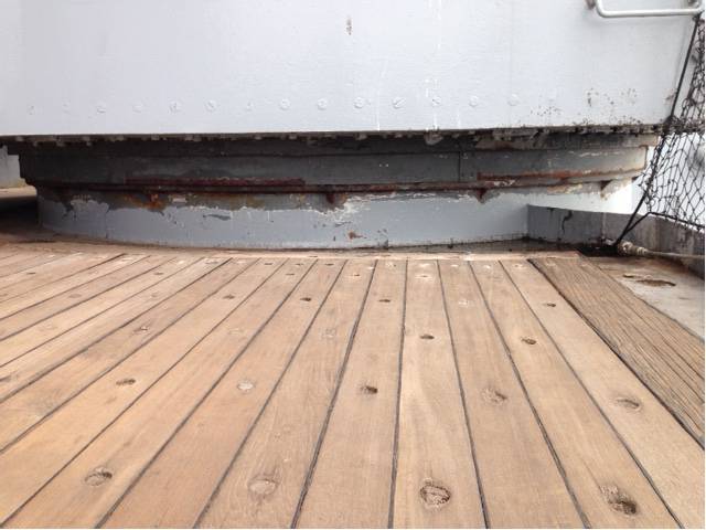

If I understand the question correctly, the turret ring for the 5" mounts does extend above the wood deck. This offset is no more than a foot though. Attached is a photograph of mount 52 aboard Iowa, which I took this morning.
Bill
Bill

An interesting photo! Will have to consult my photos but I believe BB63 is different (maybe)! The question has to do with the steel deck (under the wood) and whether or not it drops down forming a trench behind the mount and the outboard top of the handling room is lower than the steel deck inboard. My impression is from BB63 (ships differ) is that if you took the wood deck away the area behind the barbett and the outboard top of the handling room would all be the same level?
Thanks for the interesting and informative photo!

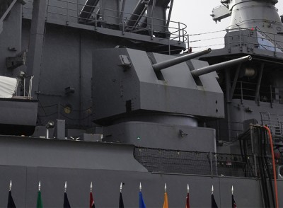

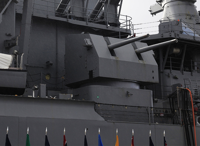

Hmmm, surprise surprise, the ships are different!
Note the smooth barbette almost to the base of the mount?

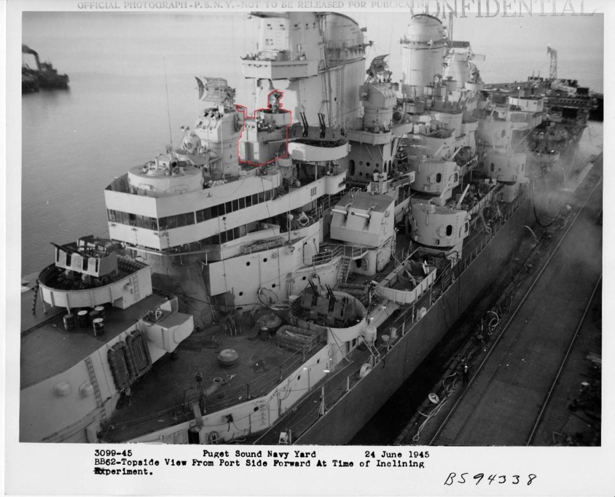

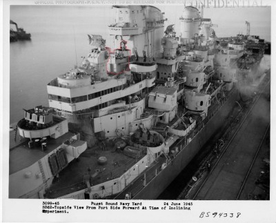

Does anyone have construction details and clearer views of the enhanced and heightened twin director (Mark 57 GFCS) platform abaft the forward Mk. 37 director on the USS New Jersey, circa 1945-50? This is a feature that appears unique to the New Jersey as I've found no other Iowa with a platform and director tubs of this size. The top of the tubs are about even with the roof of the Mk. 37 director... Not sure if my nomenclature is correct. Thanks for the help.
See area outlined in red. Image stolen from Navsource.
