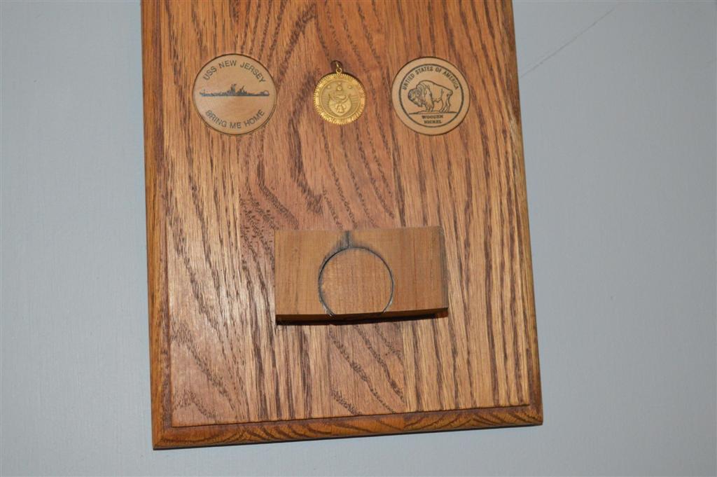

Deck Staining:
First, here is a shot of the small deck plug from NEW JERSEY -
This is attached to a plaque I made for it with a couple NJ wooden "nickels" & medallian.

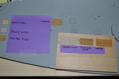

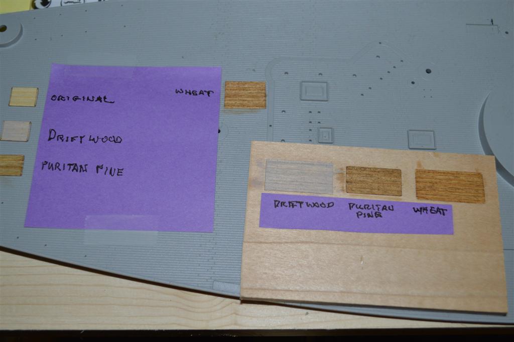

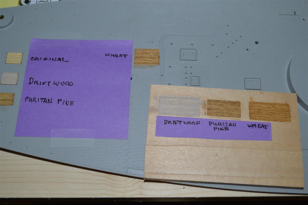

Now, here is a photo of the Wheat stain (MinWax) coupon that I think will do the job -
Unless my eyes are playing tricks on me, the Wheat is pretty much right on target; so, this is what the deck will be stained - I plan to FIRST stain an unused area of one of the deck sheets and see how this looks prior to actually stainning the parts. I realize that these are hard to see, but resizing the originals makes these a bit small in order to upload them.

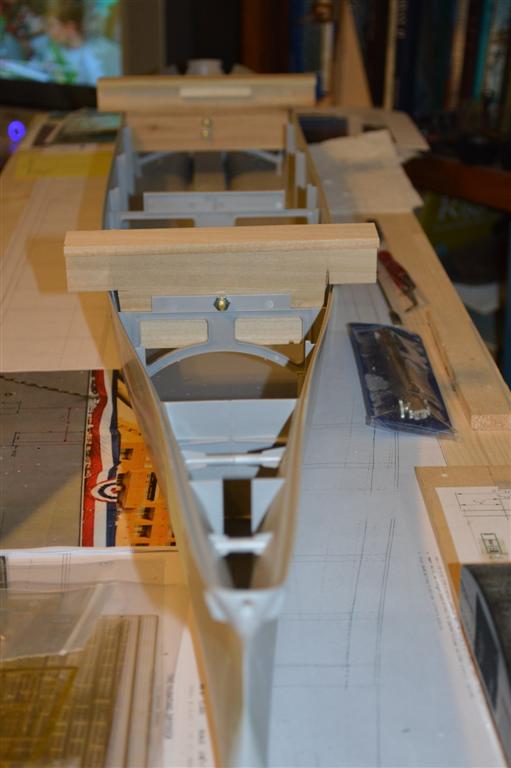

On the topic of modifying the kit bow area:
I did some basic carpendry to fashion a couple wooden hull stands which are bolted to the hull cross members -

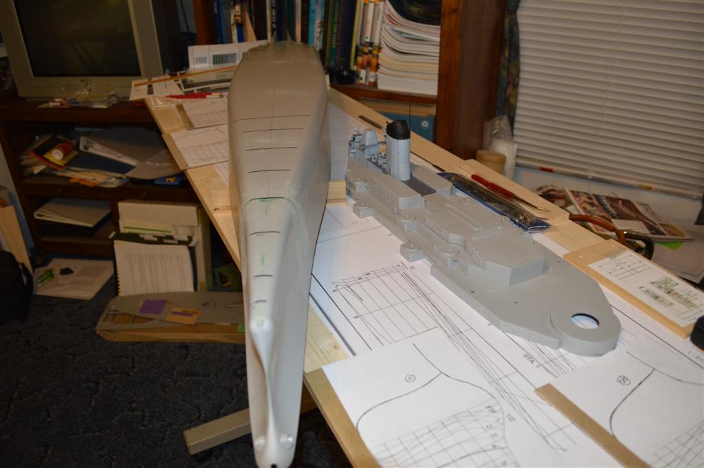

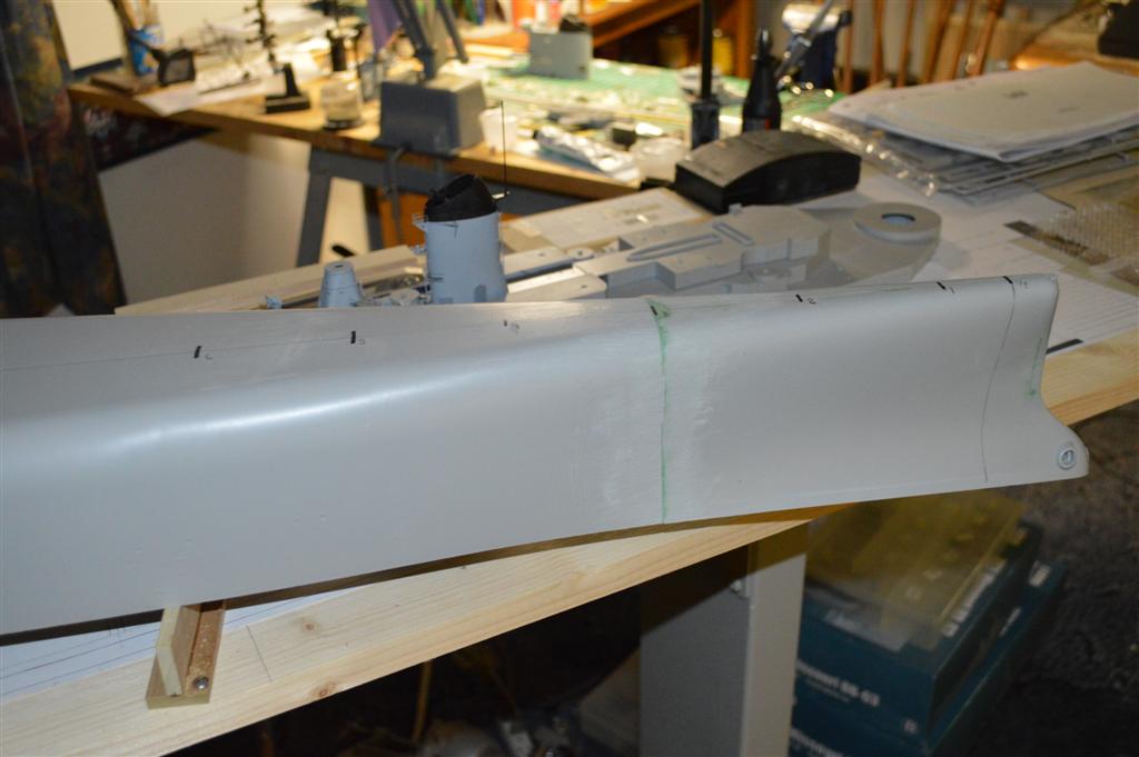

Then the stand was screwed into the work surface to hold it steady while working on the hull -
Last night I created the various templates to be used as station guides; tonight I'll cut them out to their proper shape -
So, once this is accomplished and the templates are located, I'll know where to add styrene and where the hull plastic needs to be filed away.
Note - still learniing the new camera - focus and various aspects of adjustment are in the early stages of this curve - apologies if they don't look just right :oops:
Posts: 5068
Re: 1:200 USS NEW JERSEY (BB-62) 68-69 (Trumpeter MISSOURI k
Post by Fliger747 »
Looks good Hank! A "helforstout". Arrangement, should allow the yard workers to carry out the necessary hydrodynamic modifications!
New camera looks as if it is doing a good job, at least you don't have to wait to get the pictures back to discover bloopers.

Post by Channell »
Alright, Hank!
Gotta say though, while the color matches the real deck piece well it just doesn't ring "right" in scale form to me... it seems a bit too dark in my opinion.
I've gotta rig up a similar rack for my Iowa; I don't want to crush my new hull rim accidentally. Thanks for the inspiration!

Post by Fliger747 »
A possibility to explore is to sand the deck with a fine paper to slightly but finely roughen the deck then seal with something like dullcoat, and possibly sand again with something like 600-1000 grit wet/dry paper.
Worth the experiment!

Post by BB62vet »
Tom, Jason -
Thanks for the positive reinforcement :lol_4:
The stand idea was sort of old school since I had something like that for each of my models for doing hull work. Besides, I needed something to hold it in place during the rebuild.
I understand what you're saying about the color, Jason - I think if I stain the decking and wipe as much OFF yet leave a uniform coat, it will color it and at the same time be light enough to give the scale effect you are talking about. Hence, the reason for doing this to a NON-part piece first to see the results.

Post by BB62vet »
After careful examination of the decking, I've concluded that Jason has a valid point in his remark about the color and scale factor. Since my color coupons for testing were taken from areas of the decking that were NOT scribed, they are lighter in appreance (and yellower) than the decking itself. So, I have decided to finish the decking only, no stain. This should still give the decks an overall good appearance, although not a match for the actual teak plug I have on hand.

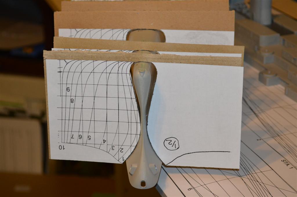

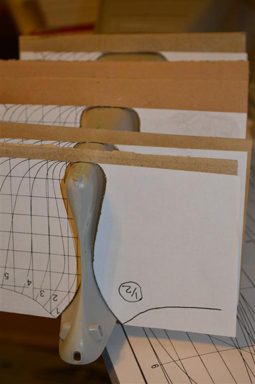

Bow Area Hull Modificaitons:
Last night I cut out the various templates that I'll use for reshaping the lower bow area and the following photos show how they look when placed approximately where they would be located:
As you can see they show the amount of plastic that will need to be added to fill out the bulb properly as well as the plastic that needs to be removed around the middle area of the sides in order to allow the templates to fit properly. I didn't want to bend the out of shape, so that's why they sit askew.
Posts: 5068
Post by Fliger747 »
I wonder if the areas that need to be pinched in could be clamped or have very small bolts/screws inleted to suck the pieces together? Or clamp and fill with epoxy?
Just ideas!
Tom

Post by Channell »
You really went the extra mile on your templates, Hank.
That's what I love about your work... so neat, orderly and clean. I usually can't resist doing stuff all over the place and end up making a big mess, then spend forever cleaning it up. You've taught me a thing or two already and I anxious for more. Good Job! :thumbs_up_1:

Post by BB62vet »
Oh, Jason :doh_1: If you could only see the living room/2nd bedroom/3rd bedroom (my spreadout workshop) in the rented mobile home I stay in during the work week!!! :big_eyes: you would have second thoughts about "neatness". :faint: But - I do appreciate the nice comments! I may have to order a tee shirt that says Nautical Pig Pen on Board
The templates are a bit fragile, so until I remove the middle plastic, I can't place them correctly on the hull. I've got one small tube of the Green Stuff, not quit a full tube - think that will be enough, or should I get an order in for more? Any preferences on brand or color?
Tom - I don't think pinching or epoxy would work here - the only way is physical removal of the exterior plastic by filing, sanding, scraping, etc. I may attempt to use a drum sanding attachment on one of my Dremel tools and see if I can't remove it that way as a start.
Posts: 5068
Post by Fliger747 »
Good luck with the drum sanding. Biggest issue I have had with sanding plastic is the heat trying to melt the plastic. Even cutting thick plastic or plexi on the scroll or band saw requires a low speed. I wonder if one of those fairly coarse sanding drums, a large one, such as one could chuck in a variable speed drill might be good? Not easy as you are sanding on the inside of a double compound concave curve.
I am sure that whatever method you choose it will turn out OK in the end...
Regards. Tom
BB62vet
Posts: 3162
Location: Mocksville, NC
Post by BB62vet »
Tom,
Thanks for the advice, etc. - yea, it's not a real simple task. I've thought of perhaps asking my modeler/machinist friend to make a s/s (stainless steel) scraper for me and I would provide him the curved profile of the blade - or I could try this myself; I do have a good elec. grinder in my workshop here at home. I'm thinking that the possible metal piece to use might be the shim from an old plane and simply grind the curve first and then grind a sharp bevel to one side. If the curve matches the pattern on the template, then it should be easier to scrape with, wouldn't you think?
Of course, I don't have an old plane I'm willing to part with - perhaps a visit to the local cheapo tools place would have something that could be modified at a really insane low price.
Posts: 5068
Post by Fliger747 »
I believe there are cabinet scrapers available with a varying curve, one would just need to apply the right part of the curve? I am not sure how much plastic one can remove this way. Certainly your hold down system would be necessary. A curved surface sanding block might be useful as well.
Looking fwd to the progress! Tom
