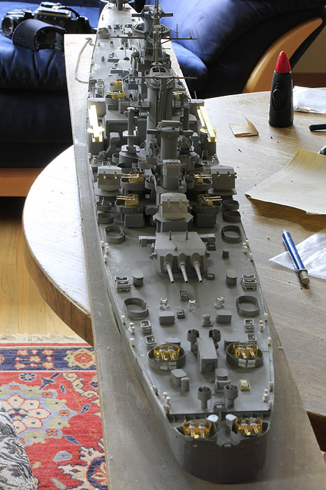

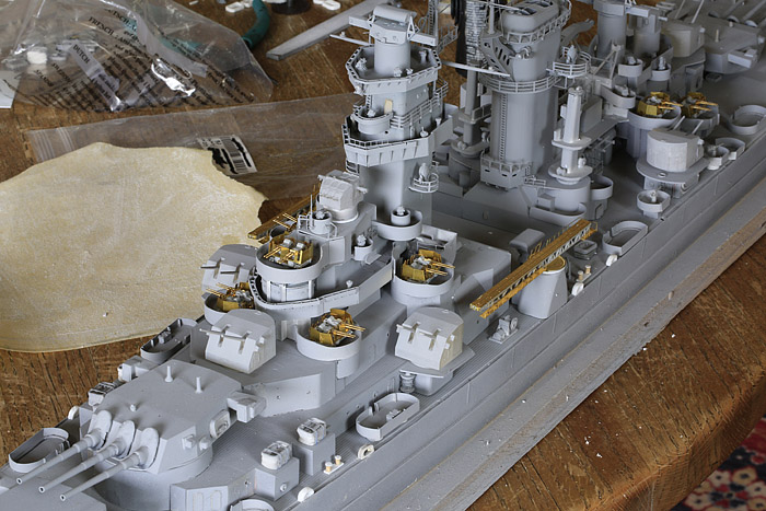

- Posts: 5068
Re: 1/200 Scale Group Build 2015
Current progress with 40 mm and start of catapult construction.

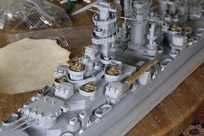

- Posts: 5068
Photo using photo stacking to increase depth of field.
- BB62vet
- Posts: 3174
- Location: Mocksville, NC
Tom,
Excellent work - The PE adds another dimension. Thanks for sharing!!
- Mgunns
- Posts: 674
- Joined: Mon Oct 13, 2014 5:39 pm
- Location: San Tan Valley Arizona
Starting to look busy with the addition of the PE. This is really coming along nicely.
Mark

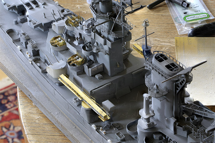

- Posts: 5068
Many thanks to Hank for making available unused PE and parts from his ongoing (and excellent) NJ. After doing the catapults I am rather amazed at the engineering that went into the PONTOS materials. Very impressed with Mr Kim and Co. I think that the Veteran 40 mm quads are probably better, no fault of PONTOS, as they are adapting to the kit parts and they come out pretty well.
The radars will be another challenge, as well as the 30 20mm mounts, which are rather amazing tour de forces of minimal sized parts!
I replaced as many of the MK 51 directors as possible, a few flew off to who knows where. That necessitated removing the existing scratch ones, which sometimes required a rebuild of it's tub due to accelerated depreciation. Re built parts of the bow 40 mm tub and director as well. I would like to build the pipe rail covers for the main deck hatch way awnings. An easy item if in the PONTOS PE mode, perhaps a bit more interesting to scratch in some quantity for scratch made hatch coamings which might vary in size slightly.
Not looking forward to modifying the stack top, which i liked, but is wrong. Any thoughts on two and three pipe rail? I used Tom's on the Missouri, but it is in my mind over fine and fragile. Brass is too soft. Might consider tempering it?
- BB62vet
- Posts: 3174
Tom wrote:
Why not very small dia. brass rod (K & S comes to mind) - something like 1/64" dia. or less (if it's available - I haven't checked lately - Hobbylinc usually has a large assortment of K&S metals). The rods can be shaped and (silver) soldered as needed and then sprayed to suit.
edited - 10am
Tom,I would like to build the pipe rail covers for the main deck hatch way awnings. An easy item if in the PONTOS PE mode, perhaps a bit more interesting to scratch in some quantity for scratch made hatch coamings which might vary in size slightly
edited - 10am
tegunn
- Posts: 338
- Joined: Tue Jul 28, 2009 1:47 pm
- Location: Texas
You might have to make a jig for your framework on top of the funnel. Build a frame out of basswood and fasten wire pins in it at the grid spacing . Thread around these pins and then solder/CA it at the connecting points. If it's the double footrailing around the funnel, take a look at 1/700 scale railing...

- Posts: 5068
The larger issue with the funnel cap is the shape, sort of a double scallop, but is currently straight. As the funnel is laminated from plexiglass and sanded to external shape, the top can be reshaped at some peril. A lot of the superstructure has a base of 1/8" plexiglass, hell for stout and an inexpensive material, which can be sanded to rounded contours, if not easily.

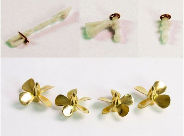

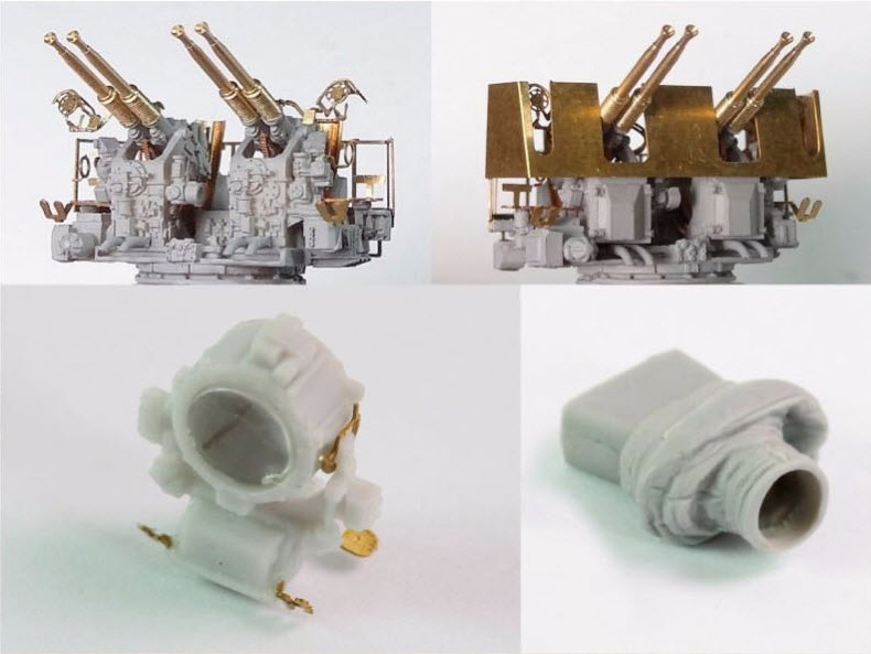

- steinerman
- Posts: 489
I may as well join this thread too!
Howdy, Peoples,
I've already got a build thread going in the "Work in Progress" forum, but since I ordered my "Monster Mo" today, I guess that makes me a committed member of the 1:200 Scale Club - and eligible to participate in this "Oh-so-Holy" thread with the rest of you crazies. (Oops, did I say that?)
What did I order? The whole enchilada:
Trumpeter 1/200 USS Missouri Kit: Ordered - Due to be shipped week of Sept 9
Pontos 1/200 USS Missouri 1945 Detail Kit: Ordered - Due to be shipped Sept 15 - 25
Pontos 1/200 USS Missouri Advanced Detail Kit: Ordered - Due to be shipped Sept 15 - 25
Now, as if I didn't already spend enough $$$, I have a question:
Does anyone know if Randy M from San Diego still hangs around here? The last post I see from him was back in June. What I want to know is he still taking orders for his reworked stern section of this kit and if so, what's the cost and lead time? Not too sure if I'll get it or not, seeing as how the Wifey isn't too happy with me right now. I would like the hull to be correct, but of it isn't, I guess I can live with it. People who see the finished model won't know if the bottom is the right shape or not. Hell, my bottom's been out of shape for years and nobody's said too many bad things about it!
Anywho, I'll let you guys know when I get my goodies. And, by the way, I can't remember who it was in the Calling All Iowa Class Battleships thread that was waiting forever on 0.3mm drill bits, but Amazon sells them from several different suppliers. I bought 2 packs of 10 for $5.25 each with delivery the 1st of October.
Later, fellas, Have a pleasant night and a great day tomorrow. It's supposed to be 90 and muggy here in GR tomorrow. Thank Heaven for A/C!
Larry Steiner
tegunn
- Posts: 338
- Location: Texas
Check out the Albion/Connecto stuff. Not sure it measures out to what you need but good to know of the source for the future..RandyBB62vet wrote:Tom wrote:Tom,I would like to build the pipe rail covers for the main deck hatch way awnings. An easy item if in the PONTOS PE mode, perhaps a bit more interesting to scratch in some quantity for scratch made hatch coamings which might vary in size slightly
edited - 10am
http://www.uschivdr.com/shopping-catego ... es-tubing/
Future Project: TBD
Future Project: TBD
- BB62vet
- Posts: 3174
Steiner wrote:
FYI - the shape of your bottom is a bit TOO MUCH INFO at this point
I would suggest you get a copy of Floating Drydock's MISSOURI Plan Book (or EPlan Book) as it's a very big asset in building the model.
I'm sort of surprised you bought both of the Pontos detail sets - please correct me if I'm wrong, but isn't the Advanced Detail Set simply additional parts included with the normal Detail Set?
Larry - I'm not speaking FOR RandyM, but I think I can safely say that he is NOT taking orders for his hull mod. I have been in touch w/him since that time and various factors have contributed to his not being able to produce any of those parts (time/cost of mat'ls/availability of printer); I'm unhappy, but moving on with my own modification plan. I think RM still peruses the forum from time to time, but his comment to me regarding his work is that he's pretty much on the go and modeling has taken a back seat right now. Life seems to always get in the way of our hobbiesDoes anyone know if Randy M from San Diego still hangs around here? The last post I see from him was back in June. What I want to know is he still taking orders for his reworked stern section of this kit and if so, what's the cost and lead time? Not too sure if I'll get it or not, seeing as how the Wifey isn't too happy with me right now. I would like the hull to be correct, but of it isn't, I guess I can live with it. People who see the finished model won't know if the bottom is the right shape or not. Hell, my bottom's been out of shape for years and nobody's said too many bad things about it!
- steinerman
- Posts: 489
Hi Hank,
Thanks for the update regarding Randy. Too bad on that deal, but I can fully understand. I was an engineer for 47 years myself and when the crap hits the fan, guess who has to fix it!
Yes, the Floating Drydock plans are on my list - probably next week or so, along with their 3D anchor chain.
As for the Pontos advanced detail kit, it contains 4 brass screws, 5 glass lenses for the searchlights, better blast bags, and quite a few other items that aren't in the original set. Mainly, it contains much better detailed 40mm quad Bofors guns from VeternModels. As soon as I get all this stuff, I'll post some pictures. Here are some pics from Ebay:
Now, I just have to figure out what to do about the hull bottom.........................
