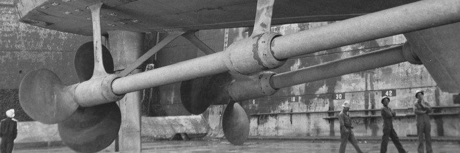

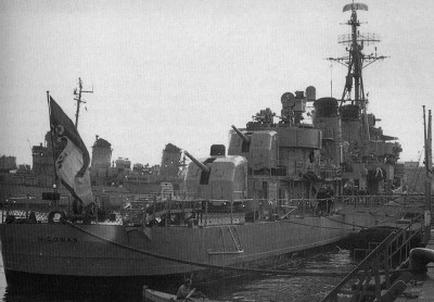

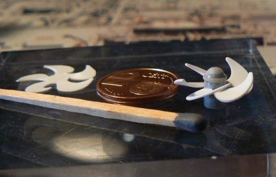

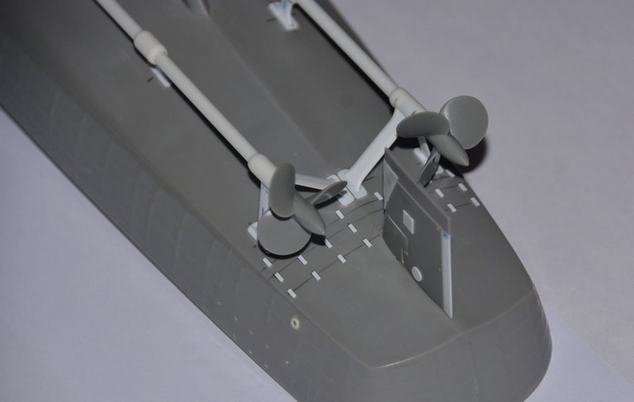

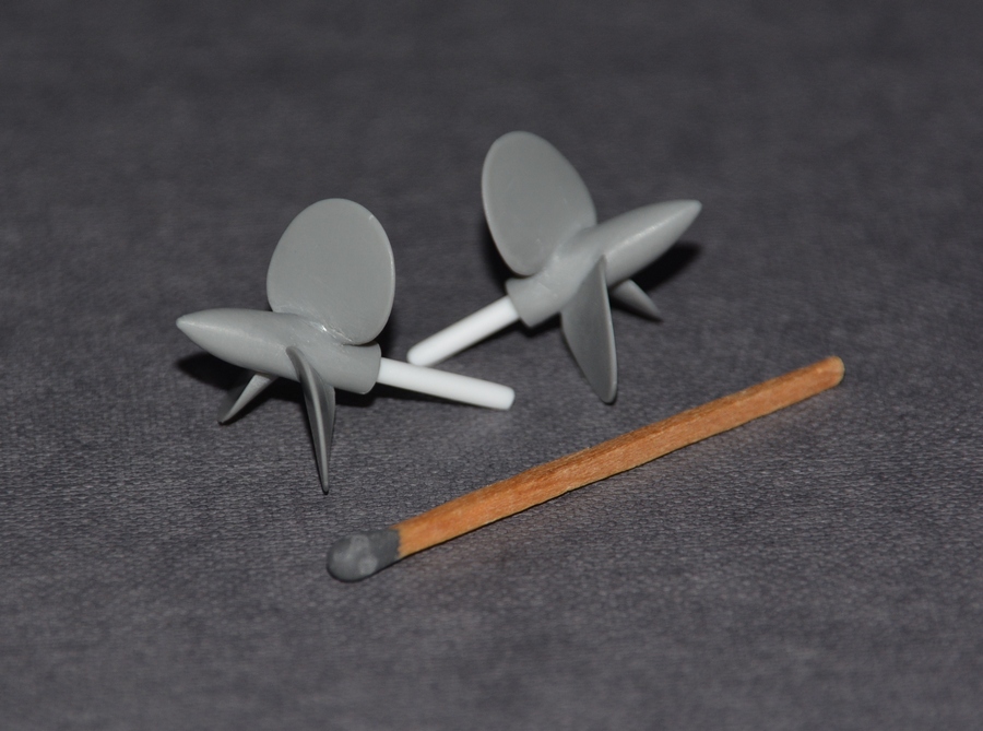

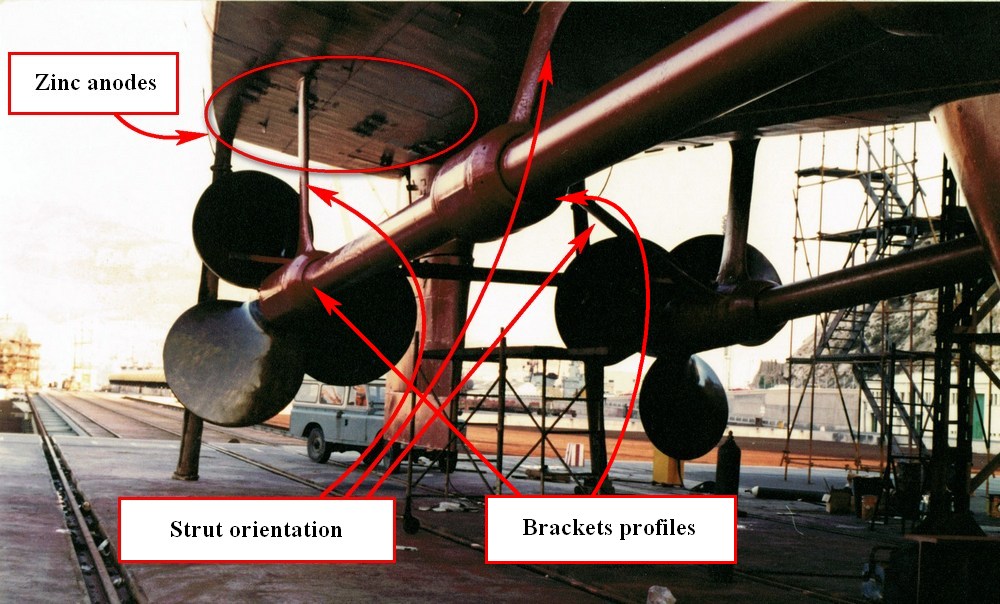

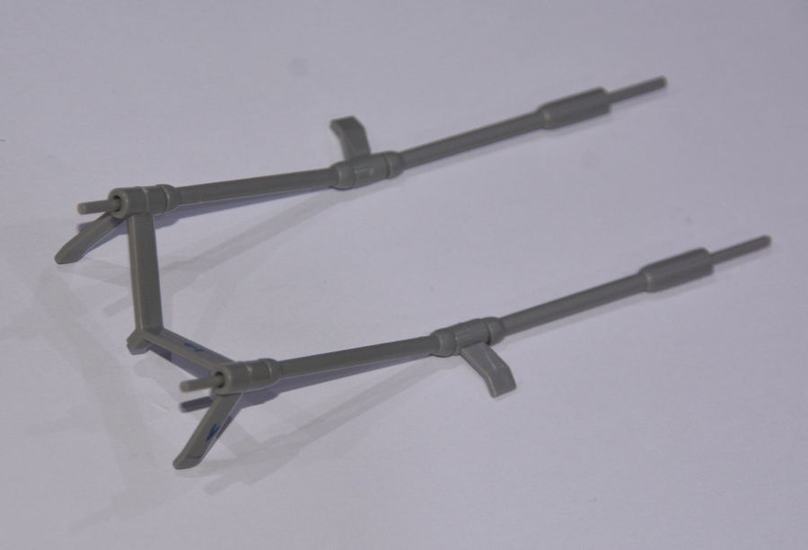

To advance this area I have devoted this week to the shafts and props, something always very interesting to build.

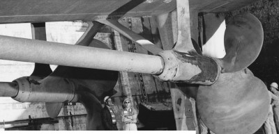

This is what has to be done : Again one of the two pics that I have of Jorge Juan has helped me lots, as it shows several elements that confirm the previous pics : Revell�s offer is not correct at all, both in thickness of the shafts, profile of the struts and some other minor details. I considered improving all these elements, but after some attempts to thin the profile of the struts I dropped the job completely, as it would take longer and would not be better than making everything from scratch, that is what I eventually did.
On the other hand the props are quite nice in shape and specially in the profile of the blades, but sadly the middle section also had three deep cuts just between the blades due to the molding process. Anyhow, as I am not very willing to spends lots of money in aftermarket stuff I had a go with them, and after some (well, much) filing and sanding, I think I can consider them acceptable for service. Over to the next post.[/size]
Glad to know you like the progress.
- Willie
- Posts: 690
- Location: Vigo, Spain

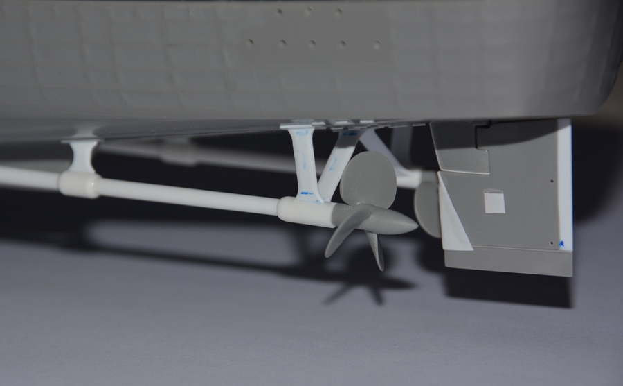

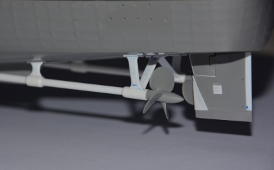

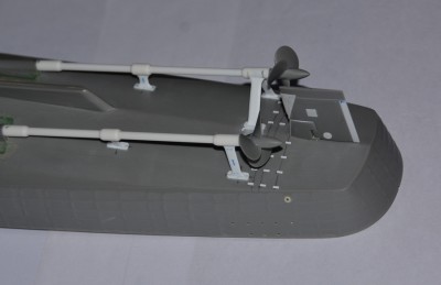

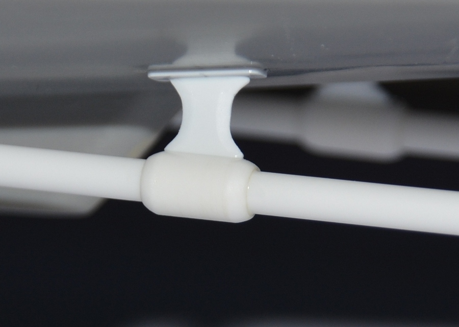

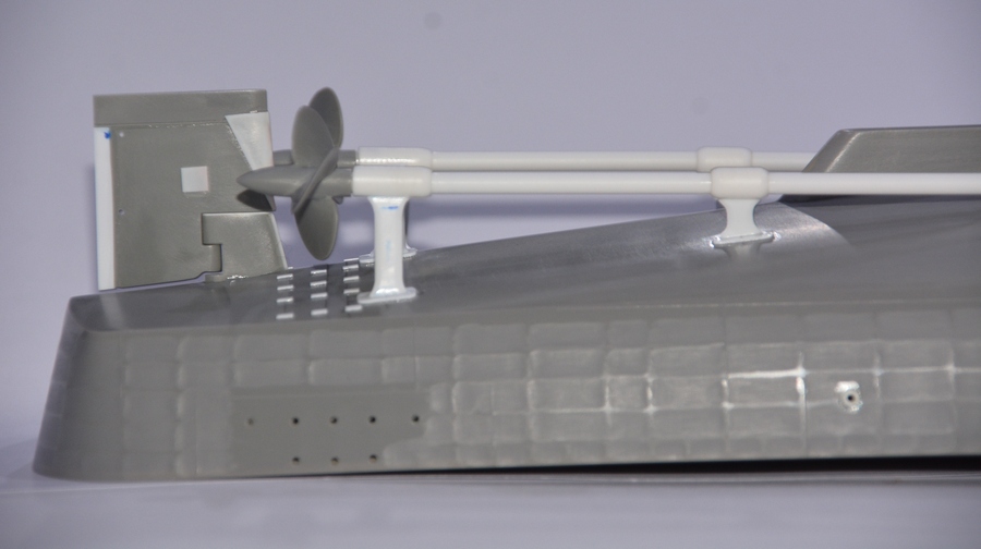

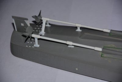

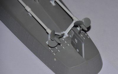

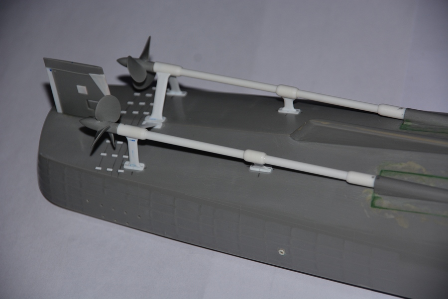

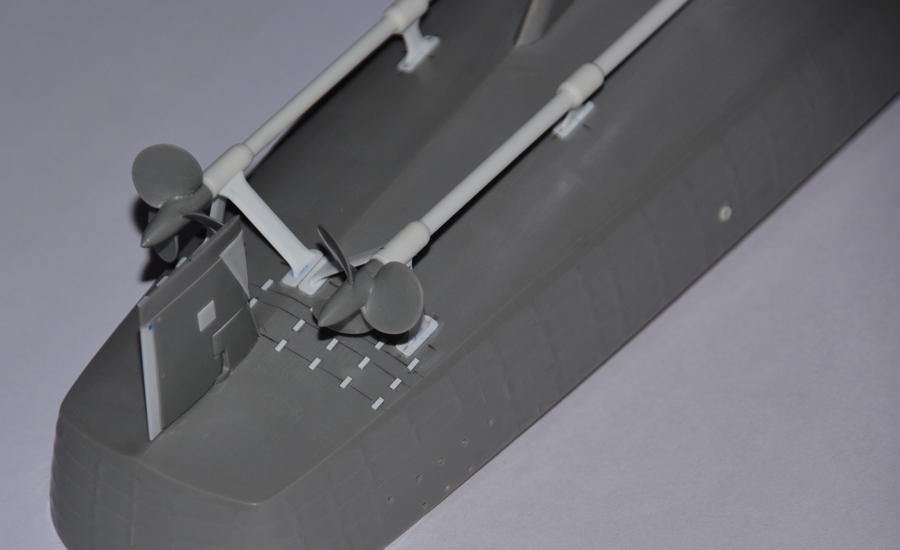

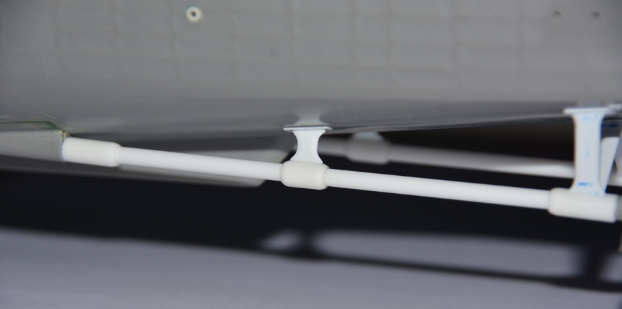

After this I made the two shafts, the six brackets and the six struts.
As all Evergreen tubing profiles are telescopic to each other, the shafts and brackets were no problem at all.
The struts were made with 1,00x6.3 mm. Evergreen stripe, so that they are identical in width and thickness. The longer ones were very easy to make and handle, but very difficult to refine, as they are placed at four different angles each, to undo the curves and profile of the hull, keeping the shafts at the correct angle and parallel to each other, which is the real problem, and, on top of it, everything had to be done with a dry fit for the most part. Really a pain. The smaller struts have only two angles, and were easier to place, but much more difficult to make, because it is necessary to handle them with the very tips of the fingers to be able to apply the sandpaper properly at the right angles. I think that more or less I have them, and the thing is solid to allow further work in the hull, consistent with the pictures, and keeping the shafts absolutely parallel. As a last touch, I also added the zinc anodes, an easy element that adds a very beautiful detail to a section of the hull that would be otherwise quite bare. And the final product in its real position: the macro pictures shows some minor details that have to be refined, but this section is coming out quite nicely.
I hope you like it, and very bets regards,
Willie.[/size]
Willie.[/size]

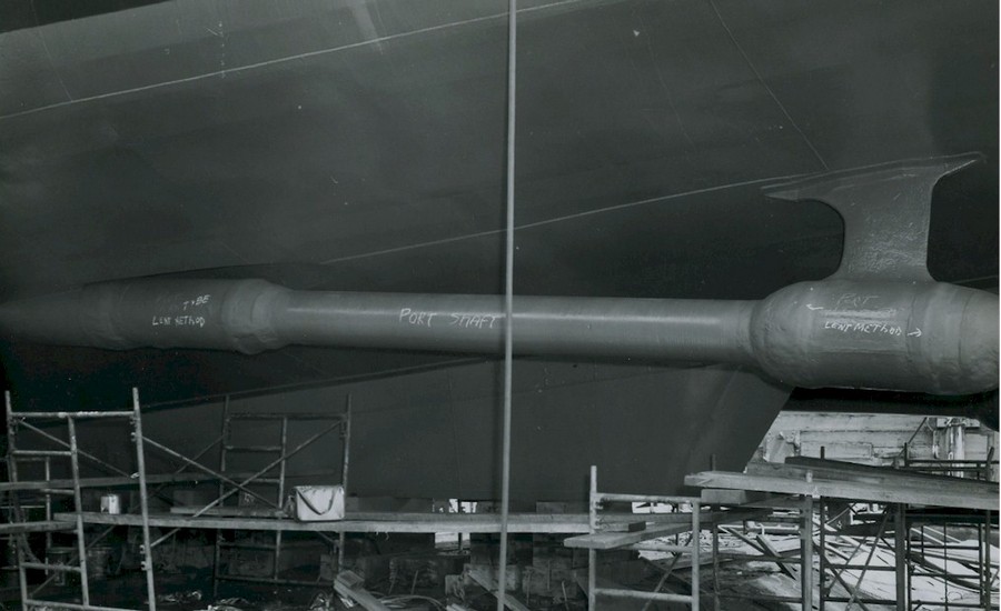

- Posts: 5068

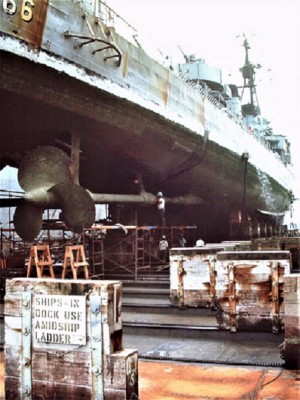

Very nice Willie! I noticed one unusual feature in your dry dock photos, the aft nominally vertical strut has a curve at the bottom to intersect the shaft bearing at right angles. Just curious as I haven't examined the Fletcher appropriate drawings, are the shafts indeed parallel? Sometimes for whatever marine engineering reasons, shafts will be at a horizontal angle to the centerline. In Battleships this can be due to space limitations from the side protective system or other necessities such as machinery arrangement.

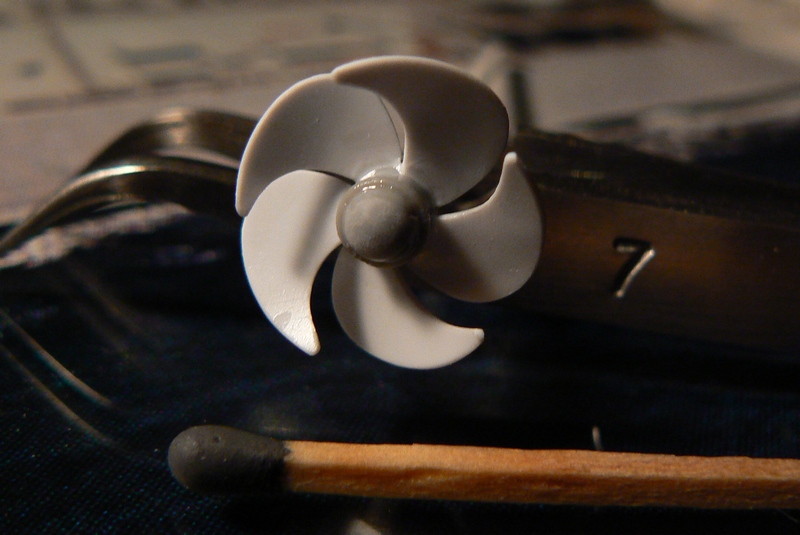

Have you found a decent realistic coating for plastic props (the brass ones nice, expensive and well, brass). I made one decently for the APA but it took four tries... And I only had to make one. I might try printing one for my next project. It's great that you were able to find enough photos to get this area correct! The business end of a very powerful ship which has more space devoted to engineering than any other!

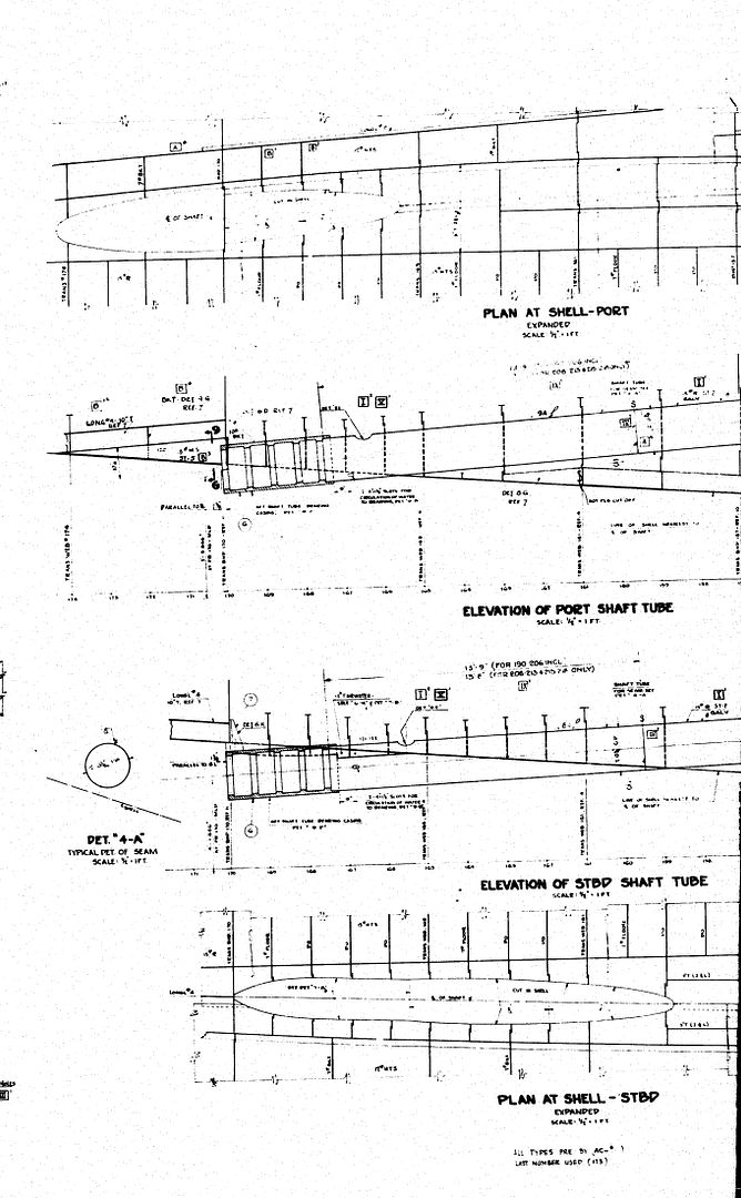

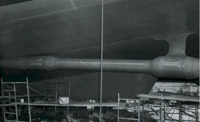

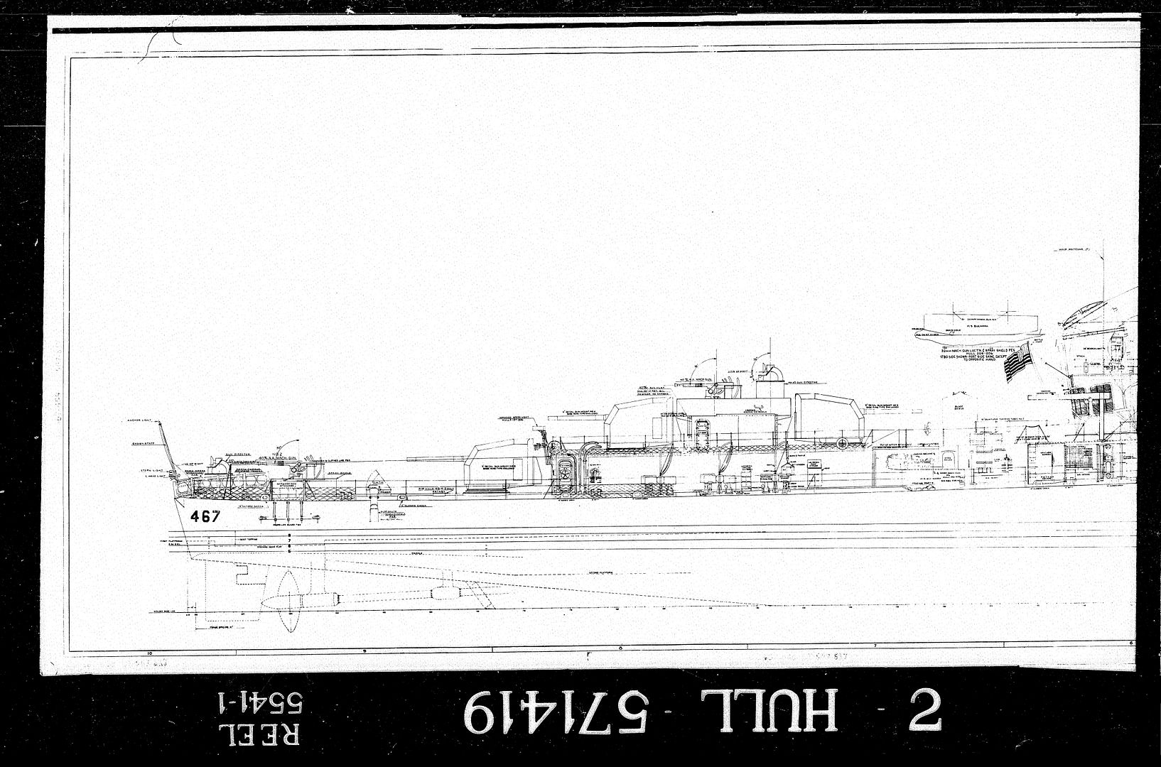

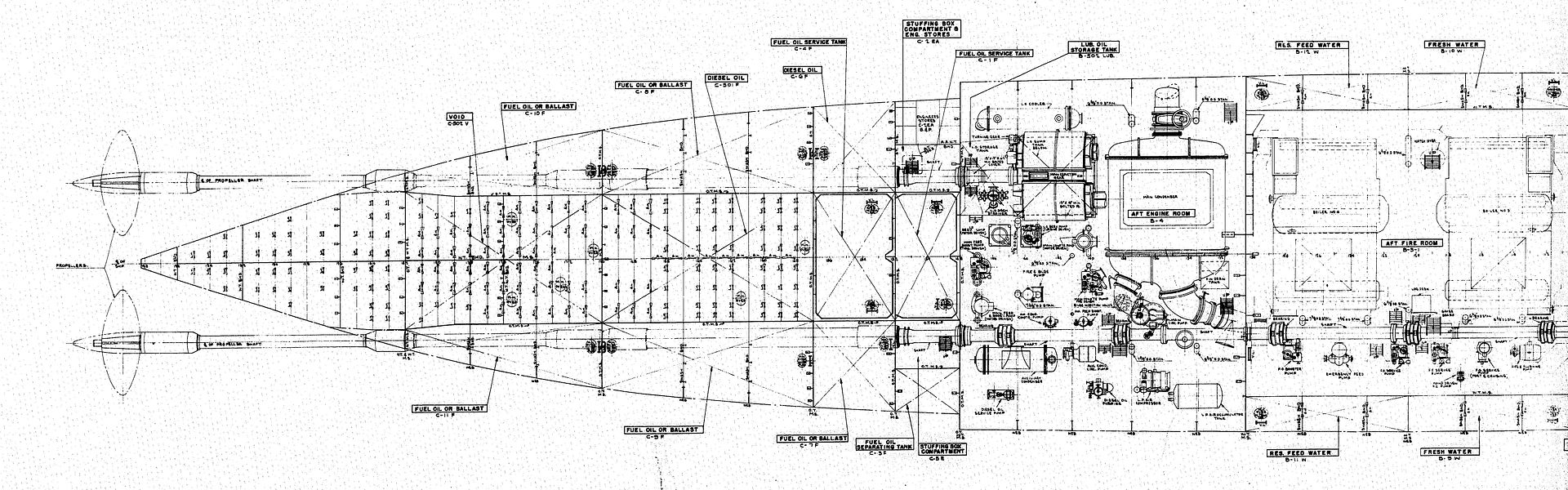

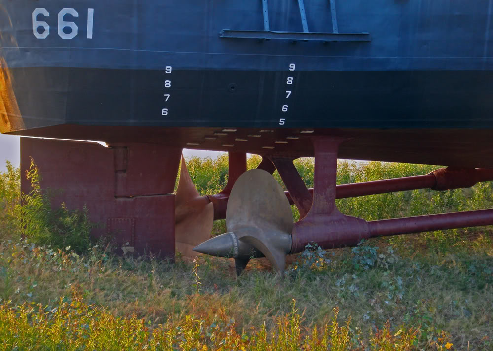

I posted these somewhere back in September 2020 about basically the same topic, from the BIW FLETCHER Class Engineering Drawings DVD.
The total length of the shafts from the steam turbines/gears to the props are different and exit at a slightly different place than the other, but are basically approximately parallel to each other.
An aside; The alignment of these shafts was tricky. In going through every FLETCHER BuShips file, it seemed like something like one out of ten or twelve units built had vibration problems due to mis-alignment and required a return to the yard to correct.

Willie,
Very nice work on the struts/shafts/screws, etc. You, of course, keep raising the bar on this so I'm probably going to follow suit. I don't really like the sloppiness of the kit parts and I think Evergreen styrene rods, etc. will work fine as replacements. I too, will use the kit props after doctoring the various surfaces you mentioned.
As for your zinc anode plates (coupons) - what are the sizes you came up with? I have left-over coupons from the NEW JERSEY build that I designed and had printed as PE and I think they may work for this model, as well. Difference in scales, but also difference in coupon sizes, also.
Rick - appreciate you posting these drawings again - Murphy's Law at work on FLETCHER construction, right?

Indeed vibration at speed was significant in my ancient recollections, at least on the fantail. The drawings, if not distorted as measured on the screen do show a slight divergence in the horizontal plane, though not enough to be noticed on a model. As RED mentions, the shaft lengths are considerably different due to the longitudinal placement of the engine rooms. In a long narrow hull with shafting at some degree of vertical angle to the shafting this begins to have impact on the available arrangement of internal engine room components.
The AOE Sacramento used 1/2 of the power plant form one of the uncompleted Iowa's, that must have been an interesting design project to build around an existing power plant from a very different ship.
Willie's ship uses the three blade props, some (Stoddard?) used a four blade prop, did this reduce vibration? The North Carolina's and SODAK's required prop replacement due to vibration issues. Any info on the history on that?

Yes, it's amazing the design/construction information that comes about from a simple, little ship model!!
I think NORTH CAROLINA and SDAK classes did have vibration problems and whether or not they were solved by the end of their active careers, I don't know - NC did experience several design changes from keel laying to launching due to engineering mistakes made during design; whether this was addressed thru their various shipyard overhuals might be an interesting subject to look into.

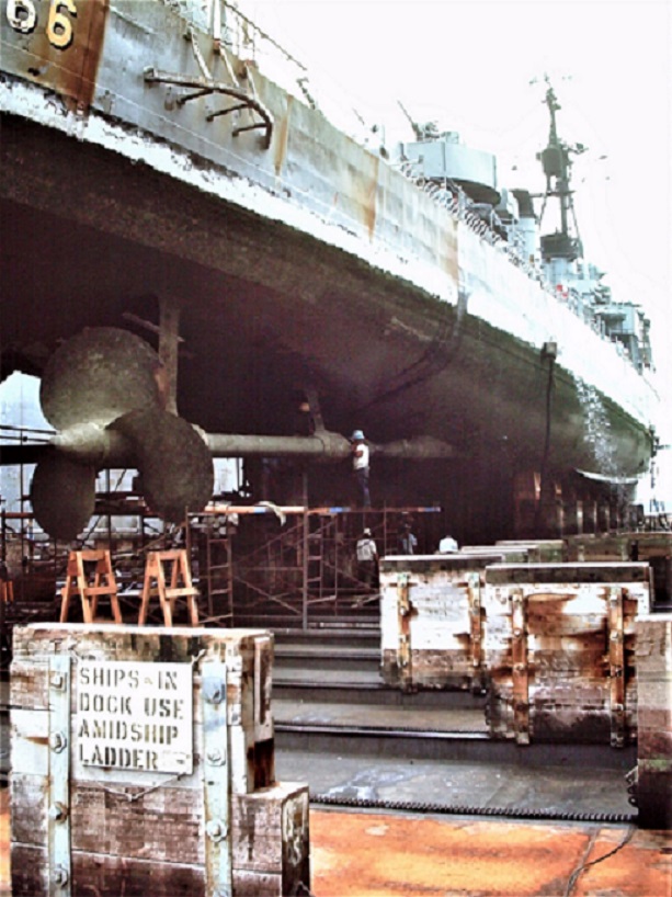

I also dispute the shafts being parallel to each other on FLETCHERs - the plan view RED posted above can clearly be seen to show the shafts slightly out of parallel. Interestingly enough, the IOWAs were also designed with out-of-parallel shafts as I recall.
Let me just reiterate that I'm no expert on nautical engineering, etc., and unlike politicians, can sometime s be wrong
Hope this helps!
Hope this helps!
- Willie
- Posts: 690
Hi there Tom, David, Mr. Davis, Hank and all,
Thanks a lot for your comments.

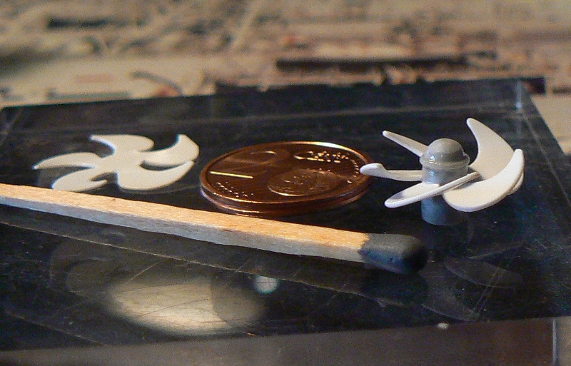

I have seen your prop at:
viewtopic.php?f=13&t=218743&start=120
Hats off to you, sir...
Even if I had three lives in a row before me I would never be able to do such a thing !!!!!

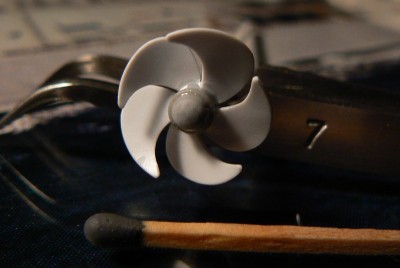

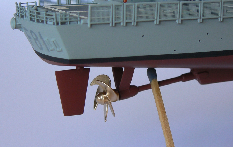

The only thing I have been able to produce in this direction is the screw for my FFG, in plastic, of course: It was not difficult to give some profile to the blades, and the final product was somehow hydrodynamic as well, as I could see when blowing gently: With the final metallic coat, it came out like this, IMO at least aceptable: [/size]
Very best regards from across the seas,
Willie.
I had noticed that, but apparently there are again variations in this element, and after studying the Jorge Juan dry dock pic I think my ship did not display this feature.Fliger747 wrote:I noticed one unusual feature in your dry dock photos, the aft nominally vertical strut has a curve at the bottom to intersect the shaft bearing at right angles.
I have no plans of the Fletcher class, and honestly I did not see that in the pics that I was dealing with, my mistake, but David�s and Mr. Davis�s observations seem to confirm that the deviation is virtually invisible, so I think my shafts can be given a passing grade, and therefore, thanks to David and Mr. Davis for their continuous interest and advice.Fliger747 wrote: Just curious as I haven't examined the Fletcher appropriate drawings, are the shafts indeed parallel? Sometimes for whatever marine engineering reasons, shafts will be at a horizontal angle to the centerline.
I use a metallic gold/bronze coat, applied in liberal quantities with a brush, so that the superficial tension makes curves and covers the filing and sanding marks.Fliger747 wrote:Have you found a decent realistic coating for plastic props (the brass ones nice, expensive and well, brass). I made one decently for the APA but it took four tries... And I only had to make one. I might try printing one for my next project.
Hank, I have again no idea of the original measures, so I followed the idea of this pic of USS Kidd, that confirmed the coupons pattern in Jorge Juan: I was using 0.4x0.75 mm. Evergreen stripe, in small sections of 2.5 mm., but as I say, this is only a guess. I would say that the effect is not bad, though, and can be considered realistic, that is the final goal of a model.[/size]BB62vet wrote:As for your zinc anode plates (coupons) - what are the sizes you came up with? I have left-over coupons from the NEW JERSEY build that I designed and had printed as PE and I think they may work for this model, as well. Difference in scales, but also difference in coupon sizes, also.
Very right. Mr. Davis, ditto: with the years Murphy has become such a close, recurrent friend of mine that I already invite him to my birthday parties.BB62vet wrote:Rick - appreciate you posting these drawings again - Murphy's Law at work on FLETCHER construction, right?

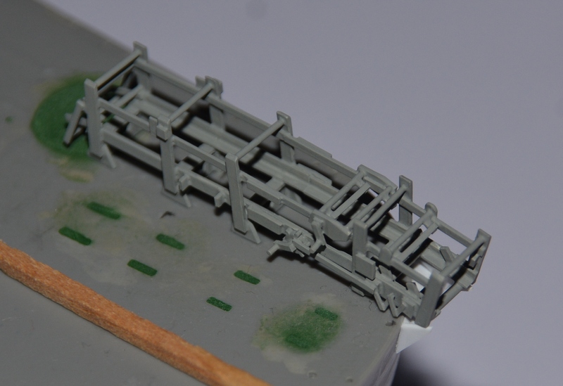

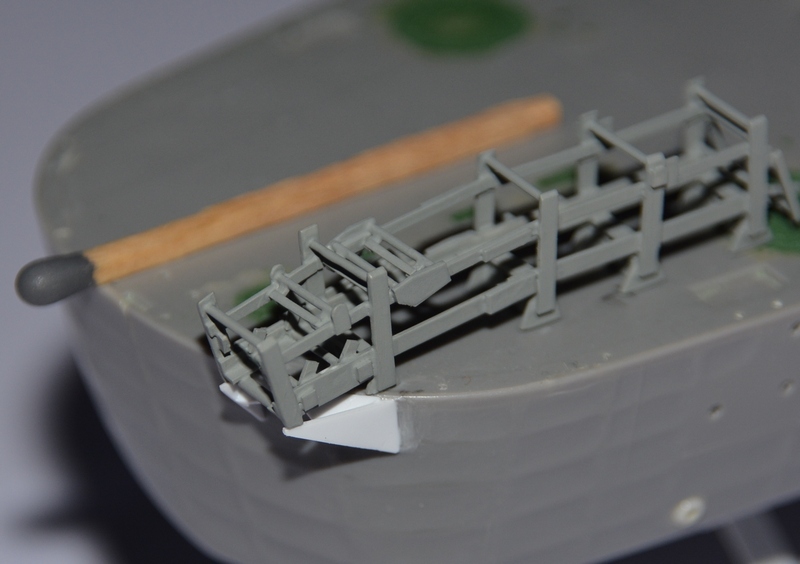

Hi all folks again.

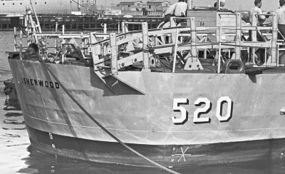

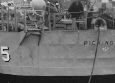

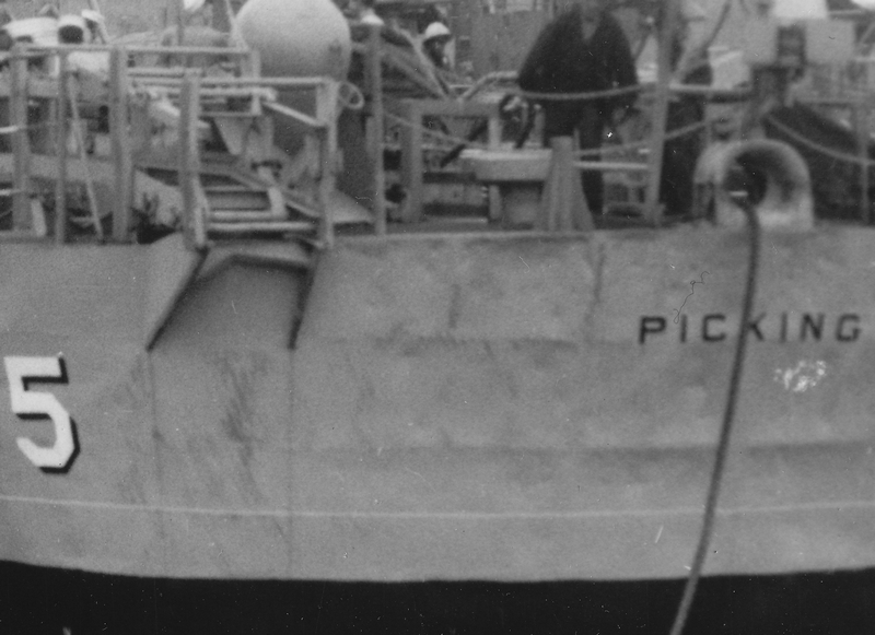

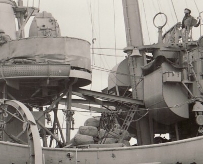

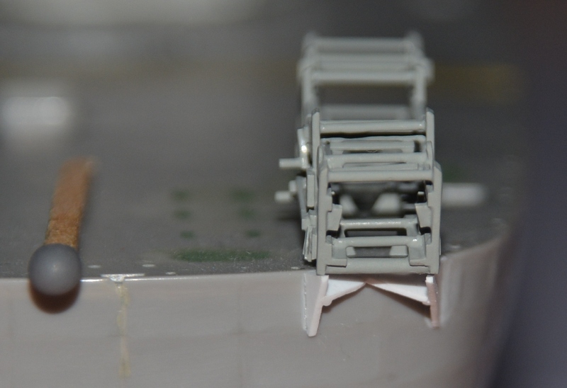

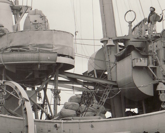

Back to the job, and still thinking about the blast bags, so in the meanwhile I have started some other easier elements, this time the off board depth charge rack supports.

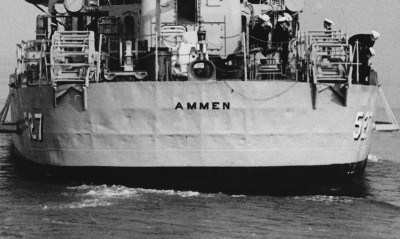

This is what has to be done, in the only specific picture that I have of this element on board Jorge Juan: Anyway, the pic is not very clear, but as this element is quite a common place among the Fletchers, it was not difficult to find something else.
This is USS Ammen: This, USS Picking: And this, USS Isherwood: With small variations, probably depending on which shipyard they were built, all these structures seem to have in common that they are not symmetrical, and that the inner plates are welded at a different height as well.
The construction was not difficult, but somehow tricky, as I had to adapt the bases of the triangles to the previous oil canning of the hull. It is now like this: With the rack on, the fit is good, and the effect is quite convincing: And that�s all for now. I hope you like it, and very best regards from this side,
Willie.[/size]
Willie.[/size]

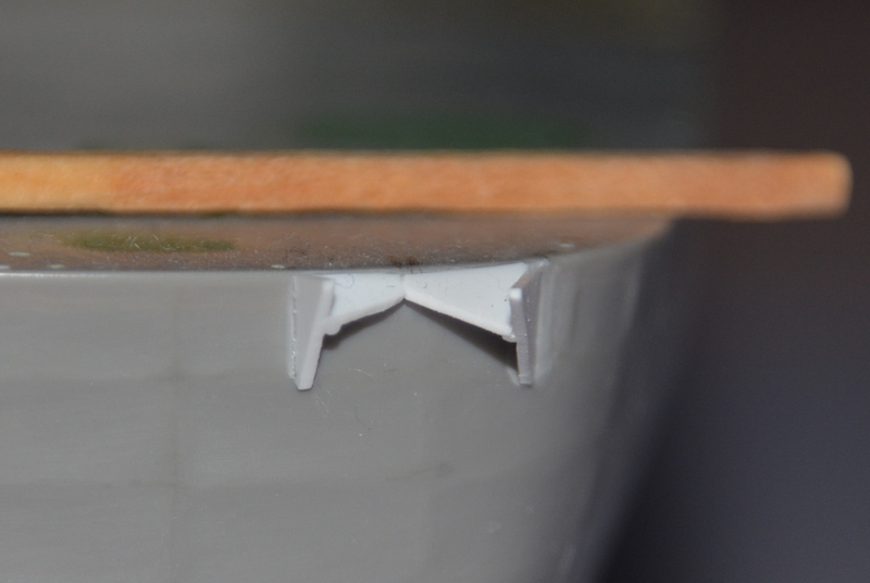

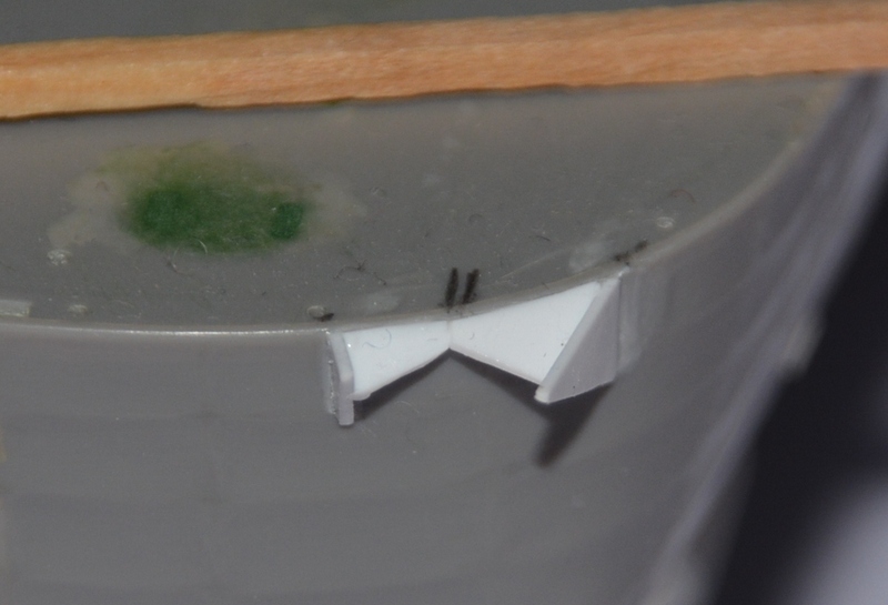

Hi all once again,
I have being reviewing some pics in the last days, and in the process I have realized something that I had not realized before. After all the fun with the oil canning, and all the discussions about where and where not involved, after I had already taken pains making and placing the shafts, look at this...: ...tell me what you see, tell me what I did that was so wrong in three previous lives, what horrible mistakes I have committed and what sins are hidden in my past to deserve this punishment
Hank, if you are seeing this, take your time with the shafts.
Nice going and all the best from this side,
Willie.
Willie.

Oil canning, lots of oil canning on the stern bottom, where apparently, after all the previous discussions and pictures last summer, there should have been none.BB62vet wrote:I'm not exactly sure what I've supposed to be looking at (or looking for) - ???? You will have to explain yourself in a bit more detail. The callout arrows point to what?
I mean that you should find out whether you should apply some of this to USS Stoddard�s hull, or not, before you build the shafts, as it would make things way more complicated, as my case now is.BB62vet wrote:I'm not sure what you are alluding to in your comments regarding the shafts.
Best regards from the other side,
Willie.
