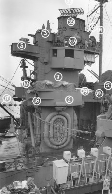

The booklet of general plans for the Pennsylvania in 1945 shows Mk-21 antenna on top of the director cabin on top of the fore tripod mast. Does anyone kno3 what Mk-21 antenna does and/or have a good picture of it?
Thanks

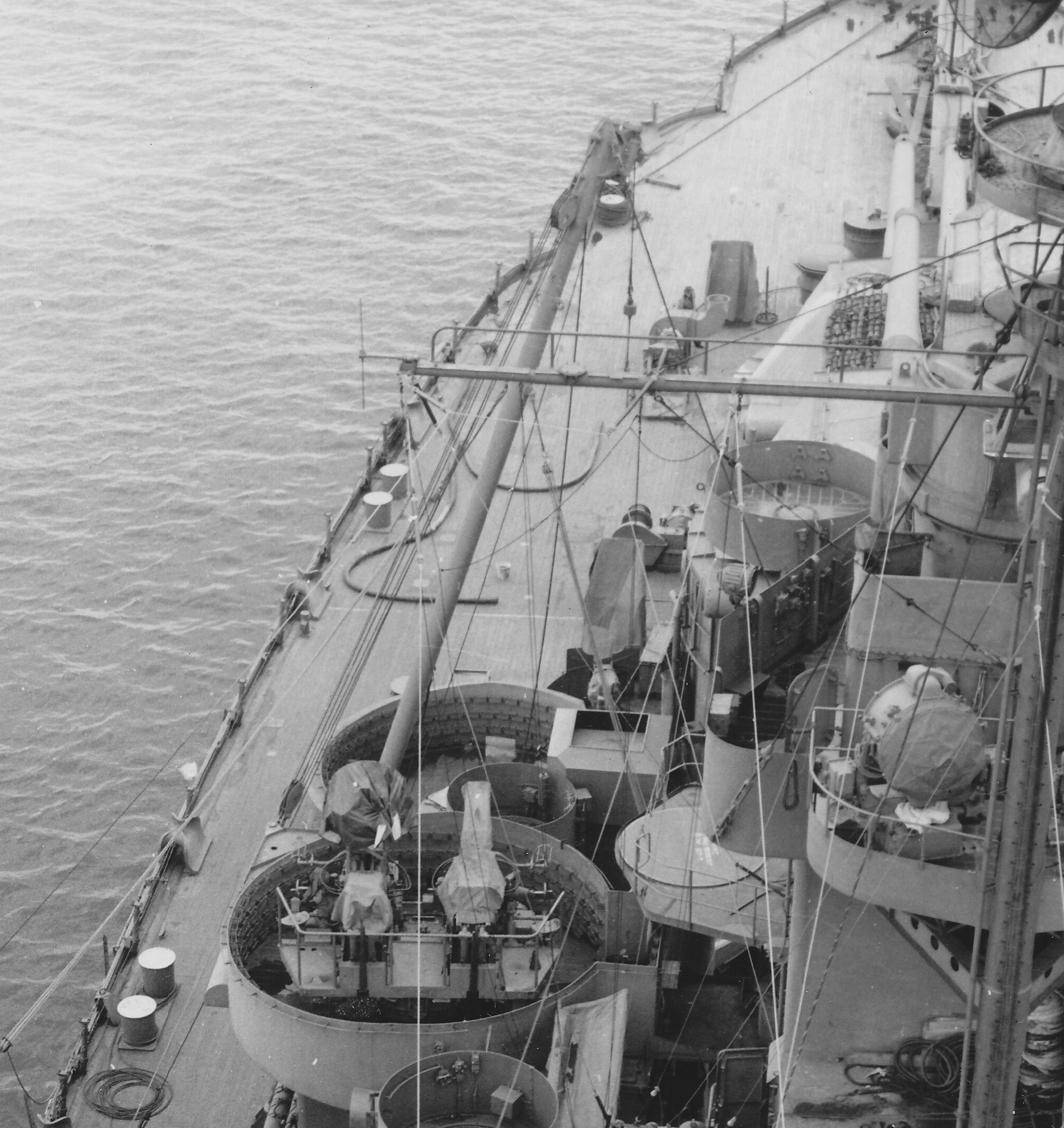

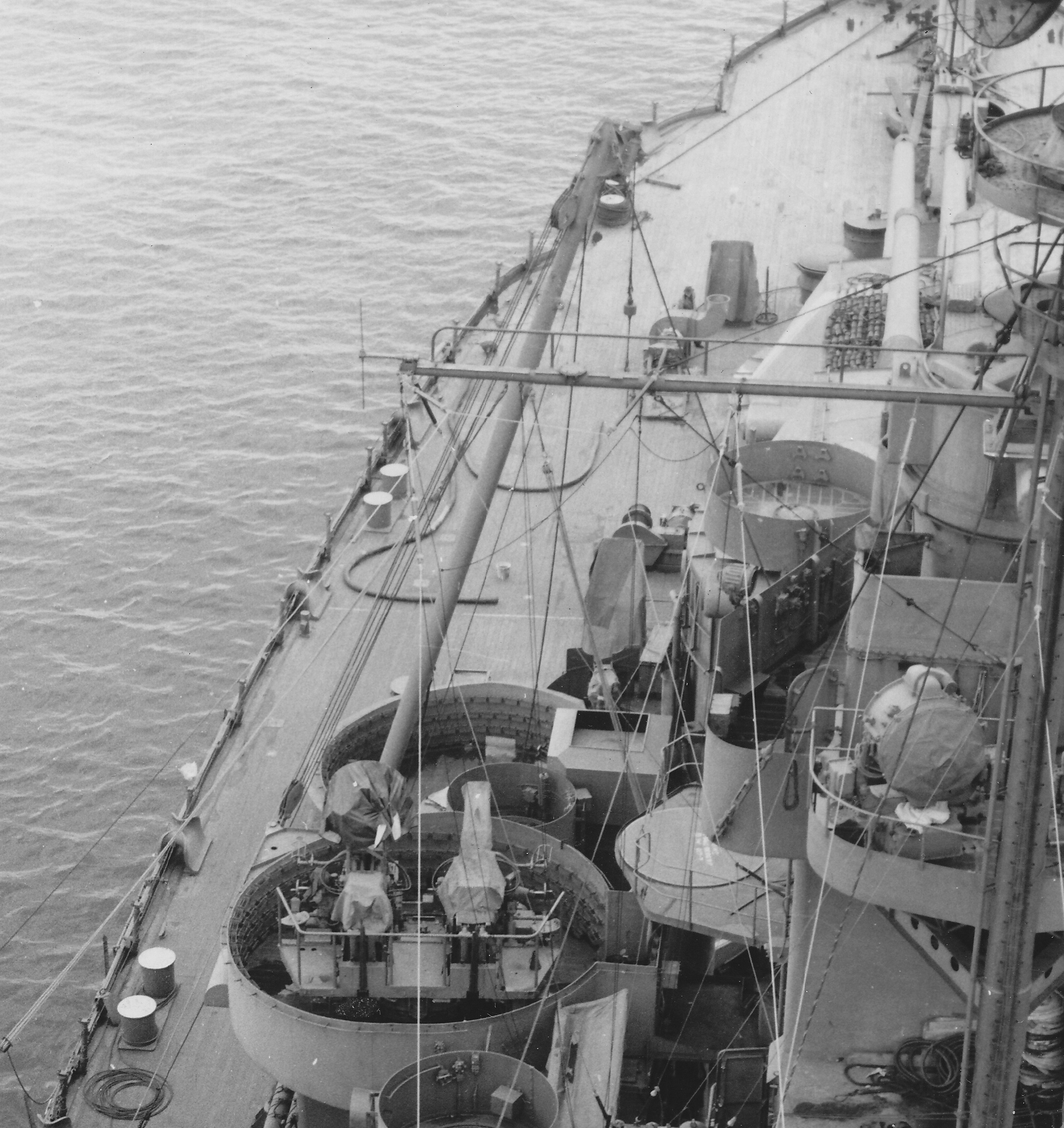

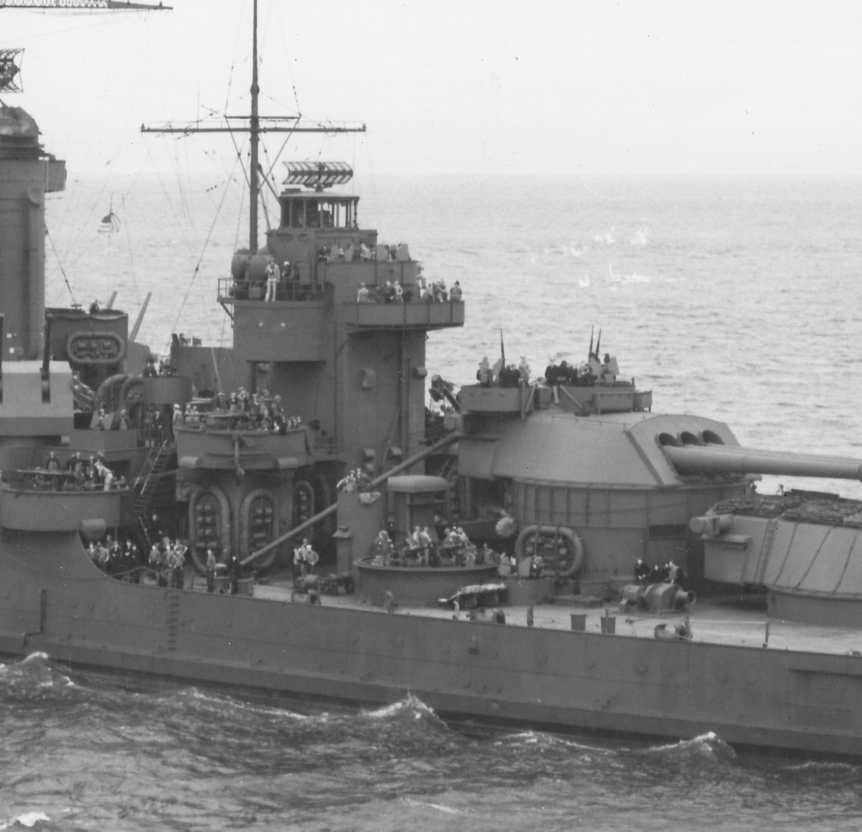

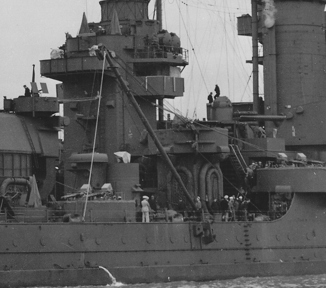

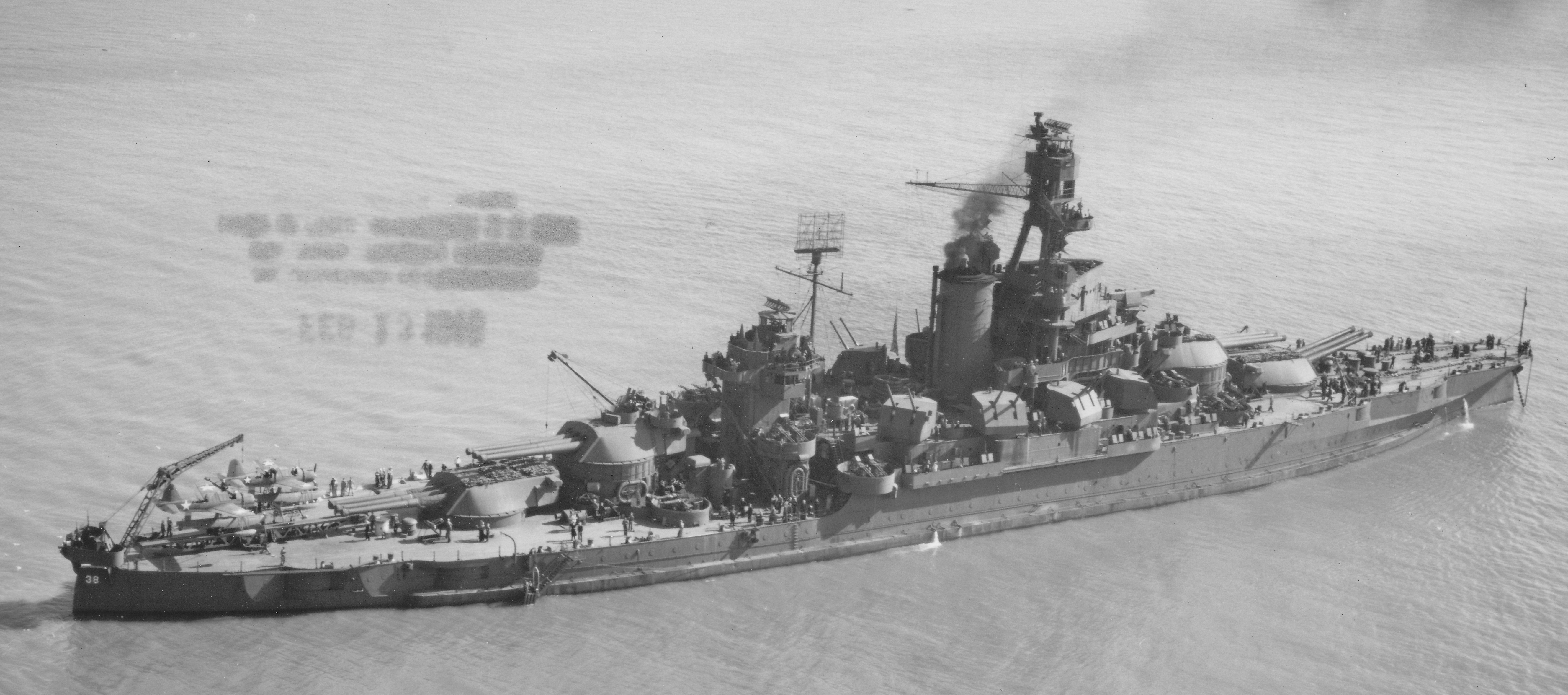

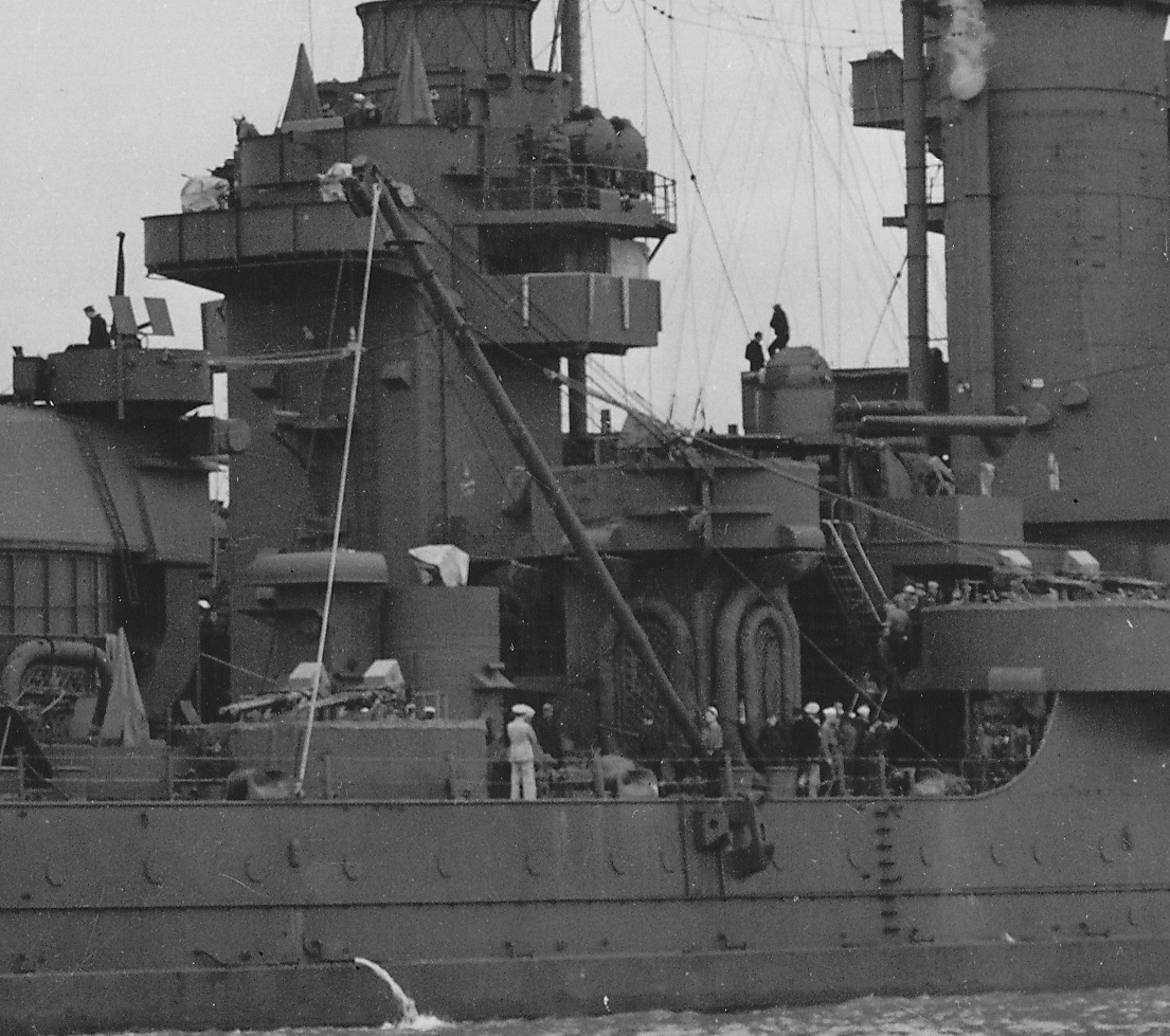

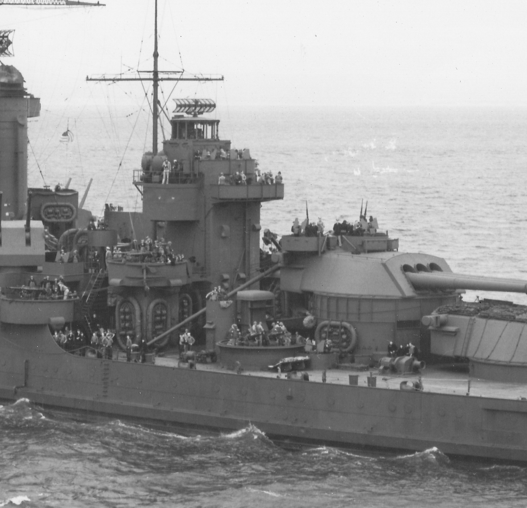

During 1942 Refit Pennsylvania�s prominent Midship boat cranes were removed and replaced by a pair of simple booms stepped behind the new aft superstructure to handle the remaining 26 foot whalers. Unlike the crane it replaced, it looks like the booms had no integral machinery whatsoever. It was simply a long tube pivoted on the deck at one end, and handed by tackles affixed to the other end. There seems to be tackles for raising and lowering the boom, swinging the boom, and raising the lowering the hoisting hook.
The tackles seems to not be permanently attached to any machinery either. They seem to normally be belayed somewhere. When they are used, they are either pulled by hand or are wrapped around a new Drum winch Installed ahead of the 40mm bofor tub.
Does anyone have photos of where these tackles are belayed to when stowed?
Also, I suspect the arrangement of tackles on the boom is largely standard. Is there any diagrams showing how such booms are typically rigged aboard WWII era USN ships?

I quoted my own message because in the original post, for some reason parts of the message I posed did not show up.chuck wrote:During 1942 Refit Pennsylvania�s prominent Midship boat cranes were removed and replaced by a pair of simple booms stepped behind the new aft superstructure to handle the remaining 26 foot whalers. Unlike the crane it replaced, it looks like the booms had no integral machinery whatsoever. It was simply a long tube pivoted on the deck at one end, and handed by tackles affixed to the other end. There seems to be tackles for raising and lowering the boom, swinging the boom, and raising the lowering the hoisting hook.

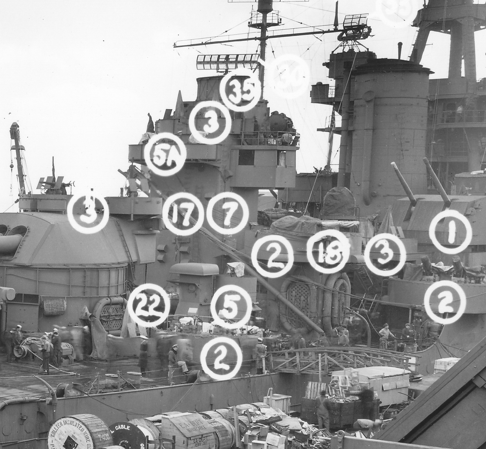

Re: Calling all USS Pennsylvania BB-38 Fans

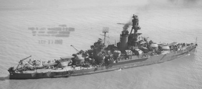

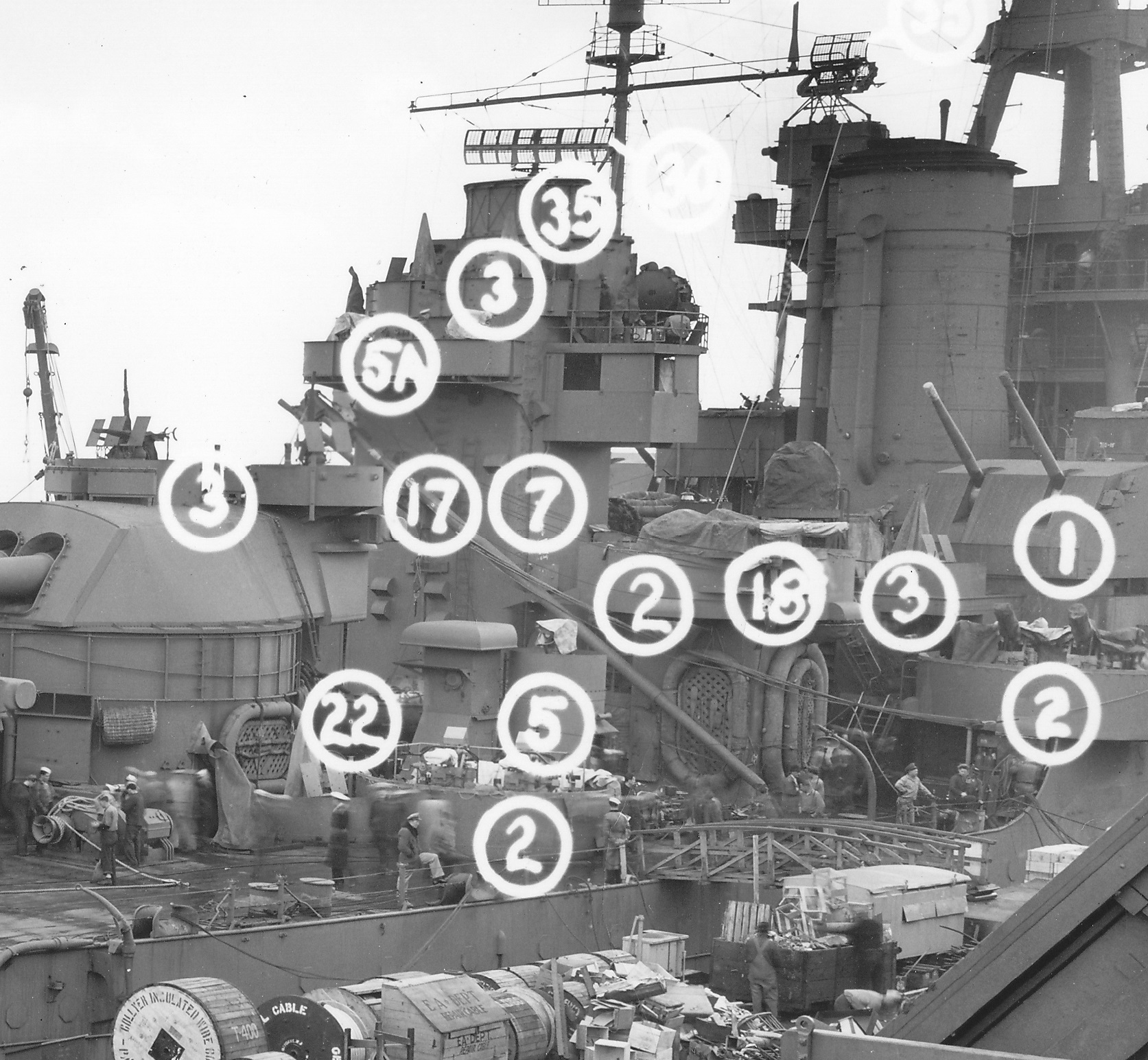

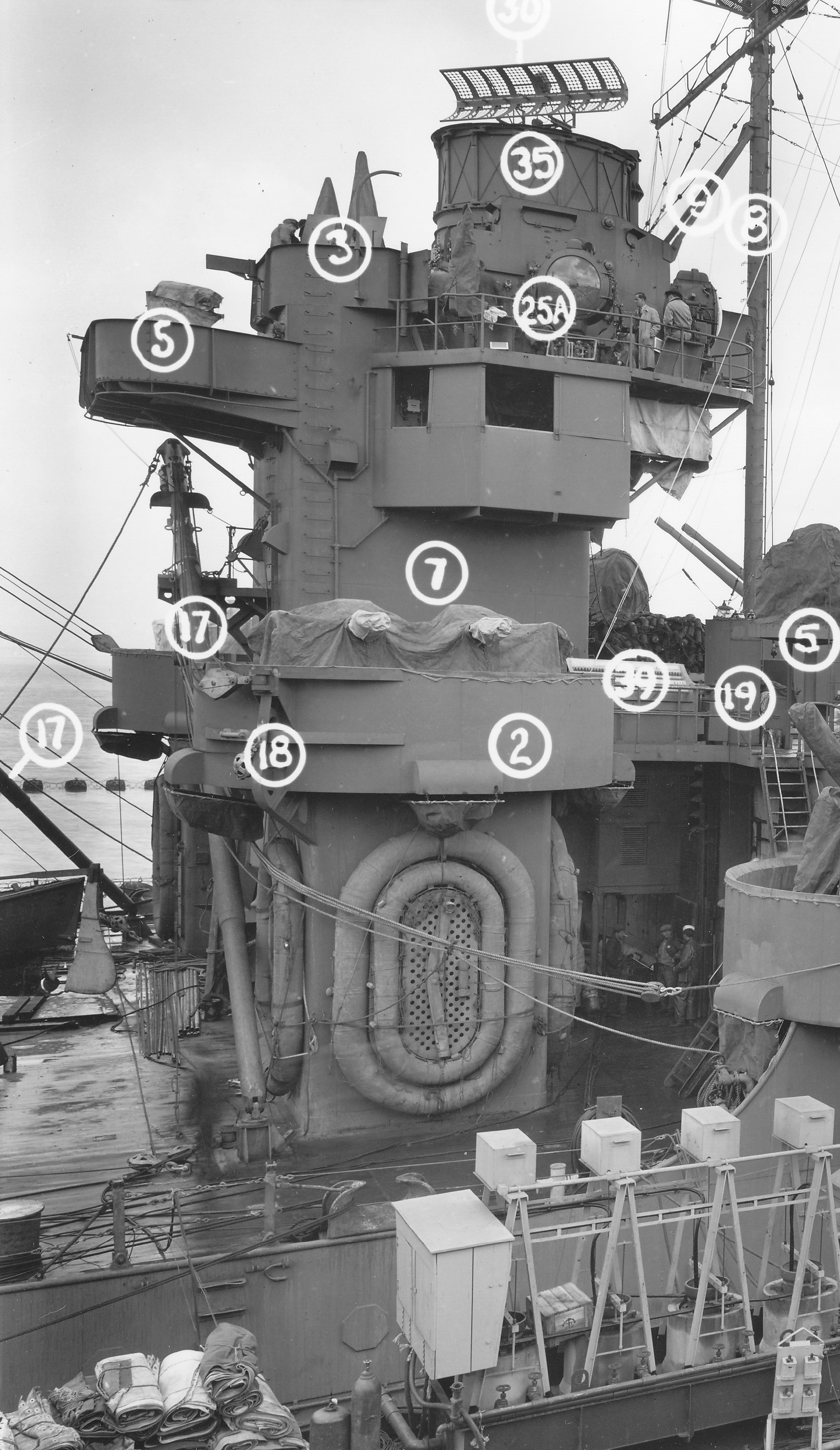

Some photos from NARA II, courtesy of James Noblin, of Pennsy after her late 1942/early Jan 43 refit/rebuild. I've cropped most of them down to highlight the area you are interested in.
- chuck
- Posts: 3384
thanks, Martin!
