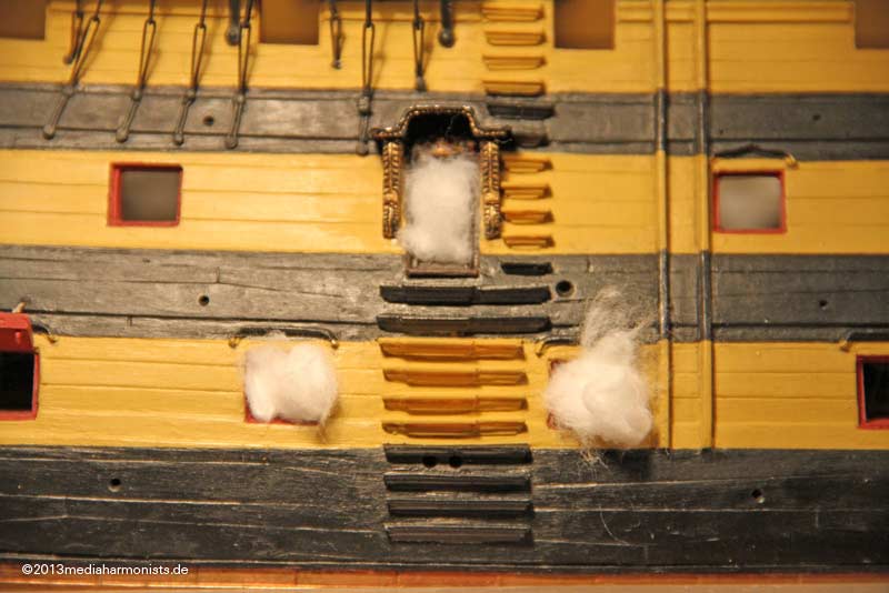

Actually those old steps were "historic" parts: the first details beyond oob :-)
Mark one still with Humbrol Colors.
At a later stage the supports underneath were added, but still - the base was too thick for my liking.
The "Mark One" Steps were stuck on the hull, UHU-Plast flooded into the gap in the back, and thick paint to cover it up. Worked well as it stayed on the ship for more than 10 years :-)
For some reasons did not work this time ...
But I better spare you THOSE Pictures. So pulled down the paint again - was easy as it was to thick and come down like a rubber coat.
Instead of the usual car filler I lately use the 2 component sculpting masses. More time to work with and being able to place it properly and still form it to the wanted effect.
My favourite is Apoxie Sculpt, a small saussage of 0,3 mm placed on the gap ...
... and squeezed in with a moistened wooden stick, moulded and already taken out the surplus material.
After drying the fine tuning ...
... with some sanding paper glued onto an old blade :-)
Also easy to fit other places ...
... like a small blister on the edge of the cast of the canopy. Also works for the steps. After modelling I just lift it up from its place and add some CA underneath with the help of a toothpick, like this it wont come of while sanding to form.

To finish the support columns, I pressed it against a piece of wood, so they were more easy to handle. Placing it on a thin acrylic and using a sanding block, one can achieve very accurate angles.
The black primer and developing the tendril, first the main body, the the blossoms. As I have more control with normal paint than with the metallic paints, I like to put a layer of ochre underneath.
Then some Humbrol gold and same Warcraft gold, to accentuate with some reddish shines, plus a tad of black ink where necessary.
In the meantime I refined the port, giving it a step like the gun ports to give a stop for the lids.
Then gave the roof a aluminum foil from Hasegawa, splashed a mixture of ink, white and detergent onto it ...
... and here we are ...
OK, the guys from the tin roof have to come for some touch ups, but otherwise I am quite happy :-)

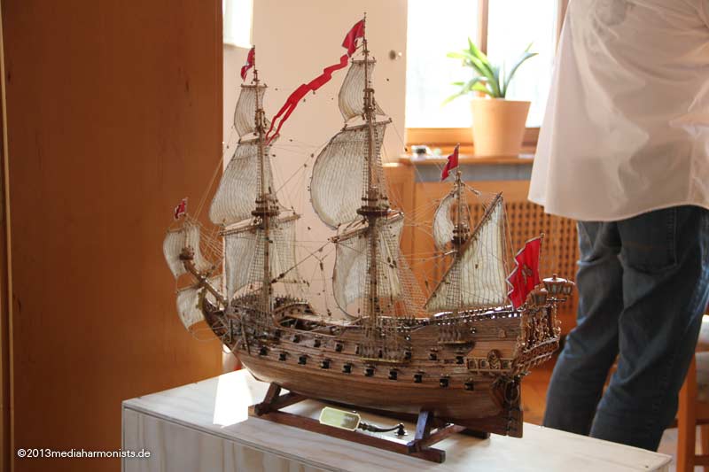

Just came back - and can you believe it ?!?
My small plastic-flower-pot standing in the middle of all those exquisite first class modells ?!?
Going bananas!

Sphinx from Alex
Amerigo Vespucci from Schiffebastler
Real de France
Friesland by Dieter
Lady Nelson by Lady Hamilton
Royal Sovereign from AVbiker
Wappen von Hamburg
SMS Trinkstein
As time goes by ...
Prince
America from Werner - I like it, its a plastic kit :-)
Cardboard models
What a day!!!

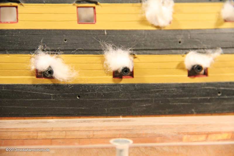

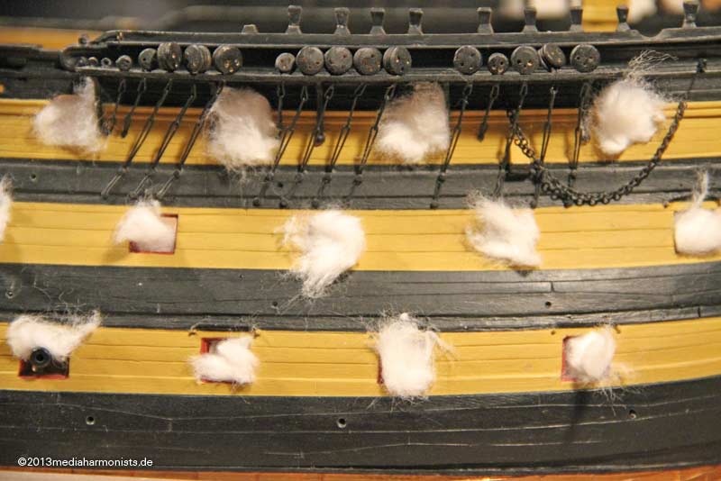

All cottoned up :-)
Post by dafi »
No, this is no broadside ...
... nor fire alarm ...
... only ...
... one of the easiest ways to prevent things falling inside of the ship. Cheap, easily placed, easily taken out without danger for paint or flimsy details :-)
Cheers, Daniel
