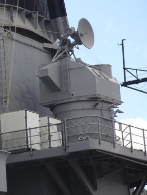

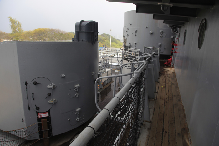

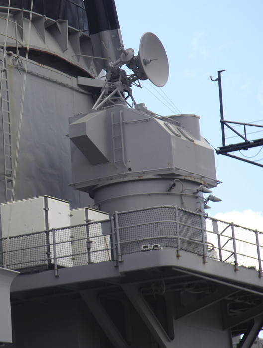

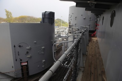

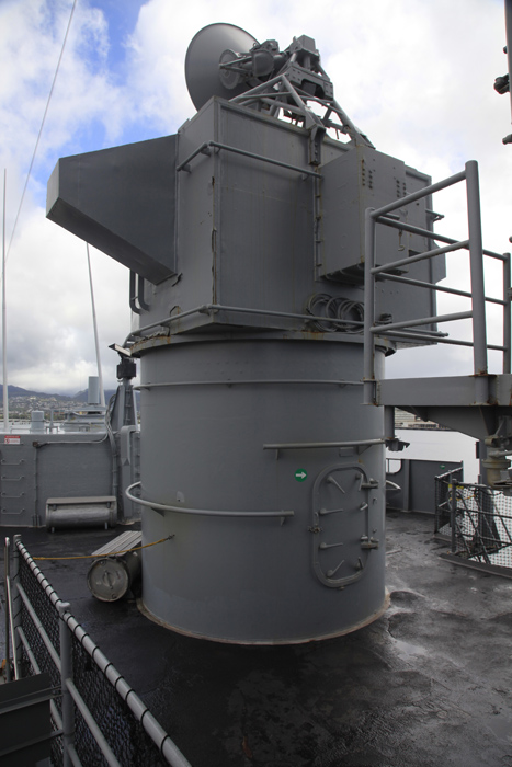

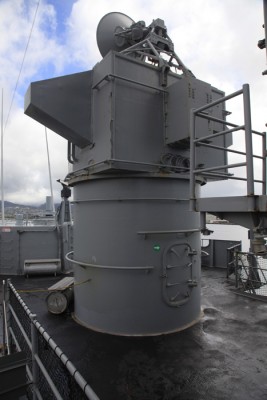

Hope these help a little: On the 5" mounts, the holdopen cylinder for the mount captains hatch is missing for some reason. Note the boxy covers on the MK 37 rangefinder wings are a post decomissioning protective addition.
Cheers: T

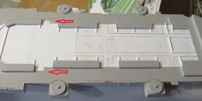

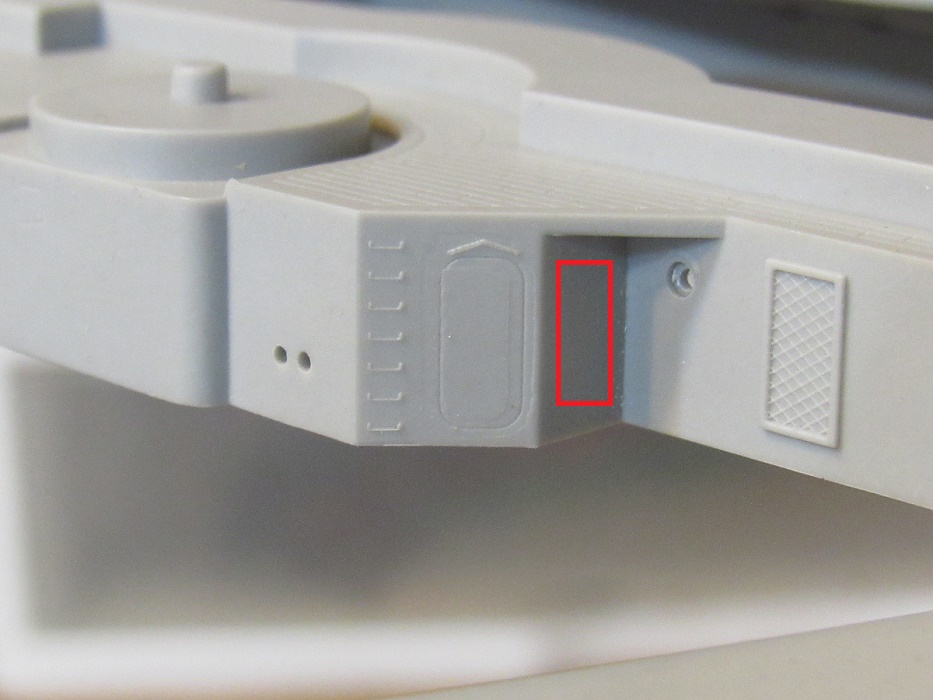

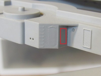

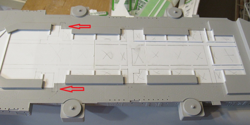

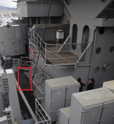

I'm hoping those in the know will be able to help me out.
I have recently started building the 1/200 USS Missouri for late 1945, well for the surrender ceremony.
But I also want to open some of the hatches on both sides of the 01 deck level to be able to see through
the structure. Trumpy has them molded on the diagonal bulkhead next to a vertical ladder. The Booklet
of General Plans I have viewed have plans for three different Iowa Class battleships that show the hatch
on the aft facing bulkhead. There is also a picture posted by Fliger747 on page 96 on this thread that shows
the hatch on the aft facing bulkhead. Is this another Trumpy mistake or were there changes in the hatch
placement?
Posts: 5068
Re: Calling all USS Iowa class fans
Post by Fliger747 »
I can't answer as to whether or not the hatch was moved, but it seems unlikely. It would appear from the photo if this area remained unmodified that the undercut area should be larger and the bulkhead wider.
The only areas that offhand I know of where one could see all the way across was in the wardroom, an awarthships passage midships and a short passageway under the aft Mk 38 tower.
Cliffy B
Posts: 3125
Location: Hawaii
Post by Cliffy B »
The more you look over the ships with a fine tooth comb the more you'll find all sorts of sundry little things different with all of them!!! Best bet is if you have the plans and/or photos from a certain date for your ship then run with it. If not make an educated guess from the info at hand. Different shipyards do different things, sailor-alts occur, changes never get recorded, plans never get amended, so on and so forth. I have a set of plans for BB-64 from 1988 and walking around the ship inside and out I can find all sorts of little changes that never made it onto paper and I'm not talking about the mods made for the museum. Just saying, you can go nuts trying to accuratize these things.
Every set of plans I have for BB-62 through 64 from the 40's, 50s, and 80s show the door as the photo reflects and NOT how Trumpy reflects. Go with the plans in this case I'd say :thumbs_up_1:

Here a photo of the Missouri at Bremerton before she was modernized.
No door on the angled bulkhead
As she is today in Hawaii.
Door installed on bulkhead:
James

Thanks for the pics James M
Looks like that confirms that the hatch should be on the aft facing bulkhead.
William Smallshaw
Posts: 227
Joined: Mon Apr 25, 2005 10:05 pm
Location: Evergreen, Colorado
Post by William Smallshaw »
Same location on Iowa. The hatch leads to a blackout area before a door into officers country. Admirals cabin and Captain's galley is just forward of this door.
