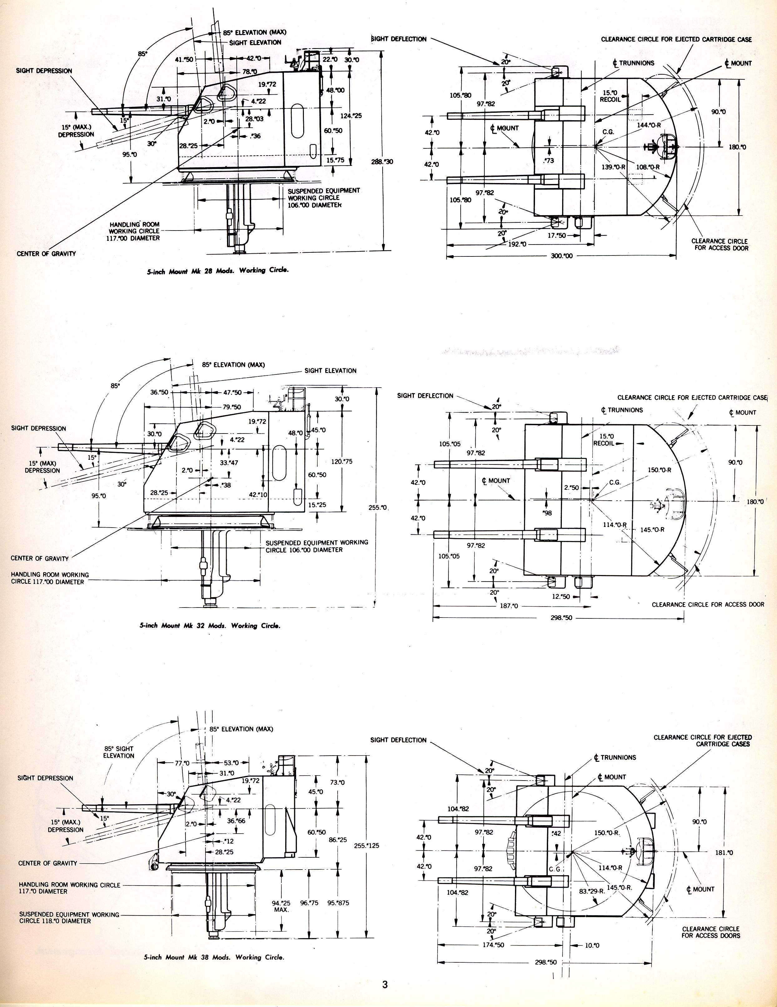

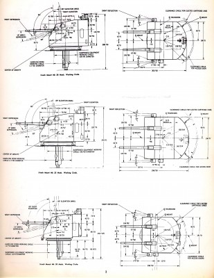

It appears that Trumpeter erroneously put 5"/38 Mk.32 mounts meant for cruisers and aircraft carriers in the 1/200 Missouri and Iowa kits instead of the much heavier Mk.28 mounts used on battleships.
They are noticeably different dimensionally. The most noticeable difference is the glacis (front armor). The Mk.28 mount's lower vertical face is much taller than the Mk.32s. That's the dead giveaway.
But not only is the glacis different, the Mk.28 mounts are 3-1/2 scale inches taller. The different glacis is easily noticeable in 1/350. The height difference is negligible in 1/350.
The extra height of the real Mk.28 mount is accounted for in two ways:
1) the roof is 3" higher measured from the centerline of the guns
2) the floor is 1/2" lower measured from the centerline of the guns
Presumably, these differences are due to the Mk.28 mount's thicker armor.
In the drawing below, you can see the Mk.28 battleship mount on top, the Mk.32 cruiser and aircraft carrier mount in the middle, and the Mk.38 mount for Sumner and Gearing class destroyers at bottom.

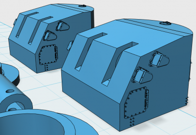

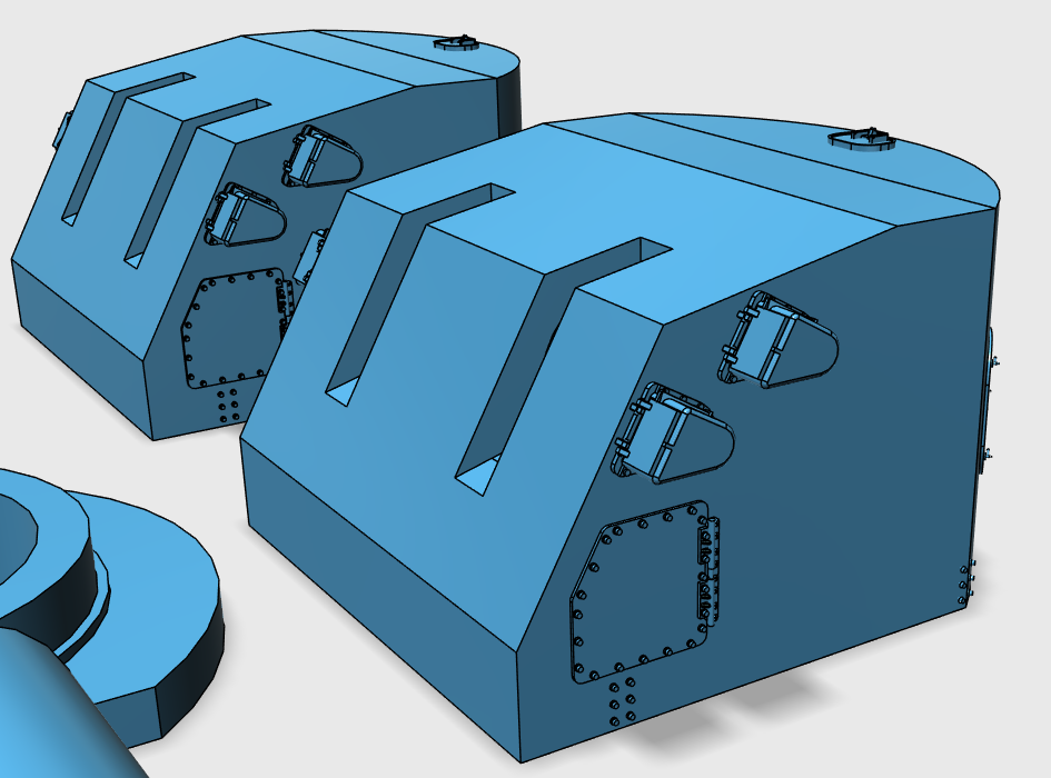

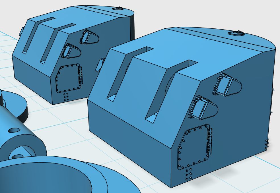

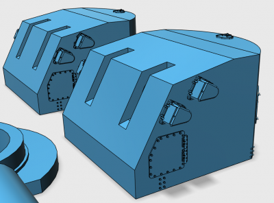

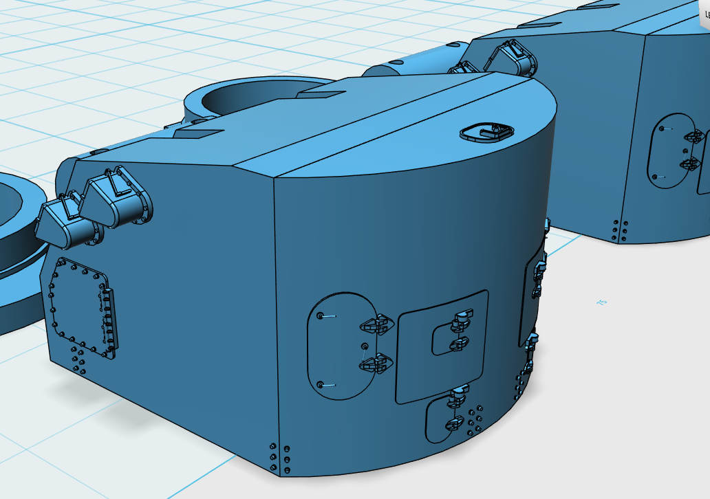

Here's how the 3D design software I use "sees" the two different 5"/38 mounts I offer in 1/350 scale (and other scales, too).
The Mk.32 for cruisers and aircraft carriers is on top. The next two images are of the Mk.28 for battleships. You can see how the glacis is very different.
Notice the accurate access hatch, hinge and bolt details, all properly sized and positioned according to measurements of an actual mount posted earlier in this thread.  Also notice rangefinder and viewfinder shutter door actuating arms on the top of the armored rangefinder hoods.
A separate trunnion slotted for brass barrels allows for the modeler to choose any realistic elevation. The trunnion is inserted into position through an opening in the mount's bottom. There is a bottom plate with integrated barbette of the correct height for USS Missouri (shown inverted) that is then closed. Once complete, the seam is invisible.
