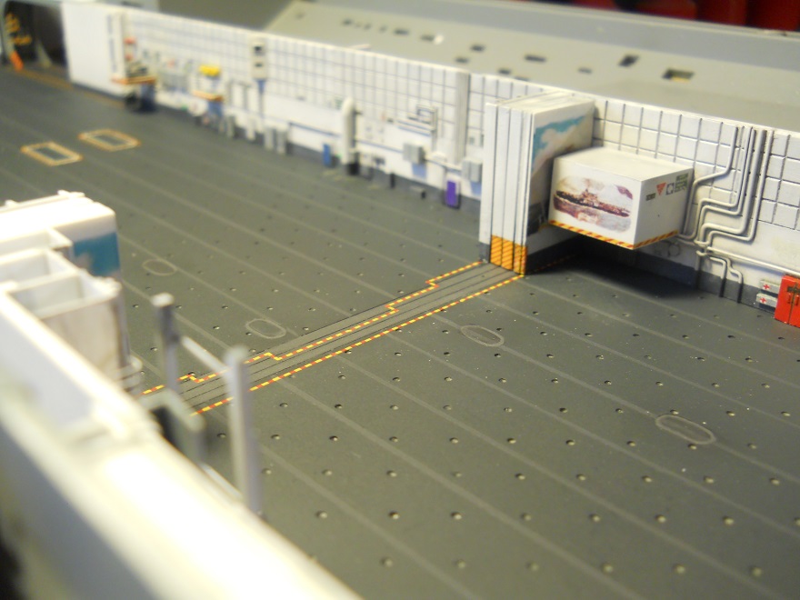

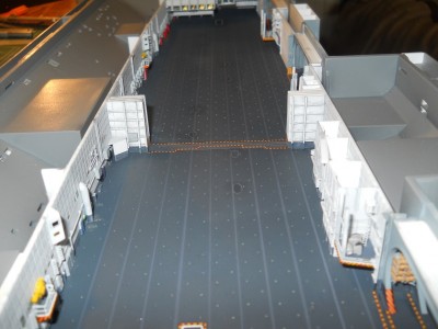

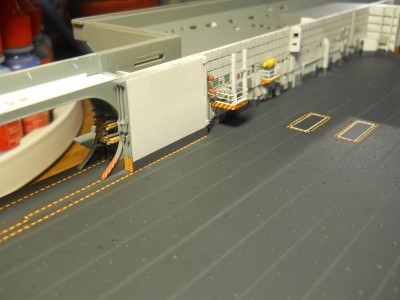

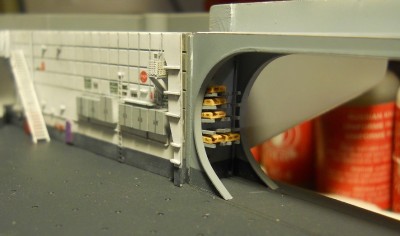

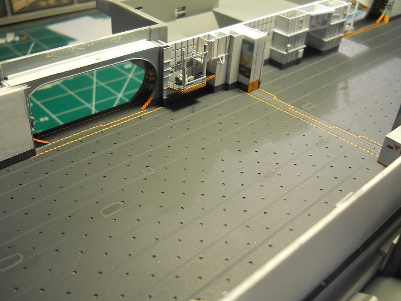

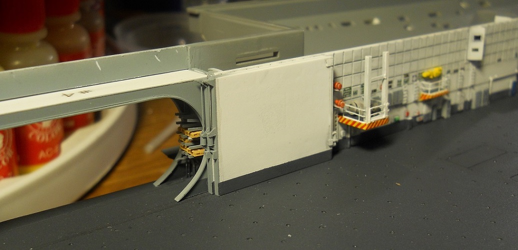

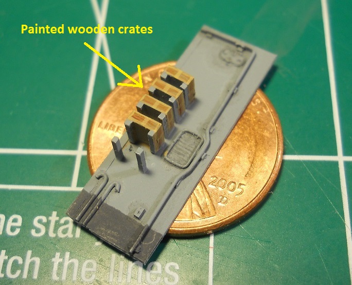

Thanks for all the comments on the work you guys! :thumbs_up_1: I painted and added the wooden crates to the hangar openings. I also pieced together the internal hangar openings along with some of the hangar walls to show some overall effect so far. I still need to add the warning lines around these areas. I also built the ceilings with support structure to complete the hangar openings themselves. Just have to paint them and then I will start permanently assembling all the walls.

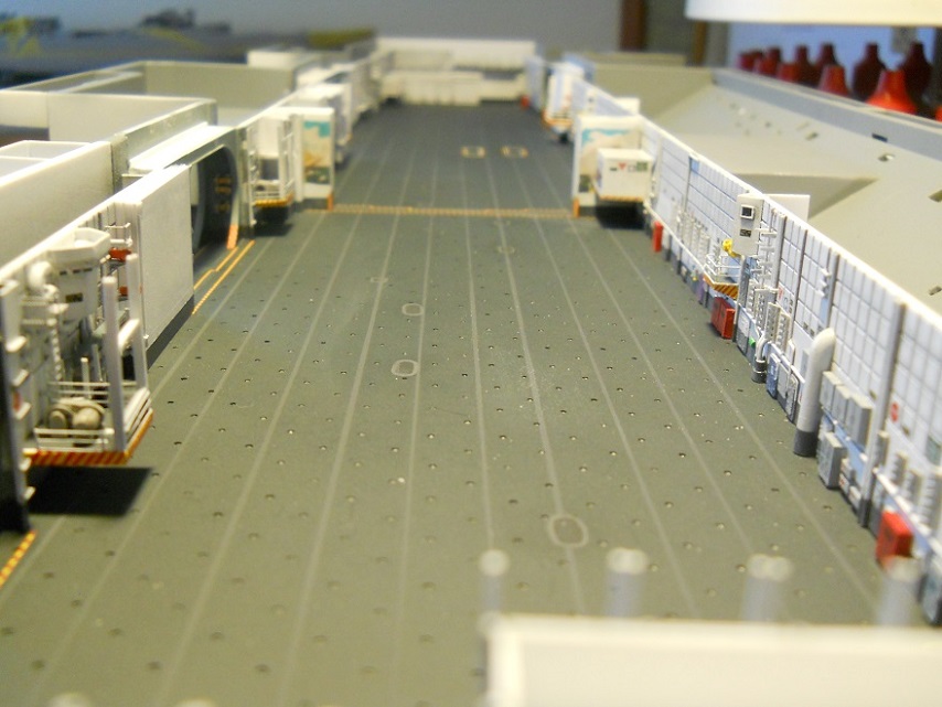

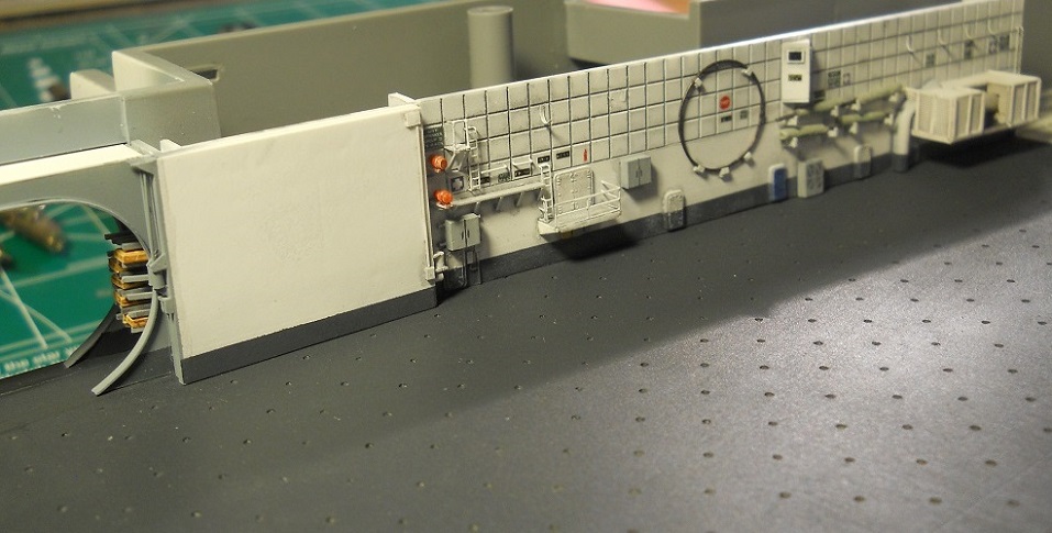

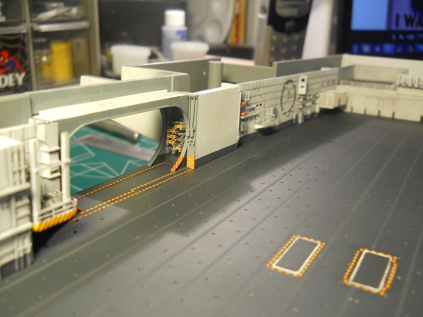

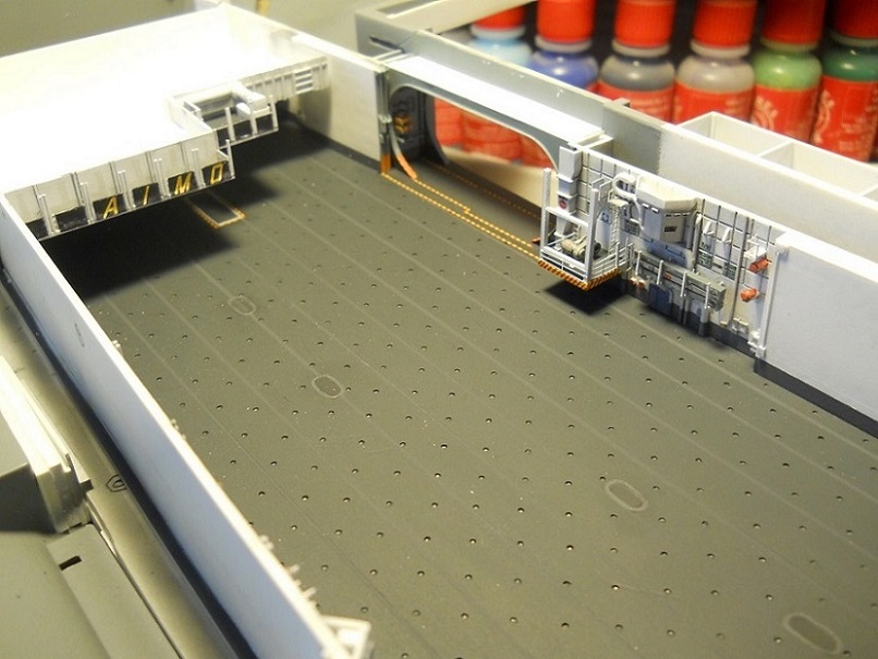

Thanks Nicolas! I have been working on putting the warning lines in the hangar openings and around ordinance elevators and have finished most of that. I finally got to a point where I was able to glue the hangar walls in place as well. I still have some more weathering to complete on the hangar floor before that's done. I will also be adding some aircraft and stowage to the hangar deck as well. I will start constructing the hangar ceiling probably very soon. It's taken quite a while constructing the hangar from scratch and getting it all painted and pieced together, but it seems to be moving along quite well now. Here are some progress photos up to this point.

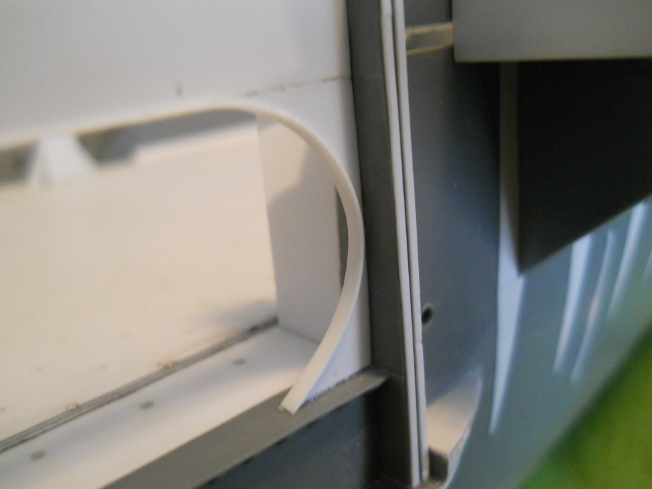

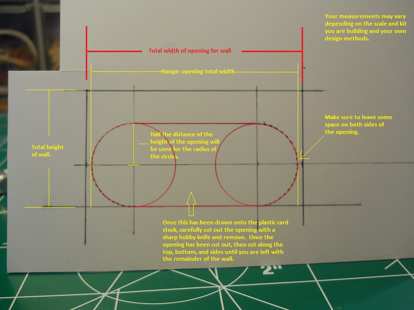

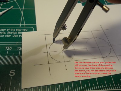

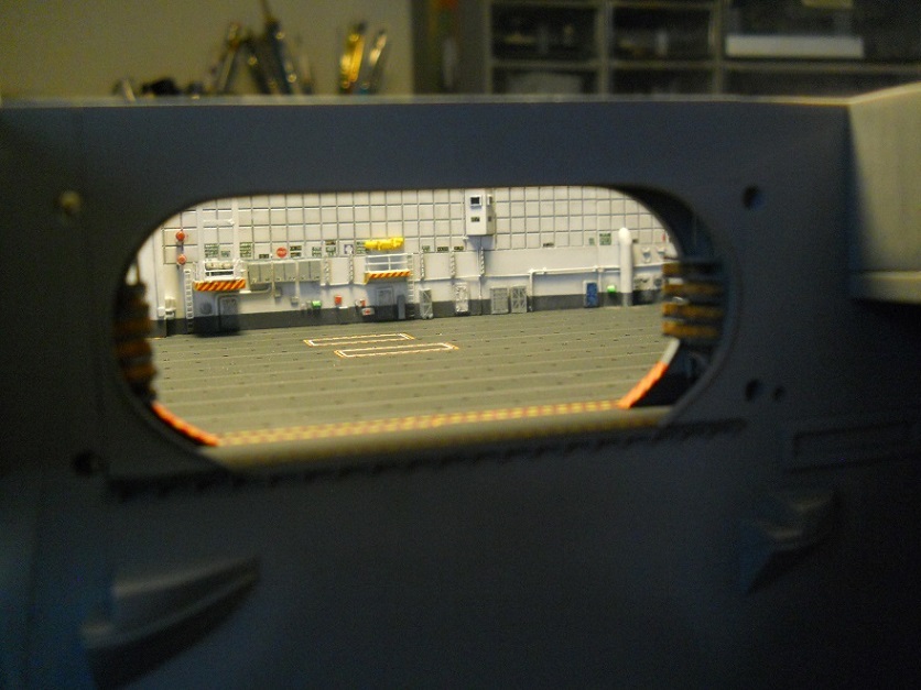

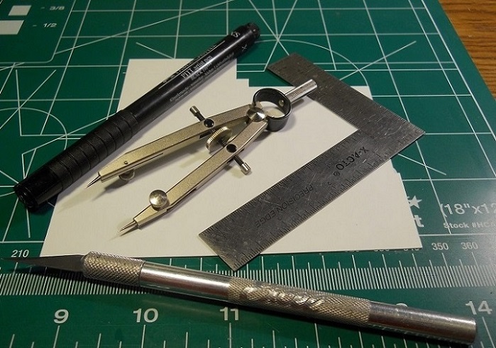

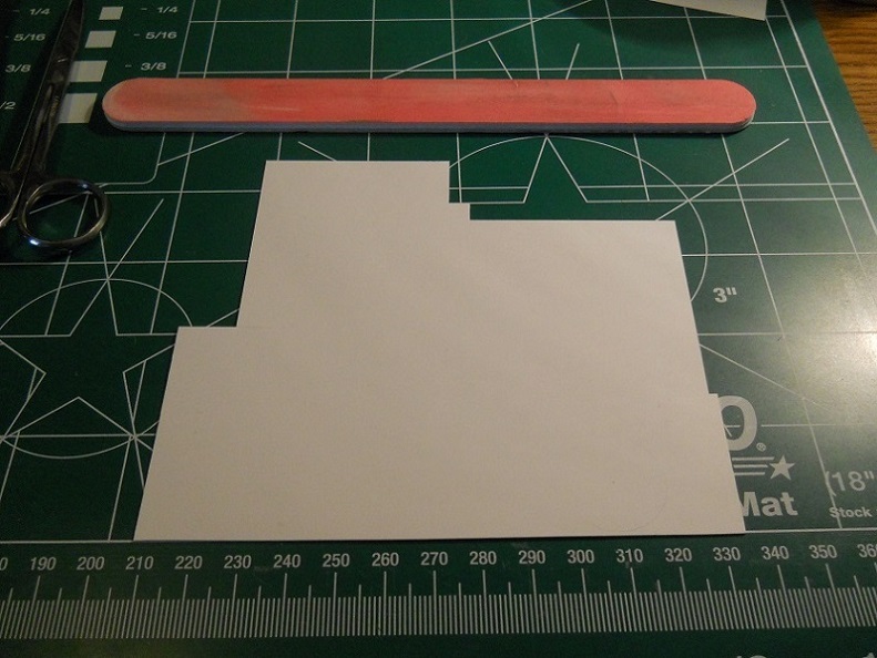

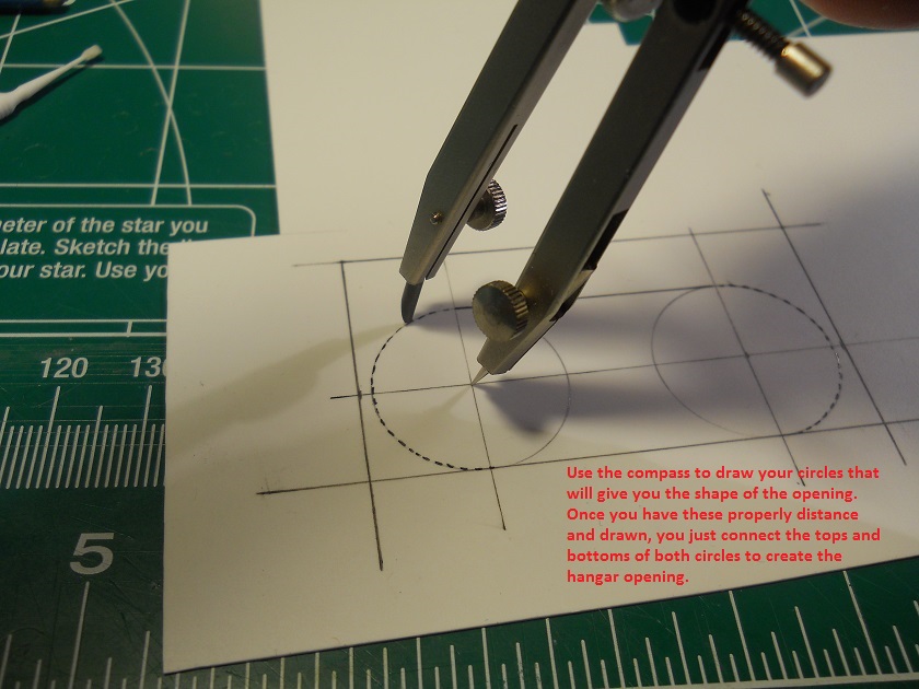

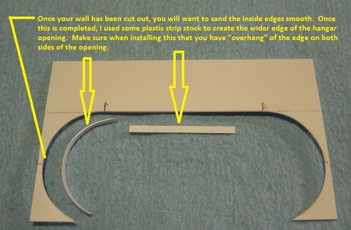

ESO wrote:.......How high do you build the walls of the hangar to fit the roof etc?
and how do you create those perfect inner hangar door curves?....
Well, to try and answer your question about the height of the hangar walls.....they need to be high enough to go just above the hangar openings and low enough to clear the flight deck above. I will actually build a "hangar ceiling" to fit the hangar instead of using the flight deck as the ceiling. That should leave a little less than 1/4 inch clearance in most of the area above the ceiling. In some areas, it will be less than 1/8 inch. The one thing you want to make sure of is to build the hangar walls with the exact same height or you will end up with spaces between your walls and ceiling if there are high and low spots. Hopefully, that helps???
As far as the hangar openings, I have included a photo of some of the tools I used to obtain the openings. There is some explanation of this on page 10 of this thread with some progress photos. If you still have questions on the "how to", just let me know and I will see what I can do ESO. Thanks for following the build. :thumbs_up_1:

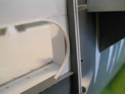

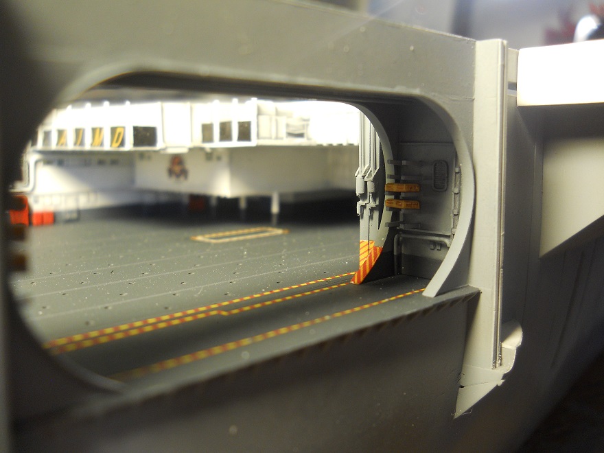

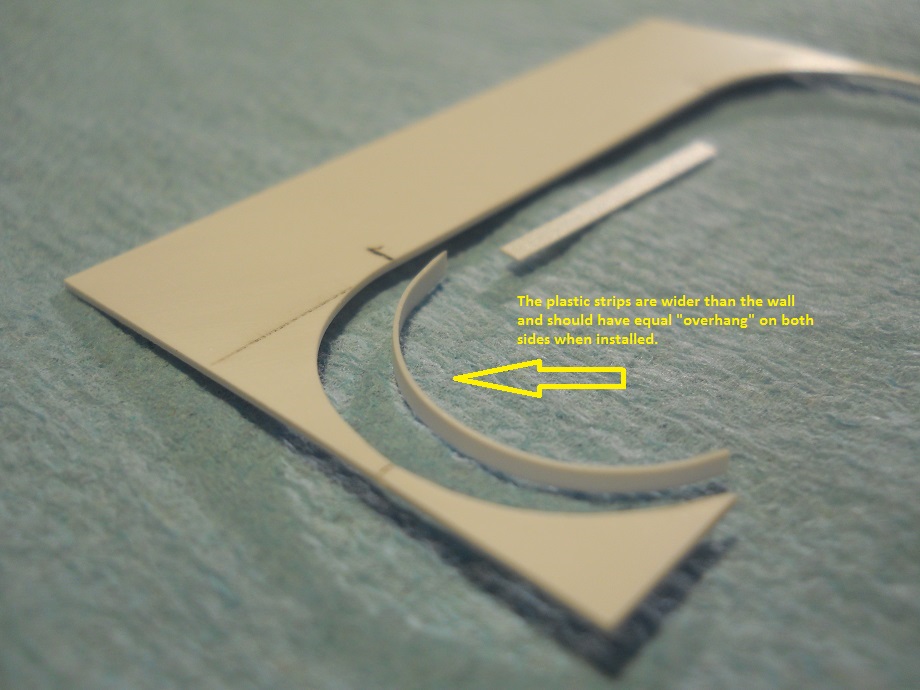

Here you go ESO. Here is a guide for how I went about creating the hangar openings.
You will need some flat plastic card stock.
The compass is used to create the "inner door curves" or hangar openings.
Guide and explanation
construction complete and installed.
