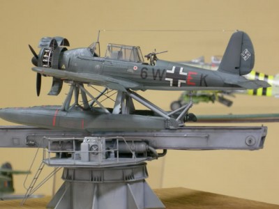

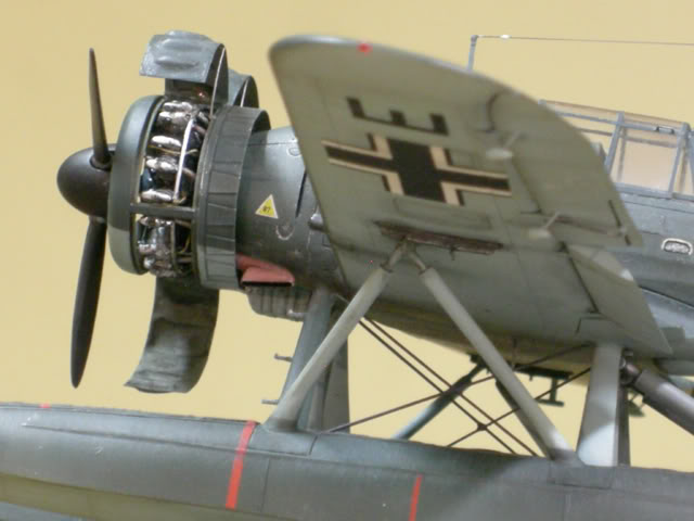

Lovely Arados.
Yes, they are Heller.
I had other makes but was advised on Heller so exchanged them.
The rest WEM 1/72 Bismarck Class Catapult Ref: PE 7247.
regards
