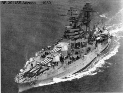

Do you know when the armor was removed from the 5� guns?
I have two pictures one in 1930 with the armor still in place, the second in late 1930�s (possible 1936) without the armor.

Are you talking about the broadside/casemate guns (5"/51s) on the main deck? Those weren't armored; there were metal plates that could be attached during heavy weather and canvas that covered the openings during other times. The Revell/Banner depiction of them as turrets is wrong. One of the metal pieces was always in place as it was attached to the bulkhead and was used to line up the gun for the removable pieces (they were normally stowed pointing fore and aft parallel to the length of the ship).

Tracy White wrote:Are you talking about the broadside/casemate guns (5"/51s) on the main deck? Those weren't armored; there were metal plates that could be attached during heavy weather and canvas that covered the openings during other times. The Revell/Banner depiction of them as turrets is wrong. One of the metal pieces was always in place as it was attached to the bulkhead and was used to line up the gun for the removable pieces (they were normally stowed pointing fore and aft parallel to the length of the ship).
Yes those are the guns.
So the upper part would be rolled back/stowed when not in heavy seas leaving just the bottom half in place?

The bottom half or part was structural; it never went anywhere. Look at the second picture on this Navsource page; you can sort-of see a raised armored looking section. These were the removable plates. Each plate had one porthole in the center, so you can see about how many individual casemate cover pieces there were. the plate in between the gun and the bulkhead inboard of the gun was hinged and had no porthole.
The 12th photo down on this BB-38 page ("U.S. Navy Photograph # 1108-42") shows what Arizona's casemate guns would have looked like with the plates off and the canvas covered rolled up and tied off to the overhead at the top of the case mate openings, but it doesn't show the plate on hinges I mentioned. If you have Paul Stillwell's Arizona book let me know and I'll list some page numbers for you.

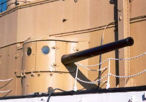

I found a picture that shows the granddaddy of the 5"/51 gun mounts. I can see how the Arizona's evolved.
http://www.navweaps.com/Weapons/WNUS_5-51_mk7_pics.htm

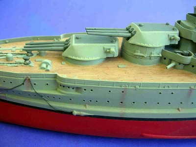

Another question
On the Revell kit near the bow what is this thing that has a wire or rope attachment as seen on Georgius Credidio picture of his ship.

I think thats a paravane. They would tow that device while underway and it would entangle in the anchor cables of mines and detonate them.

Those are indeed paravanes; they were normally stored on deck when not in use. They also didn't tangle the mine chains as much as push against them so that the mine would not come in contact with the hull. Hopefully they would also break the mine's chain so that they would float to the surface where they could be spotted and either blown up or at least avoided.
