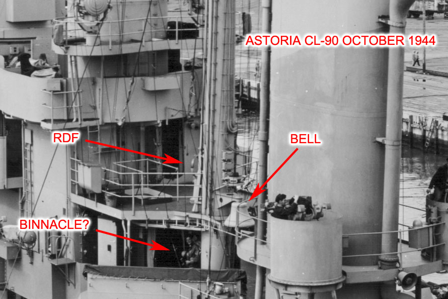

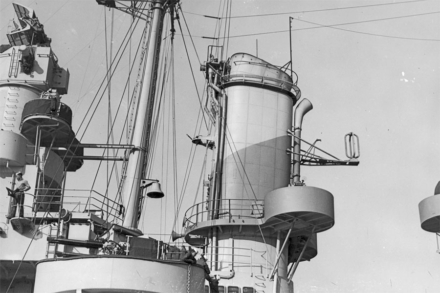

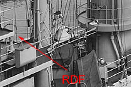

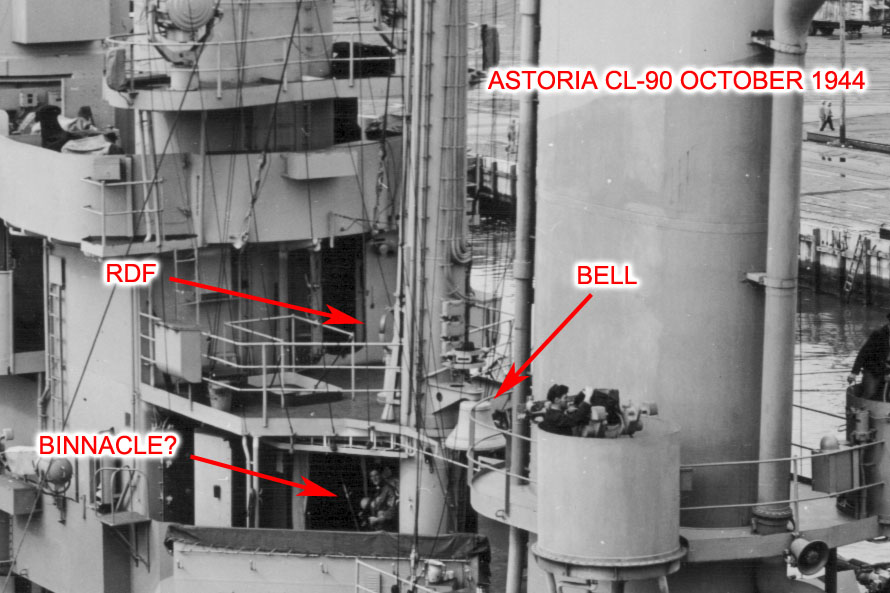

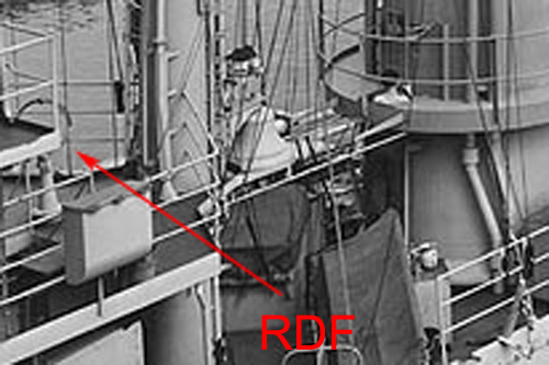

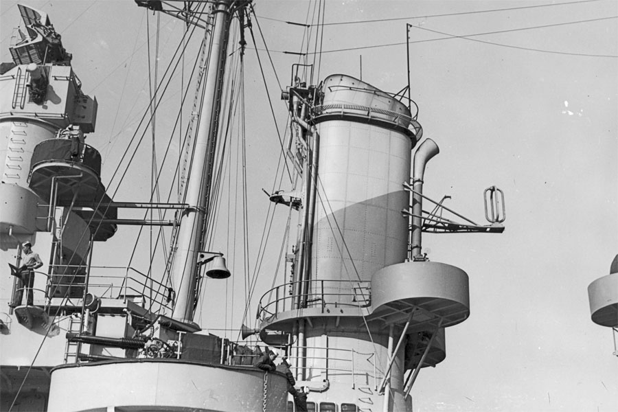

Still working on detailing my 1/96 USS Manchester CL-83. I am trying to determine if this device on the Forward Fire Control Station is a Binnacle/Compass. Any thoughts? Thanks in advance for your help. Neil

Plans for the USS Miami CL-89 show a "Radio D. F. Loop" at this position.
USS Cleveland CL-55 plans also show a "Radio Dir Finder" at this position, on the deck above the compass.

From the picture you posted I can't tell what it is. I do see the ball you mention, and I don't see the normal set of circular RDF antennas.
In the plans the binnacle (compass) is on the deck below - the same level as the flag bags. Above it is supposed to be the radio direction finder.
However, the plans were drawn up before the war or earlier during the war, and by the time the war ended things might been moved around. The bell is supposed to be at the level with the flag bags, but it obviously wasn't.
The binnacle was sensitive to objects around it - there was a magnetic "keep out" circle around it where other equipment was not to be located, especially magnetic objects or devices that could generate a magnetic field. Placing the RDF almost directly above the binnacle might have caused problems, as well as equipment around the flag bags and on the deck below. So maybe the RDF was moved elsewhere and the binnacle was moved to it's position.
Many of the late war Clevelands have a RDF antenna mounted on a support attached to the aft side of the forward smoke pipe. After the war these were removed on some ships.
Whatever the thing is in your photo, it is manned in virtually every picture I have of Clevelands underway.
I have attached some files that show the circular radio direction finder antenna at the location forward of the fore ward smoke pipe, and some showing the RDF antenna on the aft side of the forward smoke pipe.
