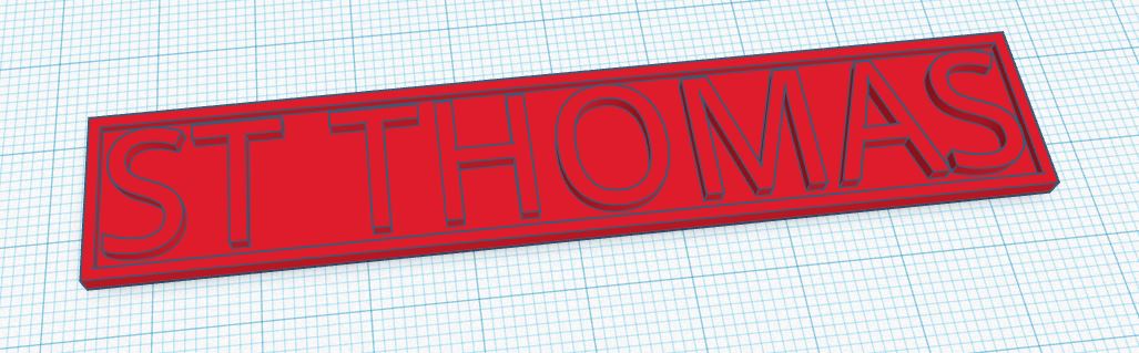

So,
Yesterday as I was puttering around on my HMCS St Thomas model, I discovered that I was missing a key component. I ended up heading into the simplest of all programs and doing up the design...then I pushed it from TinkerCAD out to PrusaSlicer, and the print-job took 14 minutes to make 2 copies.
I'll have them out to the garage tonight to paint, and will mount them.
The key part here is the ability to go from design, to prototype, to completed build in a matter of less than an hour.
I love the flexibility of 3D printing.
NS

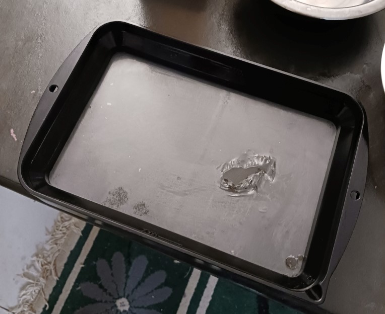

The last print run yesterday resulted also in a major rip in the printer vats original FEP -
Original FEP after rip
So, this morning while it was still cool in the shop, I replaced the FEP - I had watched a U-Tube video last night of a guy in UK replacing his and it wasn't that difficult but did take around 45 minutes to have the vat ready to go. I did a new Z-lift calibration and Zero'd the build platform, so everything is back to normal on the printer. Something Positive, for once!!!

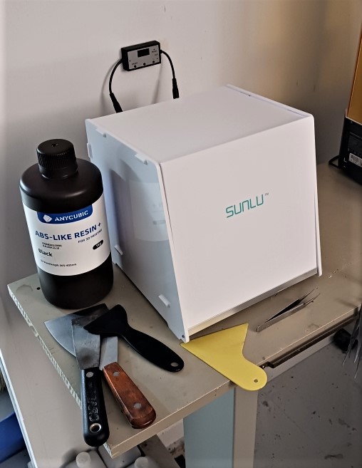

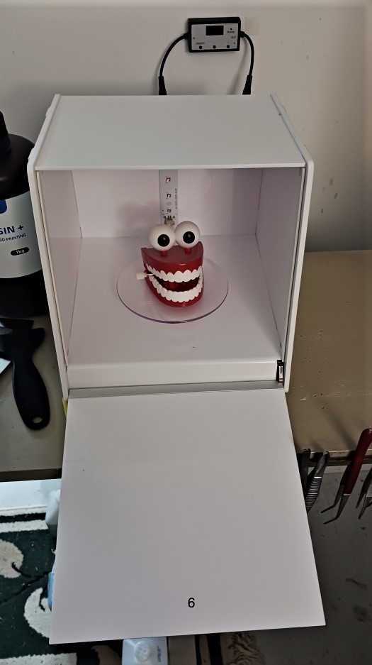

One new purchase has also proven to be a winner - I bought a Sunlu Curing Box and it has done a great job of providing a steady and timed curing period. I've cured the AC and Elegoo resin parts in it and they seem to be hardened sufficiently. This box comes unassembled but isn't difficult to put together. The bottom with the turntable is preassembled and just a couple connections are needed to have this item up and running. Here is the curing box -
Sunlu - Exterior
Sunlu - Exterior
Sunlu Interior
Sunlu Interior
In the back (on the wall) you can see the timer - starts at 300 seconds and goes to zero and shuts the machine off. You can set it to higher times or simply turn the timer on for a 2nd curing period, etc.
