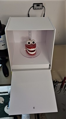

One new purchase has also proven to be a winner - I bought a Sunlu Curing Box and it has done a great job of providing a steady and timed curing period. I've cured the AC and Elegoo resin parts in it and they seem to be hardened sufficiently. This box comes unassembled but isn't difficult to put together. The bottom with the turntable is preassembled and just a couple connections are needed to have this item up and running. Here is the curing box -
Sunlu - Exterior
Sunlu - Exterior
Sunlu Interior
Sunlu Interior
In the back (on the wall) you can see the timer - starts at 300 seconds and goes to zero and shuts the machine off. You can set it to higher times or simply turn the timer on for a 2nd curing period, etc.
