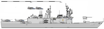

The next consideration to take into account is that the original design was set up for the USS Hayler. In that case, the Hayler was supposed to be a normal Spruance equipped with a hanger that extended over the standard flight deck and a flight deck that extended over the Sea Sparrow deck but still left the 5" deck untouched.
So, as an updated/expanded design, as some of the shipbucket drawings have depicted, do you guys think that the helo landing area should be extended all the way aft deleting the stern 5" gun for a longer landing area? While a larger landing area would be accommodated it would not be large enough to land two HH-60s at a time. Is it worth just having a little extra room to operate one HH-60 or having the standard landing deck with the extra capability of the stern 5" gun?
Remember in the upgrade proposed in the later posts in this thread the stern gun would be a Mk 45 Mod 4 5"/62caliber gun capable of providing NSFS/NGFS to existing troops ashore or troops the ship put ashore.
Also, keep in mind that by "troops" I mean special operations forces (SOF) such as NAVY SEALs and such, not Marine landings.
The extended stern version would look a little like this: ...fantastic.

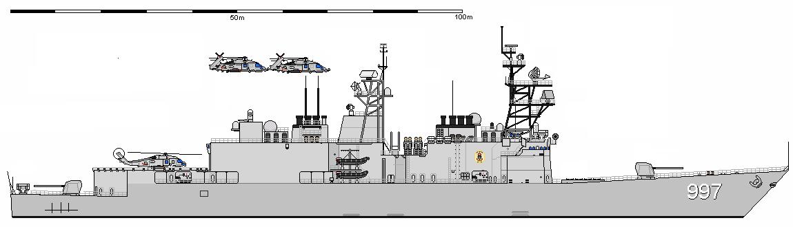

I love it when people are on the same pagecarr wrote:...I seriously doubt that can be achieved in this design. Thus, the larger landing area is pointless. Keep the gun.
- navydavesof
- Posts: 3127
Re: Reactivated and Modernized Spruance-class
With an 8-inch gun forward, I think we have a winner. However, I think the 7 non VLS Spruances shoud get the Mk71. The Spruances equipped with the 61-cell VLS will likely have to retain that and be limited to the 5-inch gun. At the very least we can upgrade to the Mk45 Mod4 to provide reasonable fire support. The lighter mast aft is a possibility, but retaining the original mast is a possibility as well for the Spruance-class DDH.
This final piece of weaponry [based on the originally modified (61-cell VLS) ships will have only a Mk45 Mod 4 forward and the same aft] will be focused on NSFS/NGFS. It will possibly be adequate for mass saturation of personnel targets while able to engage small craft and perhaps other vessels.
I think we have an ASW Spruace-class DD that would make CAPT Potter proud.
carr
- Posts: 1780
Looking good!
Does the stern RAM create a blind zone for the gun?
Do the two folded helos really fit in the hangar nose to tail (cause they don't look like they do) or are they going to be angled a bit to fit?
Bob
Bob

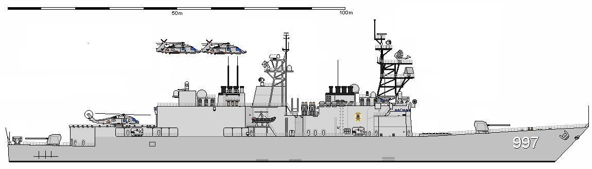

yes the RAM mount creates a blind spot for the aft gun, but that's the name of the game it seems. The Sprucans had RAM back there, and the Ticos have Harpoon back there. So... Why not?carr wrote:
For the helos, however they would fit. Angling both sides inward would draw them in closer together.
carr
- Posts: 1780
David,
I have no problem with the RAM-caused blind spot. That's what maneuvering is for.
On your drawing a few posts ago, I think I see one SPG-60 and maybe two Mk95 Bugeyes? If so, that gives you 3 guidance channels? Am I interpreting this correctly? Again, if so, why the mix of directors as opposed to all of one kind?
Will you mount a couple of Mk38s?
Looking good!
Bob
Looking good!
Bob

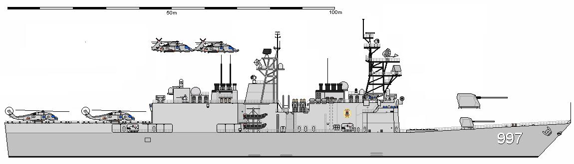

Fo' shizzle.carr wrote:I have no problem with the RAM-caused blind spot. That's what maneuvering is for.
There is no being lazy around you, Bob! I had not finished modifying that shipbucket drawing. I propose 2 Mk95 Bugeyes and no SPG-60. The original Bugeyes aft will stay where they are instead of moving them like I did for that picture, and the second will go up front just under the mast or on the mast.carr wrote:On your drawing a few posts ago, I think I see one SPG-60 and maybe two Mk95 Bugeyes? If so, that gives you 3 guidance channels? Am I interpreting this correctly? Again, if so, why the mix of directors as opposed to all of one kind?
Yes, sir I will. I foresee two, one per side, it's just a question of where.carr wrote:Will you mount a couple of Mk38s?
Thank you, Bob. I wish I could spend more time on this, but the North Koreans have us busy in Japancarr wrote:Looking good!
- SumGui
- Posts: 484
- Joined: Fri Dec 21, 2007 12:57 pm
I noticed the drawing ha the SPG-60 aft and wondered which re-arrangement would allow it to move forward so it could match the Mk 71. SPS-49 would be a good candidate to move is the room is needed. Of course, now you have said you intend to remove the SPG-60�
A candidate for the Mk 38s might be the top of the hangar, which should give a little extra distance to spot targets, and that distance may allow for earlier engagement.
So the difference between the ABL ships and those fit with 61(64) cells is only mount 51/81? How many cells do the former ABL ships pack forward?
The weights we used earlier show approximately 195k lbs available forward after the Mk 71. Deduct Phalanx, and we are at 183k.
16 cells with ESSM quadpack = 75.8k,
16 cells with Tomahawk = 98.2k
Meaning we�ve eaten up the estimated margin with 32 cells: 16 Tomahawk and 16(64) ESSM. The weight estimates do potentially allow for 8 of those ESSM cells to be Tomahawk - but IMO, ESSM would be more valuable to a ship at the pointy end. Additional Tomahawk could be lobbed by an asset farther out, if needed.
I have no weight data for a Mk46, but there may be deckspace for it in a few locations.
We don�t have data for the electronics, and then there is potential weight savings to be had in refit, so this is a SWAG you may or may not want to use in any case.
I�m still a fan of a gun mount with a faster RoF to support the Mk 71 against small boats � such as a Mk75 or Mk 110. Those 8� ships will get the first call to go close in, where the smallboat threat is highest. Not critical, just where I lean. Matching the Mk 45s fwd and aft on the VLS ships is perfectly logical and probably the right way to go.
