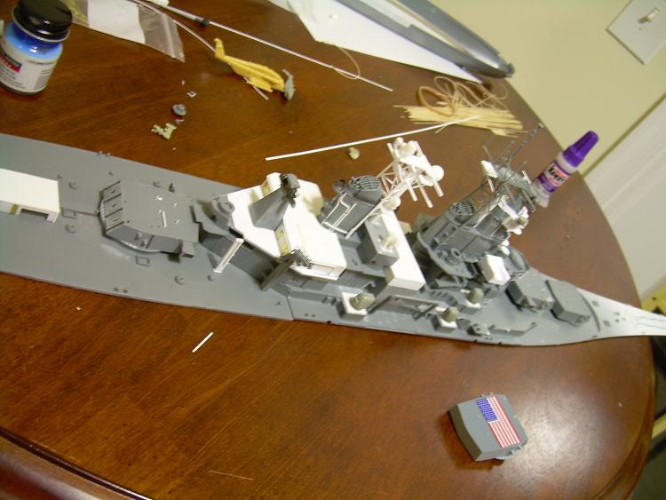

As someone who is currently building an updated New Jersey, whilst I don't have the technical know how to contribute, I'm finding this whole discussion fascinating :thumbs_up_1:
John
