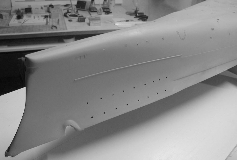

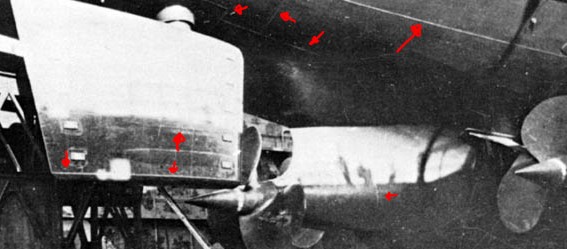

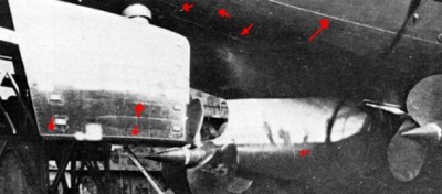

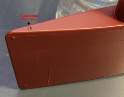

Hi,
no, these are the covers of the mounting eyes (DIA 120 mm). See the fotos of Bs while still on the slip way. Later on they were sealed with a cover.

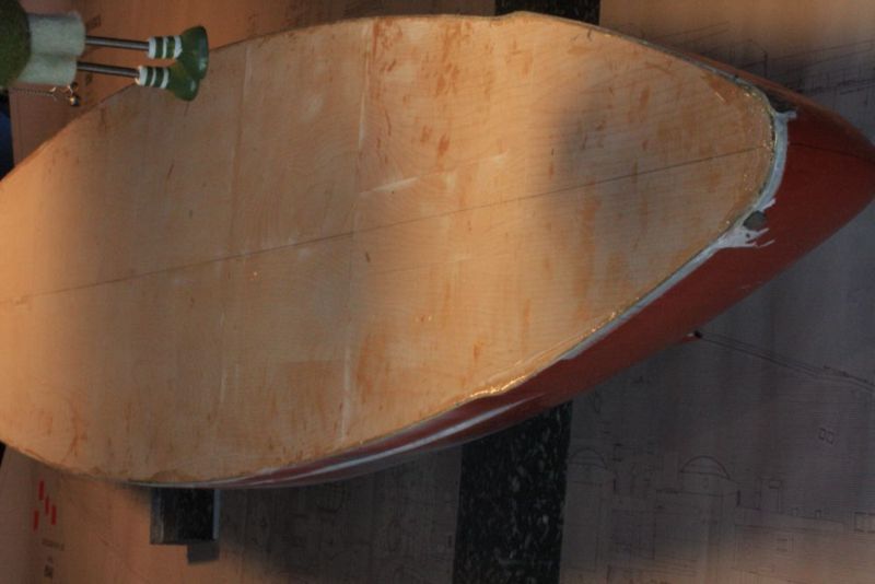

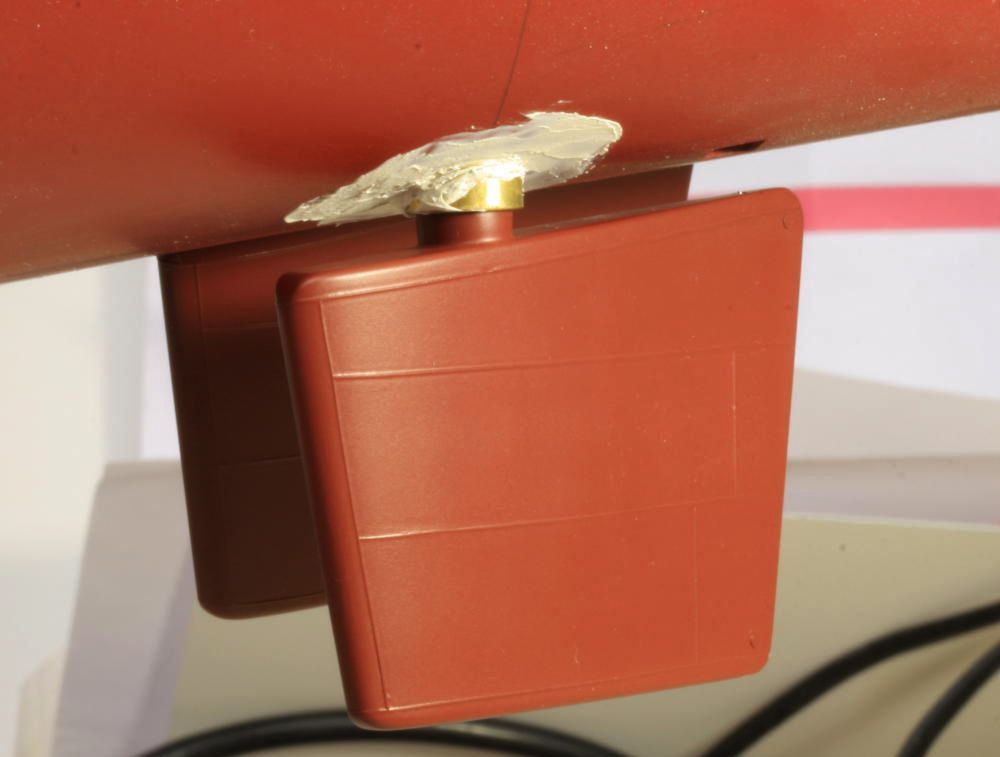

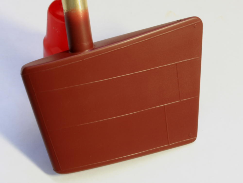

Hi,

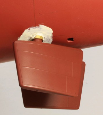

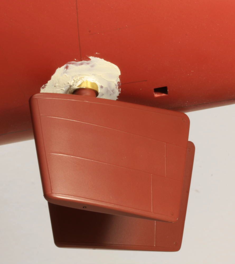

I airbrushed the rudders with RAL 8013 and added some more detail. The anodes will be added later.
Dinner .... :-)

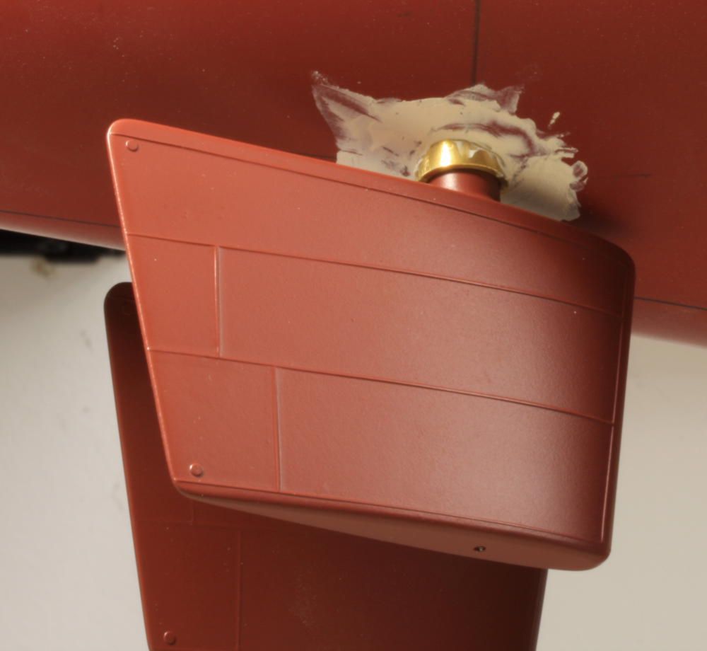

Thank you both - the compliment goes right back to you and your models! :thumbs_up_1:

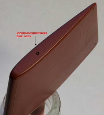

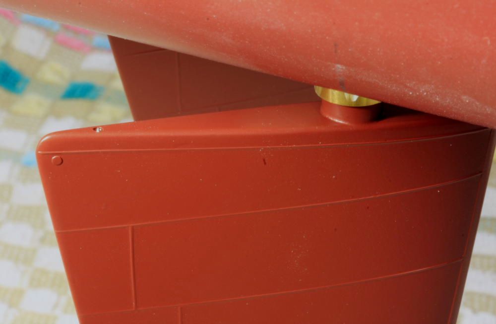

I finished the second rudder and made a test fitting of the rudders in their proposed position when they will be permantly fitted into the finished hull ...
Bye!

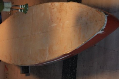

Hi,

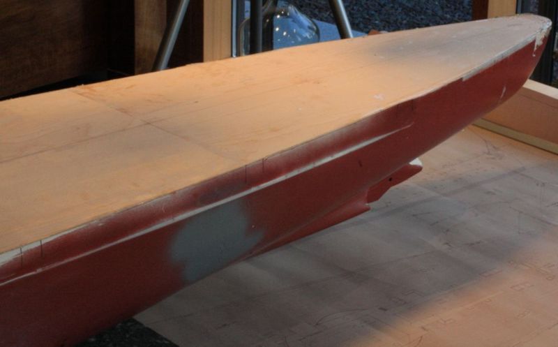

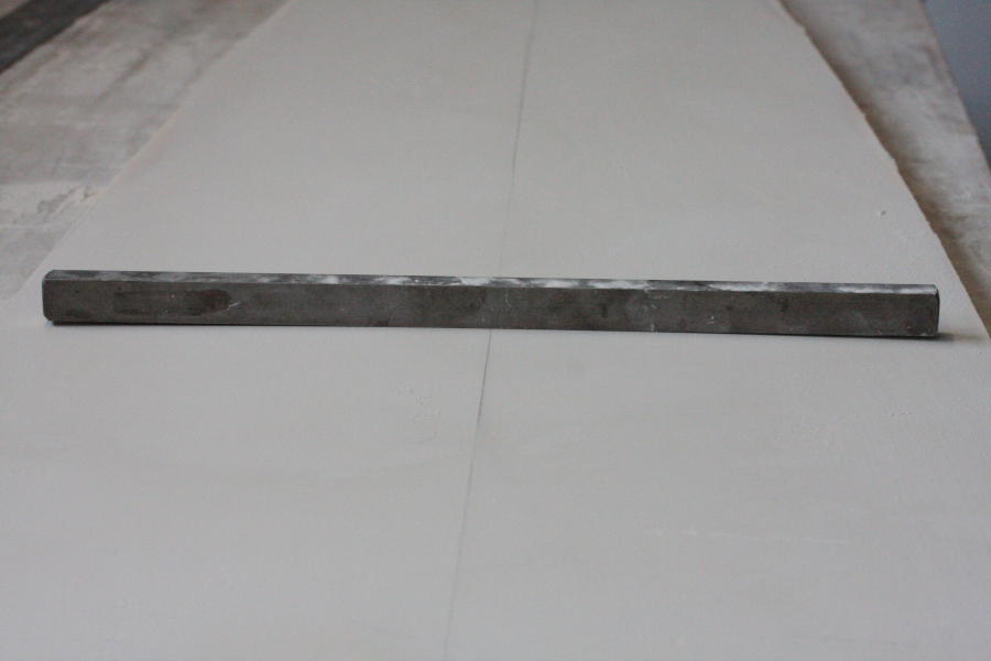

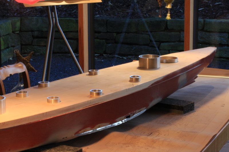

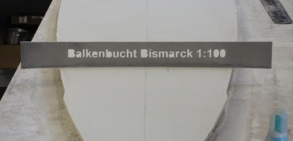

finished the camber of the maindeck: DIA. 450,18 m; height of camber at center of main frame 360 mm.
Have a nice sunday!
Bye,
Bernd.

hi bernd.i just knew that you would have the camber on the deck.because your hull is so fantastic :thumbs_up_1:

When you say that the camber's height at the main frame is 360 mm you mean at 112.30 section ? Is the radius constant from bow to stern ?

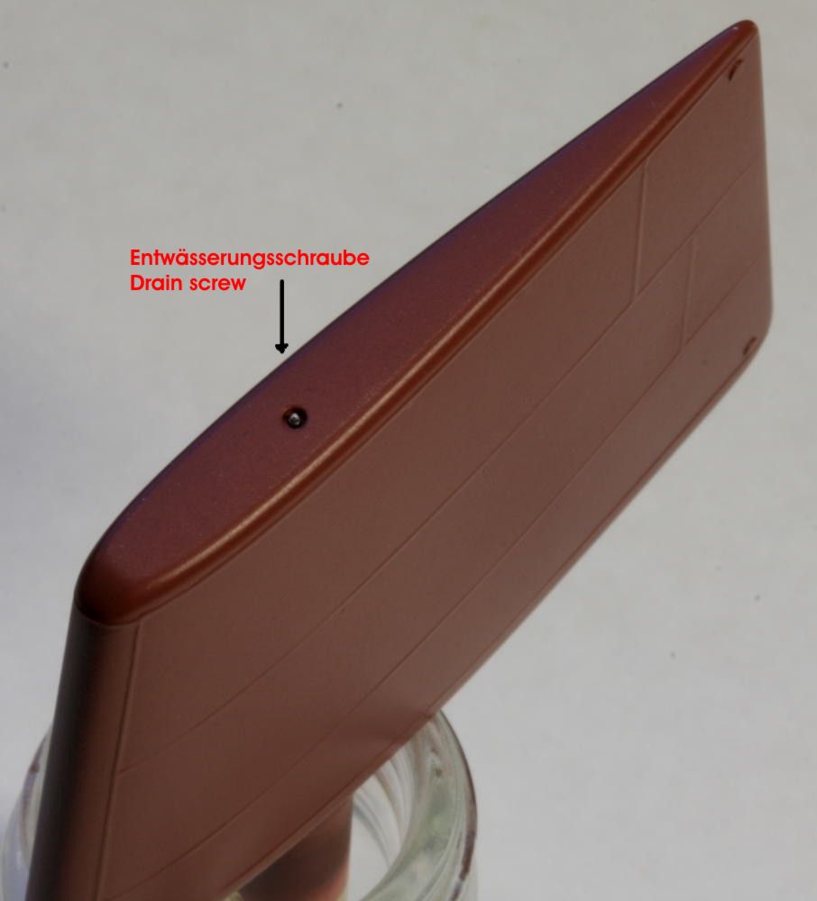

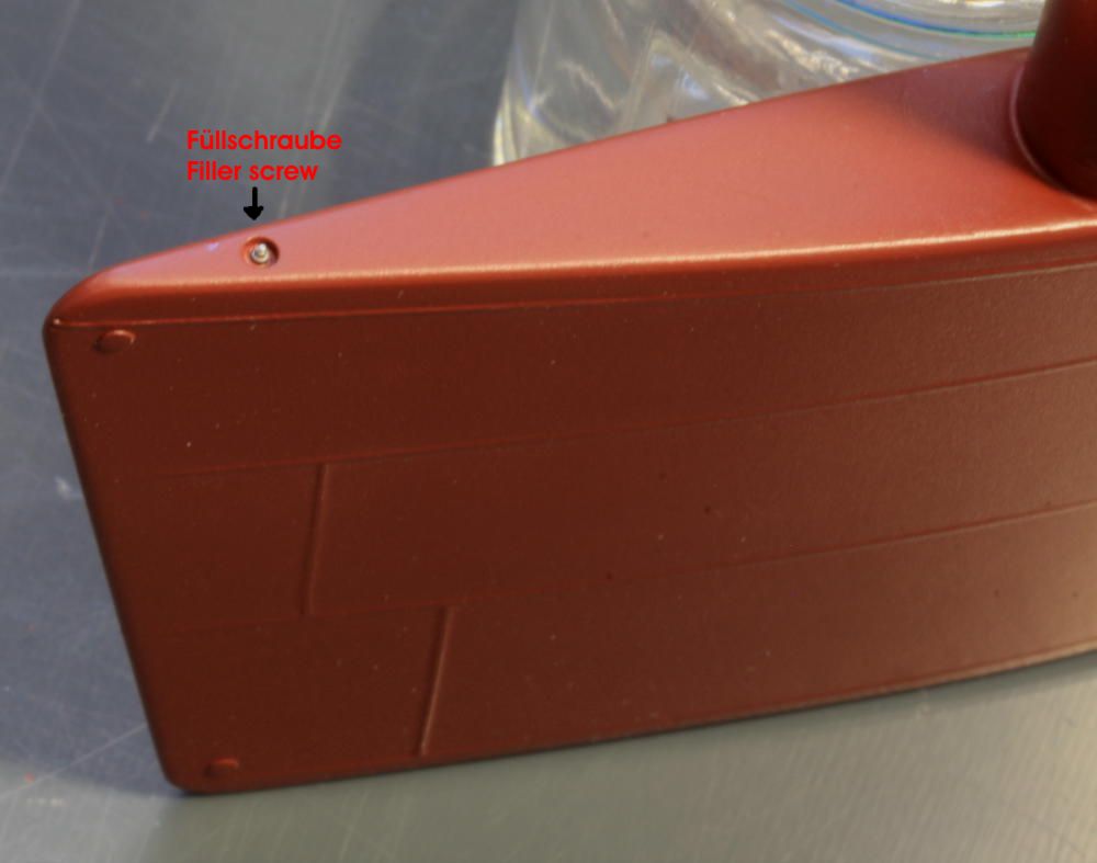

Concerning the rudders. I've noticed the filling and emptying thread holes on top and bottom of the rudders, do you know if they fill the rudders with fresh water or oil ? It seems to me that filling the rudders with water they reduce the Archimedes forces on the blades so the trunions are not unnecessary loaded, but the fresh water can corroed the rudders, for this reason I am wandering if they use oil instead.

Hi Rafael,
Camber: yes, correct frame number. The radius is constant a along the ship�s length.
Rudder: the filler and drain screws were for filling and draining the rudder with anti-corrosion fluids after construction/repair/maintanance and also to get water out of it if it should have developed a leak. The rudderes were hollow steel constructions with frames and stringes. If I find more infos on the rudders I will post it here. So check back once and a while!

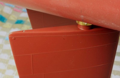

I like the idea of the welding seems, however:
they are not so well visible? And I guess even in those days they learned to grind the welds down to reduce rudder drag?
109
Posts: 627
Re: Reconstruction of hull, Battleship BISMARCK, 1/100 scale
Post by 109 »
Hi,
I took the pictures in a way to show the welds in a prominent way. With the naked eye there are much less visible. On some pictures of the real hull and rudders welds are sometimes clearly seen, somtimes they are hardly recognizable ... it may depend on lighting characteristic at the moment of fotography ...

109 wrote:Hi,
yes i one pic saw who show what you saying.
really the welds in the pic i saw show clearly the welded lines :cool_1:
109
Posts: 627
Post by 109 »
Hi,
but that foto is a good source for weld seams and how well they could be seen under favourable conditions.

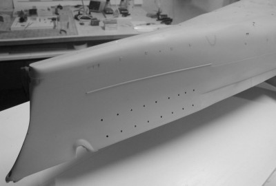

I saw the drawings of the Tirpitz hull from Hans Gally and they show an interesting detail on the bow area. The bottom plates of keel are not straight from bow to stern but has a rising up from the frame 216 in about 140 mm at the frame 239. It was really like that? 140 mm doesn't seems too much for such a big ship? Anyway, what was the purpouse of this rising up of the kell bottom plates? Had the Bismarck the same detail as I am afraid of ?
Another detail on the bow of the Tirpitz called "Schallanlage". During launching such a detail was not there according to the pictures I have, but it could be added later. Was it really there ? and again, what was the purpose ?
No, this was unique to Tp, it was not a real design feature, it was a measuring error when the ship yard had to lengthen the slip way to accommodate the large Tirpitz hull � German engineers make as much errors as all others, too! ;-) :-)
Yes, the SCHALLANLAGE or active sonar was there as it was on Bismarck. I am in the progress on researching Bismarcks sonar devices, as soon as I settled on a possible solution I will post infos here.
I attached a photo of Michael Otten�s 1:150th scale Tirpitz hull showing Tirpitz�s sonar devices.

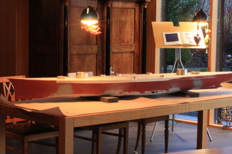

Hi,

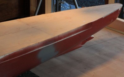

I glued the main deck into the hull � now it starts to look like a ship! :-)
Weight of the hull at this stage 10.1 kg.
I also placed the barbettes temporarily on the deck.
Bye!
