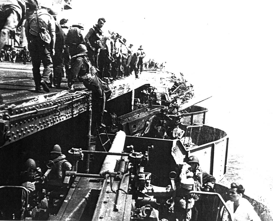

Dick J wrote:
lvsquarerigger wrote:An interesting topic has come up over on this site. Someone brought up the difference between the height and shape of the splinter shields on the 5" gun tubs on the Trumpeter kit and photograpnic evidence of the same. It seems the ones on the kit scale out at about 2' in height while pictures show them to be midchest high or so. This can change with the height of the individual in the photo but they are clearly higher than depicted in the kit opening another whole area of scratch building to rectify.
Something you may want to consider before you jump through all the hoops is the difference between the inside dimension of the kit splinter screen vs. the outer dimension. How thick, scale wise, is the kit deck? In 1/700, in order to have something strong enough to handle, and thick enough that the glue doesn't melt it into nothingness, we are faced with a trade off. Either the inside or the outside dimension is reasonably accurate, but not both. This leads to another trade off on the height of the weapons inside the tubs relative to the height of the screens. And the correct answer is ? . . . . . . ?
I wasn't thinking so much of thickness as it is probably impossible to get that part correct and still have something that holds up. It was the height and shape of the shields I was looking at. There is one shot that is looking back over the port side tubs right in that angled section of the flight deck that clearly shows the rounded portion at one height and then it rises up to a higher height between them and continues back toward the ship at that height and this is nowhere in the kit, or any I have seen for that matter.
Jim

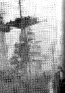

Hi Martin,
The "blurry object" on the former 8" control station (spotting top) is what Michael Vorrasi and I have been trying to ID for some time. With the newly discovered antenna on Yorktown's stack (see Yorktown thread), we are wondering if the mysterious Lex object could be something similar. In the book "The Lexington Goes Down", by A. A. Hoeling, he talks about the "new secret radar room two levels above the bridge" which they had not yet gotten to work. It is interresting that they kept the forward control position, but removed the after one when the guns were unshipped.
Another question I would like answered is about the MK-19 directors. Friedman indicates that the RF and control position were combined, leaving the "former" RF positions free for .50 cal mg's. I would disagree. The combined MK-19 units can be seen on the Pensacola and Northampton classes (as a fairly large "box") and on the Pearl Harbor battleline. Lex never carried the combined units, even if they were planned. If you look at the RF positions, the supposed "gun barrel" is never in any position other than straight vertical. The RF had a vertical periscope attached (see pg 99 of the Stern book), and I believe that is what can be seen, even in the "burning and sinking" photos. (And enough locations for the correct number of .50's can be found elsewhere.) I would like to see a better photo showing what the non-RF component of the system looked like. Also, few people notice that on both Lex and Sara, the center section of the foretop, where those directors were located, was extended forward, probably during 1941.
I guess I have the typical gripe - more questions than answers!
OK guys, here's my take on the fire control situation. The 'blurry object' is certainly a puzzle. My best guess is that it is a signal flag (see first image). On the other hand, in the second image taken from a slightly different angle, but probably a couple of hours later, there is no signal flag there but there is still something indistinct there above the 8-inch spotting top. Frankly, I haven't made up my mind.

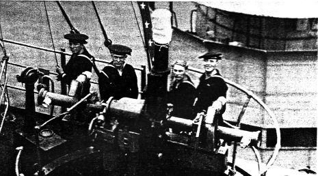

However, moving on to another area of debate, in both these pictures you can just make out the range finder atop the flag plot. In the second shot you can clearly see the starboard side range finder tube sticking out. The third photo shows the range finder atop the pilot house, about 1937, before the flag plot was constructed above it. Now, I had always assumed (wrongly as it turns out) that it was a rangefinder for the 8-inch guns, and therefore couldn't understand why it was retained after these were removed. Having just bought a copy of Naval Firepower by Norman Friedman, I now discover that this would have been a 'tactical' or 'navigational' rangefinder. It was used to help plot position of own and enemy forces and supplied data to the tactical plot. It was NOT a gun rangefinder. The tactical rangefinder was a very common fitting on the bridge structure of all pre-WW2 capital ships and cruisers. Take a look at the San Francisco class cruisers - it's very prominently perched on the foward edge of the pilot house roof. So that, I think, solves that uncertainty.

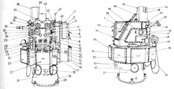

As for the 5-inch director situation, the Mk19 was indeed a divided unit. Below is a rather poor quality copy of a photo showing the ranging unit. The final diagram shows the bearing unit.
And you're quite right about the centre section of the foretop being extended. It was also a higher platform.That's very, very clear from photographic evidence. Have attached a couple of photos of how I did it for my Lexi. The Strumpeter kit is again, inaccurate here.
Hope all this helps!
Regards, Chris Smithers

Thanks for the drawing! It is exactly what I was looking for.
As for the "blurry object", I think it is way to large for a signal flag. (Compare to flags on the other side.) I am still leaning toward some type of radar antenna - but which?
