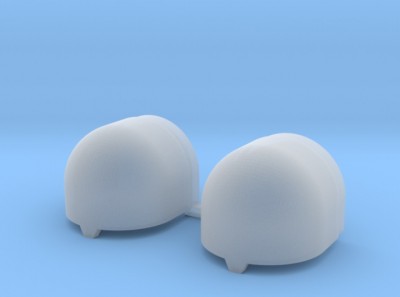

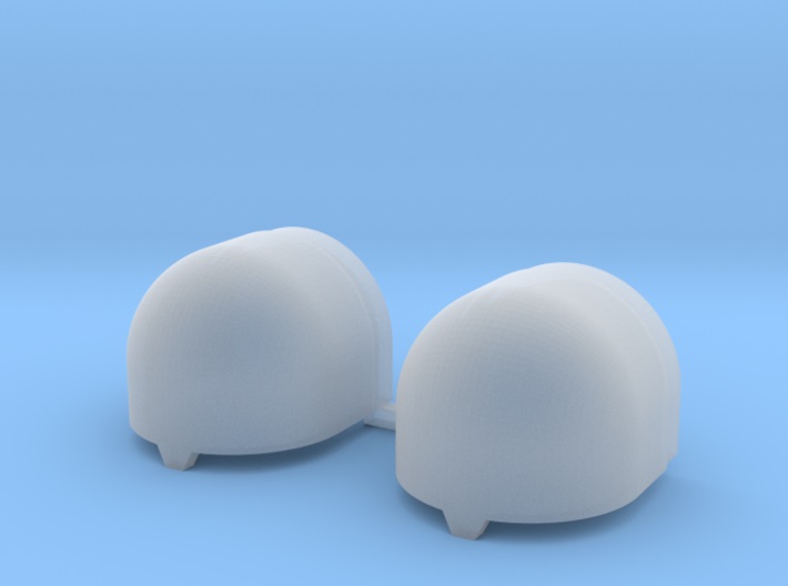

Hey everybody,
I have the trumpeter 1:350 kit in my stash, and have taken due note of the messages setting forth modications needed to backdate the glorious Prinz Eugen to 1941. Since then, there are some excitiing aftermarket products to be had, namely this:
https://www.shapeways.com/product/GKLRM ... ngefinders
I wanted to know if I needed to get anything else besides this for this backdating purpose.
I have also noted this prodcut:
https://www.shapeways.com/product/EKWL8 ... ngefinders
Thanks in advance to anyone who can help!
Edit: after reviewing the thread in question, the notes say step 14 requires "searchlight platforms, with hemispherical rotatable covers." AM I correct to presume these will fit the bill? https://www.shapeways.com/product/EKWL8 ... ngefinders
- Model Monkey
- Posts: 4096
- Location: USA
Re: Calling all Prinz Eugen/Admiral Hipper class fans
I think this product will better meet your 1941 searchlight cover needs:Sauerteig wrote:....after reviewing the thread in question, the notes say step 14 requires "searchlight platforms, with hemispherical rotatable covers." AM I correct to presume these will fit the bill? https://www.shapeways.com/product/EKWL8 ... ngefinders
http://shpws.me/ON7Z
Thanks!

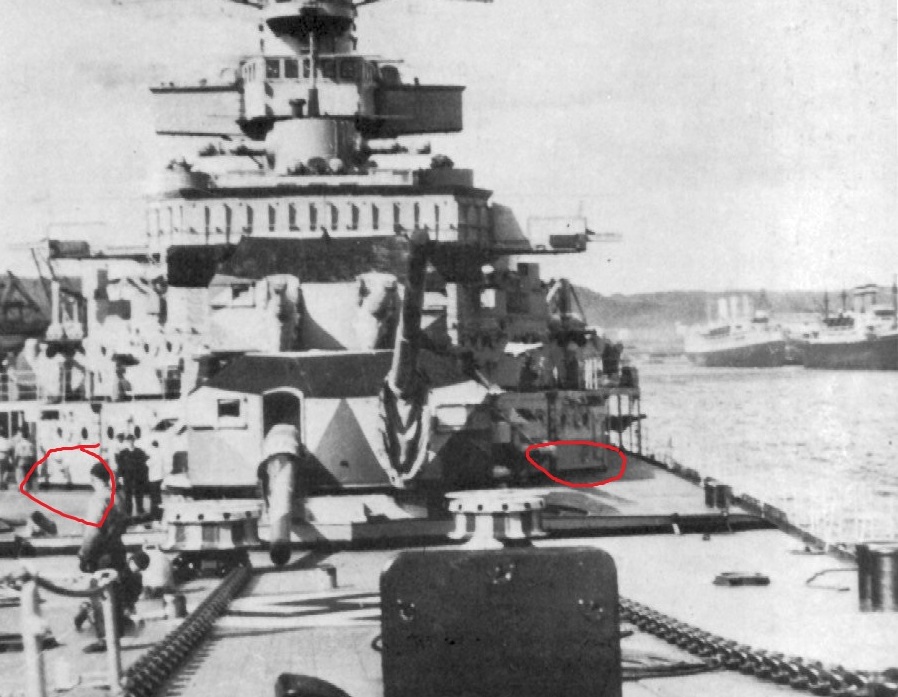

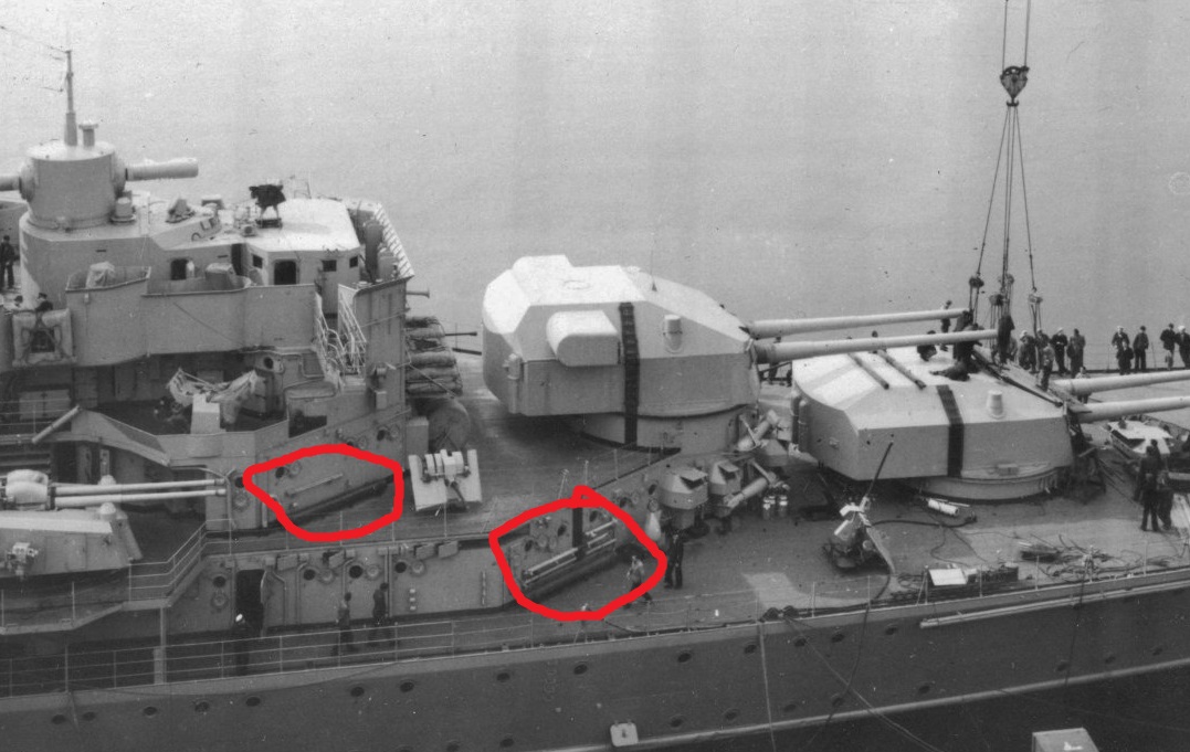

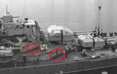

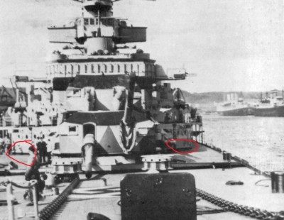

Just started to work on Eugen and decided to build it as in early May -41. Unfortunately I can't find too many detailed photos from this time and wonder if anyone knows what these tubes are - in Trumpys kit part F7. I can't see them in early photos, although it is maybe because of the poor quality, but on the late US photos they are clearly visible.
Risto
Risto
Only a guess. Containers to hold cleaning rods for the guns.
maxim
- Posts: 3969
- Location: Bonn
- Admhawk
- Posts: 950
They are booms for deploying the Paravane located on the Port side, just in front of them.
They could also be used as a davit for hoisting items up the side of the hull.
Darren (Admiral Hawk)
rvuorenr
- Posts: 50
- Joined: Thu Oct 11, 2012 10:36 am
Thanks, are you referring to the top two light gray rods?
My question is about the dark gray tube closest to the deck (or on deck), which looks more like a container than a hoist. As there are such tubes close to all main turrets the container for cleaning rods seems quite likely explanation.
- DrPR
- Posts: 1689
Did they use "cleaning rods?" We're not talking about a pistol you carry around on your waist. Large naval guns are very long, and a "cleaning rod" would have to be even longer. This would be cumbersome to handle on the deck of a ship - or the top of a lower turret.
I have seen photos of sailors pulling a bundle of rags or a brush on a rope through the barrels of battleship guns.
