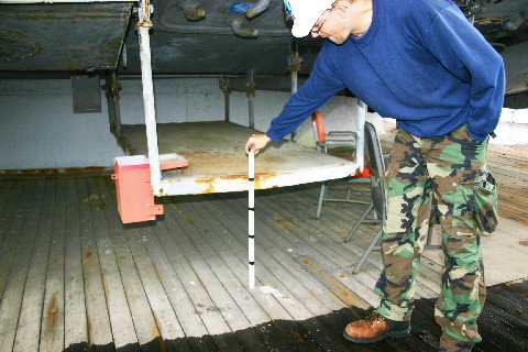

Post by BB62vet »
Flinger747 wrote:
A removable short ladder could have been used. I have never seen them installed. Easy enough to pull up into the turret when not in use. When I chipped a little paint on her in the 60's these hatches were never opened. Hank Strub might know.
Turret one is too close to the deck for ladders. Turret two (as already mentioned) had a small platform hanging under the entry hatch, and turret three has a short ladder that is lowered when the hatch is opened. I'll provide a photo showing this ladder from our '68-'69 cruise book next weekend when I'm home - the book is at my shop and right now I'm unable to post from my work computer during the week.
Here is Turret Two's hatch on IOWA taken by an acquaintance prior to becoming a museum at LA Ports, etc.:

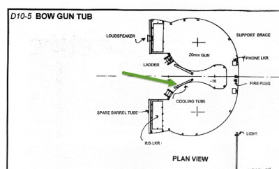

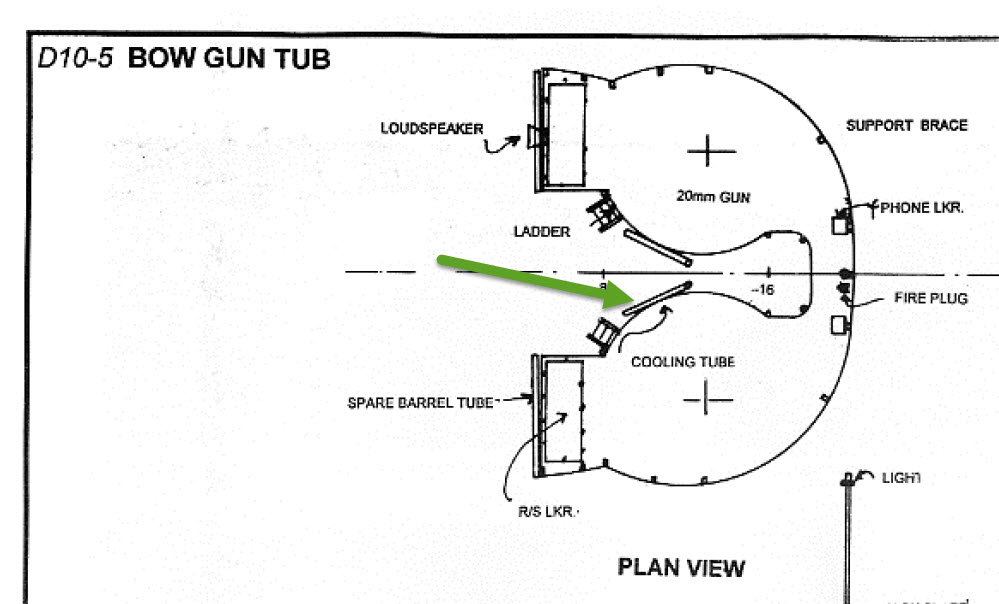

Greetings Friends,
I have The Floating Drydock's BB63 USS Missouri Plan Book on CD and in studying it, I ran across something I'd like to know.
In several places this document makes reference to "Cooling Tubes" which from their locations, I assume are for the 20mm guns.
Does anyone know the dimensions of these items? The plans show details of the spare barrel tubes for the 20mm guns, but not for these tubes. Any information on them would be greatly appreciated.
Thanks
Larry Steiner
Plastic Habit
Posts: 272
Joined: Sat Jan 12, 2013 1:44 am
Location: San Diego, CA
Post by Plastic Habit »

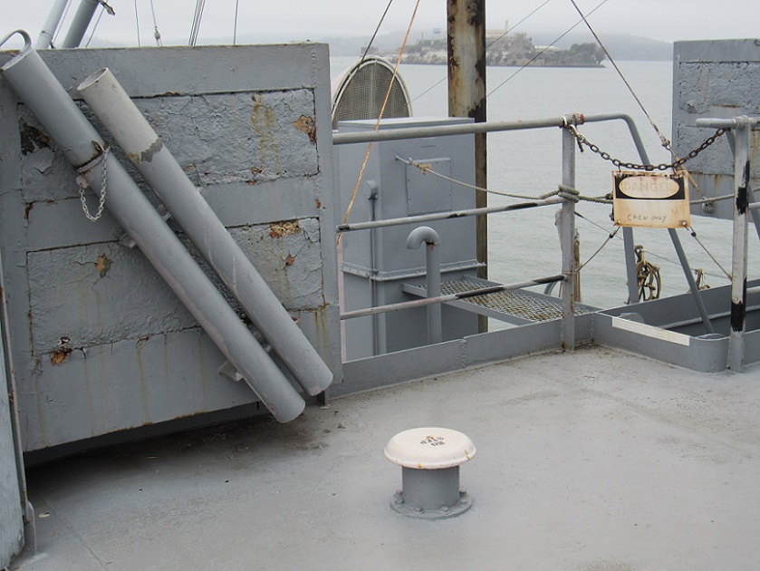

Hey Larry,
I don't have exact dimensions, but here is a pic of them on the SS Jeremiah O'Brien.

steinerman wrote:Greetings Friends,
Thanks
I've never noticed those details before..... :huh: Now I will have to look closer at the blueprints and onboard photos.
Thanks
Yeah, they are for dumping hot 20mm barrels into after changing them out to keep the guns from overheating; I'd say just pick a piece of styrene or brass tube/wire that looks thick and long enough to match the (assembled) pontos brass gun barrels...
-Jason Channell
