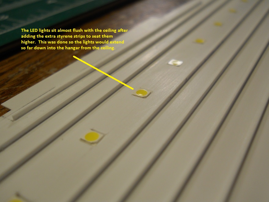

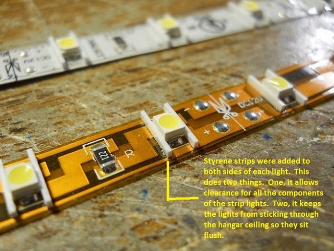

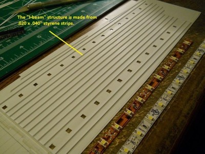

Well it seems it's been a while since I last posted, but it's because it's summer now and it's nice to be outside again. Hope everyone is enjoying their summer as well. I have started construction of the hangar ceiling and was able to find a large enough piece of styrene to use as one piece. I drew the hangar ceiling structure onto it and took care to mark areas where the "I-beams" would run. I also drew and cut out the square openings for the LED strip lighting. I also added some strips of styrene to the lights to help "seat" them a little higher so they don't extend so far down into the hangar. This way, they sit almost flush with the hangar ceiling. The photos below show the process so far as stated above.

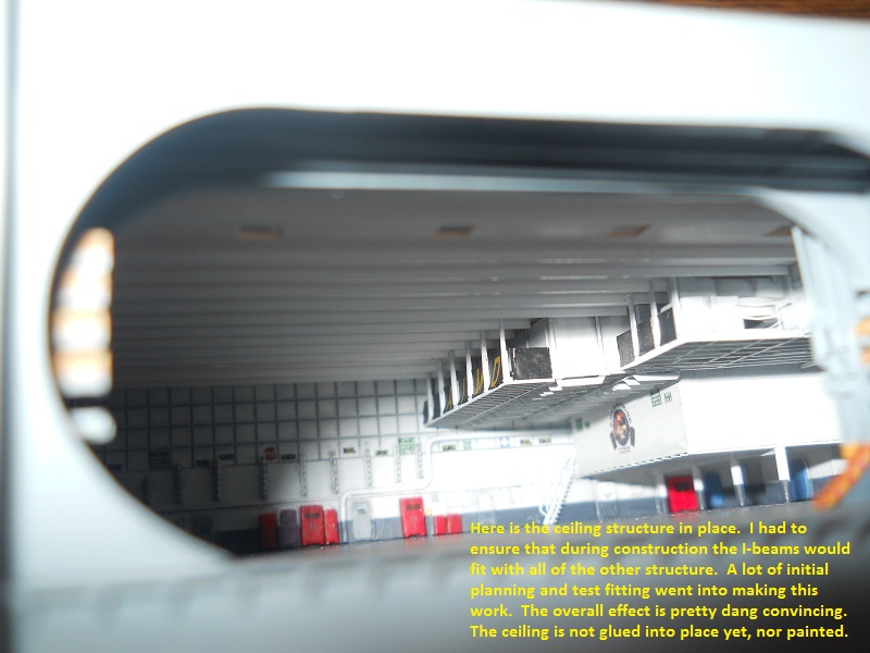

Holy Cow Doug, this is going to be the best Enterprice ever. Your celling is looking nice. Just last month i pulled out the Tamiya Big E and looking through it...and your celling is going to blow taimyas deck/celling combo away. So, please continue to take plenty of photos of how to on your celling. It's the bomb :woo_hoo:
