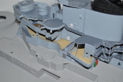

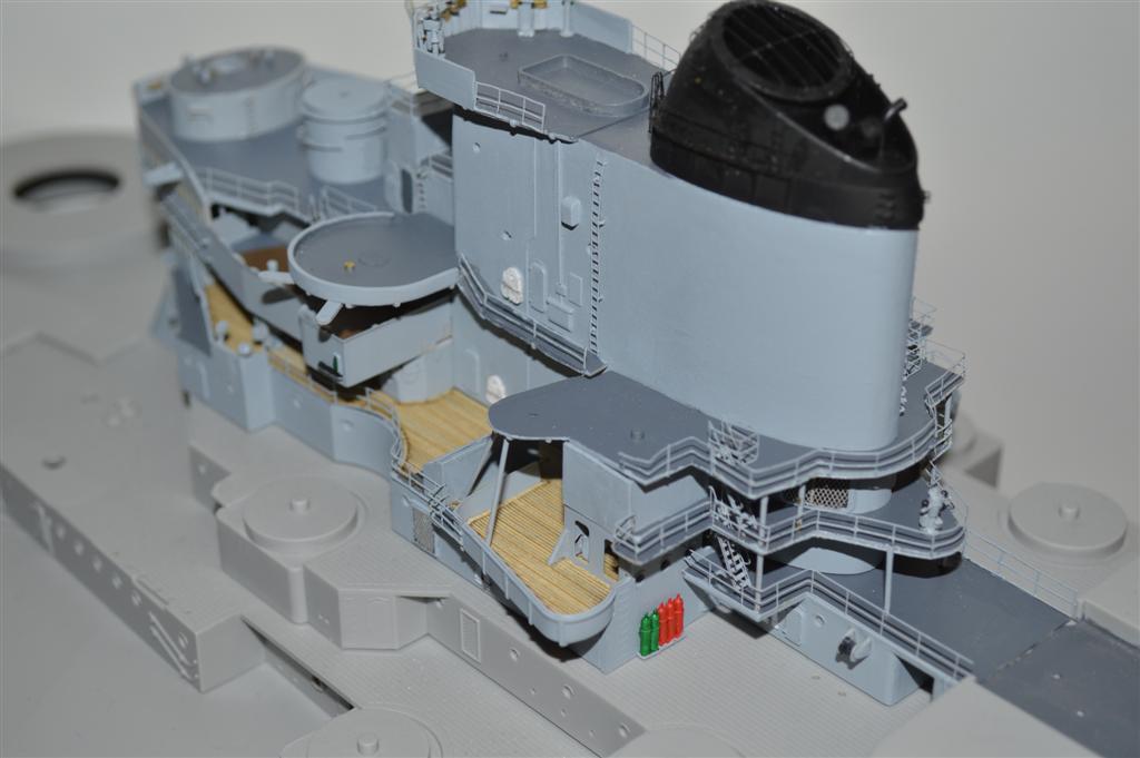

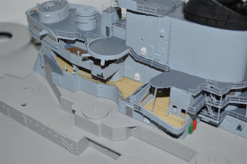

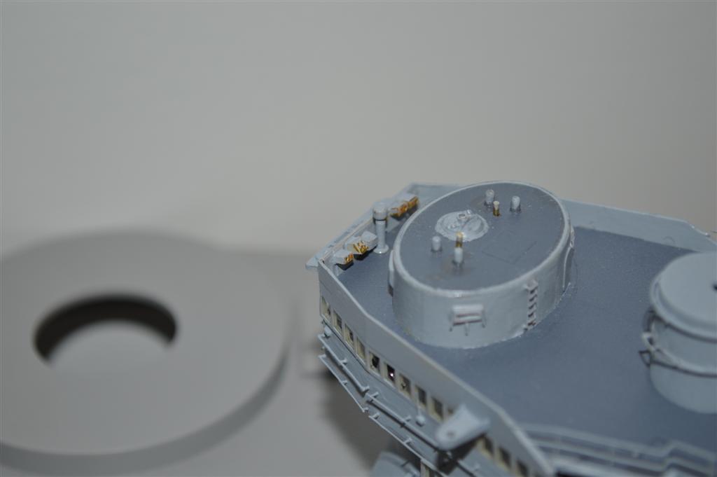

Here is a current update on work to date -
The last couple weeks or so I've been working on the 04/05 Nav Bridge/Signal Bridge/Conning Tower assembly. Here are some photos as of last night: There is some paint/railing touch-up/corrections to make but otherwise ready to have the upper conning tower mated to this assembly. I will then try to get back to working on the forward lower hull modification - putty/file/sand - which should take a few nights to get completed.

It's looking great, hank.
For what it's worth, there is a dogged hatch on the curved section of superstructure right inboard of the foremost 5"/38 mount, it also shows up on rendering of the Missouri I've seen. So I suspect it might be there on the New Jersey as well:

Thanks, Chuck - what ship was that in your photo? I will check that out in my references, but I suspect you are correct and bofore I go any further, I'll address that door (hatch).

Hello Hank:
Thanks for the update. The little details will make this portion of the model stand out nicely. Does the "windshield" come in the kit?

Hank: That's the Iowa.
