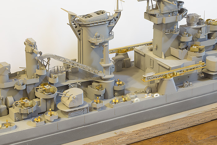

Plugging away on the micro surgery that is the Pontos 20 mm Orlikon. Have 20 of the 30 little buggers done. Keep finding new "stuff" to add, for instance a coaming hatch between turrets one and two I had somehow overlooked.

The miscount was worse than I thought on the 20 mm, turns out to be 34 instead of 30. What I did was forget there are 4 at the base of the stack on the 01 level, I only counted all the ones on the main deck plan.
Fortuitously the plastic Trumpy 20 mm have a base sufficiently similar in size to be used in place of the brass ones, so just finishing the last two.
- BB62vet
- Posts: 3174
- Location: Mocksville, NC
Re: 1/200 Scale Group Build 2015
Tom,
Your ALASKA is really shaping up nicely!! The PE parts certainly add that next dimension in detail. Relly impressive!
- Posts: 5068
Till the Alaska book shows up, coming to a slowdown of adding stuff, though there are enough Navsource etc photos to add some details such as the spare barrel tubes. Procrastinating on reshaping the stack top contours. Don't think it will be too bad.
