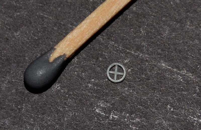

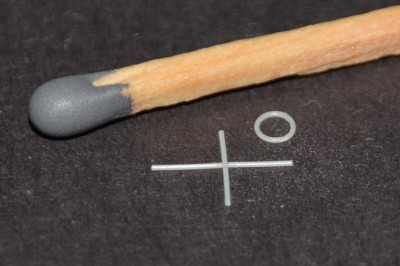

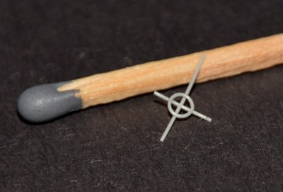

Fliger747 wrote:When I was making a plethora of hand wheels (before printing came along) I used a similar technique with very thin brass beading wire and one of my few victories in the world of soldering. I'll have to experiment with such use of sprue, certainly useful for many small shipboard items!
Why, if you are able to solder such tiny pieces, you do not belong to this world !!!!! I have never tried it myself, but I have used stretched sprue by the mile, and I can only guess that using stretched sprue is waaaayyyyyy easier, and the results are of the same quality, if not better, because they are absolutely clean.
If there is one, the only problem is to get a stretched sprue spring, but you only have to make sprue lines until you get a correct thickness, then wind it in close turns around a suitable metallic bar, and then reheat softly with a flame, making sure that the heat gets all along and all around the spires. Period. Then you have to cut circles making long cuts (this is important) and undoing the spring profile turning the cuts against each other, so that the pressure keeps the circle closed by itself. Then apply a small drop of liquid poly in the seam, and it is done. If the cuts are properly made you will not be able to see the seam anymore.
You will remember that I explained the process in my post of last Nov.9th.:
viewtopic.php?f=59&t=163082&start=220

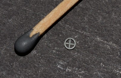

I have made today one of these handwheels, just for you to see the process:
Four parts altogether. As I used one of the springs that I already had in my spare parts box, the process took me exactly 5 minutes.
The trick is very, very easy, and as the styrene will be strong after the poly is completely dry, I would say very useful and time saving as well.
Nice going and best regards,
Willie.[/size]
