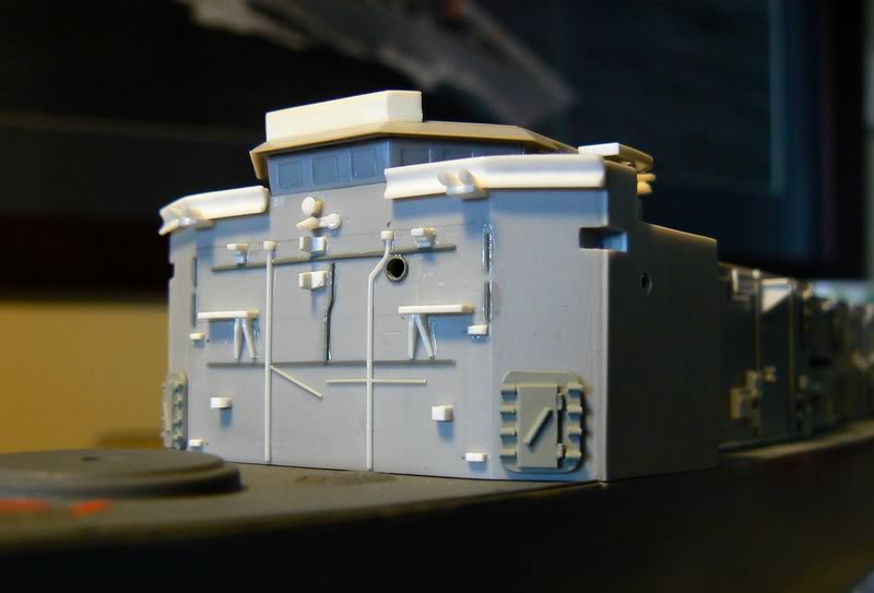

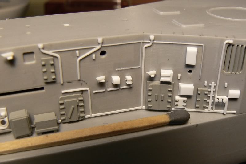

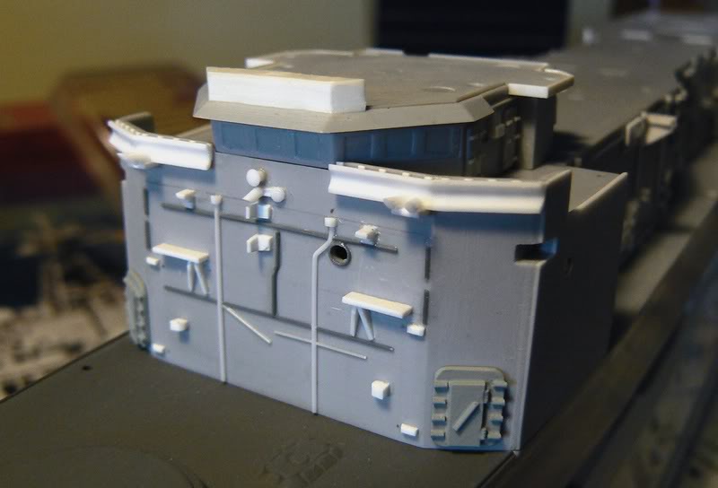

And hi all once again,:
Here you are an update of my F81 Santa Maria.

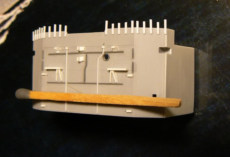

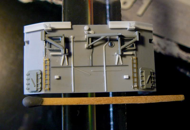

I have already made and set in place the wind deflectors in the bridge wings, using Evergreen stripes and tubing, filed and sanded to the right measures. They are now like this :
Along with the derricks previously done and already set in place -- no glue yet -- as well, the front bulkhead of the structure is like this :

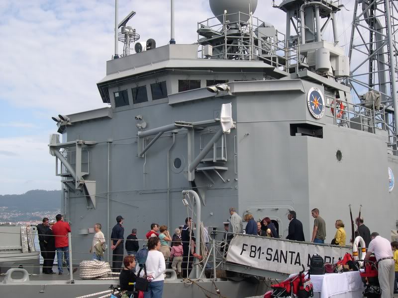

The comparison with the original shows that the result is not that bad :

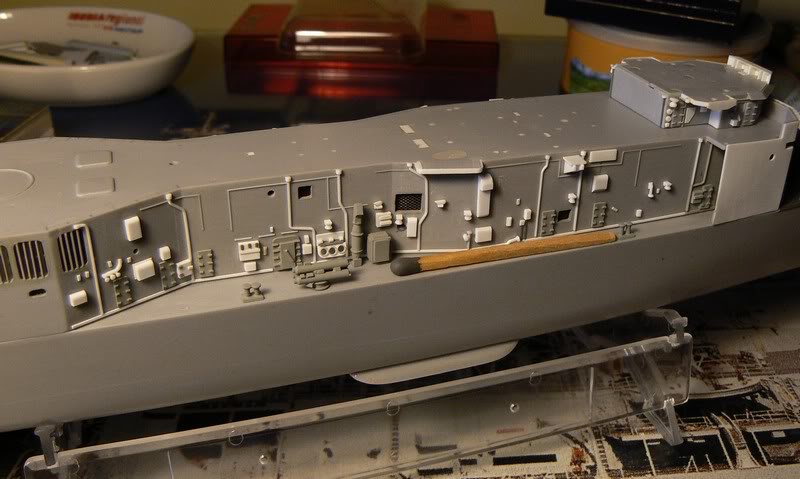

I have added as well as many details to the bulkheads as I have been able to. These bulkheads look empty, but gosh, you realize they are not empty at all when making the elements for them... Everything is stretched sprue and Evergreen stripes and rods. The placing of the atomic wash was quite tedious, because the pipes are extremely fine, and have to be cut very precisely when they cross the other pipes on the bulkheads, so that they do not look like cut or interrupted -- and the effect is realistic.
After this, I think the bulkheads are already ready to paint.

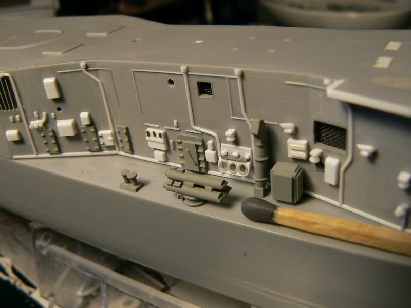

Port :
And Starboard:
And that�s all for now. I hope you like it, and very best regards from Spain,
Willie.[/size]

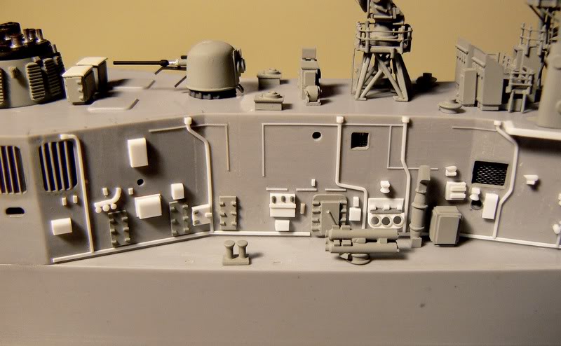

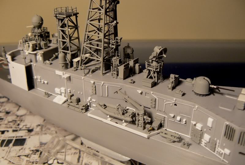

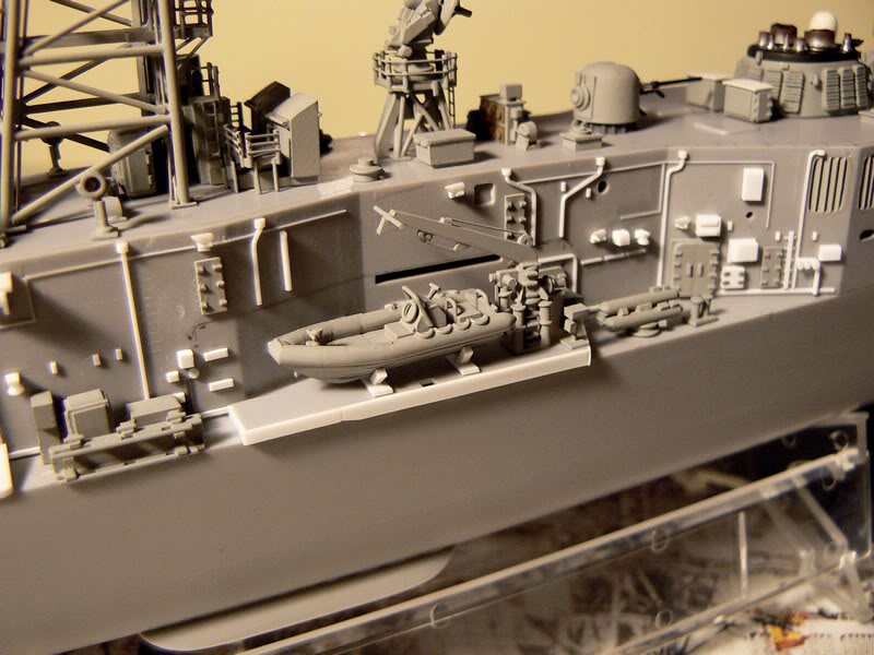

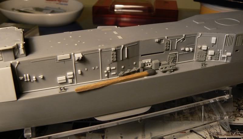

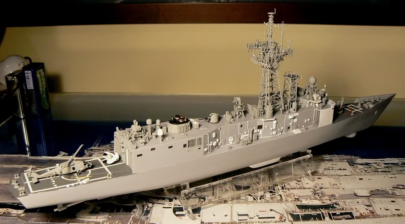

Hi again,

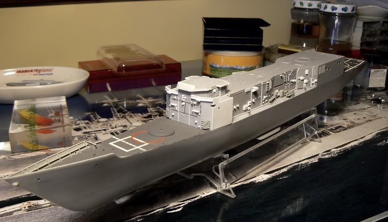

A general pic of the bulkheads with the details finished in these days :

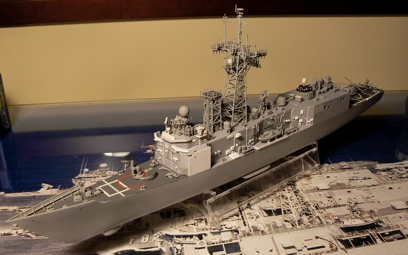

And a couple of pics with everything present :
And some general details :
Port :
And starboard:
And now -- at last !!! -- it does look like F81 Santa Maria.
Very best regards from Spain,
Wilie.[/size]

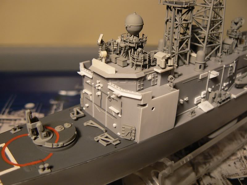

Absolutely stunning work!! Just as an FYI the red danger circle around the weapons systems extend 12 inches beyond the furthermost projection (like the nose of the missile or end of the gun muzzle), at least on US ships it does.

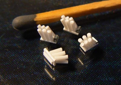

Hi Gunner and all,
Reg. your remark :
Mk 75 Gunner wrote: Just as an FYI the red danger circle around the weapons systems extend 12 inches beyond the furthermost projection (like the nose of the missile or end of the gun muzzle), at least on US ships it does.
I have double checked my picture files and you are very right : It is the same in the Spanish Navy, and I have made a mistake. But with all the forecastle finished and painted, I don�t think it is such a blunder as to make necessary to repaint the whole thing, so I will let it be, and will be aware for the next time with the OTO-Melara and next ships I build. My fault, because I should have remembered it from my own time in the Navy.

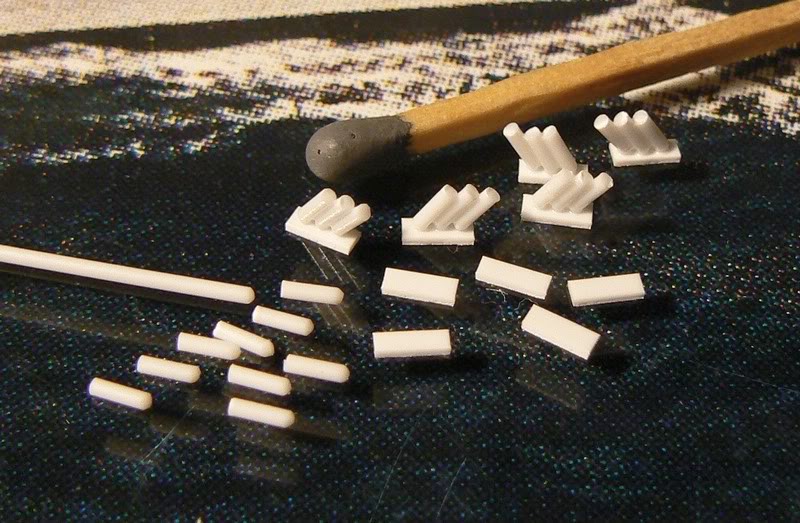

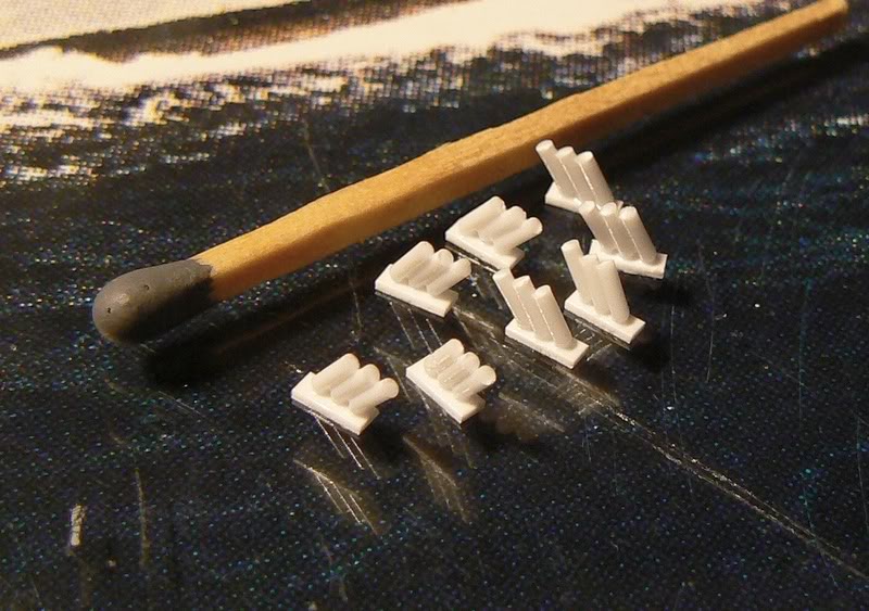

I have already made the chaff launchers, using a Evergreen rod. I tried to cut the rod at the right angles, but after some testing I was not able to get the same angle ( aprox. 30�) over and over again, so I decided to use the so to say "Infantry mortar ball base system" as easy as to sand the bottom of a rod, cut it to the right measure :
Then I had simply to set the tube in the middle in place and attach the other two, add a tiny drop of poly, and done. As easy as can be, and all the sets are identical :
I hope you like it, and very best regards from acroos the oceans,
Willie.[/size]

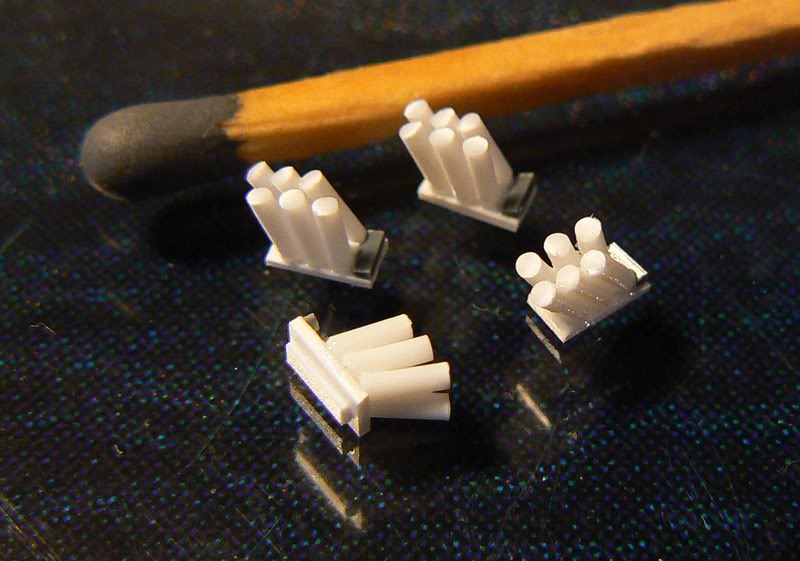

Hi all,

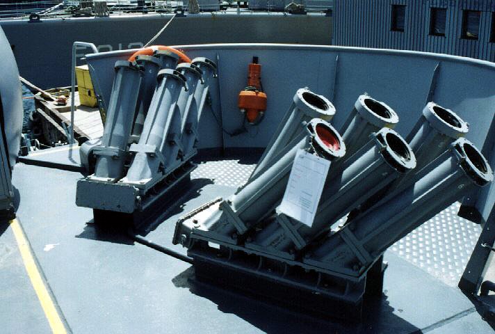

A friend modeller in the Spanish forum has let me know that the decoy launchers were mistaken in shape and tube orientation. They are actually like this :
Obviously I had been first using a pic that gave me a false perspective. I have made these pieces again, using the same method, and they are now much better, I think. To round the base of the tubes allows to place them in whatever angle :
Wilie.[/size]
