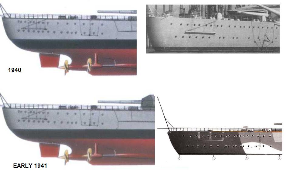

Comparing the kit, with thwe books and picturesI have, I only found problems in the portholes on starboard side.
I'm counfused... look this picture where I paste drwaings from two different books and one picture.
But as you said, one picture show 20 portholes in the top row, 14 in the lower row. I think Iwill follow it.
Oh, I see. Please, do not rely on drawings, illustrations and models for accuracy. They are only as good as the one who created them. Just two exaples from the 1940 and 1941 illustrations you posted: Note the boat boom, it's positioned to far aft - or the rows of portholes are positioned to far forward. Then, the boot-topping was NOT black. The only hard evidence is found on photos.
I don't have a real close-up photo of the stern with the dark grey paint on. So I don't know for sure the correct number of the two rows. I assume 20 for the top row, and 14 for the bottom one. The problem is the scuttle of a porthole - the 'lid' inside. If in its open position, you don't see the glass of the porthole against the dark grey paint (from the outside). The scuttle was painted a medium or light grey (I have to look this one up). As they applied the dark grey on bow and stern, the 'forgot' to paint the scuttles inside. This means, when in its closed position, you see the light paint of it against the dark grey hull (most models got this tiny detail wrong). Have a look at the ship at Grimstadtfjord, there you see a few 'light-coloured' portholes ...
