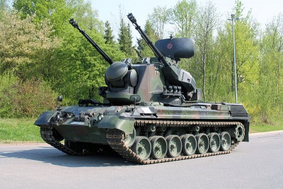

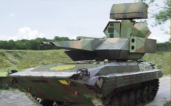

How about two land based turrets for inspiration: If you were to incorporate the radar tracking, Maybe you could co-locate mount a RAM launcher (one mount super firing over the other) and the radar could control both the gun turret and the RAM.
