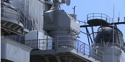

Yes - The cupula on the Mk. 37 was a WWII era mod, still present on BB63. I think you need to look over the photos of MISSOURI in her '80s configuration only; don't waste your time with other eras of the ship. If you have the Floating Drydock's USS MISSOURI Plan Book (or EPlan Book) then you can get the basic measurements of the director from that. Some times too much "associated" information can only confuse the issue. Concentrate on finding photos of Modern MO only and see where the director changes occurred.
Here is a photo of MISSOURI's port side MK. 37 director as she sits today in PH:
Hope this helps.

DavidP wrote:
would the new jersey have the same modified directors?
No, NEW JERSEY did not have the cupula on her directors:
BB62 MK37 - 1981.JPG (15.77 KiB) Viewed 3318 times
That's her in 1981 prior to her modernization
BB62 MK37 - 2003.JPG (23.04 KiB) Viewed 3318 times
Same director in 2003 as a museum, after her last commission
Hope this helps,

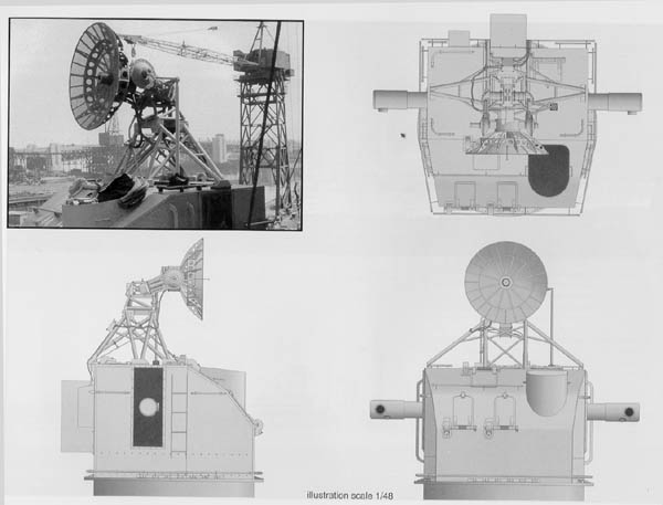

BJS wrote:
It looks to me like the back of those o n the NJ is curved.Yet I have encountered no diagrams of a MK 37 showing a curved back.
NEW JERSEY (and the other 3 IOWA class ships) do not have curved backs on their Mk. 37 FC Directors. Here is a good example of the typ. MK. 37 from the Warships Illustrated CA-139 booklet:
This illustration is of the director with the cupula, NJ's do not have the cupula and as far as my photos go back (1945) never did. You might check NavSource to verify this further back. The director Mods also differed in the number of frontal face openings they employed.
The Trumpeter model of MISSOURI does have the director with cupula which for my purposes was incorrect. Model Monkey provided the correct Mk/Mod for building a correct NEW JERSEY (regardless of era).
Hope this helps,

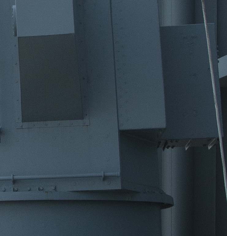

bigjimslade
Posts: 463
Post by bigjimslade »
Here is the kind of thing that is confusing me. This picture of the NJ appears to show a rounded back, squared off by a triangular filler at the top. The position of the range finder covering suggests little angle in the photo.

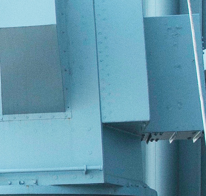

bigjimslade
Posts: 463
When I looked at the photo uploaded (especially when resized to fit the limits of the site) the details I referred to were not clear. Here is a filtered version that shows the triangle more clearly.
bigjimslade
Posts: 463
DavidP wrote:that back is not rounded but angular because of the bottom of that triangular piece has straight edges not curved.
Yes, it could well be faceted. Yet I have found no diagrams showing a MK 37 with a faceted back.
