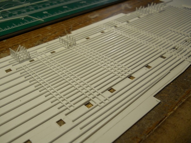

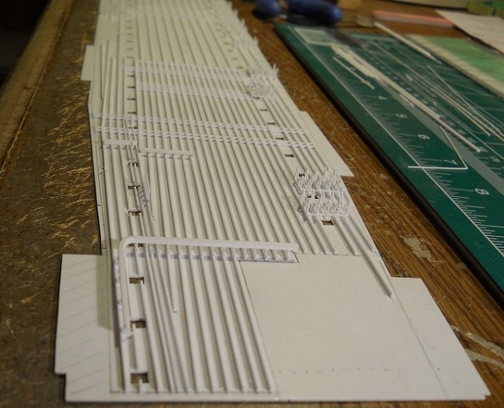

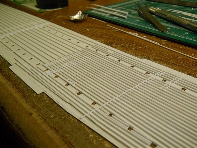

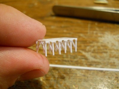

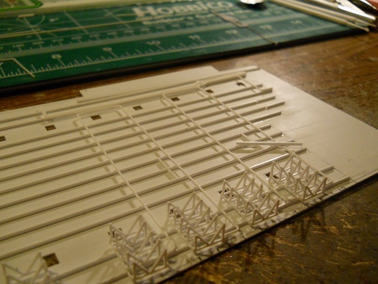

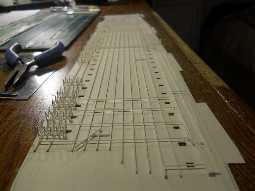

Holy cow man... You are setting the bar awful high for me to try and do something with my 1/350 Nimitz! Where do you buy your plastic for making the stiffeners and additions? did you make the sponsons too? I'm going to have to modify/create sponsons for the CIWS on mine to make it look like the Carl Vinson from 01 (when I was on board). I also have a few pics of the Enterprise from 01 when we did a vertrep with themDWD wrote:Thanks a bunch you guys. I really appreciate all the comments from everyone. Things are still obviously progressing slowly...... I have been working on creating my own drawings for the hangar ceiling so as to get better placement on the drop tank racks, AFFF sprinkler system, and the RAS posts, which I still plan on adding. It's not going to be near 100 percent accurate, but it will go a long way in providing good representation and should look pretty dang cool. I promise to post photos as soon as I have anything significant built.
Laci, I appreciate your interest in my racks! HAHA and rest assured, I am fine......no crazier than any of the other excellent flat top builders on here.
Ryan, I appreciate your confidence in my work man. I have watched your builds on here for some time now and have watched you getting better and better with every build. Pretty damn inspiring man. We can all benefit from each other with the stuff we share on this site, so thank you.

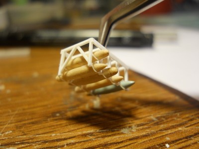

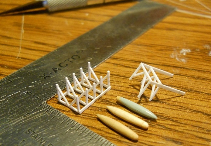

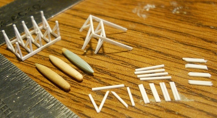

Hey medic08, it is possible that the fuel tanks in the photo could be possibly made from bamboo skewers. I know I used those too because they were a little thicker, but I kept running into them falling apart and splintering when I was trying to shape them so I just scrapped them altogether. I may have had just a few that turned out alright and they may have ended up in my photos. I attempted to use Mr. Surfacer 1000 to coat the wood/bamboo so it wouldn't be so porous and grainy. That is the case with the grey tank in the photo. The majority of the ones you see are in fact regular round toothpicks, so it must just be the photos. I think I may even try plastic rod, if I can find a suitable width.

Hey Caleb. The plastic is Evergreen sheet styrene in various sizes and purchased from local hobby shops and online hobby websites. And yes, I had to scratch build the sponsons. Thanks for the photos man and following my build. Good luck with your Nimitz!Calebgilmore wrote:Where do you buy your plastic for making the stiffeners and additions? did you make the sponsons too?
