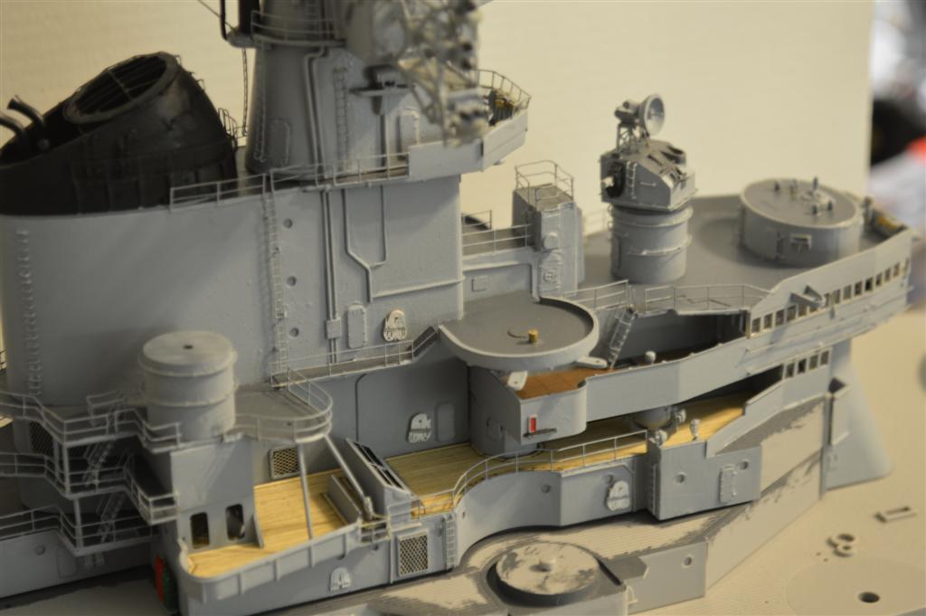

As of last night (Wed. 18 Feb 15) here is the superstructure at this point:
The Conning Tower/Mast is now permanently attached to the bridge assembly. 08 Level Conn Station canvas railings will be added (but not the canvas - leaving open). I have not added the side Mk. 37 directors or any of the long whip antennae as I don't trust myself to NOT knock them off simply by being near them
I've started work on the 02 level superstructure - adding vertical hand rungs, A/C vents, details such as that - may take a week or more to get it ready for putting everything above in place.
- Posts: 5068
Re: 1:200 USS NEW JERSEY (BB-62) 68-69 (Trumpeter MISSOURI k
Clean and sharp! You might check the NJ positioning of the ladders from 02-03 at the aft of the flag bridge, on Missouri I believe they were on the fore aft bulkhead, not the awarthships one. That is of course a different sister and was a WWII setup. I'll check and see if I find any direct ref to NJ.
I still haven't permanently affixed the tower to the 05 and rest to the 03 level yet. Held on with magnets, keep removing to add or change stuff. Eventually they will be semi permanently attached, probably with machine screws. Probably the same with the superstructure to the main deck.

- BB62vet
- Posts: 3162
- Location: Mocksville, NC
Thanks, Tom!!
I'll check the ladders out - I'm still missing a few that will be placed once the 02 Level is ready to be incorporated into the whole assembly.

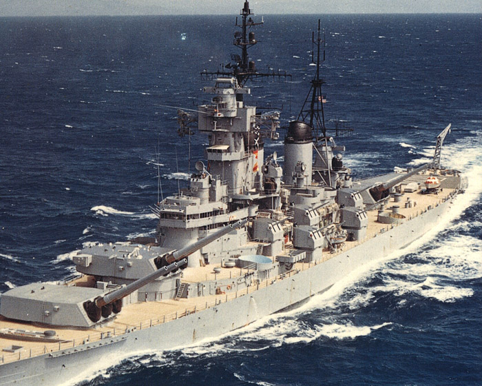

Hello Hank:
Neat update! Looks like you have made some progress. I have a photo of NJ off a calendar. If I can remember, I will snap a picture of it and post it here. Some good bow on shots. Who knows, you might see yourself.

- Posts: 5068
Hank:
Looking at the large color photo of NJ on the cover of Stillwell's "Battleships" (B&N) book in Vietnam era configuration, the ladder, at least on the port side, ( I presume stb is the same) from 02-03 right behind the flag area is an awarthships inclined ladder just as it is on Missouri today. Must be a for show photo as the main battery is trained out, the guns elevated, but the Mk 38's are fore and aft and there is a boat on dollies right by turret three. Perhaps just an illusion but it appears that Capt Snyder's swimming pool on the 01 level is painted aqua on the inside?
- Posts: 5068
Hank:
You can barely see the ladder to the left of the 51 mount.
Tom
Tom
- Posts: 5068
Sorry about the double photo. Ladder is also visible on the often shown NJ photo which is on p 209 Stillwell NJ.

- Mgunns
- Posts: 674
- Joined: Mon Oct 13, 2014 5:39 pm
- Location: San Tan Valley Arizona
Hello Hank:
This is off a Navy calendar I got many years ago. It is the reference I used when I did mine in 1/350 about 15 or so years ago. I tried to get some good photo's for reference, bear in mind this is a flat piece of paper so some of the images may be a little distorted.
And the model
I hope you find these images useful.
And the model
Mark
