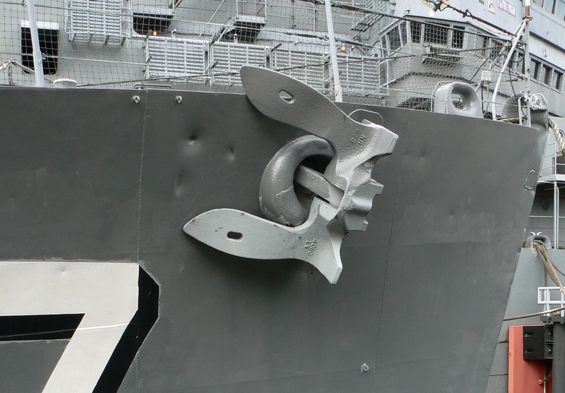

This week I had a go with the forecastle and the anchors, ship elements that I have always liked. The first thing were the anchors themselves.
I have excellent pics of US Navy stockless anchors, taken on board USS The Sullivans:
After this, I could see that the ones in the kit are good but can be improved. The flukes are OK after they have been reshaped, but the shank comes with a molded crown shackle attached to an awful looking plastic chain, so it has to be completely replaced.
The only interesting step in this first stage was to open the channel all along the shoulders, but little else. Thew shanks were carefully glued in position, so that they fit perfectly when into hawseholes. I added a crown shackle and a 10 cm. section of chain.
The anchors are set in place loosely, but they keep their position by sheer weight of the chain. The effect is good enough for me.

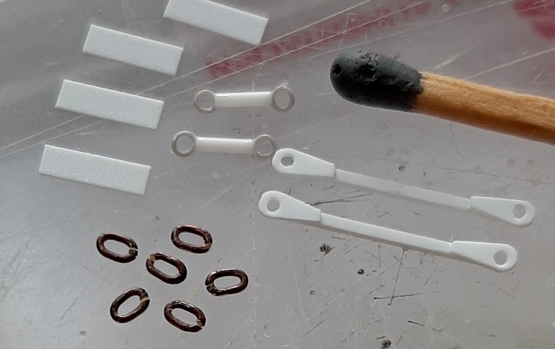

After this, the deck elements. I have no picture at all of how it was on board Jorge Juan, but I have some of other Fletchers, and all of them follow the same pattern:
The first elements were easy to build. The turnbuckles are out of scale, but I am not able to handle smaller diameter rings. I would have liked to see again the tutorial by EJFoeth in his HMS Hood thread to see how he did these elements, but the pics seem to have vanished in the air.
I completed the set with some other chain links in two diameters, and used the kit hawse covers and the winch. It is now like this:

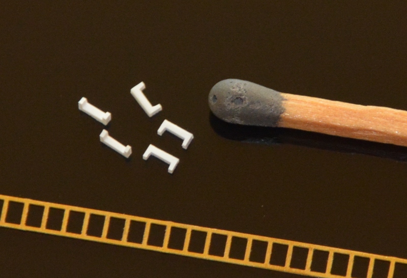

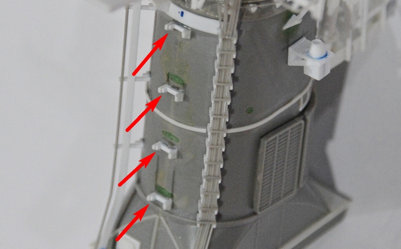

I have given another push to the rear stack, adding some more details. Firstable, the thick double wiring with two sharp curves on the left, going up from deck to the ECM domes. Apparently, as with many other elements common to all the class, there are no two ships having identical arrangements, and I have seen no clear picture of how it was on board Jorge Juan, other than it is there too. I have followed the model of USS The Sullivans, because it is common to many other units and is slightly off-side, in an ideal position to have room later to add the supports for the upper platform:

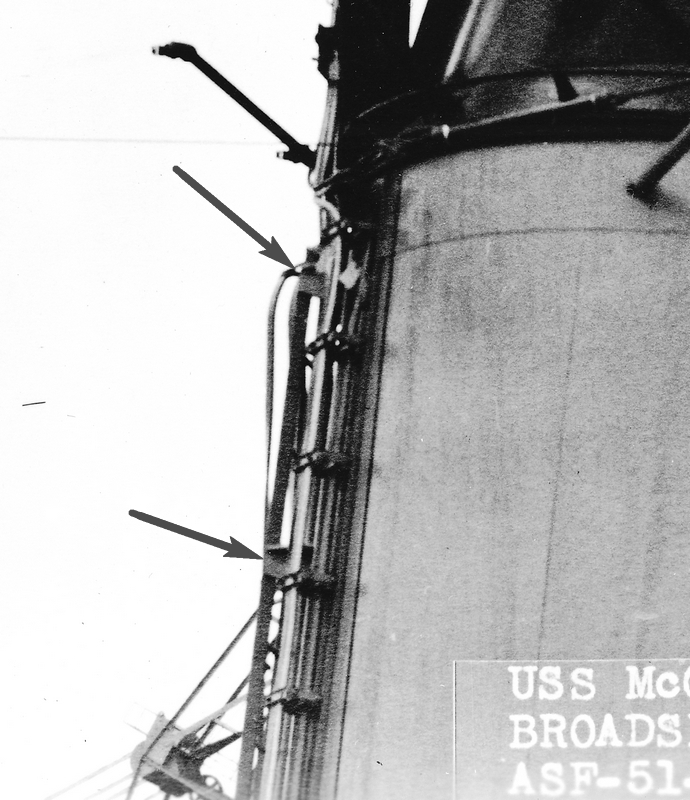

After this I tried the scale. I have one single good (but blurr) picture of how this scale was attached to the stack on Jorge Juan:
This system seems to be the common one to all Fletchers, so this solves the problem:
I cut the first elements from a 2.5 mm. Evergreen canal, which is exactly the width of the scale that I have.
When they are set in place with the "sides", the kind of step that follows is ideal to place the scale with absolute precision and no effort at all:
It was afterwards completed with scraps of stretched sprue.
I have also added the upper section of the wiring trunk, so the thing is at the moment like this:

And a new question for all of you guys. What are the holes on the anchor flukes for ? I have been researching the subject in the internet, but I have found nothing reg. this subject.
As far as I can remember I have seen them only in US Navy anchors, but I could be wrong.
