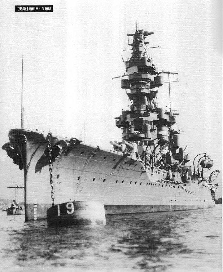

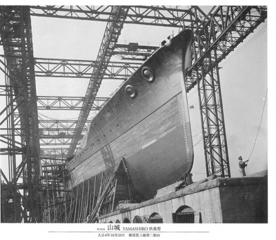

Posts: 9049
Re: Calling all IJN Fuso & Yamashiro fans
Post by Dan K »
Photos that I have are not clear enough to show individual plates, only the horizontal bands of plating.

Posts: 9049
Post by Dan K »
Only two. See captions for credit

chazi
Post by chazi »
Hi .
Thank You Dan.
I thought that You have a something different then these photos. I saw these pictures in internet.
Posts: 9049
Post by Dan K »
I've not found any close-ups for these two. Any plating pattern has to be inferred from similar classes.
