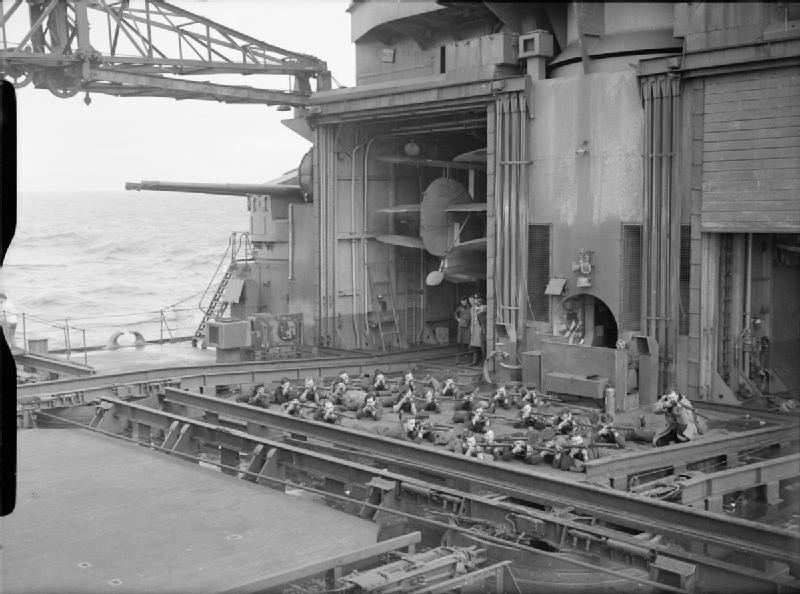

anyone got pictures of the inside of Repulse' plane hangers?
Post by Allan McBeath »
anyone got pictures of the inside of Repulse's plane hangers? Ive found pics of Queen Elizabeth's and guess they might look similar. However Burts diagrams seem to show different internal bracing to QE or Renown.
Also any idea as to hanger color? In pics it looks a grey. Same for Repulse ?
Below pics off the net.
Your help as always much appreciated :)

Re: anyone got pictures of the inside of Repulse' plane hang
Post by EJFoeth »
That's King George V, btw. There are a few on the IWM site and I attached a cropped image of HMS Sheffield. I do not know how correct Burt is in same aspects of his drawings. A comparison between Burt and an official drawing of HMS Hood's armour layout showed Burt's distribution of belt armour segments to be imaginary. But he did give me the idea to add to lines to armour, so no harm done ;)
THE ROYAL NAVY DURING THE SECOND WORLD WAR. � IWM (A 3881)IWM Non Commercial Licence
THE ROYAL NAVY DURING THE SECOND WORLD WAR. � IWM (A 4188)IWM Non Commercial Licence

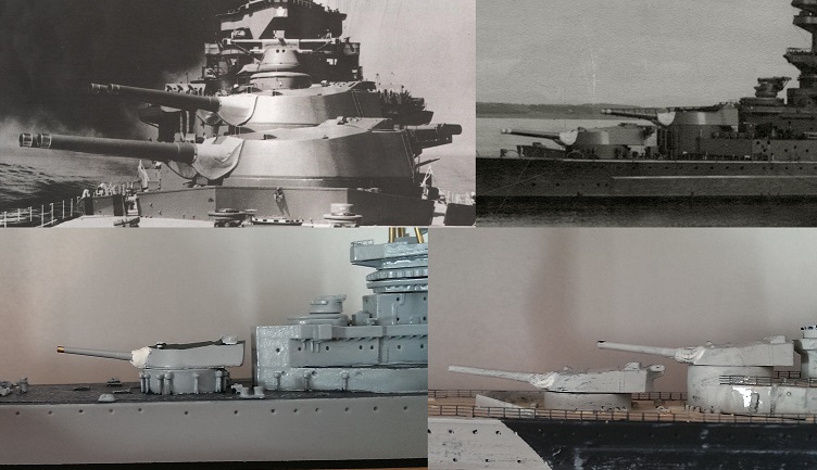

I know this has been asked before but I feel the question has not been thoroughly answered and I want to throw a different slant on it anyway.
I want to make a 1923/24 Repulse in 1/700 (yes, another one, but hopefully much better this time).
I am wondering whether the Tamiya or Trumpeter kit is the best starting point. Since the backdate is fairly dramatic, any issues regarding quality/accuracy of superstructure and AA stuff is irrelevant. What I am interested in is only hull + turrets.
OK so having built the Tamiya Repulse OOB I am very impressed with the kit. The reasons it is not a clear cut decision though are:
1) it's over twice the price, is it worth it given I'm discarding half the superstructure?
2) the upper half of the Trumpeter hull is deeper, which would make a more accurate waterline look compared to her much deeper draught in 1941 (although I still have my doubts about the accuracy of this hull split decision on their part). Any other glaring inaccuracies in the Trumpeter hull I should be aware of?
3) I want to use the ArtWox wood deck, but this is designed for the Trumpeter kit and I am not sure I want to fiddle around trying to adapt it. Would it be possible to adapt the ArtWox deck to the Tamiya kit? Is the real wood deck even worth it?
If I do go for Trumpeter though, I'm pretty sure the turrets need replacing (with the Admiralty Modelworks ones), am I right?
I also assume the Admiralty turrets are identical to the ones in their Glorious kit (which I have). Just from putting the Glorious and the (Tamiya) Repulse side by side and looking at pictures, the Tamiya turrets actually look better than the Admiralty Modelworks :-o !! Can this be or is it just my eyes?
Your input would be appreciated :smallsmile:

Re: Calling all HMS Repulse & Renown fans
Post by RNfanDan »
I cannot help you much with regard to models, themselves---but the turrets for HMS Repulse, Renown, Courageous and Glorious were, historically, nearly indistinguishable as far as their basic form is concerned. The most obvious difference in outward appearance between the twin 15" turrets of RN battleship classes and the above battlecruisers /white elephants, was the lack of "facets" on their rounded sides.
The gun barrels, themselves were essentially the same in appearance, for modeling purposes. HMS Renown's main armament was given increased elevation after 1936, and she sported armor mantlets (sometimes dubbed "eyebrows") along the forward edge of her turrets, above the gun openings. This was not the case for Repulse, so I would avoid any aftermarket turrets offered for Renown --if they are available.
Post by Vlad »
Hi Dan,
Thank you, that is good to know. Since you are not familiar with the kits (and for the sake of discussion anyway) I am attaching a comparison picture. At the top are two reference pictures of A and B turrets on HMS Repulse, below are the HMS Glorious (Admiralty Modelworks) and HMS Repulse (Tamiya) kits in 1/700 with close-up of the turret. Although the Admiralty Modelworks turret is excellently cast, I can't help but feel the turret roof is too "flat". The pictures seem to agree more with the Tamiya depiction of a turret that is lower overall and narrower at the front. Let me know what you think about this.
Vlad
