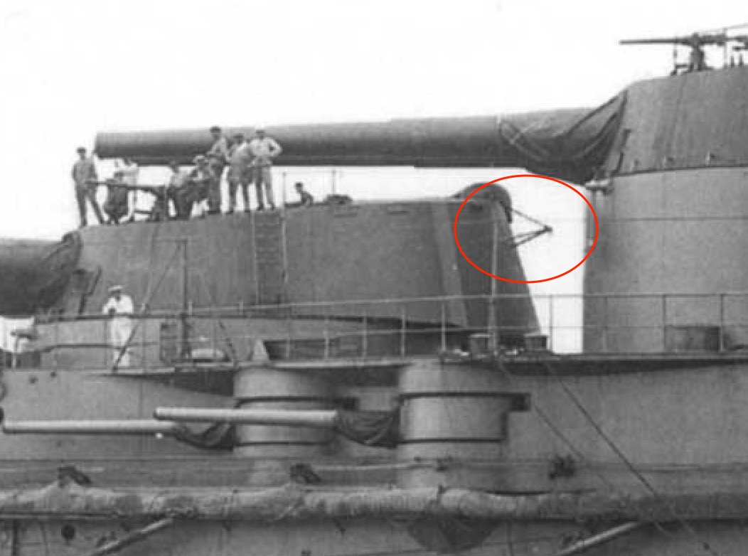

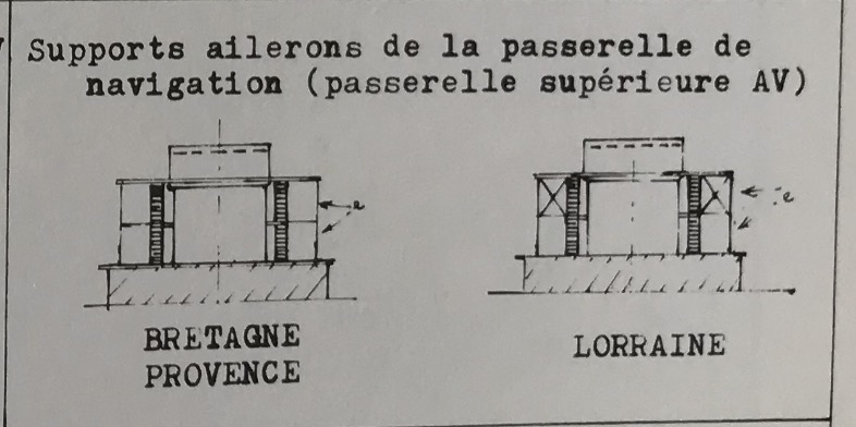

Note that the bridge stanchion are mounted longitudinally on the Bretagne and Provence battleships, and laterally on the Lorraine (with the X at the top so as not to impede passage).
Installation of the C-turret deck railings, and the stanchion on the same deck. There are still many to be installed at the rear of the deck.
Drawing of what would be the winch used to turn the boat cranes. I don't have any photos of this equipment. I used the ship's plans to imagine it, schematize it in 3D and then print it out. I waited until the last moment, hoping to find a photo or a document.
I still have the 4 garbage chutes to draw and print.

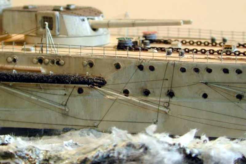

The salt rime at the water line of the ship looks very realistic.
Have you ever tried searching for patent drawings for the winches or other equipment?
While working on my Oklahoma City CAD model I stumbled across the patent for one of the winches on the ship. It had very detailed drawings of the winch and its parts.
Then I started searching for other things and found patents for the entire guided missile launching system and the TALOS guided missile! Hundreds of detailed drawings!! It was the last place I expected to find such information.

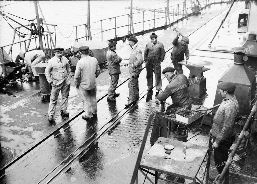

I'm working again on the sailors who will board the "Bretagne".
I'd like to reproduce the beautiful scene in this photo, which I like very much, showing sailors on the deck at the port bow of the "Lorraine" in Brest harbour and workers from the Arsenal forging parts.
I would place it on the starboard side for the Bretagne, the side that will be displayed in its showcase.
I replaced the civilian workers with sailors.
I'm starting to get a nice crew, but I need a lot more different poses.
I'm also going to reproduce this one, the sailors with their lunch tin queuing up outside the galley door on the port side of the C turret.
This scene also shows the 340mm shells being loaded into the ammunition bay.
The shells were loaded by this removable mast at A and D turret level, through a hatch in the deck.
