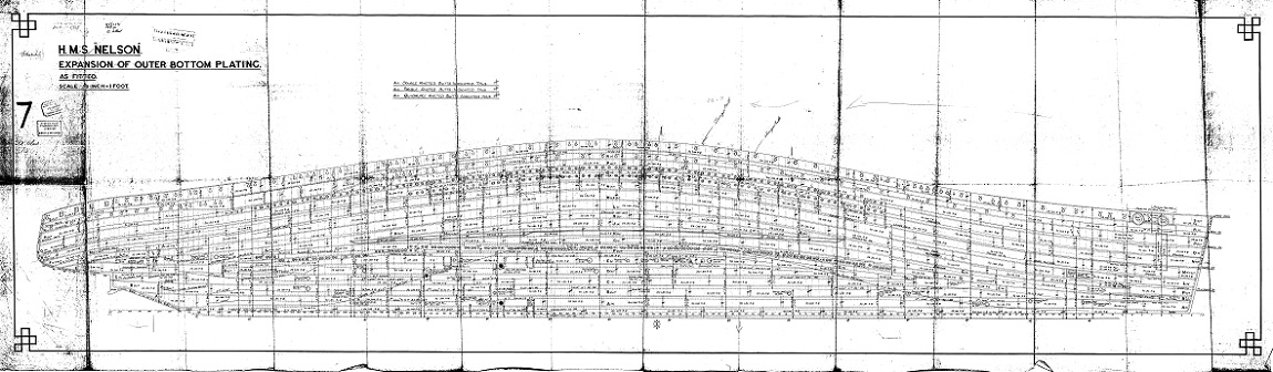

Modelist
Re: Calling all HMS Nelson & Rodney fans
Hello everyone.
I'm building now HMS Rodney in scale 1:200 from ukraine publisher dom bumagi. The model have shown a shell platting on both sides but only on upper part of hull.
I'm looking for shell expansion of lower (underwater) part of hull.
Maybe someone have any drawings?
thanks
best regards
Chris
thanks
best regards
Chris
- Maarten Sch�nfeld
- Posts: 1845
The complete shell expansion plan of HMS Nelson is in the archives of the National Maritime Museum in Greenwich. I have bought a copy of it some ten years ago, at a horrendous price admittedly. I include here a much reduced version of it.Modelist wrote:Hello everyone.

Modelist
Hello MArteen
Thank You very much for fast response. Its very nice gift for Christmas days.
Thank You very much.
Best regards
PS. I know that the prices are very high because I also bought many drawings from BundesArchive but for battleship Bismarck.
Best regards
Modelist
Hello again Marteen.
Is this possible to send in better (bigger) resolution?
Chris
Chris

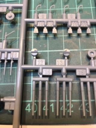

Tamiya 1/700 HMS Rodney Directors Q
I'm looking at building the 70's kit that's been in my stash for nearly 40 years.
Looking over it I noticed that the two directors atop the tower which were for the 6" guns are missing a sighting arm each.
Can someone please tell me what mark these were (Circa 1928) as I'd like to source some replacements if at all possible.
Thanks.
Thanks.

Depends how much of the rangefinder arms appears to be missing. As designed, the kit's parts A12, A13 (the two for'd 6" L.A.DCTs) and the two Parts B39 (the lower halves of the after ones), plus Parts B31 and B32 are all correctly asymmetric. The rangefinders were mounted off-centre in the structure of the DCTs to reduce the swept arc on the inboard side, so that the DCTs could be mounted closer together.

tjstoneman wrote:Depends how much of the rangefinder arms appears to be missing. As designed, the kit's parts A12, A13 (the two for'd 6" L.A.DCTs) and the two Parts B39 (the lower halves of the after ones), plus Parts B31 and B32 are all correctly asymmetric. The rangefinders were mounted off-centre in the structure of the DCTs to reduce the swept arc on the inboard side, so that the DCTs could be mounted closer together.
As you are looking at them the A12 left arm, A13, right arm, both back to the body.
Would these suffice?

The 6" LA.DCTs' rangefinders were very assymetric - the inboard arm barely protruded beyond the side of the DCT's structure. See https://media.iwm.org.uk/ciim5/419/224/large_000000.jpg (where the DCTs are trained aft, so that what should be the inboard side is outboard) and https://www.iwm.org.uk/collections/item ... /205136471 (where the port DCT is trained for'd, and the starboard one is trained to starboard). Also note that the hood on top of the DCT is assymetric, set off in the direction of the longer rangefinder arm. The model parts shown at http://www.modelwarships.com/reviews/pe ... age-09.htm give a rendition of the LA.DCTs (right-hand side, halfway down - ignore the HA.DCTs on the left, which (a) are the wrong mark for RODNEY and (b) show the aerials facing backwards!).
The Shapeways Mk IV HA.DCT to which you link is the wrong mark for RODNEY's fit - later in her career, she was fitted with a Mk I HA.DCT. The Mk IV HA.DCT looks nothing like the 6" LA.DCT.

Took a photo, it's a bit blurry but you can make out the arms.
