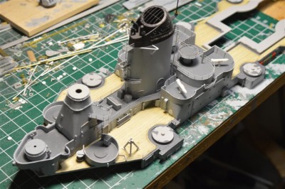

Tom,
Some of the stanchions arre in place, others not - I may not be able to fit all that were actually there; probably should have taken them into accoutn prior to putting the 04 Level in place. They are almost hidden from view.
Enjoy your lessions!

You might be able to drill a hole from the bottom and slip them into place? Probably the reason I have several levels still held together by magnets to add or re do stuff!
Cheers. Tom
Cheers. Tom

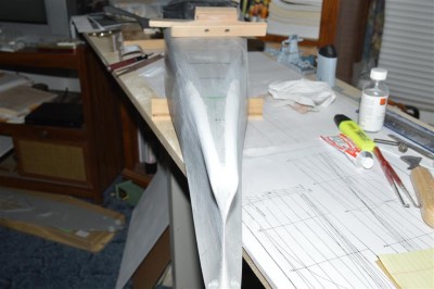

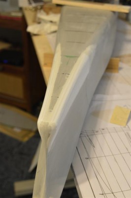

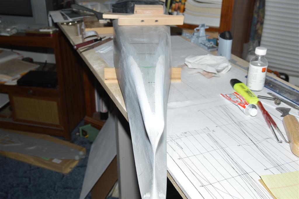

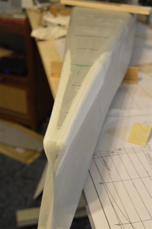

Working on two areas while waiting for a resupply of 0.03mm drill bits. FYI - larger or smaller bits don't work with the Pontos PE hand rungs - the holes need to be 0.03mm. So, that's causing a holdup on certain superstrucure work.
Here is the latest lower bow reshaping: At this point I will do some final fine sanding and then put back in place the paravane opening (the new one will be scratch built) before beginning to work on locating the hull eye bolts and hull plating. The hull is about as close to the templates as I'm going to get - One thing I realized is that mixing the styrene strips and Squadron Shop Putty is not a good thing - the strips have a tendency durng sanidng to "peel off" and as their consistency is different from the dried putty, it makes it hard to judge what's been sanded to shape and what needs more shaping. The bow is much better now than the out of the box part so I'm fairly happy with where it's at. Trumpeter really lacks badly in the molding of the 1:200 MISSOURI Hull.

Re: 1:200 USS NEW JERSEY (BB-62) 68-69 (Trumpeter MISSOURI k
I ran into similar issues on my bow reshape... eventually it worked but not without half a dozen or so putty/sanding/primer/putty... cycles to get the new curvature to blend in. I've decided it's easier to build something the right shape from scratch rather than trying to reshape something that is already wonky.
-Jason Channell
- Posts: 5068
Looking great, another milstone converted to a milestone.
Regards. Tom
Regards. Tom
Jason - Yea, this is one of those learn as you go projects. Still, it DOES look better than before.
Tom - Thanks! Not quite there yet, but getting closer. I sure wish my 0.03mm bits would get here.

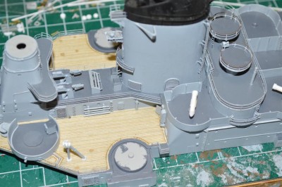

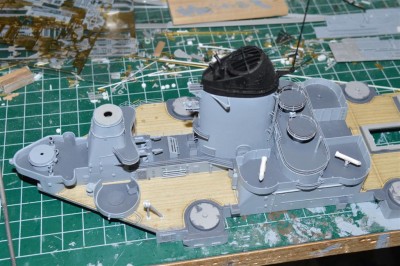

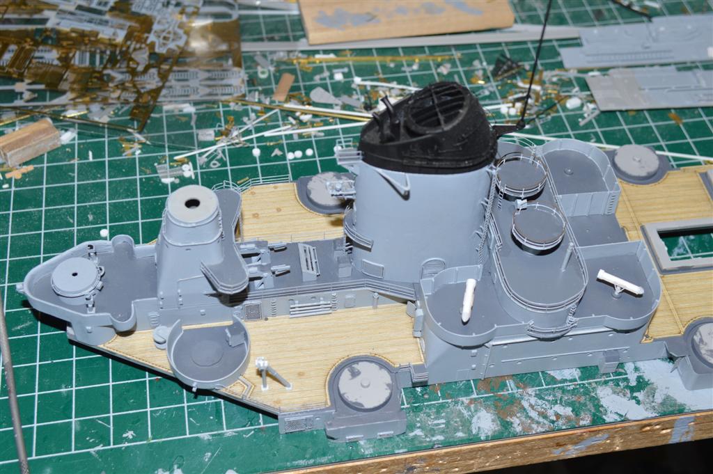

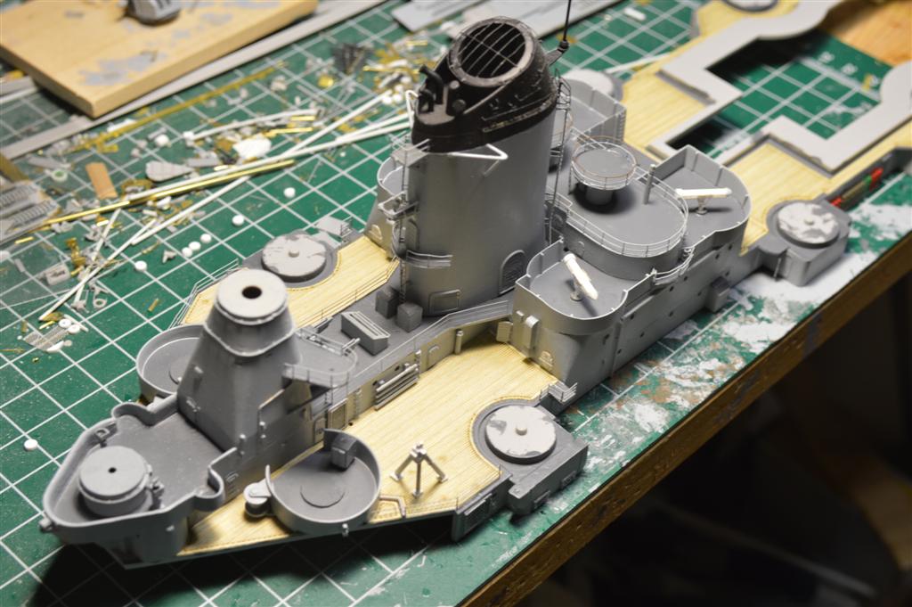

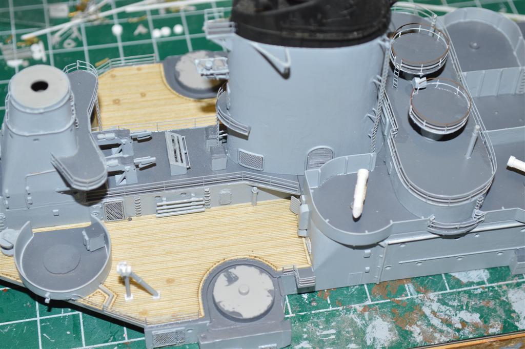

Here are a few photos of the recent work done on the After/Amidships 02 Level and Superstructure:
Much of this area has been heavily modified - the amidship 40mm tubs are now Zuni Rocket Launcher tubs and the center tubs replaced with a raised Mk. 56 FC Director Platform. Here is a closer look at the addition of various bulkhead equipment and the Refueling/High Line Transfer Tripod added in 1968:
I have also corrected various HVAC and door additons made in the 67-68 refit as well as a couple kit incorrections in the upper handling rooms to the 5" gun mounts.
With an update at work to a new desktop and Windows 7, I found that I was unable to upload photos this a.m. - so, unless it was an anomaly, I will have to wait until weekends to post w/pictures from here going forward. Hands are being tied left & right and it wouldn't surprise me that this is just another move by mgmt.. to curtail internet usage.
Next week I hope to add the forward superstructure to this assembly and then contemplate work on the main mast & arrays. I also hope to upright the hull and think about further work there.
Hi Hank:
This is coming along nicely. The work is clean and sharp. I don't know what areas you made corrections to but whatever it is and you did, it doesn't snow, which I guess is good. The wood looks great.
Nice update.
Nice update.
Mark,
Appreciate the comments. Some of the changes are subtle, others quite obvious. The kit does a fairly good job of representing MO, but maybe not so much the other 3 class ships. There were various differences, even extending back to their original construction.
