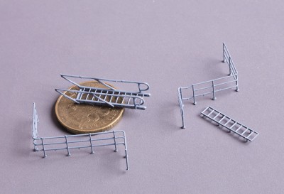

The rail for the aft section of the O2 level printed fine, in scale, but at .24 mm dia pipes are very fragile and super flexible. I am printing one with larger pipes (.4 mm) which I think will still look good and will compare the two. The skinny one is currently sitting in place but not glued down. Installing skinny (in scale) rails might be problematic in some ways. For Phil's project at 1:96 it is a more practical implementation.
I sent Hank a rail file for the aft director for his Stoddard. That one, going all the way, wrapping around the platform included a band at the bottom to attach to the platform edge and make for a new edge with the appearance of stanchions welded to the perimeter.

Yes, minimum is 0,3mm .. Not due to the printer but the mechanical resistance of the resin..

Thank you for adding your experience. I finally went with the rail that I printed at .4 mm dia for the pipes. It looks fine and is considerably more solid. Now attached to the ship and I like the ability to have a curved bend at a corner without a stanchion placed there.

So, based on Phil's specs. of pipe sizes, in metric terms @ 1/144 scale, the following is derived:
Top Rail - 0.23mm - maybe bumped up to 0.4mm as you mentioned without looking oversized
Lower Rails - 0.1852mm - perhaps bumped up to 0.3mm, etc. for strength
Stanchions - 0.2928mm - bump them up to 0.45mm as they should be the widest of the set
That's just a calculation w/o actually drawing anything in CAD to visualize how they would look.

The file I sent you has .4mm pipe and stanchions. See how it looks, my experience suggests that the rails tend to print at smaller than the nominal dimension.

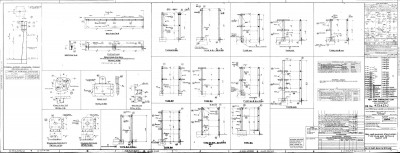

Here is a blueprint for handrails on a Cleveland class cruiser in WWII. It is a basic BuShips drawing and was used for most US Navy ships.
The 35mm microfilm image of the original 94x36 inch drawing was scanned at 1000 DPI and is 193 megabytes - a bit too large for posting on the Forum! But after messing with it in Photoshop I managed to get a low resolution file less than 400 kilobytes that the Forum accepted.
The image is a bit fuzzy but legible. If there is something you can't read I can cut out a part of the original scan and make an image of it.
Hope this helps.
Note: If you know the distances between the horizontal rails for the hand rails in a picture you have a vertical measure for "photoguestimation" of the dimensions of nearby objects. I have done this many times and it produces pretty reliable dimensions.
The only caveat is that although the distance between the bottom rail and the deck is normally 18 inches there is usually a 3 inch high x 3/8 inch thick coaming at the edge of superstructure weather decks. So in photos the distance between the bottom rail and the top of the coaming is only 15 inches.
Hope this helps.

Photo estimation is favorite hobby. I worked for years with both still and photo stereo pairs using photogrammetry methods.As always the linch pin is some known dimension. Such estimations depend greatly on being able to depend on comparison with a particular focus plane. In the event we have to surrender in many cases a few significant figures.

Last night I had printed some rail for the 04 level etc, but didn't cure it before hitting the sack, just sat it on a heating air vent to dry thoroughly. That seemed to yield a much stiffer product, it's curing now. Hopefully not brittle? There may be some optimal curing process for such delicate items, let you know what I find out. I did make an inclined ladder, I think my paper ones look equally good, with wire rails, but those are tedious to assemble!
My technique (evolving) currently is to draw the plan view of the rail, with the bends etc, rounding the corners etc as appropriate. Then extrude the line into a round section, currently in 1:120 a diameter of .4 mm. I then copy the form, move it down a scale 12", copy again for the third rail etc. The stanchions are extruded as round sections either drawn as .4 mm circles on the top rail or as a separate item and moved into intersection. To aid installation I am currently making a pad of 1mm diameter at the foot. They look huge on the drawing, but are almost invisible in practice.

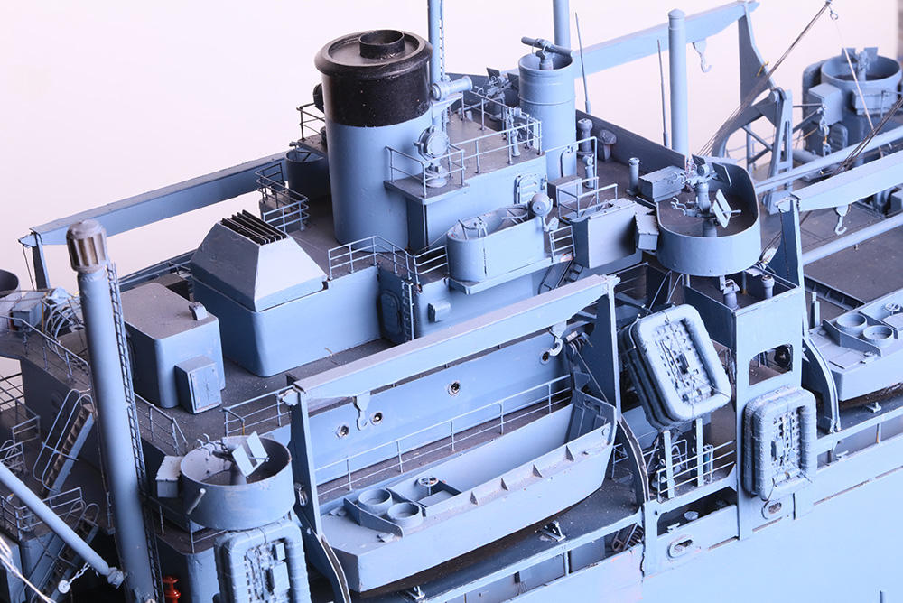

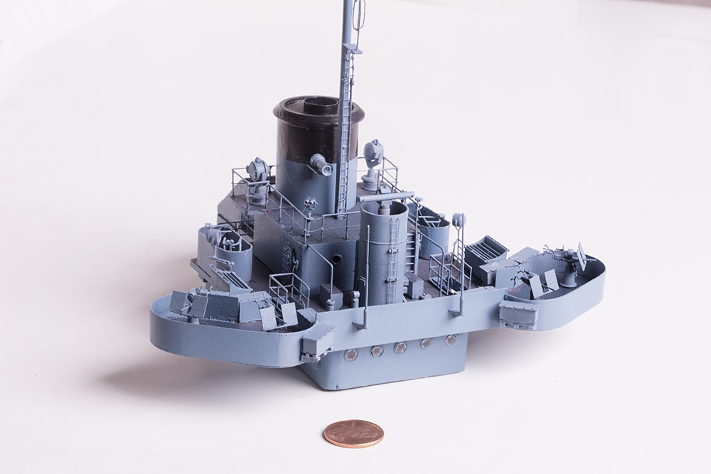

Current status of the pilot house. Note the Engine Order Telegraph just to the (ship) starboard of the rangefinder tower. I haven't seen the location of a probably voice tube, but with the compass repeaters and other instruments the ship could be conned from here.
- Posts: 5068
Re: APA project
Printed rails for the area on the O4 level aft of the stack.
- Iceman 29
- Posts: 1945
- Location: Bretagne, France
Re: APA project
Nice job Tom!
Pascal
- Posts: 5068
Re: APA project
Superstructure from abaft.
