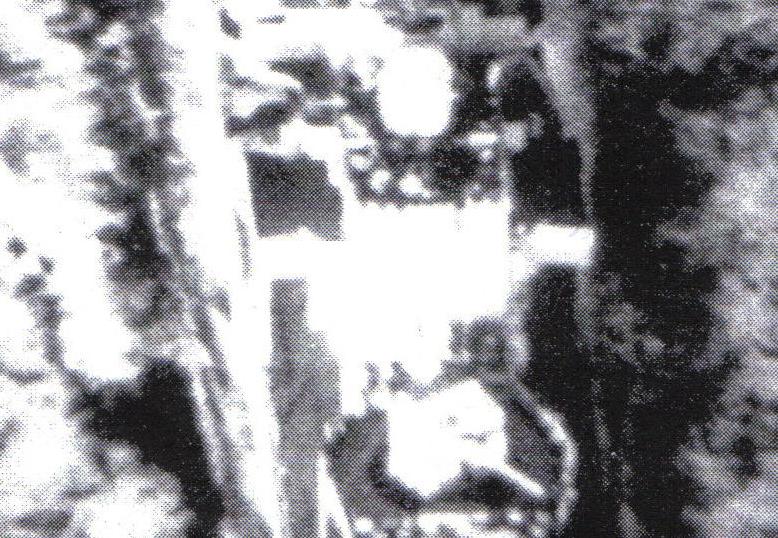

Re earlier posts on this thread, the much questioned single 20mm Oerlikon on HMS Electra referred to in the Cain/Sellwood book was mounted centrally on the light AA platfom, ie midway between the two 0.5" quads. It was unshielded which makes it hard to spot.
You can see the safety firing rail, picked out by sunlight, curving around the starboard and forward sides of the Oerlikon, until it goes into shadow over to port, in an aerial photo taken October 1941. You can also see the rail in the November 1941 photo taken from HMS Prince of Wales in the Indian Ocean. I think that you can see the bottom of the Oerlikon pedestal in the photo of Electra rescuing survivors from Repulse.
However I have now come across a photo of a Rosyth dockyard fire practice on the quay alongside �a destroyer�. The destroyer is Electra and in this photo the barrel is visible, vertical. (IWM A 5862). Date must be Aug - Oct 1941 as she is in the WA scheme and has the fixed 286 just above the lower yardarm on the foremast.
I think that we must now accept that the Oerlikon was fitted where and when Cain said: July 1940, Troon.
She was not the only A-I to have a single unshielded Mk 1 Oerlikon fitted on the lt AA platform between the quad 0.5� MGs in 1940. In good quality versions of the photo of HMS Foresight during Op Menace (whilst lowering a boat, with HMS Barham in the background, 24 Sept 1940) it can be seen that she too had one there (unshielded, barrel vertical).

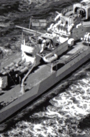

Question about the 3" gun that replaced the aft torpedo tube. How was this mounted, was it a cirular shield with a gun with an enclosing shield? This picture of Express seems to show a different arrangement:

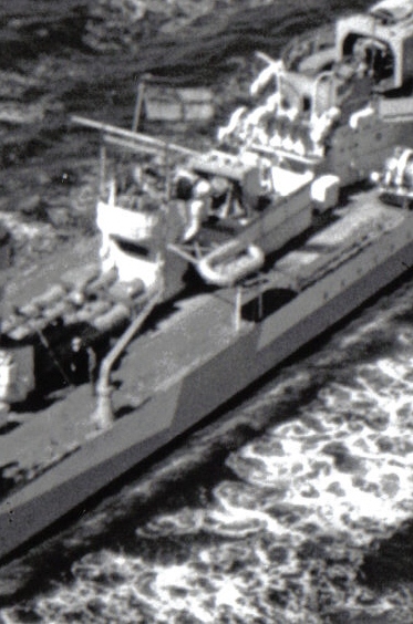

I hope that these answer the question re the 3" gun:
Express m jun 1942 crop.jpg (24.12 KiB) Viewed 6407 times

Post by Chatfield »
Dick,
thank you for this, you have saved me hours of research.

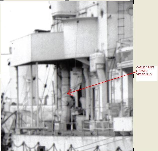

Changed my mind about the bridge wing supports. The Australian War Memorial bow photogrpah seems to show two pole supports whereas I had them down as 'X' supports. Carely floats sit behind these which makes more sense if they are pole supports.

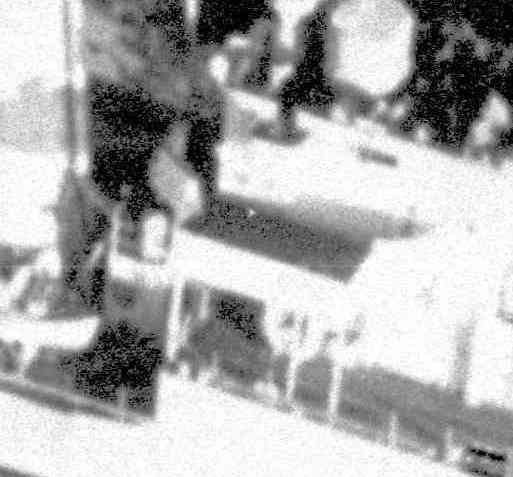

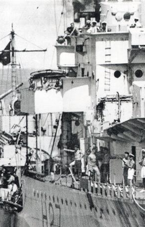

I assume you mean this photo of Electra?
Here are a couple more of the area in question.
Re the colour of the deck, for Electra in 1941, I think we can be sure it was not B30 which was not yet invented then. I guess that Hodges� comment was based on CB. R 3098/43 (May 1943) which codified things more comprehensively than they had been before. Its predecessor, CAFO 679/42 (9th April 1942), gives no direction for what colour to paint the decks of ships with the Western Approaches scheme. I think you are therefore left with the practice from before then which, as I understand it, means the bare metal areas of her deck would have been painted a medium or dark grey doubtless somewhat weathered in tone. Some areas should have been covered in corticene but that was presumably by then much dirtied and battered. MS2 seems as good a suggestion as any judging by the tone in the photos, but it might have been 507A originally.

Dick:
Are you sure that the middle photo in your previous post is of HMS Electra? It seems that in that photo, the leading edge of the extended bridge wing is at a swept angle, while in the first and third photos, it is perpendicular to the bridge. Or was its configuration altered during the life of the ship?
Thoughts?

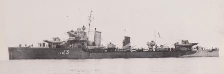

Mike,
I am absolutely certain it is Electra. You can see the top of the hull pendant numbers in the original photo, also the fixed 286 radar aerial just above the lower yardarm/just below the upper yardarm on the foremast, and this particular design of extension for the 20mm was not common.
I think the effect you see is a trick of the eye. The extensions sloped out downwards viewed from the front. This is disguised in the first ("AWM") photo by the arms of the crewmen but is clearer in this photo.
Best wishes.

Dick:
I think you're right, now that I study the photo.
Trompe L'Oeil as they say!
Thanks for that!
