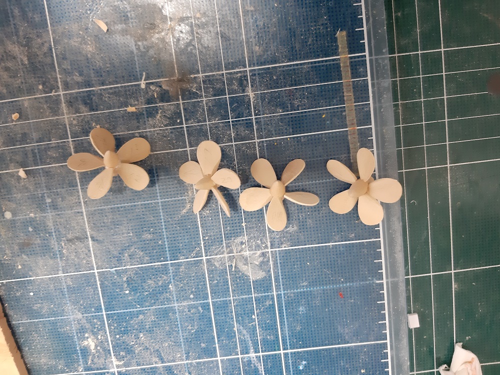

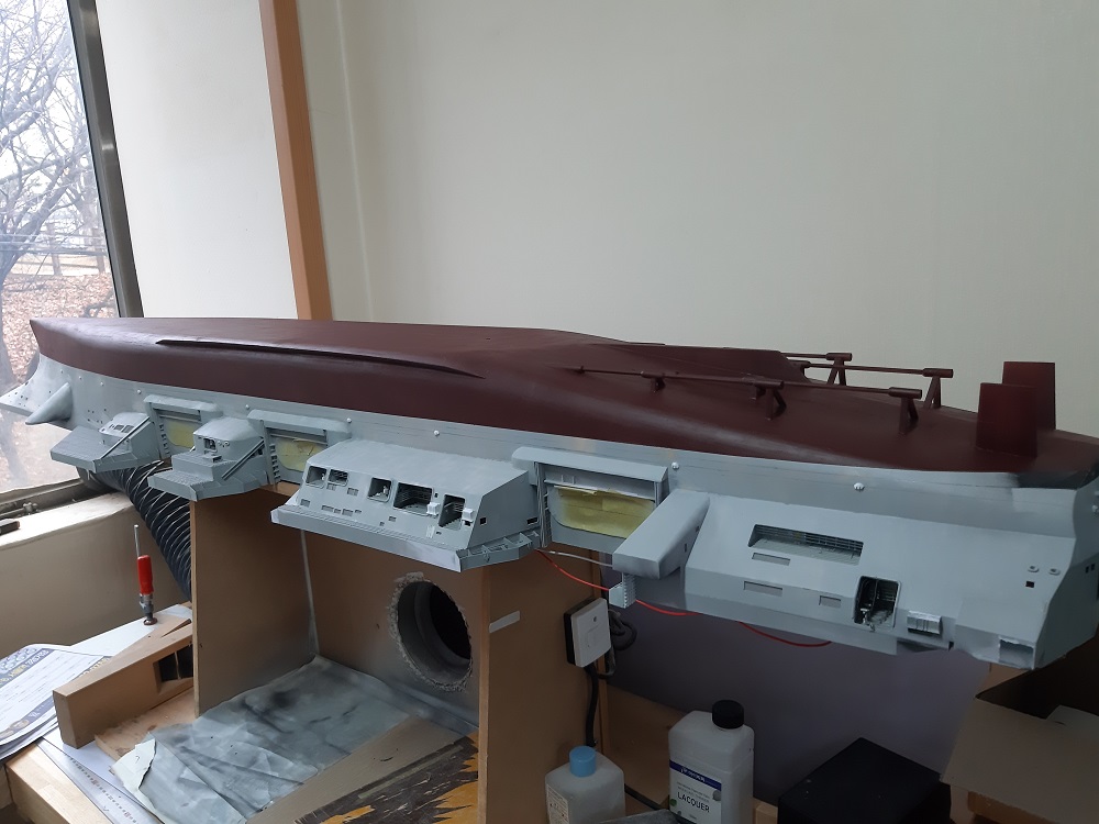

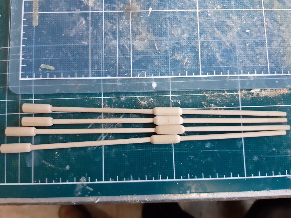

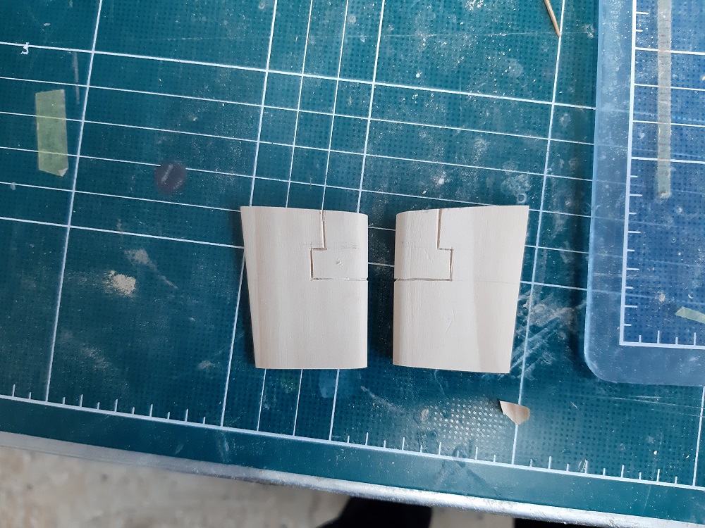

Hi,all member!
I've made propellers and its components,rudders.
And painted hullred.
Song
Song
- Posts: 5068
Re: 1/200 USS Nimitz
Song:
This is even more impressive with the hull paint and the props/rudders. Do you have an assistant to help turn this very large model over for the bottom hull work? I especially like the way the rudder and associated skeg fit together!
Best regards! Tom
Best regards! Tom

- Song Jung Gun
- Posts: 1631
- Joined: Sat Apr 26, 2008 5:21 pm
- Location: chun an city chung nam Korea
Hi,Tom!Fliger747 wrote:Song:
Best regards! Tom
Thank you,I don't have helper so I handle very carefully it.
Best Regards; Song

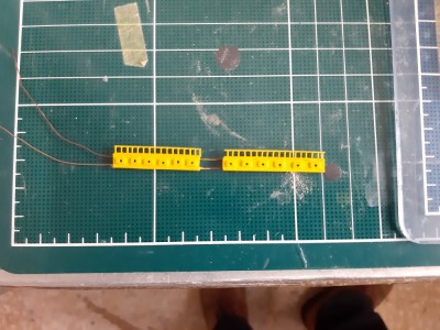

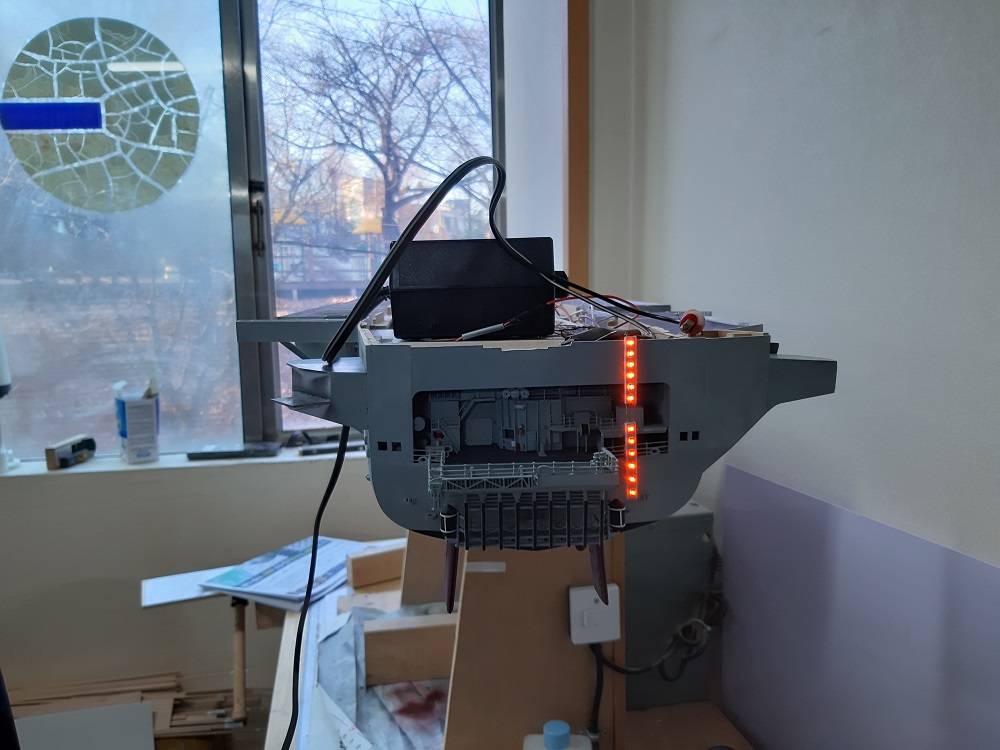

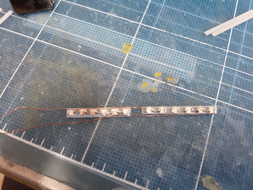

Hi, all!
I've made lights on the stern.
Song
Song
- Posts: 5068
Song, the horizontal alignment lights are very convincing, it makes me want to make an arrested landing on your ship!
Best regards: Tom
Best regards: Tom
