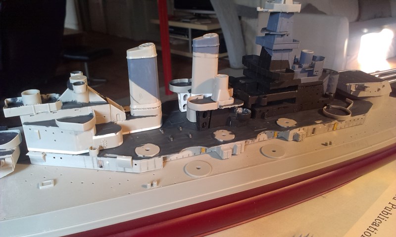

I am contemplating my next build being the trumpeter 1/350 kit of the North Carolina. Are there any major issues I should be on the lookout for as I do not wish to read through this entire thread? I'm aware that the 01 level is a bit too tall but I have no intention of trying to correct it. I have the white ensign models photo etched set for the kit, and I am really just interested in a nice clean build that results in a presentable and attractive model for the display shelf. I am not overly obsessed with having every detail perfectly accurate.
Thanks for your imput and suggestions. :smallsmile:
Maarten Sch�nfeld
Posts: 1848
Re: Calling all USS North Carolina & Washington fans
Post by Maarten Sch�nfeld »
Hi Thomas,
in my view there are four areas which really spoil the looks of the North Carolina model, and should be corrected:
1: the bulb of the bow is much too narrow,
2: the guns in the main turrets sit too close together and are too short,
3: the funnels are tapered and should be straight, the caps should be improved,
4: and indeed the 01 deck sits much too high.
Of course it's up to you what you want to do about these, but even the 01 deck correction isn't too hard if you try it this way (I did that):
Glue all the sidewalls to the 01 deck, instead of to the box structure on the main deck as directed in the instruction. When completely dry sand off almost two mm of the bottom of the sidewalls, on a piece of sandpaper on a flat table. Take your razor saw and completely remove the box structure just mentioned from the main deck. After painting the decks to your liking you can you can cement the complete level to the main deck, and at the correct height. By the sanding you have removed the lower part of the doors, so replace these by PE doors. However, the portholes sit at just the right height now!
Of course there is a long list of other smaller items to correct, but these are relatively minor. But again, it's up to yourself what you think is necessary to correct.

http://www.steelnavy.com/NCbook.htmattachment=0]NC intermediate.jpg[/attachment][
Just a picture showing the 01 deck correction, the funnels still have to be done here. Note that the rear superstructure needs to be corrected for the height loss as well...
