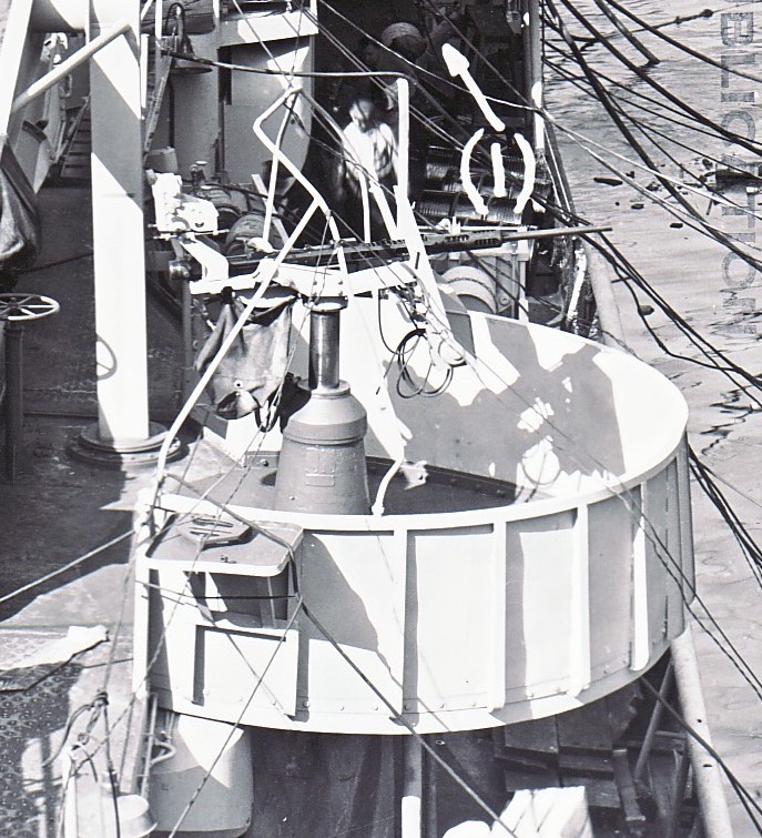

Hi all...
LOOOOOoooooooonnnnng time no post here. I changed scales for my project and have become absorbed in the new build, and have been more active on a different board. Sadly, one of my cats caused my 1/200 Missouri to fall four-feet onto hard tile floor (just the hull, and this is a different cat than the one that got my Boston, else I'd have one fewer cats). There is some damage, but - surprisingly - the grafted-in part came through unscathed.
I have a couple specific questions regarding 20mm mounts on BB63. After scrutinizing a LOT of photos, it appears that the mounts on Missouri differ from those on Iowa in at least one very significant area: Missouri's mounts have what appears to be a circular splinter (ricochet?) shield mounted horizontally about a third of the way up on the pedestal. Iowa's mounts do not have this feature - at least in the photos I have. I have not looked at photos of 62 or 64 yet.
Questions: does anyone a) know what these actually are, and b) does anyone have actual dimensions for them? See drawing below for an idea of what I'm talking about.
Hope you all have been doing well!
Randy

David... thanks for the reply. Was wondering if it is a step/stand of some sort. But if you were to visualize someone standing on that plate with their shoulders in the rests - even if they were balancing on the tips of their toes/boots, their body would be at a nearly 45-degree angle, which to me seems extremely awkward.
I've read thru all the available OP documents and especially OP909, which deals specifically with the different versions of 20mm mounts. None of them reference this addition. Yet it was clearly added to all of Missouri's 20mm guns. Curious.

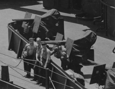

Well, after much searching I did find one possible photo of NEW JERSEY showing the similar type of pedestal. Once again, MO and NJ had a few more similarities between themselves as did WISKY and IOWA.
I have made a clip from photo #80-G-244433 showing the port side 20mm battery - it's the middle mount - seems to show the additional foot rest that RandyM is talking about: Comments, etc. welcome as usual. It certainly would be nice to find documentation on this item.
Hope this helps,
Hope this helps,

OK, no mistaking the modified pedestals on the 20mm on this photo of MISSIOURI:
And, also in a similar photo of NEW JERSEY:
Hope this helps,
Hope this helps,

- Posts: 5068
Those look like more of a shield and somewhat unsubstantial for a foot rest. A foot rest of the period would more likely take the form of a pipe ring?

I just don't see it being a shelf/footrest/body support. The geometry is all wrong for the gunner with respect to the shoulder rests. The vertical pivot point for the gun is well behind the vertical axis of the pedestal, and the shoulder rests are well behind that. The gunner's feet would probably be 2-3 feet away from the center of the pedestal. I'm thinking more the equivalent of a baseball player's cup for the gunner
- Posts: 3889
Guys, the "ring" around the base of the 20-mm guns is an aid for the gunner to stand on when and if he needs to "quickly" shift his elevation of the gun without having to adjust the height of the gun. Normally with the Mk 4 base, while in action against aircraft targets, the gun is cranked up depending on what the gunner desires so he can get high elevations on an aircraft target. If a gunner is concentrating on one approaching target he isn't going to want the gun lowered while firing and he can simple step up on the ring for a reduced elevation to maintain track on the target. I see these a lot on USN destroyers. I could see that not every 20-mm gun location on a large ship like a battleship would need these rings if they are located where the gunner would have to disengage a low angle attack because of cam restrictions on NOT FIRING into the ship.
The Mk 5 bases, seldom used on USN warships and sent off to be used on merchant ships, didn't have a gun height adjustment cylinder to save weight and they installed a "step" bulwark around the gun.
Also, after experience during the Philippines campaign, mines (floaters and moored) got to be a major concern. I have read many War Diaries for destroyers talking about "plinking" mines. Such rings helped to get a better depressed angle against a mine closer than the crew would really like to be near one. When the Mk 4 bases were replaced with none elevating Mk 10 tripod bases to save weight, either a similar ring was attached or more likely a tube ring was mounted on the deck on stand-offs.
You seldom see the Mk 4 mounts in the elevated position in either yard photos. Here is one of USS ERICSSON (DD-440). One of the problems the USN had with this elevation cylinder, was it getting corroded and difficult to operate. Hence keeping it down when not in use.
