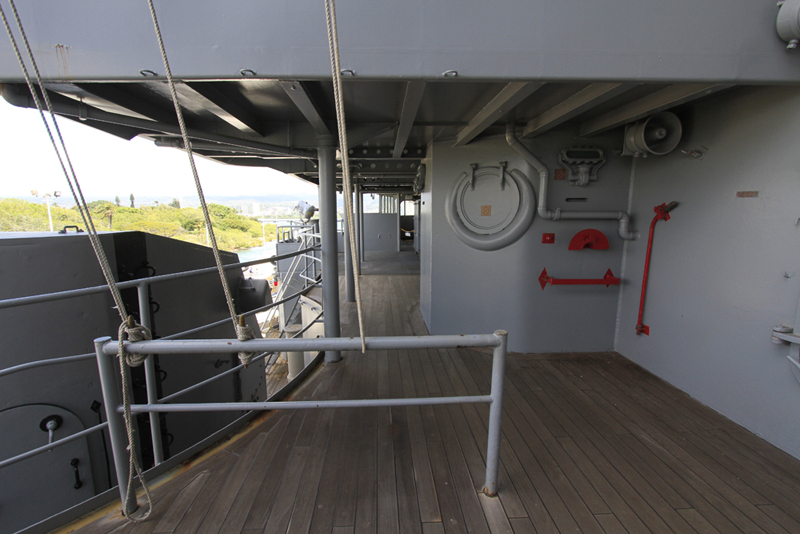

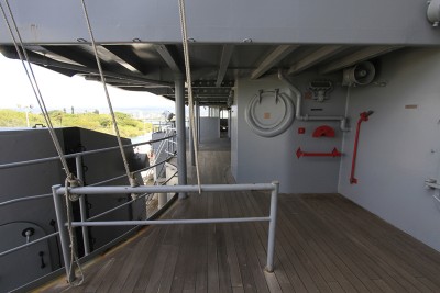

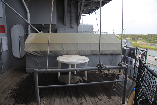

Signal Halyards? Several feet forward of the flag bags there is a rail, much like a hitching post in an old west town.

I see the hitching post rail on the Iowa now. But I am pretty sure that rail wasn�t there during WWII. No drawings or photos of that part of any of the 4 ships from that era shows such a rail.Fliger747 wrote:Signal Halyards? Several feet forward of the flag bags there is a rail, much like a hitching post in an old west town.
Also, the location of that rail aligns with back edge of the extension to balcony outside the chart house one level above on level 04. There is even a row of eyelets at the edge of 04 level extension for halyard to thread through. But that extension was added during the 1980s modernization. Prior to 1980s the aft end of balcony on level 04 terminated a few feet further forward, and aligned with the support stanchions of the 40mm quad bofor tub on 05 level. So it seems to me that hitching post rail was added during the 1980s as well.
- Posts: 5068

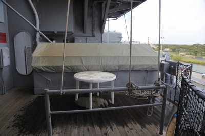

Currently there is a canvas cover over the flag bag. I will have to look at the photos I have, but the Iowa's are a little unique in that both sides of the flag bag is easily accessible.

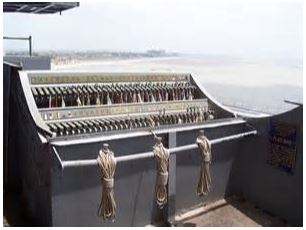

Large double page spread on page 96-97 of "Battleship New Jersey" shows the halyards tied off inboard and even with the fwd edge of the flag bag. The ship is not underway and crew is manning the rail for the photo. The scariest aspect of the photo is a line of sailors sitting on one of the 16" barrels, all the way out to the end!

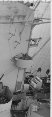

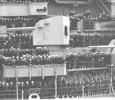

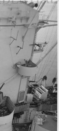

If you blow up this image from Navsource: http://www.navsource.org/archives/01/016341c.jpg.
you can make out the signal halyards. It appears a couple of halyards are attached to the front of the flag locker, but most of the halyards are threaded further forward to a frame mounted on the back of 04 level balcony.
This makes sense while the ship is in operation actually. Because directly under the bulcony, forward of the flag locker and behind the flag plot, is an armored battle signal compartment, with armored glass vision slits and a large round hatch on the wall facing diagonally towards the back. This hatch is unusual because there is a fat round coating all around it.
Several sources say this is an escape hatch. That makes no sense. Why would the escape hatch be round, so small a person has to squeeze through, and 5 feet off the deck? Why the fat coaling?
I believe this round hatch is open during the battle to allow signal halyards, threaded through the frame just behind and above it, to come into the battle signal station. The fat coaming is prevent the halyards and signal flags from snagging on the rim of the hatch opening. My theory is In battle the signal flags will be set inside from the protected battle signal compartment, and then hoisted out through the hatch up to the yard arm.

- Posts: 5068
This shows the area in some more detail. Not the possibility of a set of light and dark halyards. The overhang of the 40 mm tub above somewhat complicates the use of signaling from the 04 level. Indeed the hatch which appears to be of a countrballanced type may well be for passing flags through from behind a splinter protected space. Whether or not this was used to any extent in this manner, who can say.
I do have closeup photos of this hatch from Missouri and included it on my scratch 1:192 modern ship.

Page 60 -Flag Signal Level FR. 115-136 shows 2 sets of 5 belaying pin rails on the port and starboard sides just next to the two 5" drill ammunition lockers and forward of the rear flag locker.
I believe that small hatch which looks a bit like a toilet seat is where the signal halyards were fed through. This is an armoured control centre and the idea was that during a shooting battle the signals flags could be sent from this armoured centre with no danger to the personnel operating these signals. The halyards were fed through a kidney shaped frame down to the "toilet seat" opening into the armoured room. On the plan I believe it is incorrectly labelled an "Oval Escape Scuttle". The kidney shaped feed is shown on Page 75 and labelled "Fairlead for Signal Halyards". I don't think these were ever used in a battle as at that time other forms of communication were being developed. The Fairlead for the Signal Halyards is shown on page 75 - Navigation Bridge Level.
Page 58 has a photo of the "toilet Seat" scuttle and an overhead photo of the starboard flag bag onboard USS Iowa in 1986. It states that "the belaying pins and rail are made of brass".
Hope this is helpful
David
David

Here is a somewhat typical Navy flag bag with belaying pin tie-offs: Hope this helps!

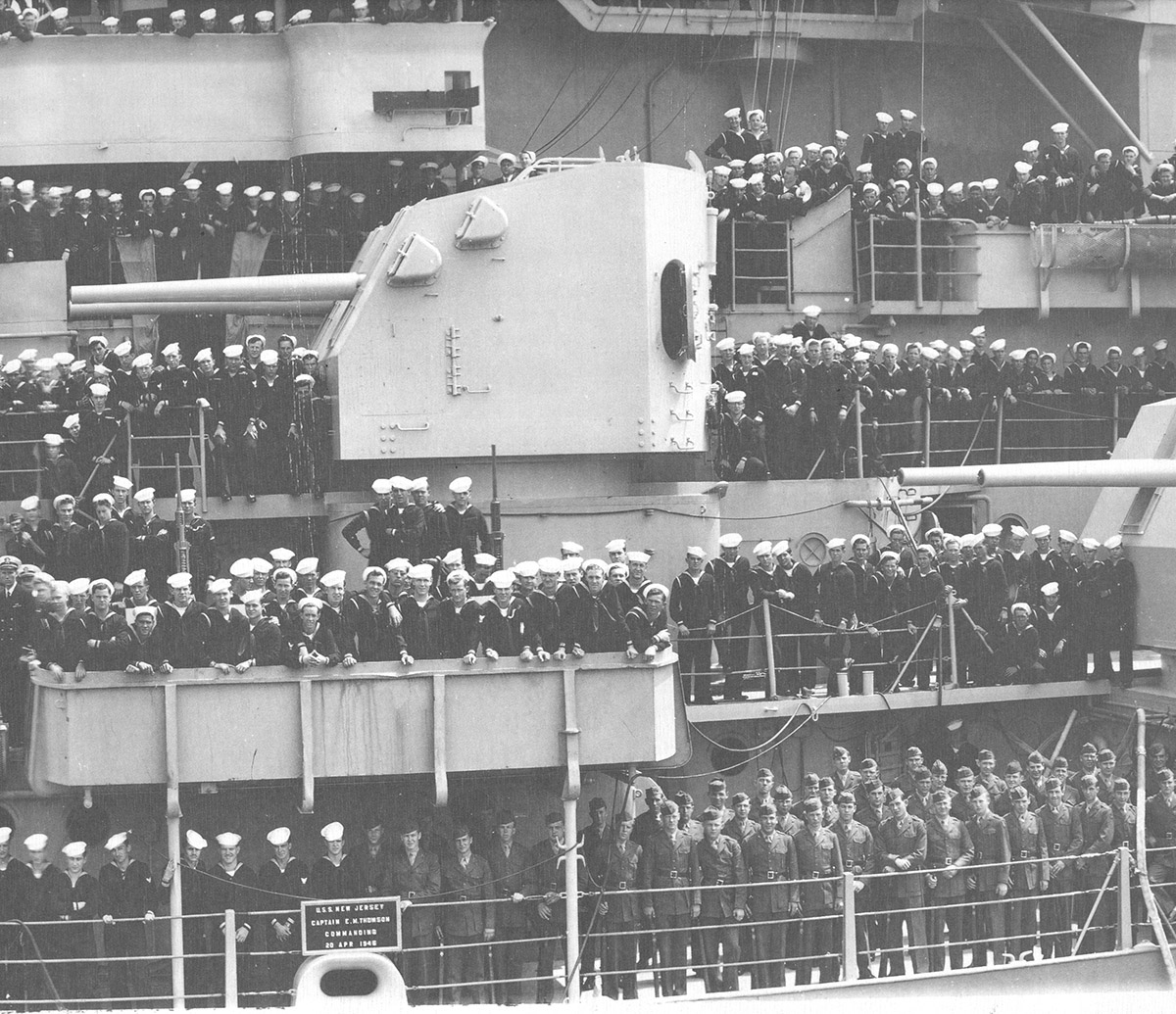

Yes, there was - here is a portion of NEW JERSEY taken in June 1945 at Bremerton of her after flag bag: I would suspect that this was typical for all the IOWAs at the time. The pipe rack tie-off in front of the flag bag was still there when she was re-activated for Vietnam War service.Another question, for the halyards on the mainmast, where did they tie off on? Trumpeter helpfully provided a third flag locker for the space between the aft funnel and the 5� practice machine, and Pontos helpfully provided a belaying pin rail for it similar to that provided for the other two flag locker. But Trumpeter May have simply extrapolated without direct evidence. All the plans and the big Gibbs and Cox model l�ve seen suggests there wasn�t a flag locker there during WWII.
- Posts: 5068
Covered, but one can see the original rail in front of the bag.
