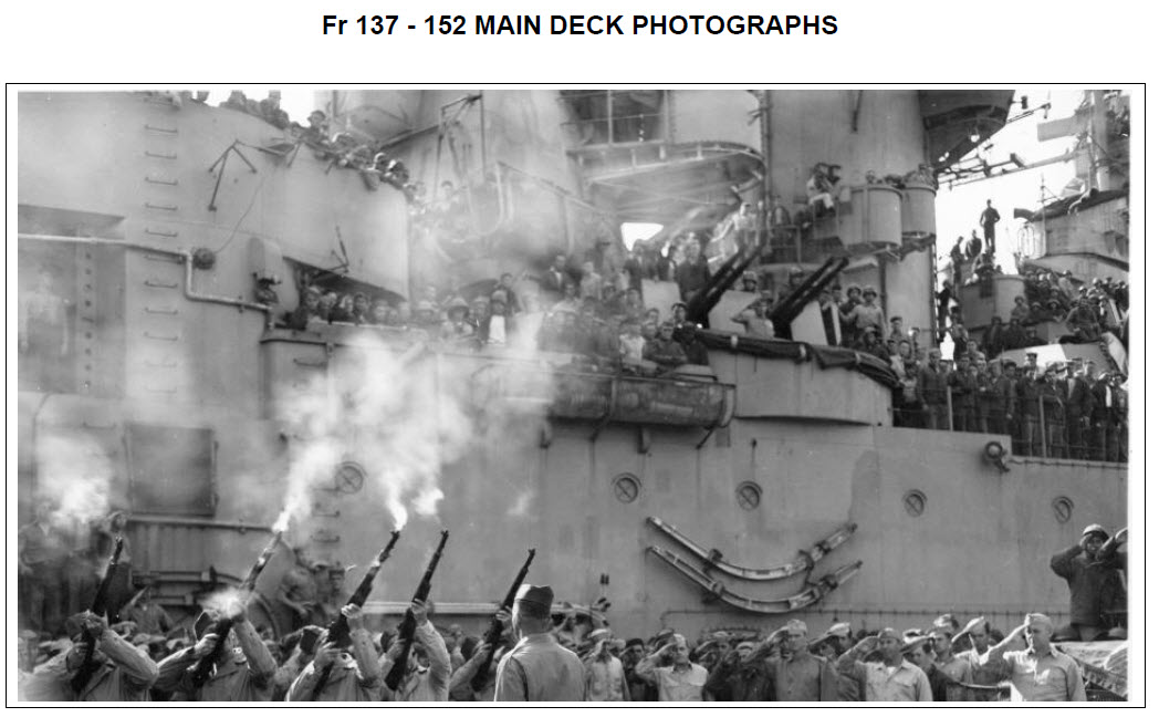

Greetings gents,
Can anybody tell me, is Cliffy (Mike) still around here? I need some information and while I'm not sure about the rest of you, I know he would know the answer to my questions.
1: Compared to the anchor chain, how big is the parasail chain? I mean, how many links per yard is this smaller chain?
2: At least on three different photos recently, I've seen Iowa class BB's with portholes that had this "X" pattern in them.
(Photo from BB-63 Plans E-book, Pg 97 The Floating Drydock PN/ BBPB-011707)
I presume this was a cover or shield of some type. My Pontos Detail-up set has a lot of PE showing portholes like this. I plan on drilling most of the portholes out on my Trumpeter MO, but I'd also like to leave a few of them closed and glue this shield or cover to the inside (after grinding away the thickness of course.) My question is - were all the portholes on the ship covered by this same shaped cover, or was it just certain sections?

Larry Steiner
- Posts: 5068
Re: 1/200 Scale Group Build 2015
They are called "Paravanes", Parasails a somewhat later civilian invention. Not sure if Cliffy can answer or not as the Iowa's were not equipped with Paravanes after the 1980's modifications. If he can answer it will be from historical sources. They were usually stored in a cradle on the foc'sle.
It may have been in the Iowa thread where the porthole situation was discussed recently. The issue with the PE porthole covers is that they usually hinged from inside and a proper application would be recessed, not applied externally. They were to provide minor blast and splinter protection when closed and assure leigh tightness at night. I believe that might have been a Hank post.

- Cliffy B
- Posts: 3125
- Location: Hawaii
From what I know the paravanes were all gone by the 1980s and their associated equipment all removed and the chain pipe in the forefoot blanked off. BB-62 actually had her's completely removed and welded over as the seal didn't hold and caused the whole thing to rust horribly. Not sure which method was followed with the other three off hand.
The chain is much smaller than the anchor chain but there's no way to tell from looking at the current ships. Original blueprints and photographs will be the only source. I believe there are some recent photos on NavSource of BB-63 as she was being finished that show the paravane chain rigged on deck and the size difference is readily apparent.
The portholes are recessed as they sit against the frame around the glass. The cover and the glass are all inside the ship for those style portholes. I can get some photos from the inside of them and how they work if you'd like. For a building note, if they're big enough, I'd glue the porthole covers on the inside of the bulkheads if its possible. With the scale though it may not be visible/worthwhile going that extra step unless you're doing something in 1/96 or larger. The glass is only inset an inch or less from the edge of the bulkhead.

- BB62vet
- Posts: 3174
- Location: Mocksville, NC
CliffyB wrote:
Portholes from the inside of a bulkhead - steel port cover, then glass, then porthole. Usually they are 4 dog units. I don't know that there would be any portholes in a bulkhead that were not all uniform - i.e., hole, glass, cover. The oval openings in the armored bulkheads are different and would not be considered portholes, but observation slits; an entirely different situation altogether.
Hope this helps,
That is correct - BB62 had her paravane skeg & eyelet completely removed in her 1987 overhaul. The pipe which runs from the bottom of the ship up to the main deck was cut out and plugged (welded over and ground smooth). Her paravane winch on the main deck was retained as the crew had refurbished it themselves. The other 3 IOWA ships have retained the paravane skeg on the bow but nothing more. The units themselves were not activated in the '80s. We didn't have them on board NJ in the 60's, either. Unless you can find a USN operating manual for paravanes, I have no idea what the chain size would be. Perhaps one of the various photos mentioned recently might give a clue as to the chain size.From what I know the paravanes were all gone by the 1980s and their associated equipment all removed and the chain pipe in the forefoot blanked off. BB-62 actually had her's completely removed and welded over as the seal didn't hold and caused the whole thing to rust horribly. Not sure which method was followed with the other three off hand.
