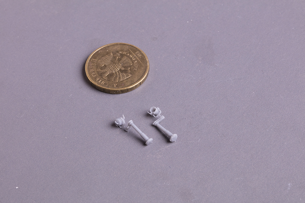

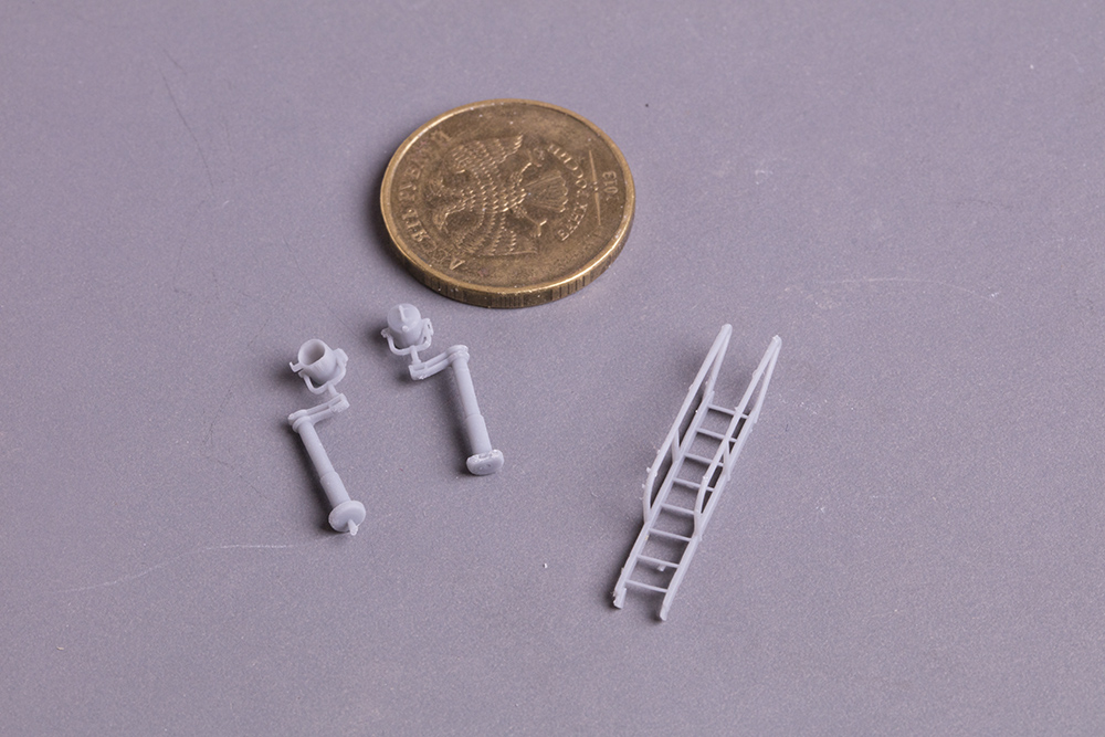

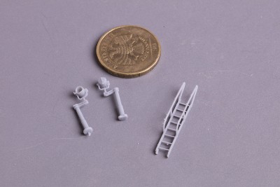

Last nights printing was set of 12" signal lamps, such as found on the bridge wings of a Fletcher. The first one's I printed had problems with the actual lamp, the stands came out fine. They needed an addition of a support on the bottom of the lamp. These are in 1:120 but I am sure I can print them well in 1:144. If I don't destroy them in cleaning them up, perhaps some photo's later?

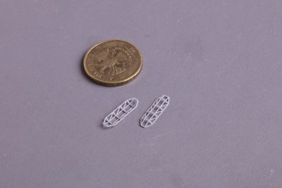

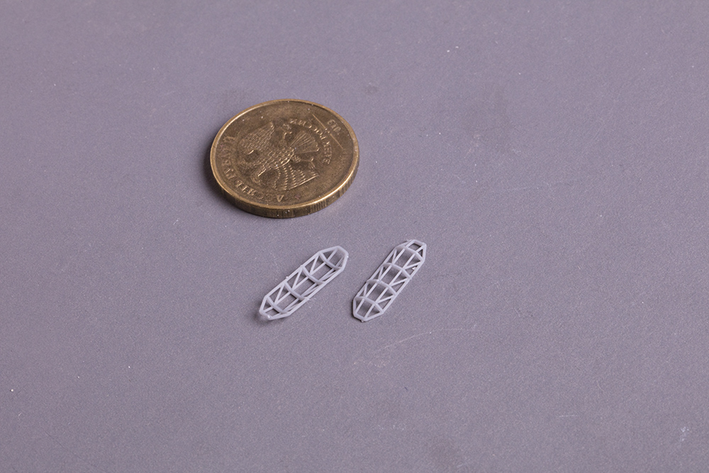

Hot off the printer: I printed two stokes litters. One can't at thins time print the chicken wire, but the framework looks pretty good and sure looks like a stokes! Yet another thing to litter the topsides with!

Hey Tom, what scale are your stokes litters and your 12" searchlights? If they are by chance 1/200, would you consider selling some? I'd love them for my Missouri.

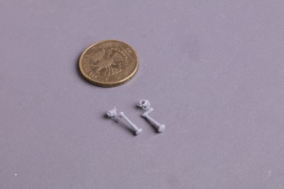

For this project I am working in 1:120. I did print deck binoculars in 1:192 which came out OK. I put those and some sky lookouts and Mk51 directors I printed in 1:192 on my Missouri and Alaska. I haven't as yet tried printing the searchlights in 1:192. Such delicate items often need re engineering, as even in 1:120 some parts such as the U frame are super delicate and don't always print successfully. As I recall Missouri today carried a pair of those on the flag bridge and at the fwd flag bags. There may have been others I didn't see.
I'll let you know if these can print at that scale..

Here is a photo of the stokes at 1:120 and also some 12" lights in 1:144. I am currently printing test lights as 1:200, we shall see!

Today printed some 12" lights in 1:200 and 1:144, currently printing some Stokes in 1:144 to see what they look like. Maybe one could take some of that light open ribbon material and fit a mesh by hand, I don't think it's printable.

Currently printing some 1:144 items I'll forward to Hank for his Stoddard and experimenting with some 1:200 stuff I could use on Alaska and Missouri. However sometimes things need to be re designed, as the parts become vey fragile and have issues with being able to be removed from their supports. I think my printer undersizes small parts like rail or the supporting parts of say a signal lamp. So this seems to become a significant apparition at smaller scales.

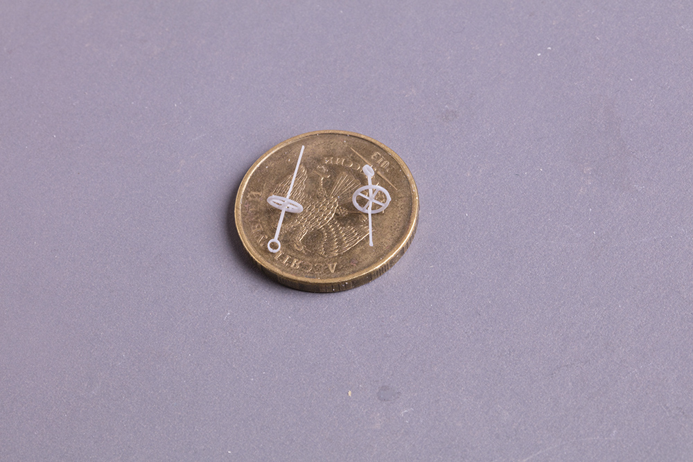

Comment on rails. The rails I designed as .40 mm in 1:120 actually mike out at 0.18 mm when printed. Which is pretty much in scale.
If you use this technology for the superstructure railing a little experimentation will be necessary.

Tom, Thanks for the advice! I wonder why things come out undersized? That seems like a very big problem to me!
I have read a bit about 3D printing on the Internet and for some printers there is a pretty wide range of materials that have different desirable and undesirable properties. AS you said, some experimentation will be necessary.

My rails come out the right length and height dimensions, it's just the rail diameter shrinks. It was really apparent when the rather clunky tubes of the stokes still printed nicely in 1:200.

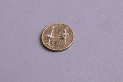

- Posts: 5068
Re: APA project

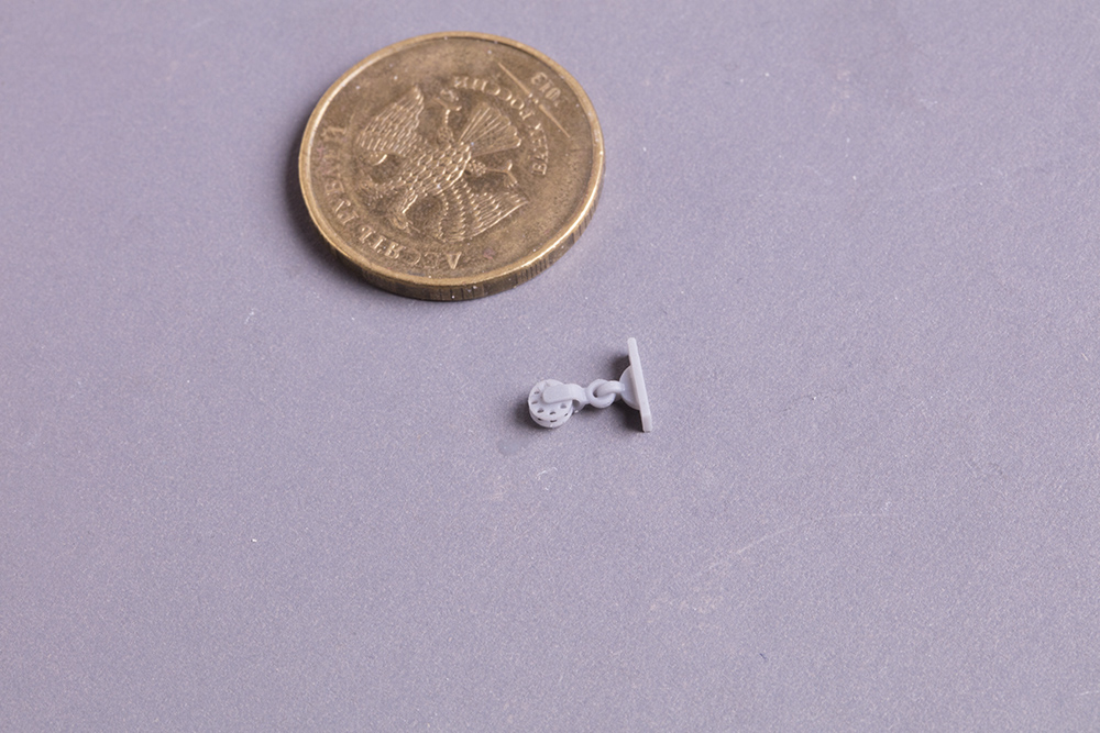

Single sheve pulley. The idea was to have the rings not intersect, but it didn't print that way. Currently printing a slightly larger one with exaggerated holes, maybe that one will work. Also as a trial, printing a stud link anchor chain, we will see if that works! Also made a dipole antenna. The circle at the base will either slip over a wire mast yardarm, or if slit, expands for a birds foot grasp for security.
