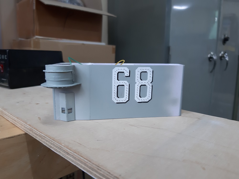

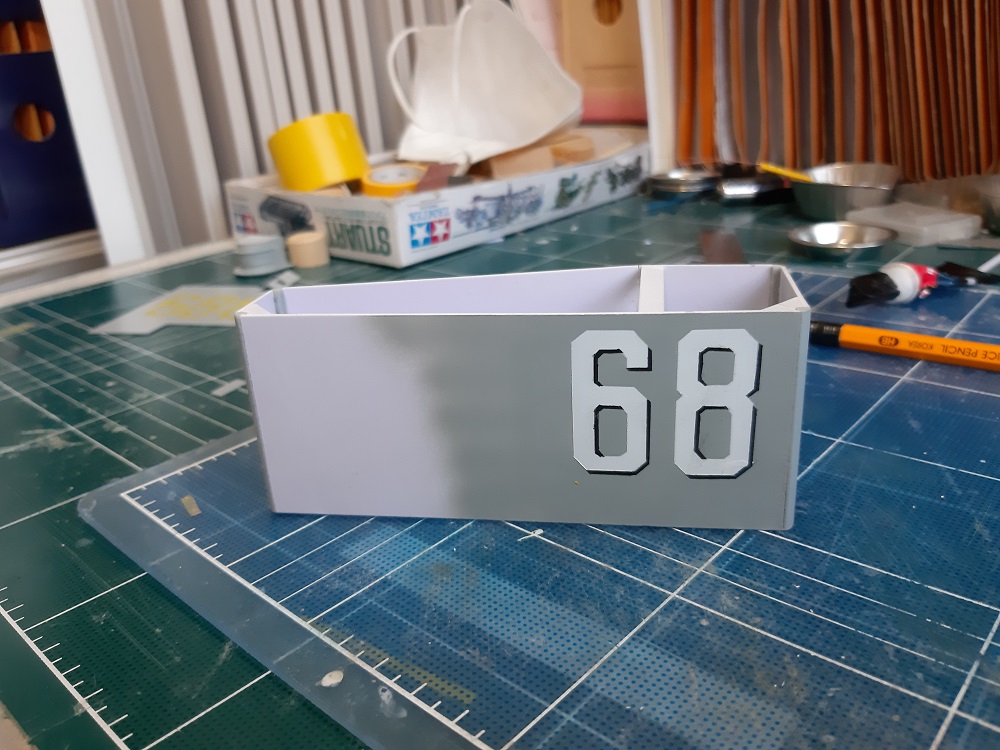

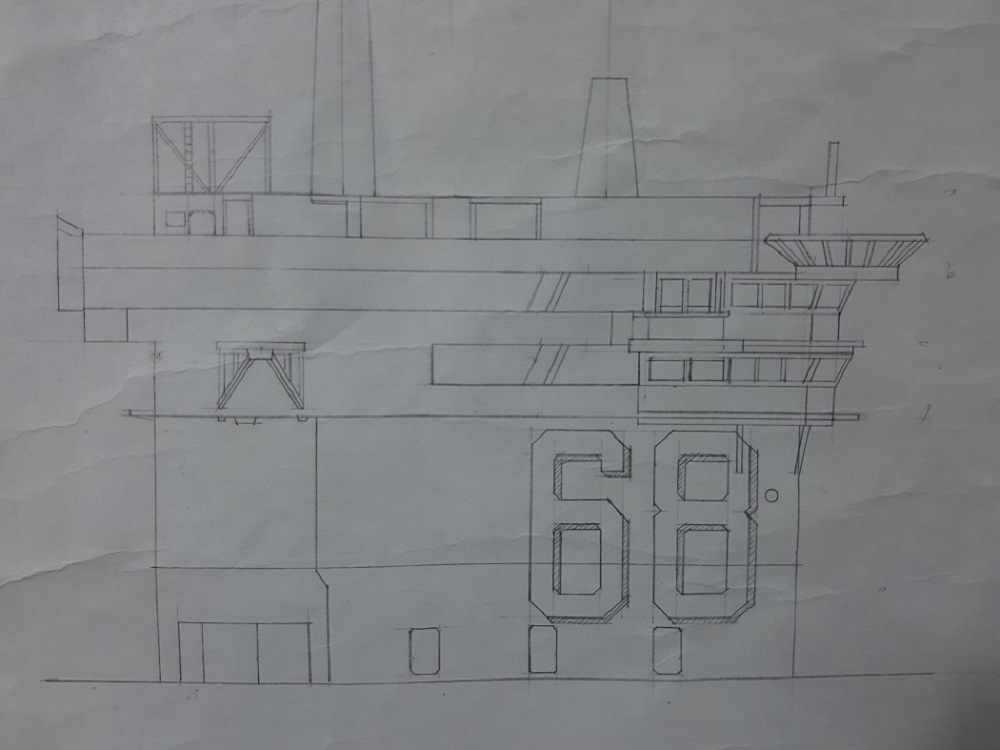

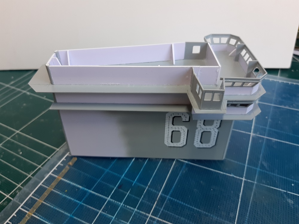

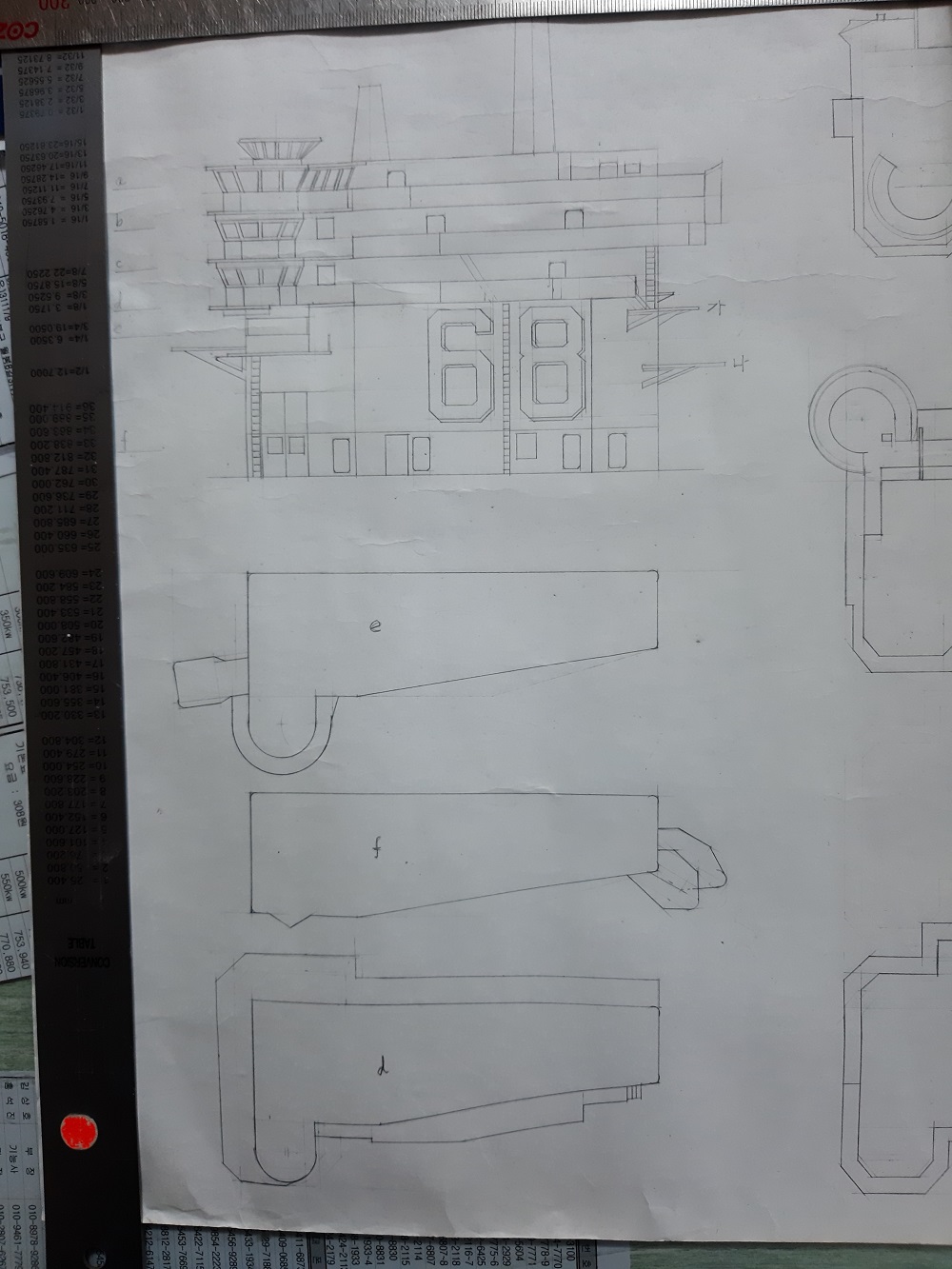

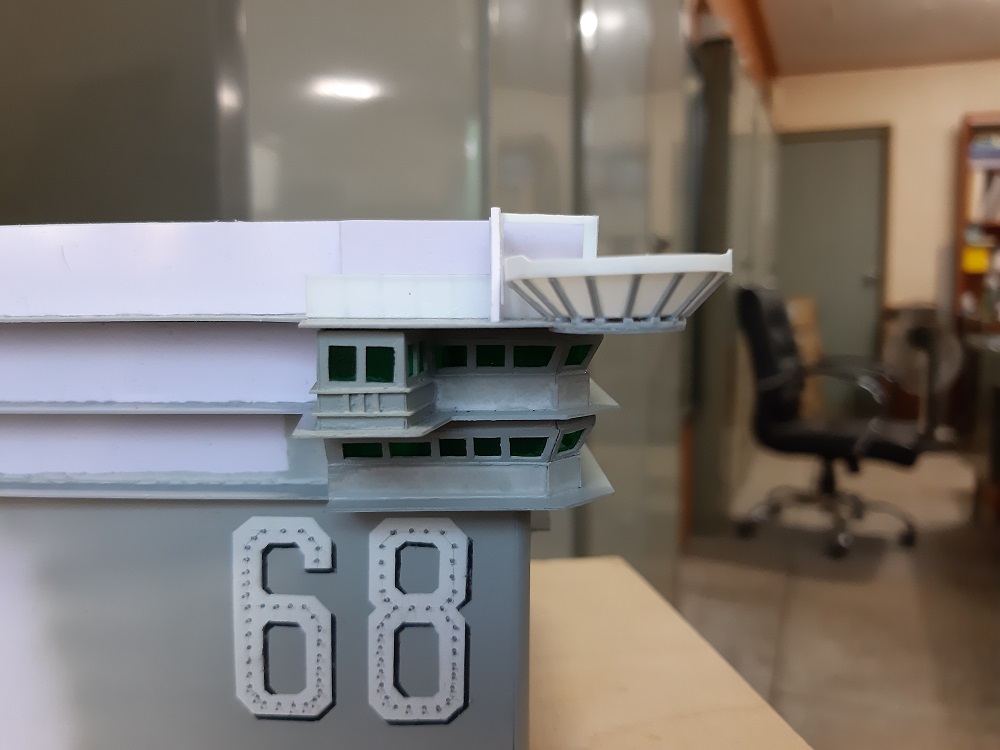

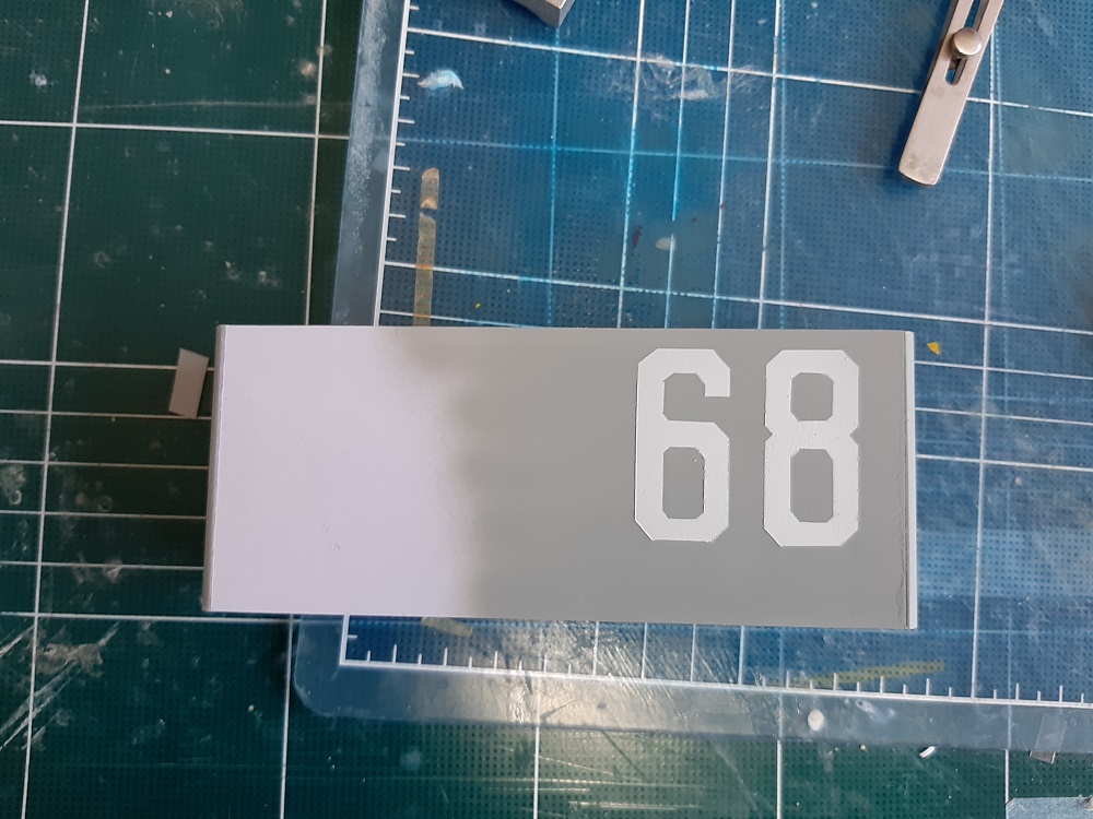

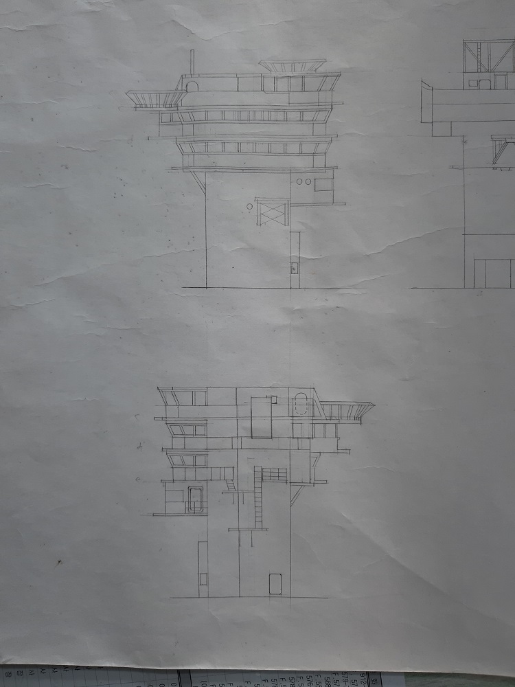

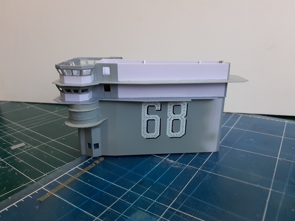

Hi, all!
I start to built island. It will built just plan.
The number 68 made by stencil.
The first one is too wide, so i make it again.
Song

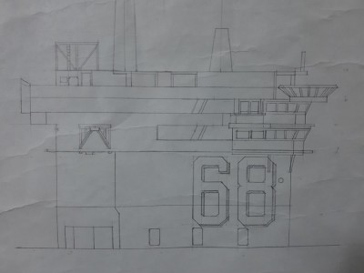

Song:
Your drawing is a very good path to organizing the construction of the ships "Island" into individual pieces and an order for assembly. We will all be looking to see how you solve the inevitable problems that will arise.
Best regards! Tom

Fliger747 wrote:Song:
Best regards! Tom
Yes, It is very easy to construction and assemble if got the good drawing.
So I prepare drawing first.
Thanks always!
Best regards; Song

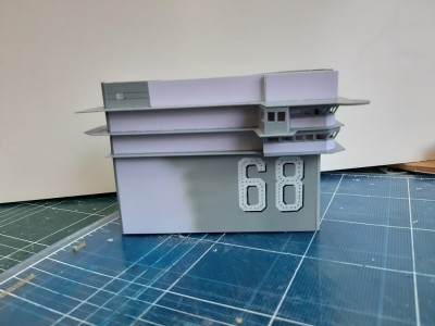

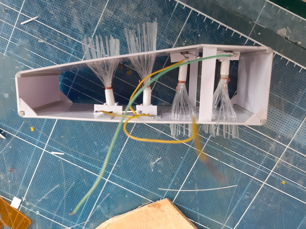

Hi,gentlemen!
I've made shaded hull numbers and then made hall insert 0.5mm diameter optic fiber.
And assembled parts.
Song
Posts: 5068
Re: 1/200 USS Nimitz
Post by Fliger747 »
Song! This continues to amaze!
Best regards. Tom

Song,
What are you using for the fiber optics? Drivers and fibers? Brand?

DrPR wrote:Song,
Phil,
I am using LED lightings and Mitsubishi ESKA CK-20.
Song

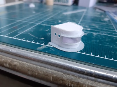

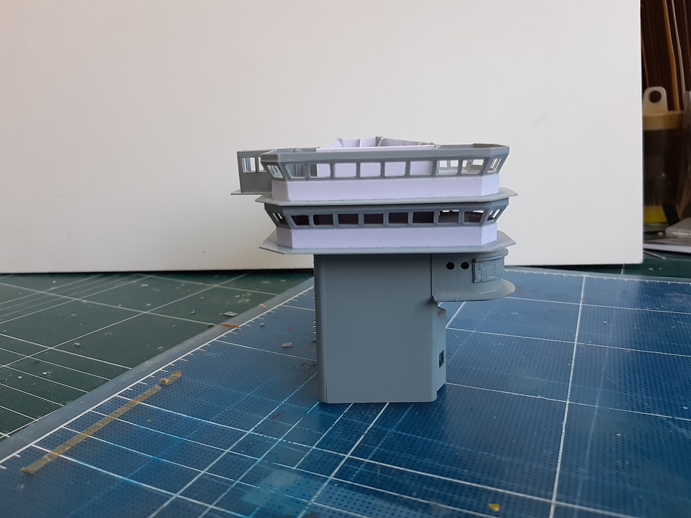

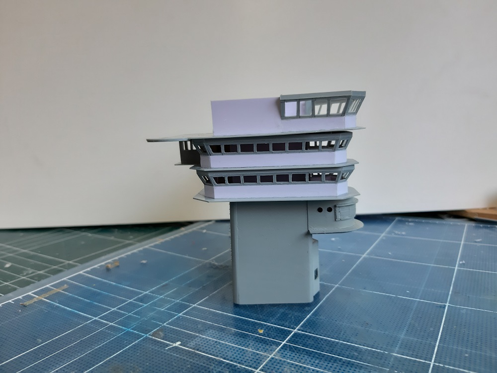

Hi,gentlemen!
I've built island parts,especially window frames.
Song
Posts: 5068
Post by Fliger747 »
Song:
Considerable precision is required to construct the angled window frames, but as usual you have conquered this task. It is amazing as to how large the bridge is on this modern generation carrier. By comparison the pilot house on a WWII Essex class carrier was almost exactly the same as a Fletcher class destroyer except Engine Order Telegraph for four shafts rather than two and a higher viewpoint.
More windows to go!
Regards: Tom

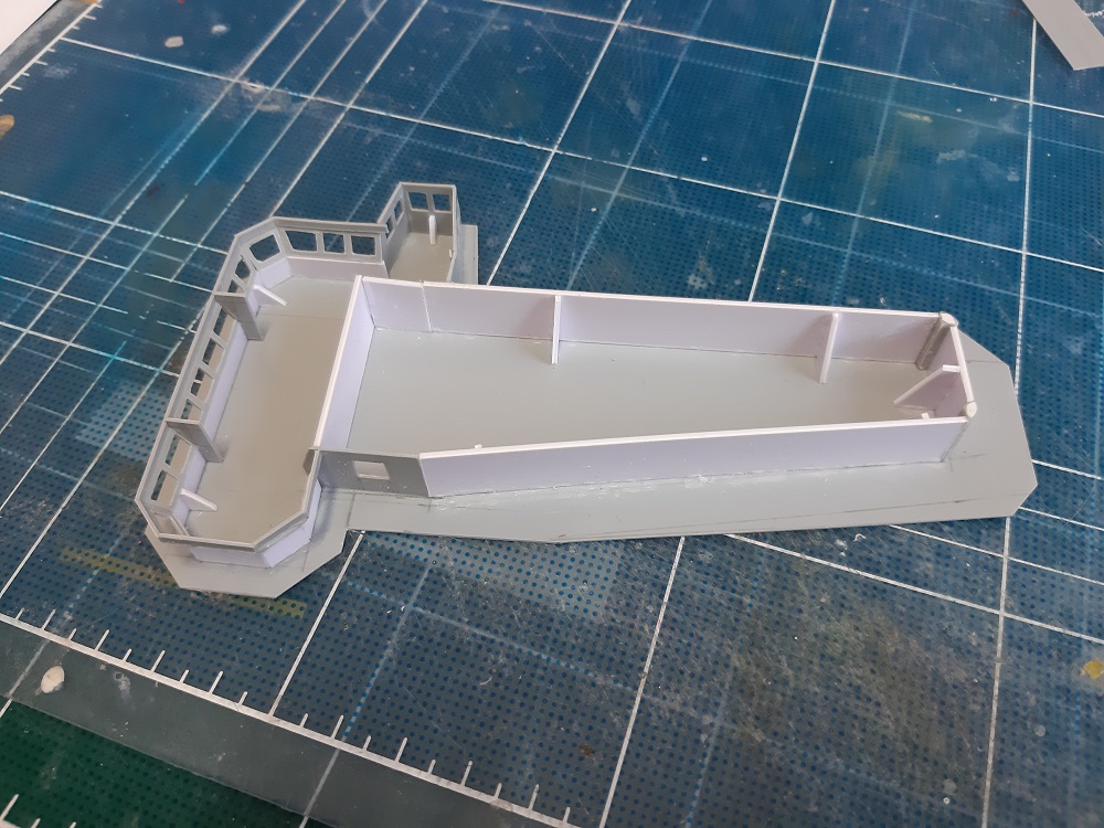

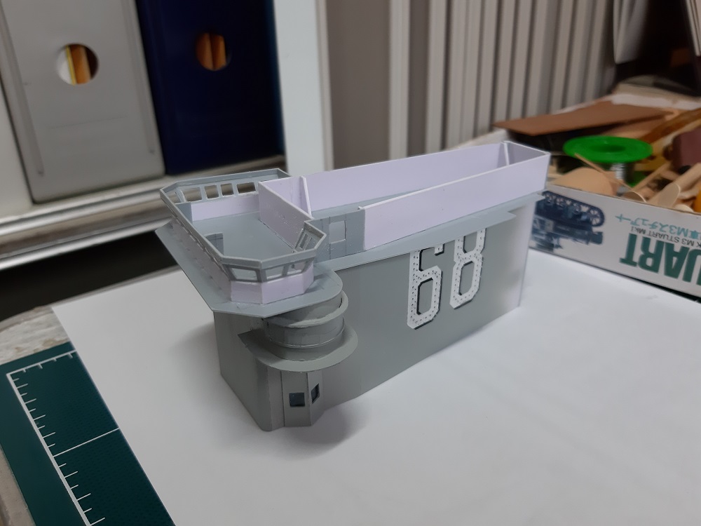

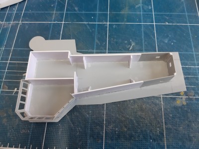

Hi, gentlemen!
I am doing construction of island. The same method and shape of former post.
Song

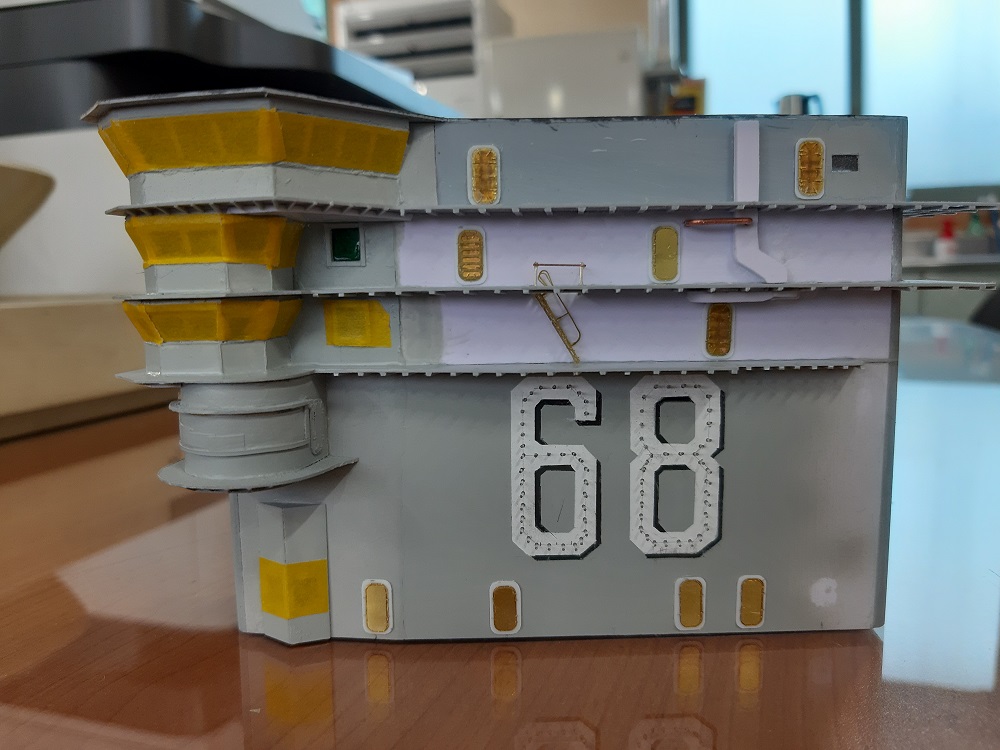

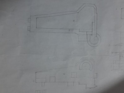

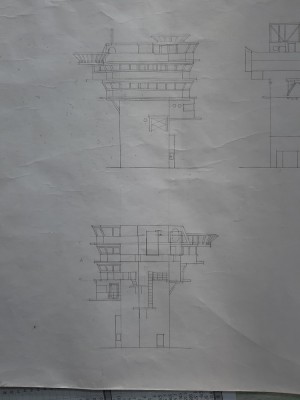

Hi,gentlemen!
I've corrected mistakes of my plans.
and then I've built last floor of island via plans.
Song
Posts: 5068
Post by Fliger747 »
Song:
Quite the "penthouse apartment" for the Admiral! In the horizontal view it appears that these windows might be glazed? Certainly developing in a very convincing manner!

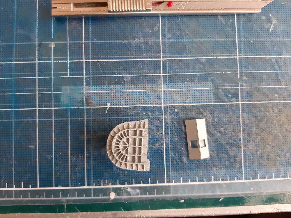

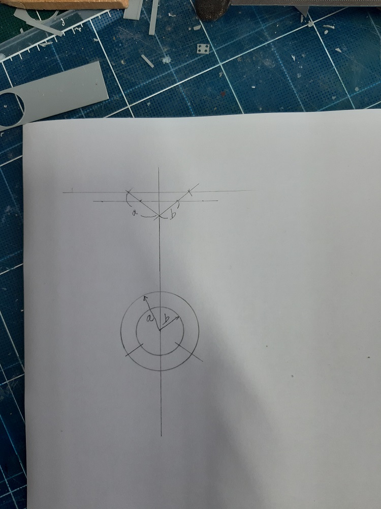

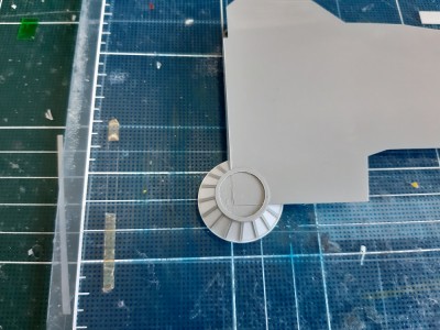

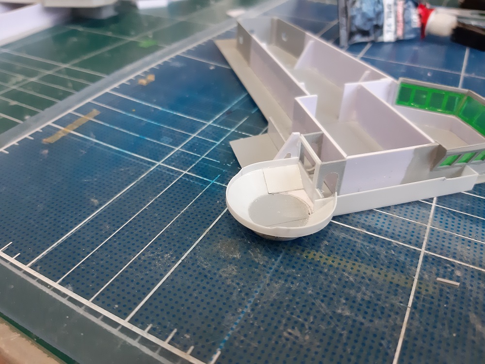

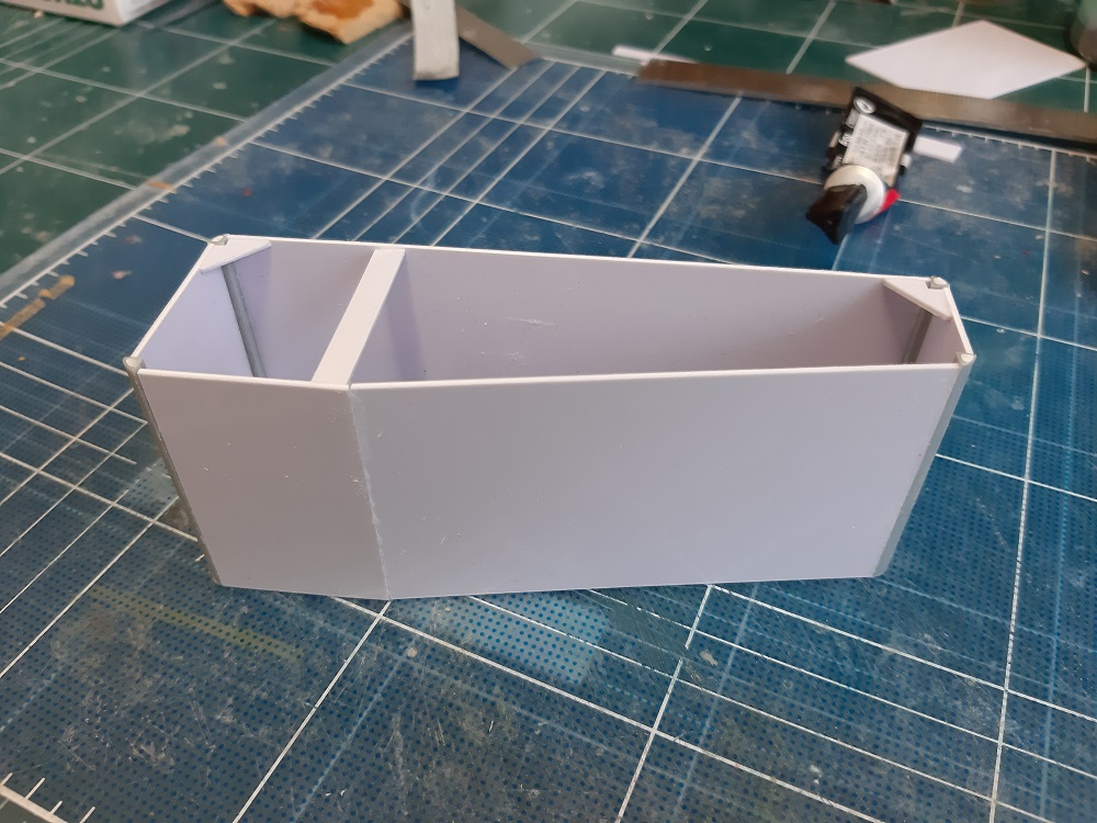

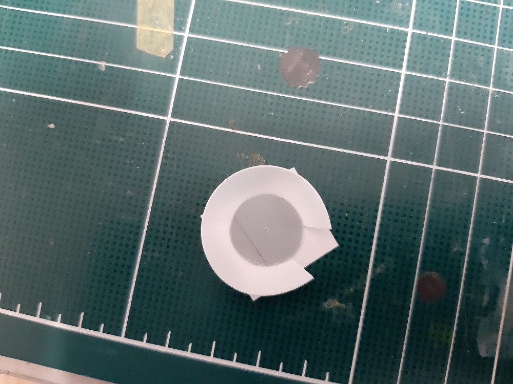

Hi,gentlemen!
I 've built sponson for NATO sea sparrow director.
This cone type sponson is need very precision work.
Song
Posts: 5068
Post by Fliger747 »
Song:
Certainly not an impossible item as you have demonstrated, but requiring calculation and precision layout and cutting. Nice work!
Regards: Tom

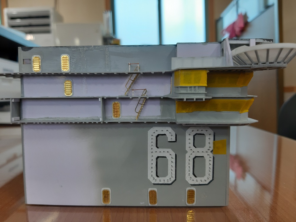

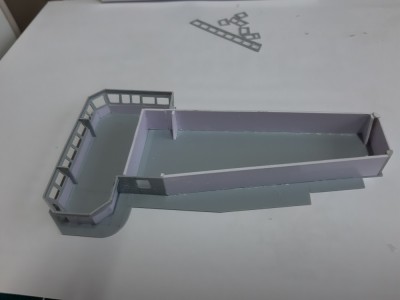

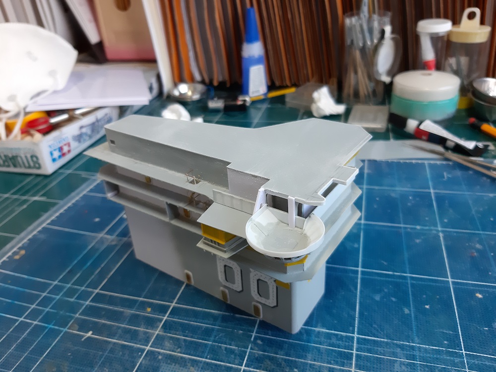

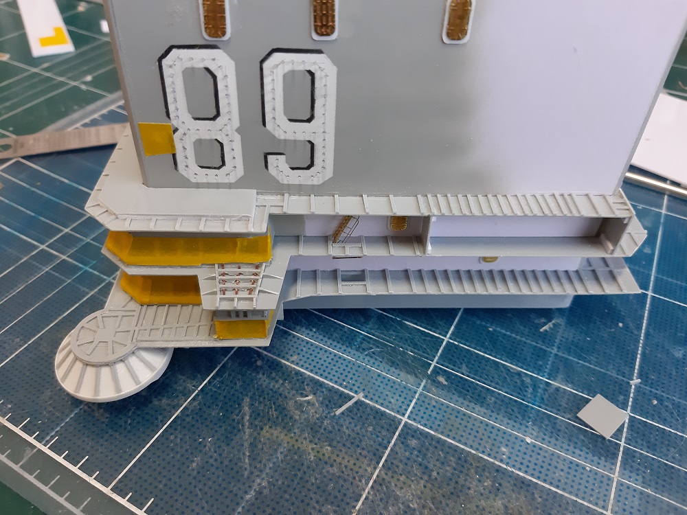

Hi, gentlemen!
I've built still island. The water tight doors,stairs and others.
The main work is supports of under decks.
Song
