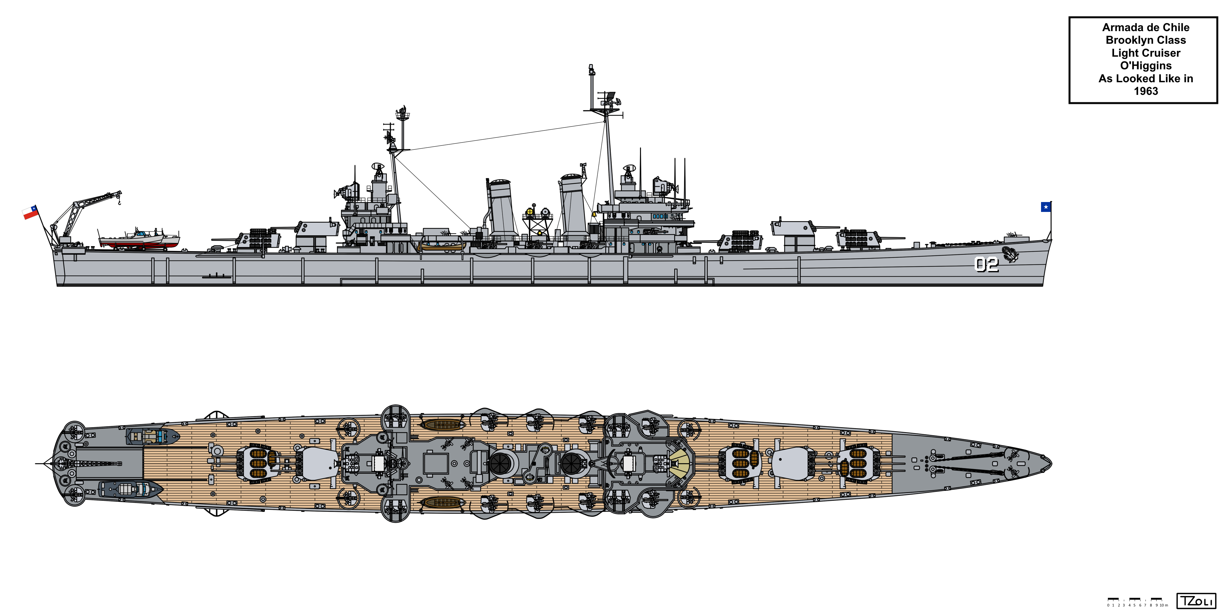

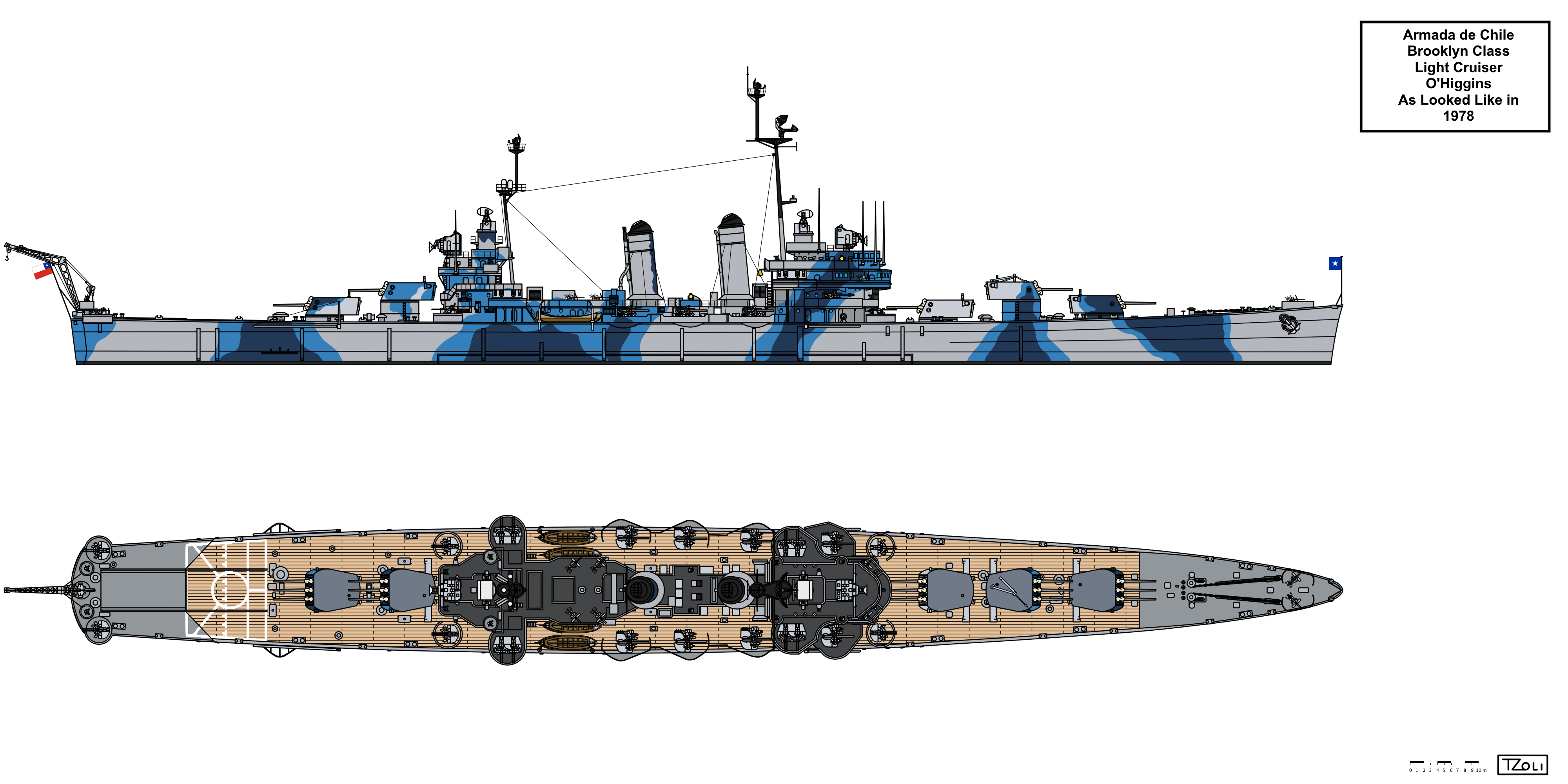

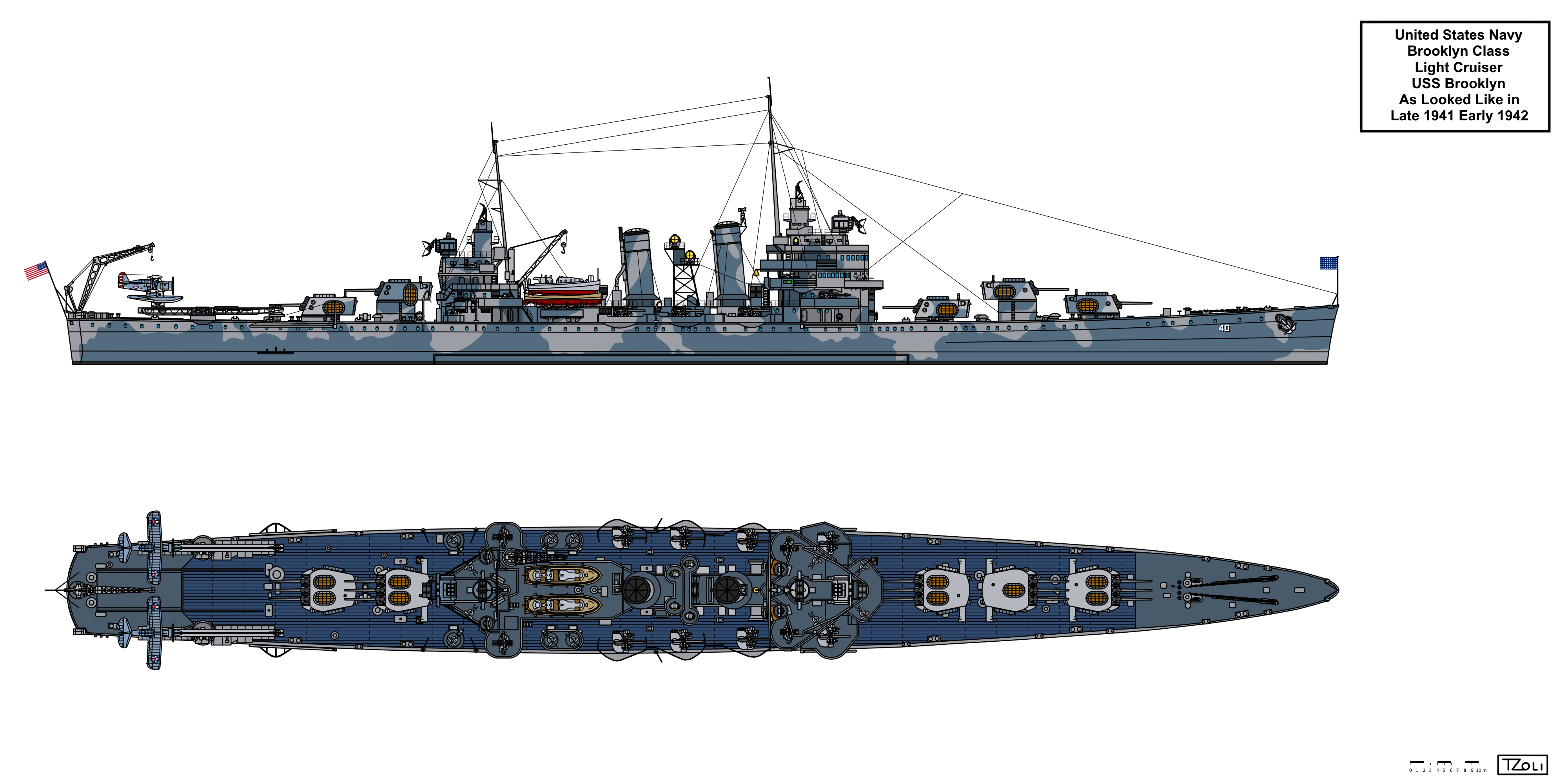

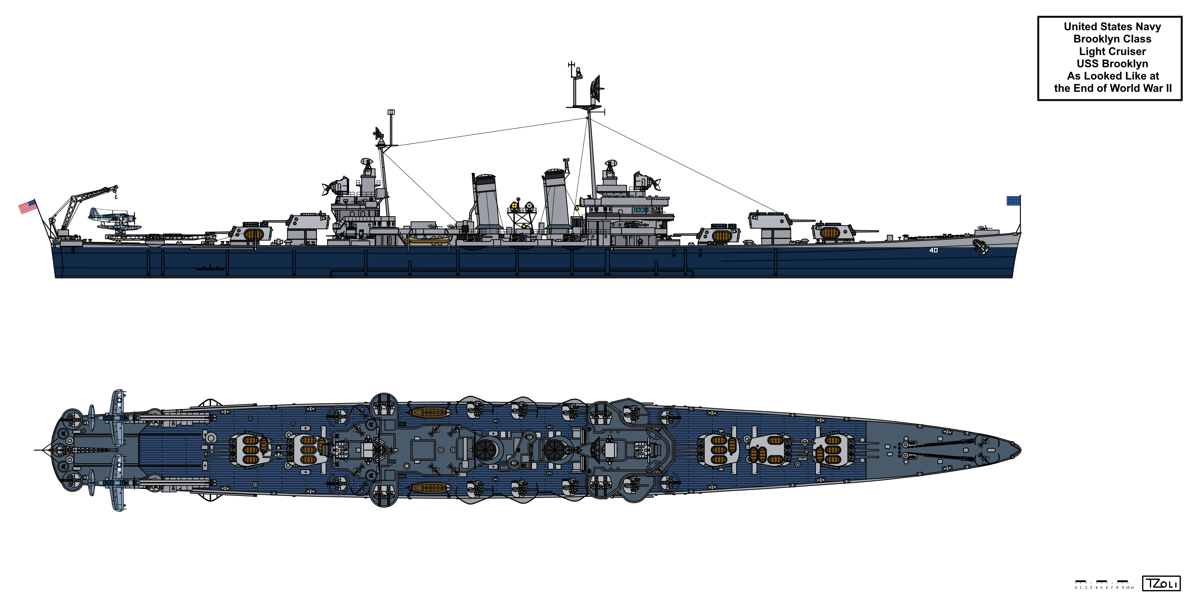

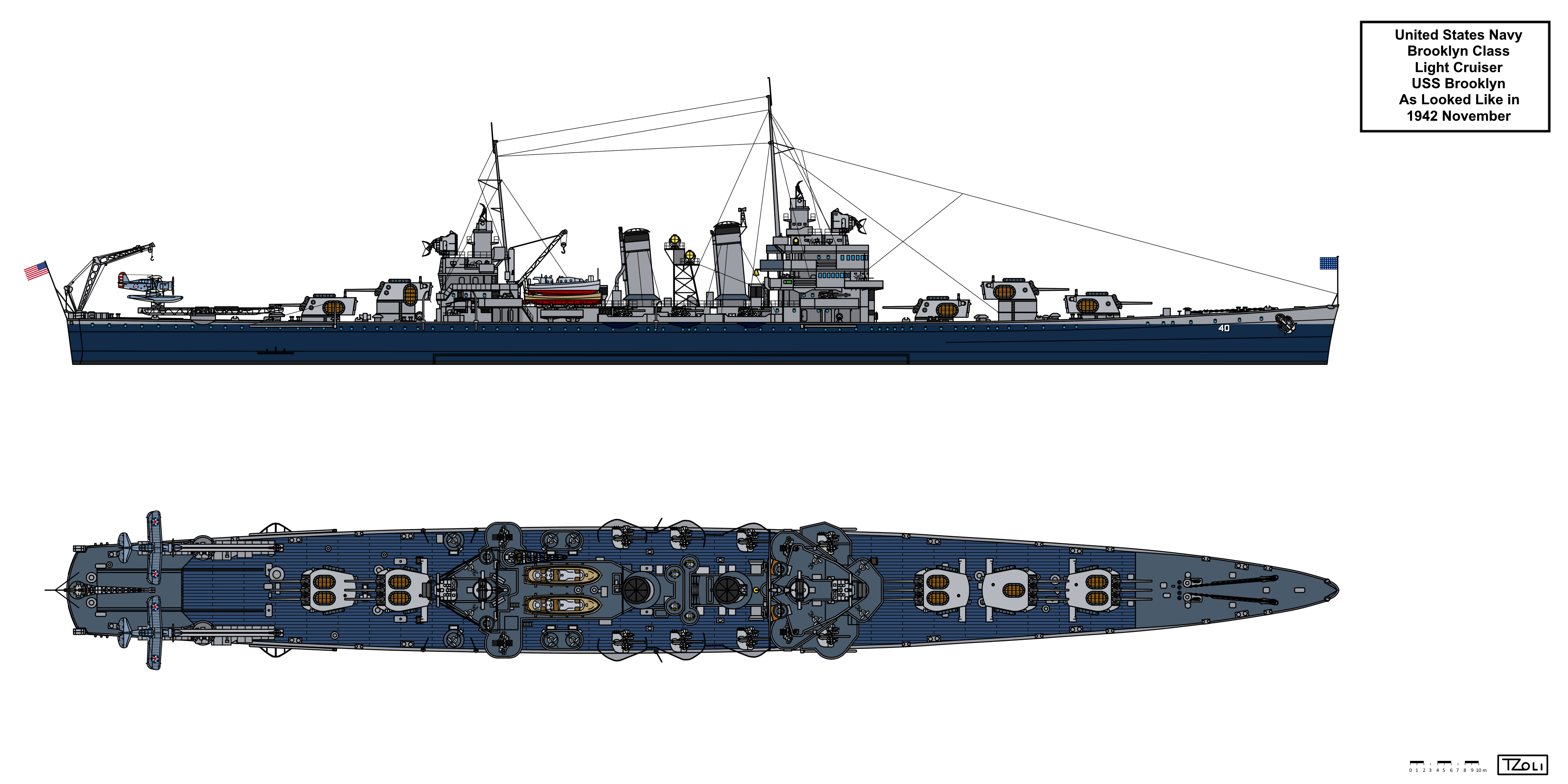

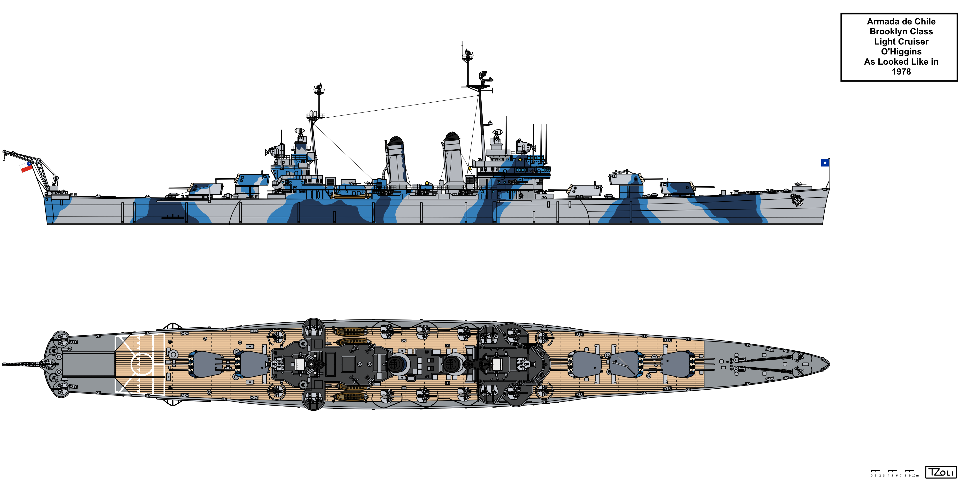

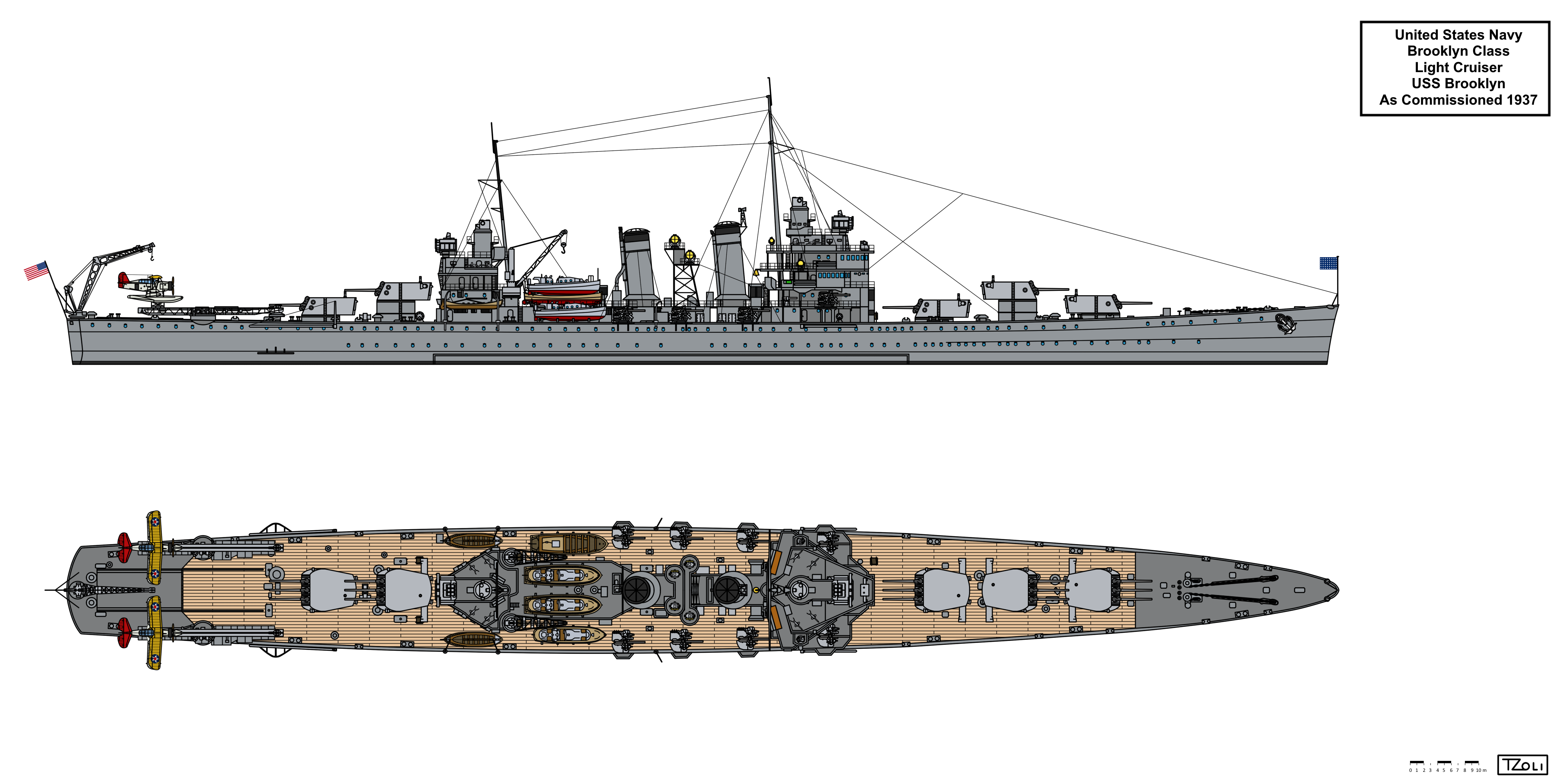

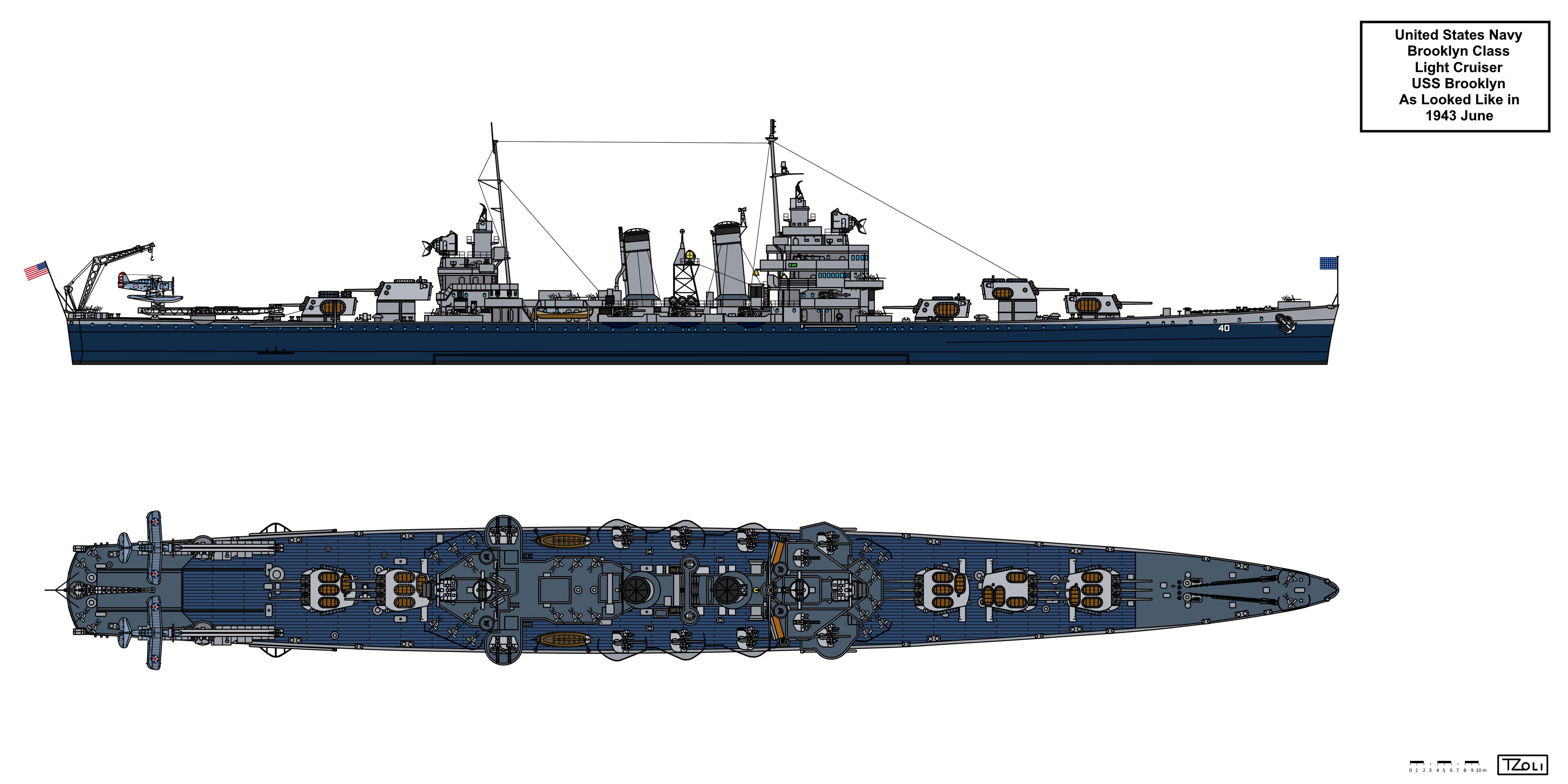

These are my drawings on USS Brooklyn/O'Higgins trough the years:
1937:
https://www.deviantart.com/tzoli/art/US ... 1310354109
Late 1941/Early 1942-ish:
https://www.deviantart.com/tzoli/art/US ... 1310728290
Late 1942:
Mid 1943:
https://www.deviantart.com/tzoli/art/US ... 1311087366
Around 1945:
https://www.deviantart.com/tzoli/art/US ... 1311459216
In Chilean Service:
https://www.deviantart.com/tzoli/art/Ch ... 1311814037
In 1951/52:
1963:
1978:

You do beautiful work, but I do have a couple of nitpicks. First, as built, the first 4 Brooklyn's had the open topped version of the MK-33 director. The later 3 were built with the fully enclosed MK-33's. CL's 40, 41 & 43 had the fully enclosed version installed in 1943 (whether new equipment or a conversion of the original directors, I don't know.) Savannah had the open topped directors when she was hit by the Fritz-X, and was rebuilt with MK-37's. Brooklyn and Philadelphia had the hull blisters installed in 1945, but didn't have the 5" gun/MK-37 upgrade that Savannah and Honolulu received. That can be seen in the main deck 5" gun tubs which no longer extended beyond the hull sides.

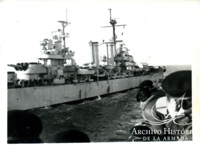

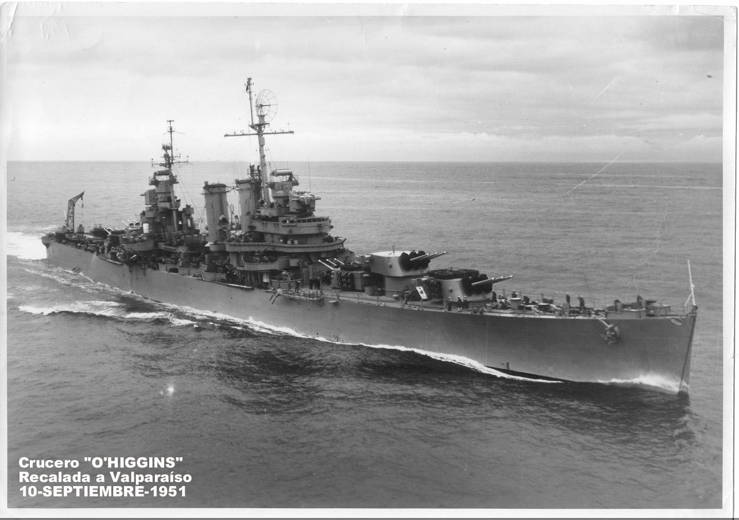

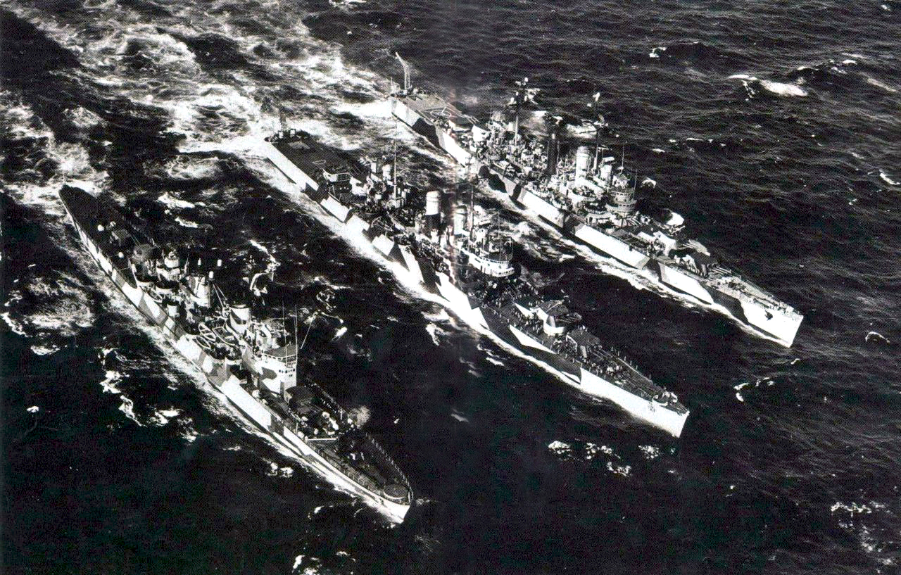

Here a view of the three Chilean cruisers in 1978 - on the right is O'Higgins (ex USS Brooklyn) with the much wider hull because of the torpedo blisters compared to her sistership Capitán Prat (ex Nashville) without them in the middle.

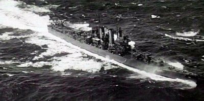

Here, you can see the positions of the 5" gun tubes relative to the hull side because of the wider hull of O'Higgins. Also clearly visible is the rear of the torpedo blister:
The rear of the torpedo blister is also visible here:

I thought they got a simple Torpedo Bulge but as I did not seen on any photo the characteristic bulges I thought this was an error. So the entire hull is widened???

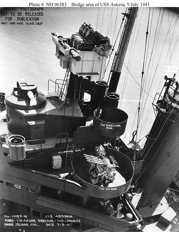

Also I cannot find any drawings of the open Mark 33 director, and all photos I've seen either not show the ship from aerial view to see the top of the AA directors, too far away or not high quality photo to notice anything or already shows the closed director.

Yes, the bulges are up to the level of the upper deck going up from the waterline in something like a 90° angle. In effect, the entire hull is widened.
As Dick J wrote, Brooklyn, Philadelphia, Savannah, and Honolulu got them.

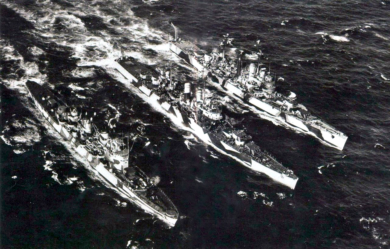

Here my Savannah compared to Nashville:
And Savannah, Nashville and Helena:
USS Savannah (1/700, Niko Model)

https://www.navsource.net/archives/04/034/0403412.jpg
The link goes to an image of the MK-28 director on the Astoria. The MK-33 was essentially a MK-28 with power drives. Because of the power drives, the MK-33 could carry more weight, like radar, wind baffles or getting fully enclosed. The MK-28 was hand cranked, and so limiting weight was critical for it to be maneuvered fast enough to track the aircraft it was targeting. But externally, the two director types were visually similar.

Okay, I've fixed the Mark 33 directors (Able to find a 3D model and 3 views here: https://www.swordfishmodels.com/product ... ly-version ) and the widened hull post 1945:

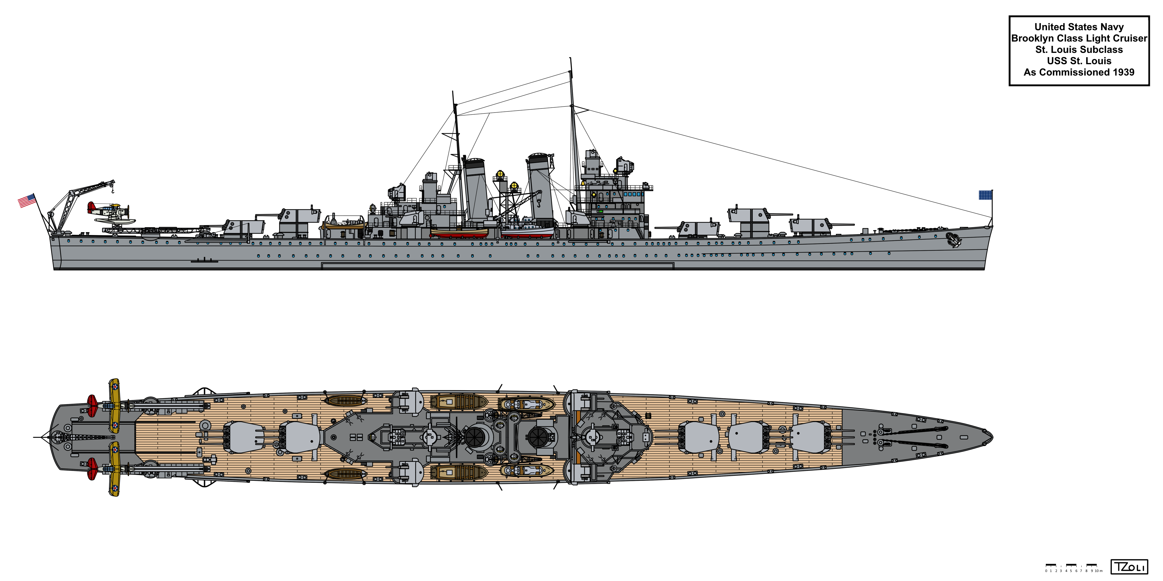

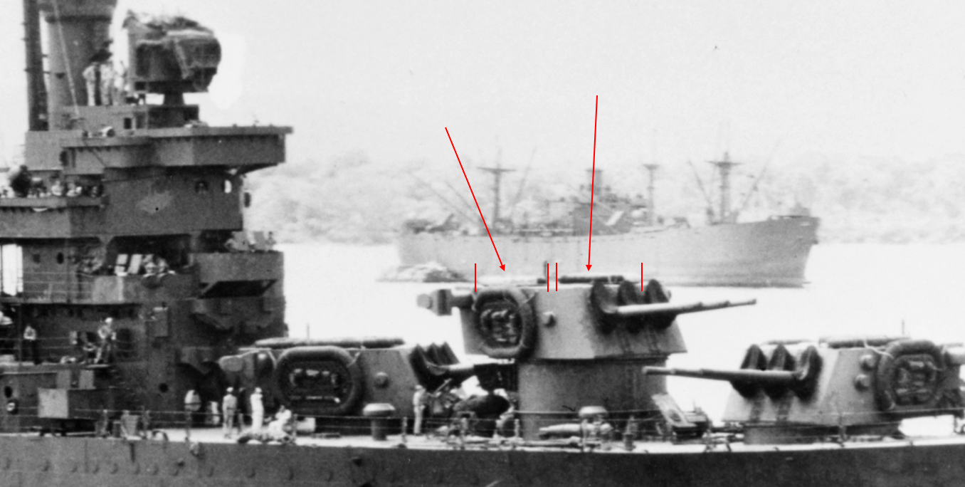

I've also made a drawing of St. Louis as commissioned in 1939 with the likeliest spots for the 0.5" Browning Machine Guns.
https://www.deviantart.com/tzoli/art/US ... 1313001544
