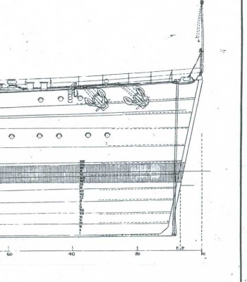

This is slightly off the current discussion but can someone provide any guidance as to where the top and bottom of the boot topping on the 1/350 Trumpeter HMS Cornwall would be located. I would like to get it right the first time. I'm thinking that the top edge of the boot on the model would start at the top edge of the 1st raised strake above the bulge. I don't know how wide to make it; perhaps 1/8" or .125. which would cause the bottom edge to be slightly higher than the bottom edge of the raised strake on the model. I also understand that some boot toppings are not equal in width for the length of the ship. I would assume that with a 1/350 hull this difference in width would not be significant. Any thoughts are appreciated. As always thanks in advance to all who chime in.

Maybe these two pictures I found are helpful.

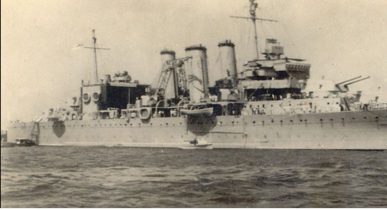

I'm building the trumpeter Cornwall as she appears in this photo. The vertical black painted stripes at the corners of the aircraft appear to cover the hanger doors too. Is this correct or just a trick of the light as I've seen it in no other photos also would it have covered the rear wall of the hanger too?

In the photo posted by Ady, the hangar doors are open, and the dark area is the interior of the hangar, in shadow. The boxes into which the doors rolled up show the top of the camouflage demarkations. The well-known photo of the ship being sunk shows a lighter coloure trapezoid shape on the front of the hangar (last photo on this page: https://www.world-war.co.uk/loss_corn_dorset.php3). The best (albeit not wonderful!) photo I have seen of the rear of the hangar is at http://www.ianmeadows.me.uk/images/jack ... ip9_lg.jpg.

Thanks for that. I did wonder if the doors were open and it was shadow inside. Looks as though the black just wraps around each corner of the hanger then. Cheers

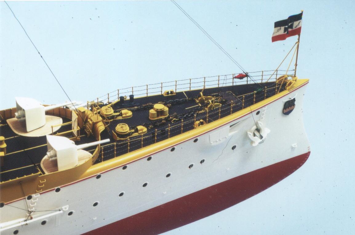

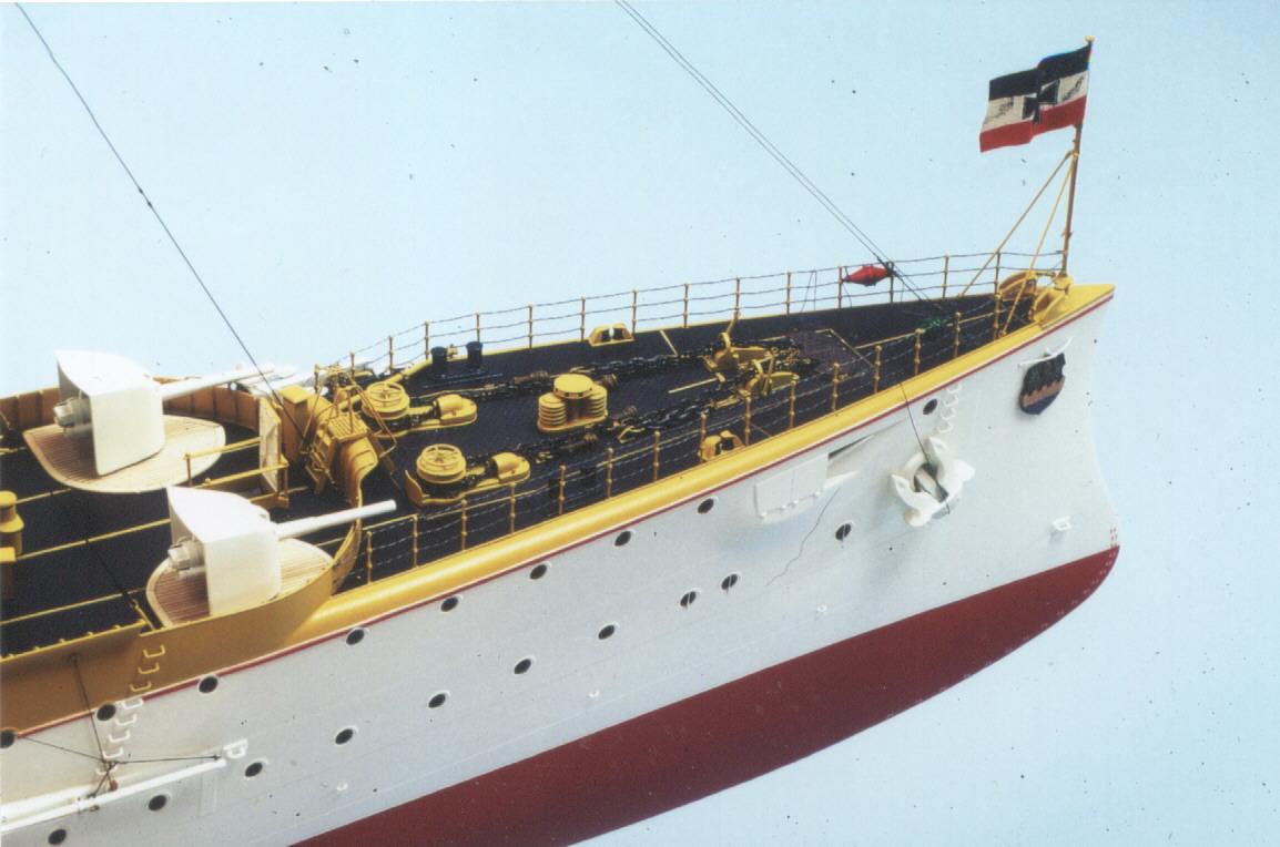

Before WW1, in the German Imperial Navy the 'China Station' cruisers like Emden had white hulls (and yellow superstrucyure/funnels), with a narrow red line along the deck edge. Maybe you have that image in mind, but to my knowledge this was never ever used in the Royal Navy.

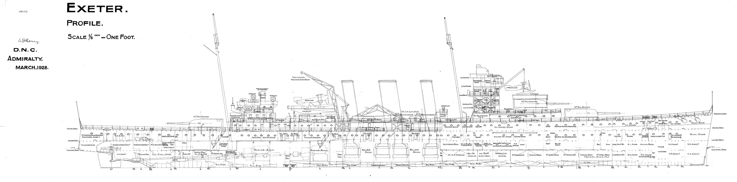

For all you three funnel County Class fans :heh: , here is a glimpse of what Exeter (and York) would have looked like if built as conceived ca1928. (Pardon if it has been posted earlier, as I did not look through the whole thread.)

KevinD wrote:For all you three funnel County Class fans :heh: , here is a glimpse of what Exeter (and York) would have looked like if built as conceived ca1928. (Pardon if it has been posted earlier, as I did not look through the whole thread.)
Yeah, funny isn't it, the York class owes a lot to the Counties... At least York retained the slant funnels, in Exeter they were straight up again, back to WW1 looks!

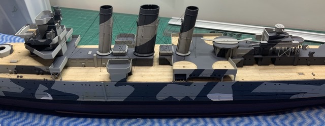

This is my build of HMAS Canberra as she appeared in May 1942. She�s not complete, but all of the major scratch building has been completed here. Base kit is Trumpeters 1/350 Kent.
Maartin, my apologies, I must have missed this when first you posted, only noticing it today when the latest 'post notice' came in, so...............
Yes, nothing like those aft slanted funnels to give the enemy no doubt regards which way you are heading / facing. :smallsmile: :wave_1:

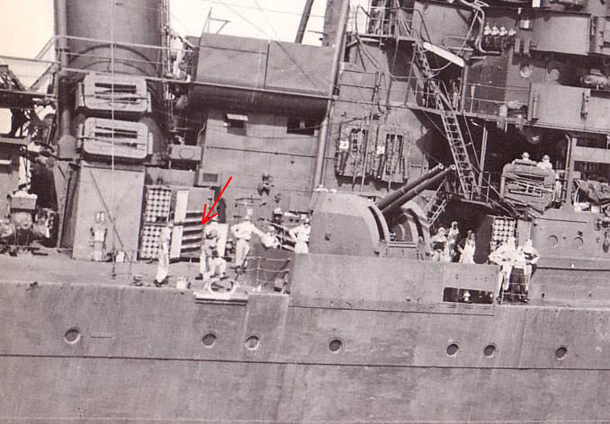

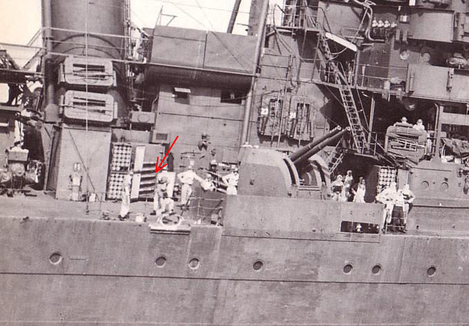

would anyone have an idea about the object to the right from the 4in ready ammo locker on HMAS Australia, marked by red arrow on the famous photo below of Australia hit by the Betty off Leyte? There are apparently open doors of the ammo lockers and behind them to the right there are some shelfs? or pipes? on the facing side of a large "box". I tried to locate something similar on other class members but to no avail so far.
Thanks!
